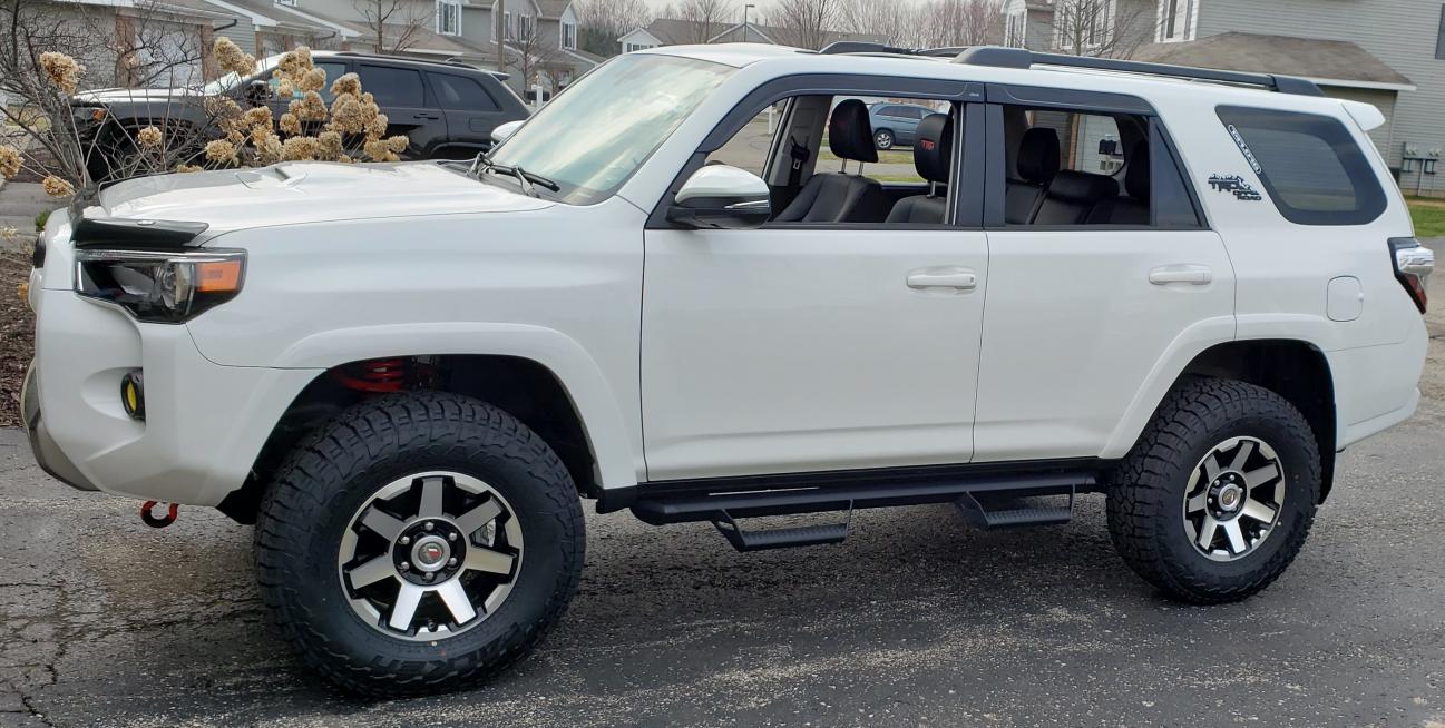

New TRD Off Road

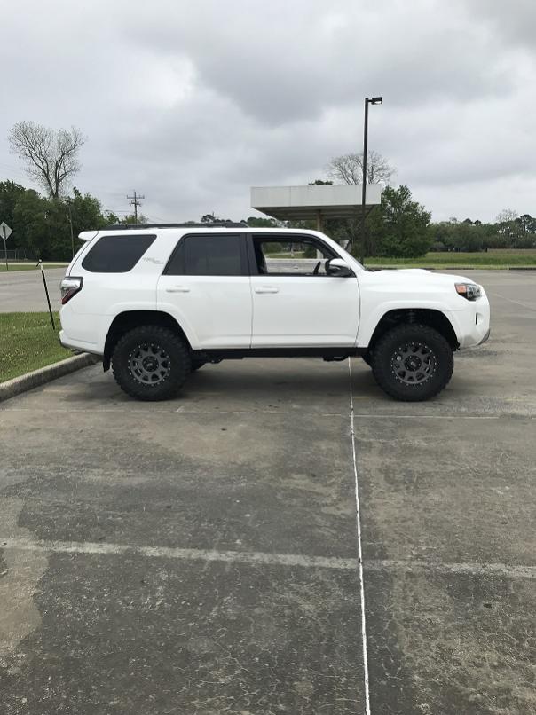

today I installed the lift and tires that were on my previous 4Runner,
just bought the new one last week and have been busy doing mods.

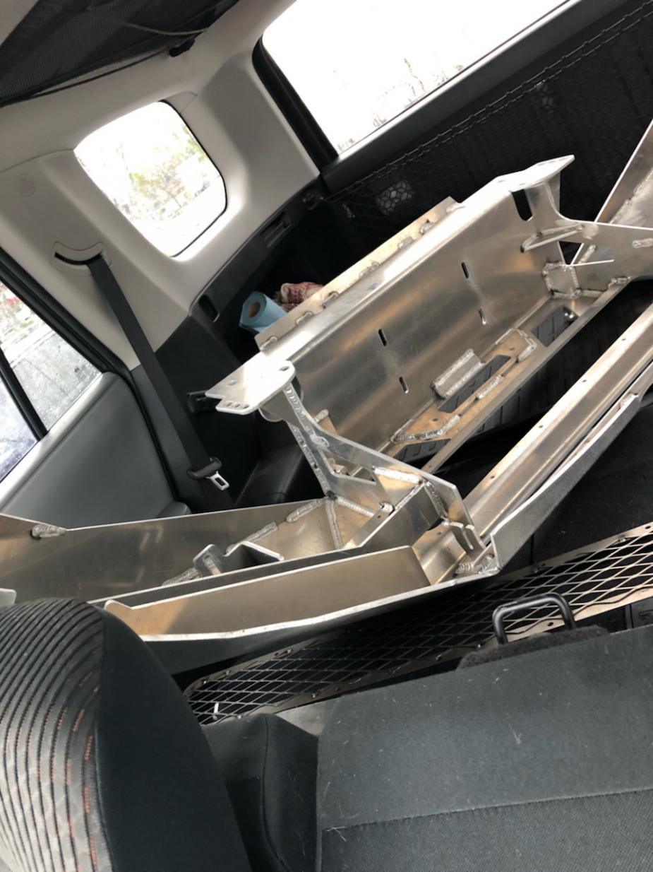

Headed out to BAMF at lunch and picked up this thing from Jerry.
Baja Designs lights will be delivered tomorrow.
Wife is helping me tear apart headlights tonight for the retrofit.
Now how do I coat the bumper?

Our delivery guy is such a crybaby. "so heavy, so heavy!"
Haha I'm ready to spend the weekend hacking my front end to bits in order to make these suckers fit.
I totally want to know what you had to do to run these. I’ve been looking at this setup for a while now.
I'll let you know! I plan on chopping/pushing/banging/cutting for the next few days. I only have one tire mounted on a wheel right now, but hoping to have everything rolling by the end of the week. Depends on how long it takes to acquire some 106/112 hub centric rings.

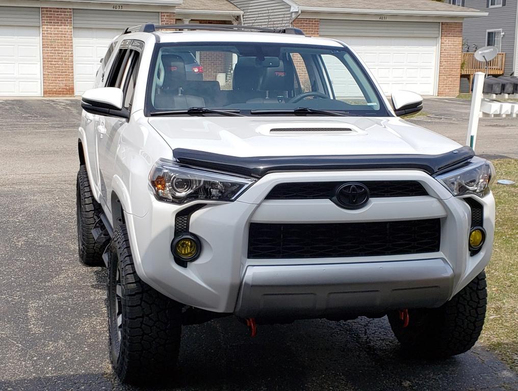

Had 285/70R17 Falken Wildpeaks put on today. Rubbed on front fender liner and still have some rubbing on the body mount.
They didn't give me alignment numbers when the lift was installed so I am going to have them check the caster and hopefully that fixes the body mount rub.
You want about 4* caster. If that doesn't solve it, take the wheel spacers off. They are definitely causing some of the problems with rubbing.
Without spacers it'll rub on the ucas. I might have to choose between the spots.
May come down to buying wheels with the correct back spacing or doing a BMC It's a shame, those trail wheels look really good. Just not the best for wider tires and JBA arms are prone to rubbing. They have more rubbing issues than any other arm on the market.
