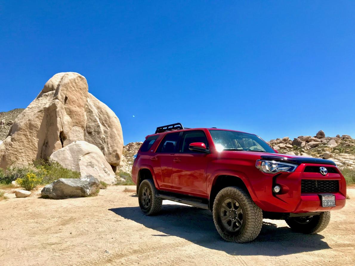

Not quite. 17x8 with 4.5" BS and 0 offset is generally the magic number. You're at probably 3.5" BS now, maybe less. In this picture I'm running 1.5" lift with 295s and no rubbing, no BMC

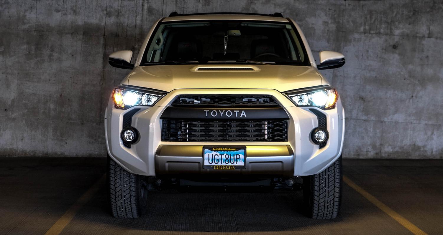

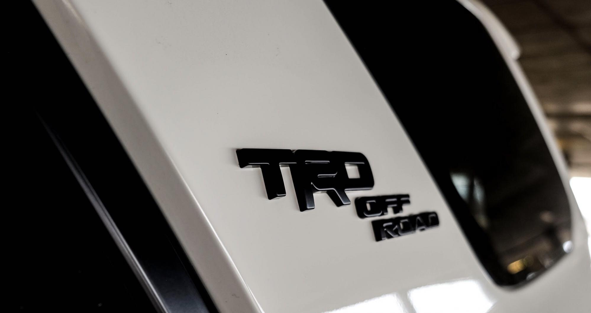

Finally got a chance to install grill, Led’s and black overlays.

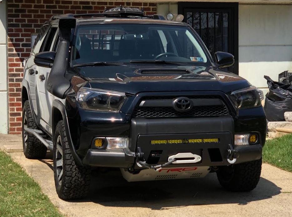

C4 10-13 Lo Pro

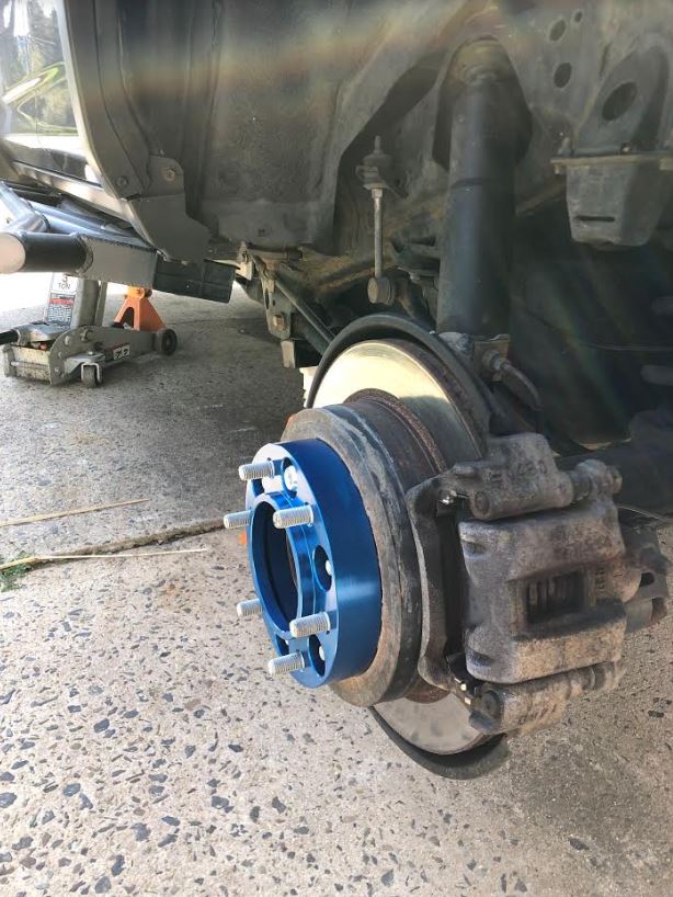

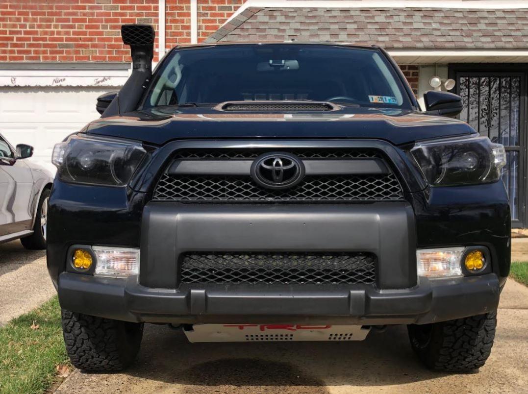

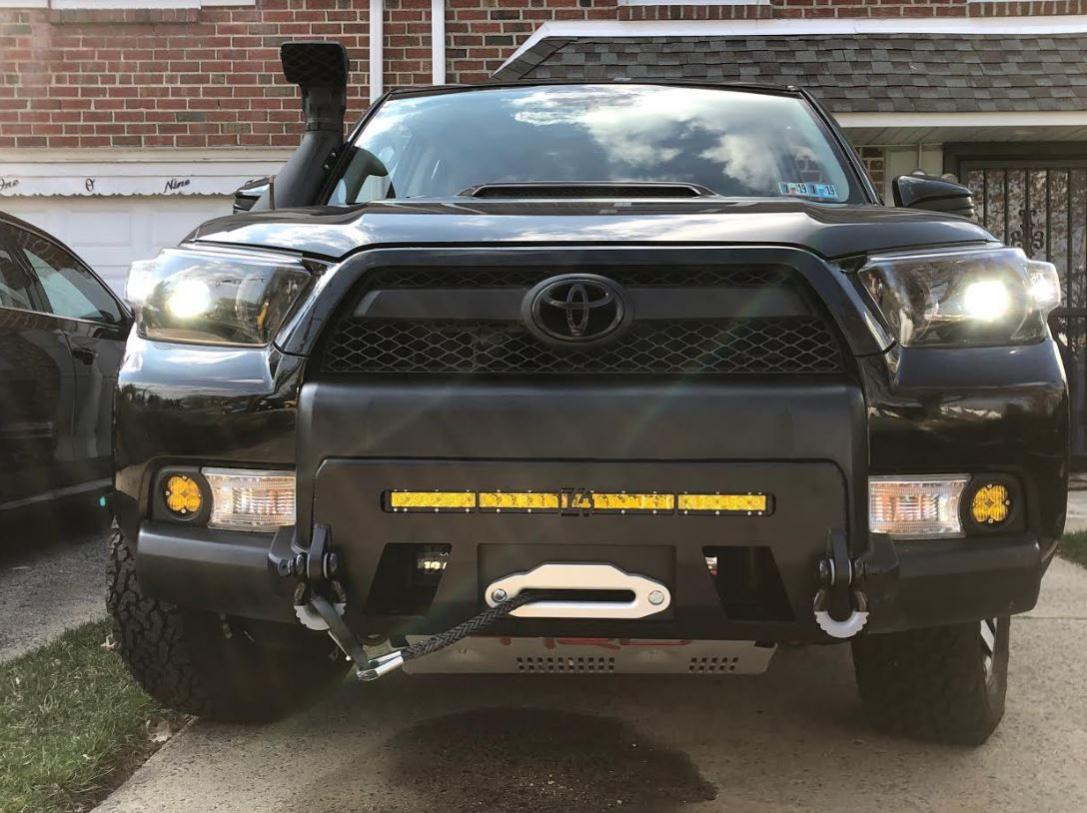

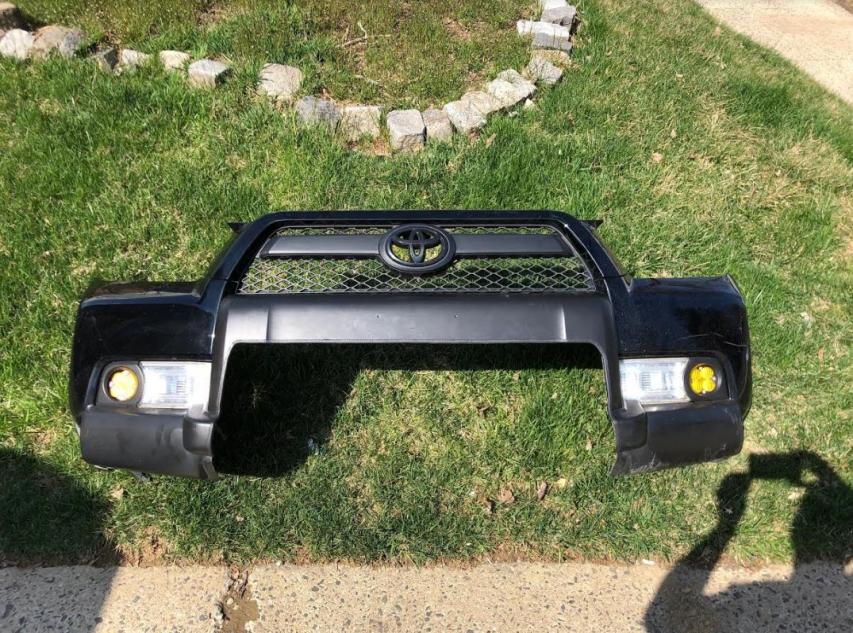

Installed the new 10-13 C4 lo-pro winch bumper and a set of 1.25" Spidertrax spacers.

Looks really good, how did the cutting and install process go?
The physical bumper install was very straightforward and easy. The most time consuming part was the bumper trimming, mainly because I cut on the long side of their measurements because I wanted a smaller "gap" so it was a lot of trimming and test fitting to get it how I wanted.
Shrockworks make a heck of nice bumper with a very simply design, I am very pleased with my purchase!
