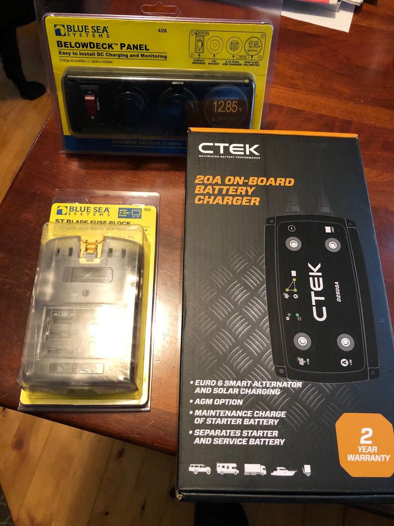

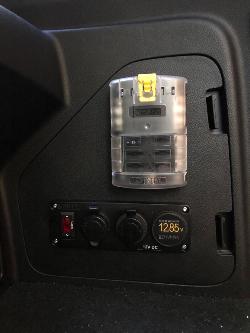

Parts are arriving so I started my dual battery install yesterday. Wires run from engine bay to rear passenger cargo area and got these installed. Waiting on C4 Fab battery tray to decide where C-Tek unit will go and the finish up wiring.

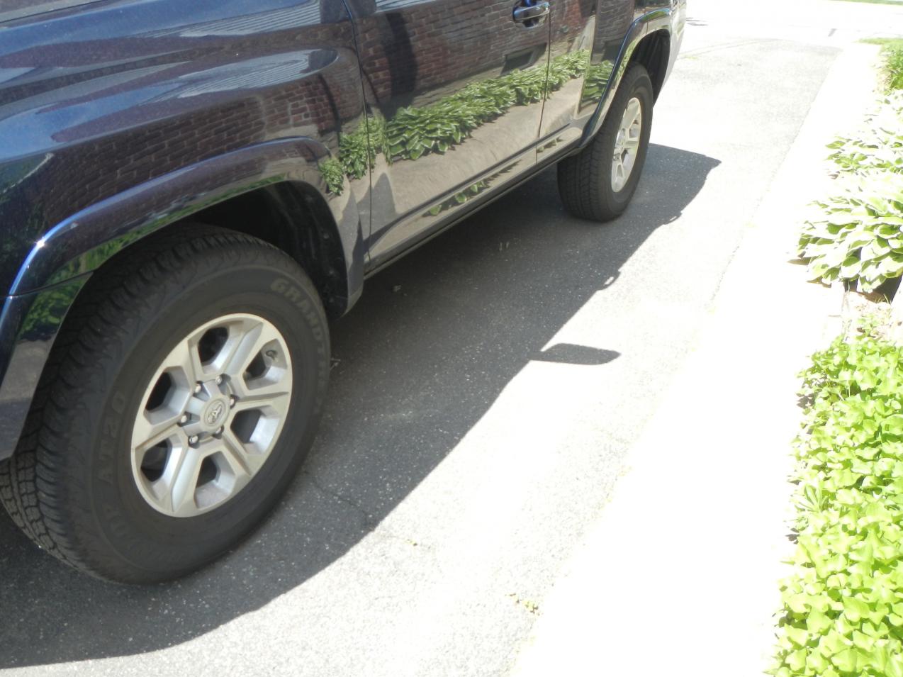

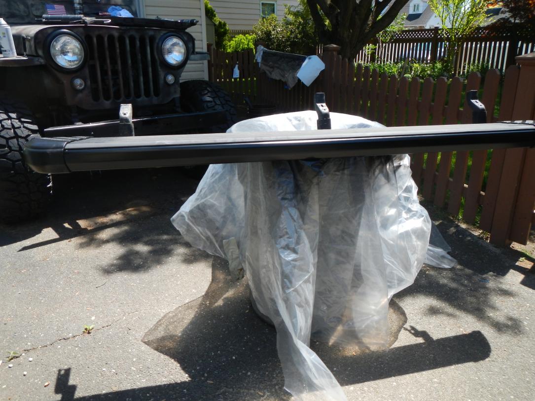

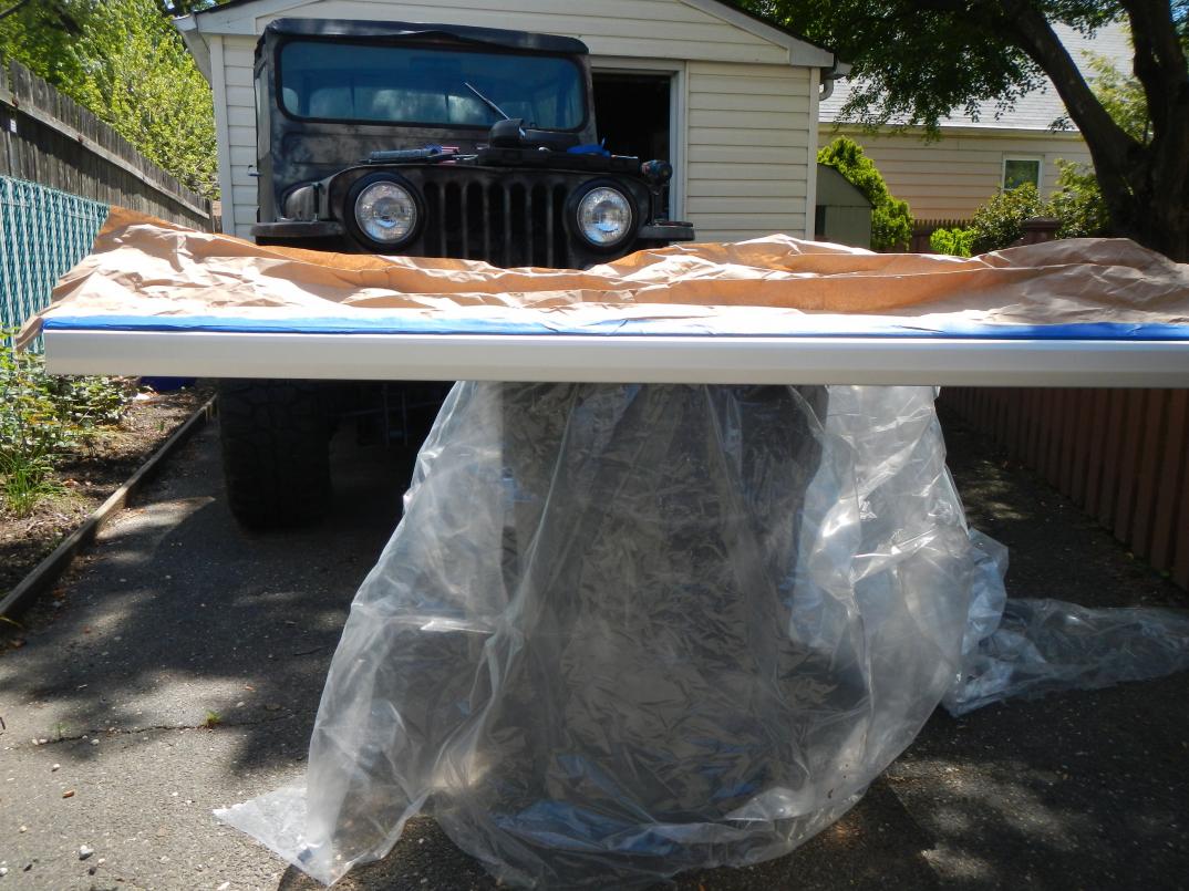

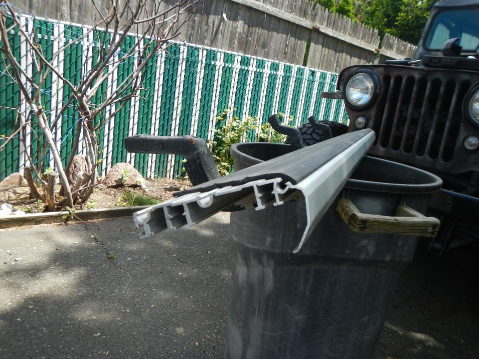

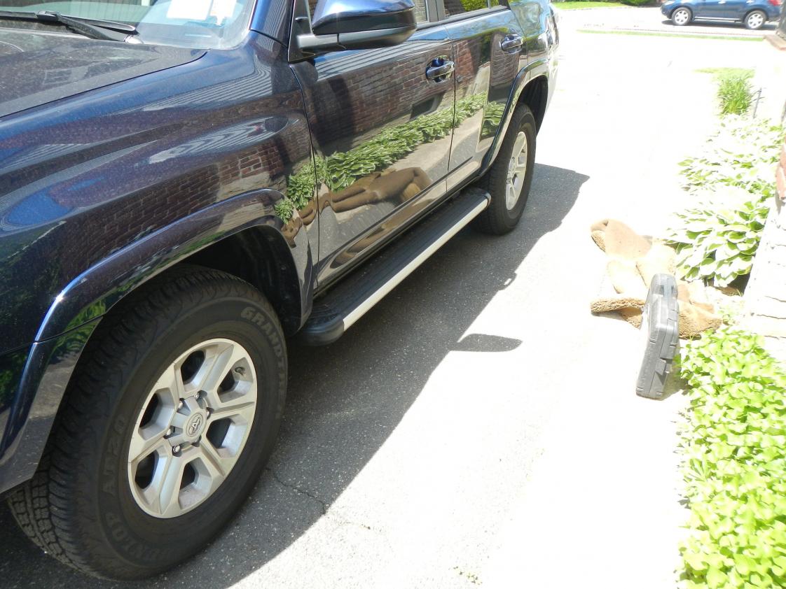

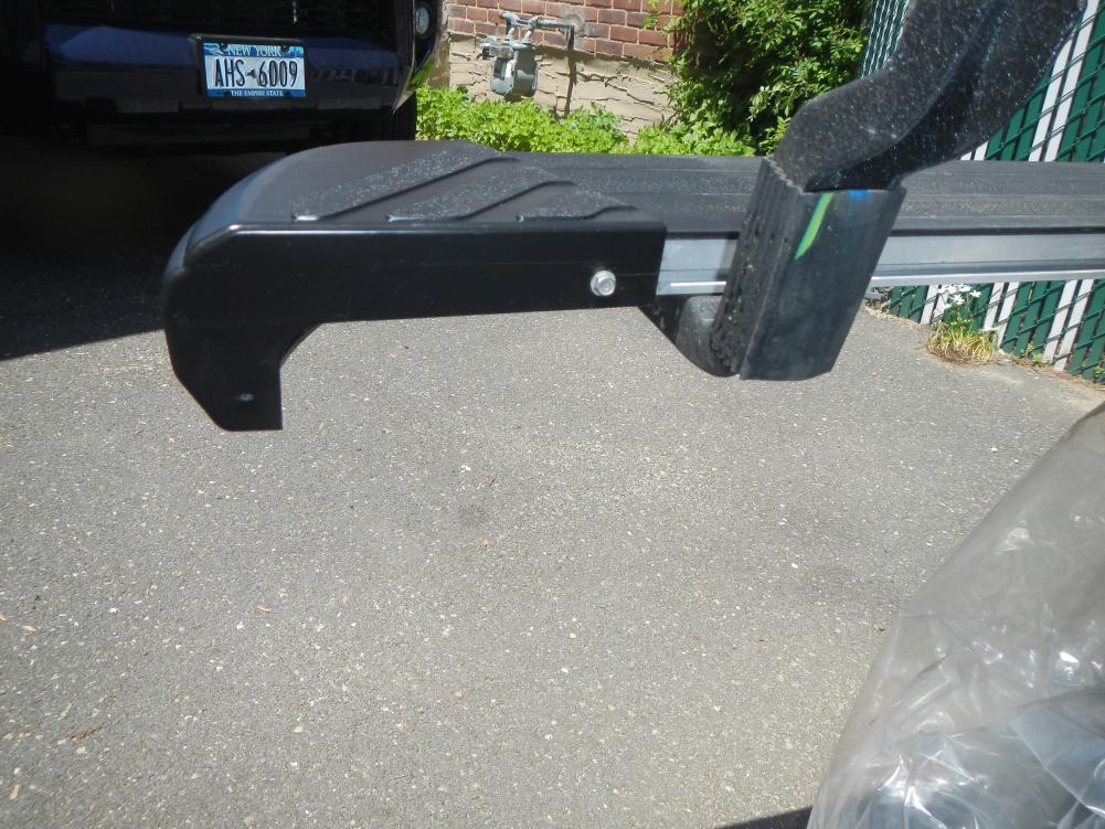

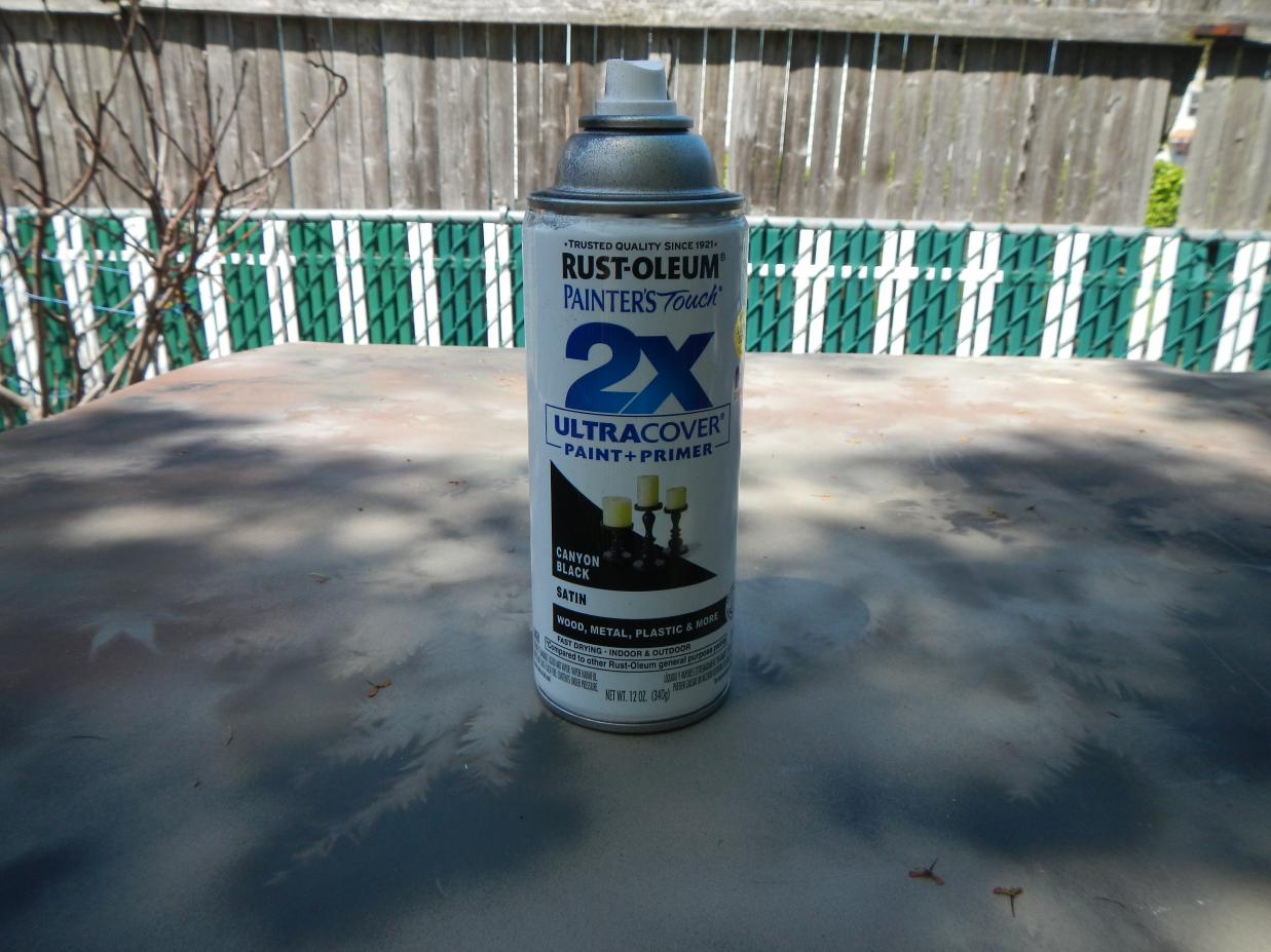

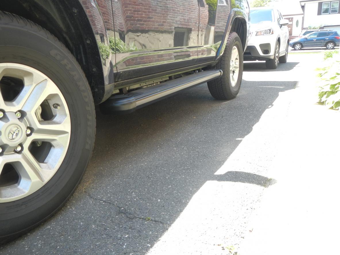

Painted the side steps
I really don't care for the side steps and don't want to spend $$ right now for nicer ones. My wife thinks the Runner is too high without them and they are handy for putting stuff on the roof racks soooo...
An easy job but time consuming. I didn't want to worry about over spray on the car with all the masking that would entail so I took them off. You'll need a 12MM socket if you decide to do this. Also a 8MM to take of the small bolt holding the end caps on. I wanted to remove the rubber tread but it's dovetailed on there and I tried for a while to slide them off with no luck. Tape doesn't like to stick to them but I did the best I could.There's a picture of the paint I used, I like the satin finish. Took about 4 hours including taking them off, prep, masking and painting. I waited about an hour for the paint to dry enough then I put them back on. I'm happy with the results. It will be interesting to see how they hold up. Easy touch up when that becomes necessary.
The bolts holding them on to the truck are long with a pretty fine thread and I'm lazy so I used my drill/driver to spin them off and on then final tightening with a ratchet.

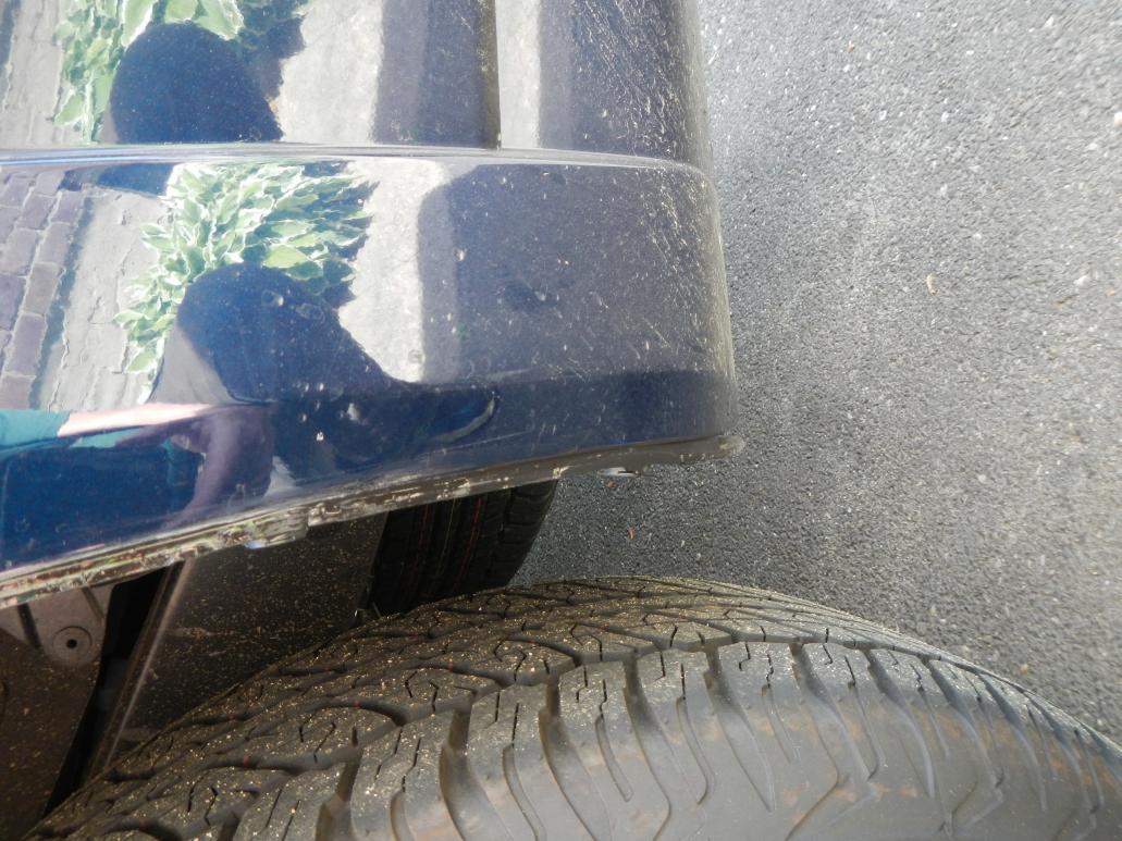

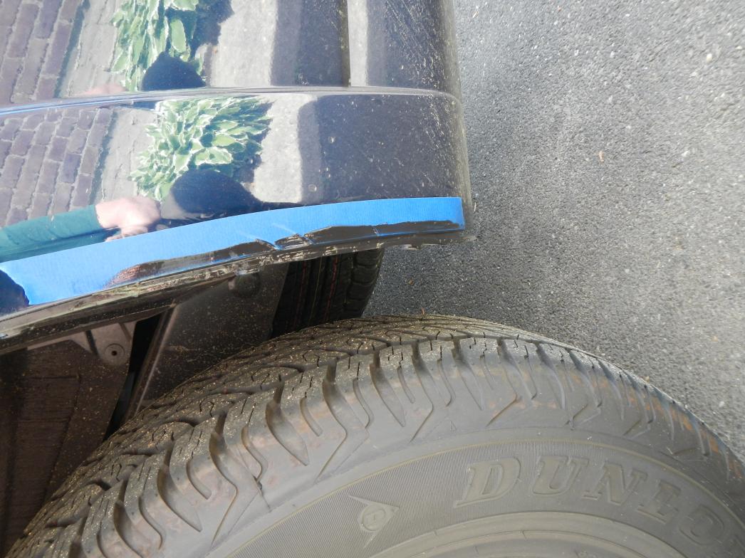

Siliconed the gap on the rear mud flaps
Anyone who has removed/cut the mud flaps know there's a gap where the bumps are for the plastic rivets. I've seen where some guys ground them off but I decided to use black silicone and fill the gaps. I made sure a good amount got squeezed into the gap. Looks smoother in person than the pic.

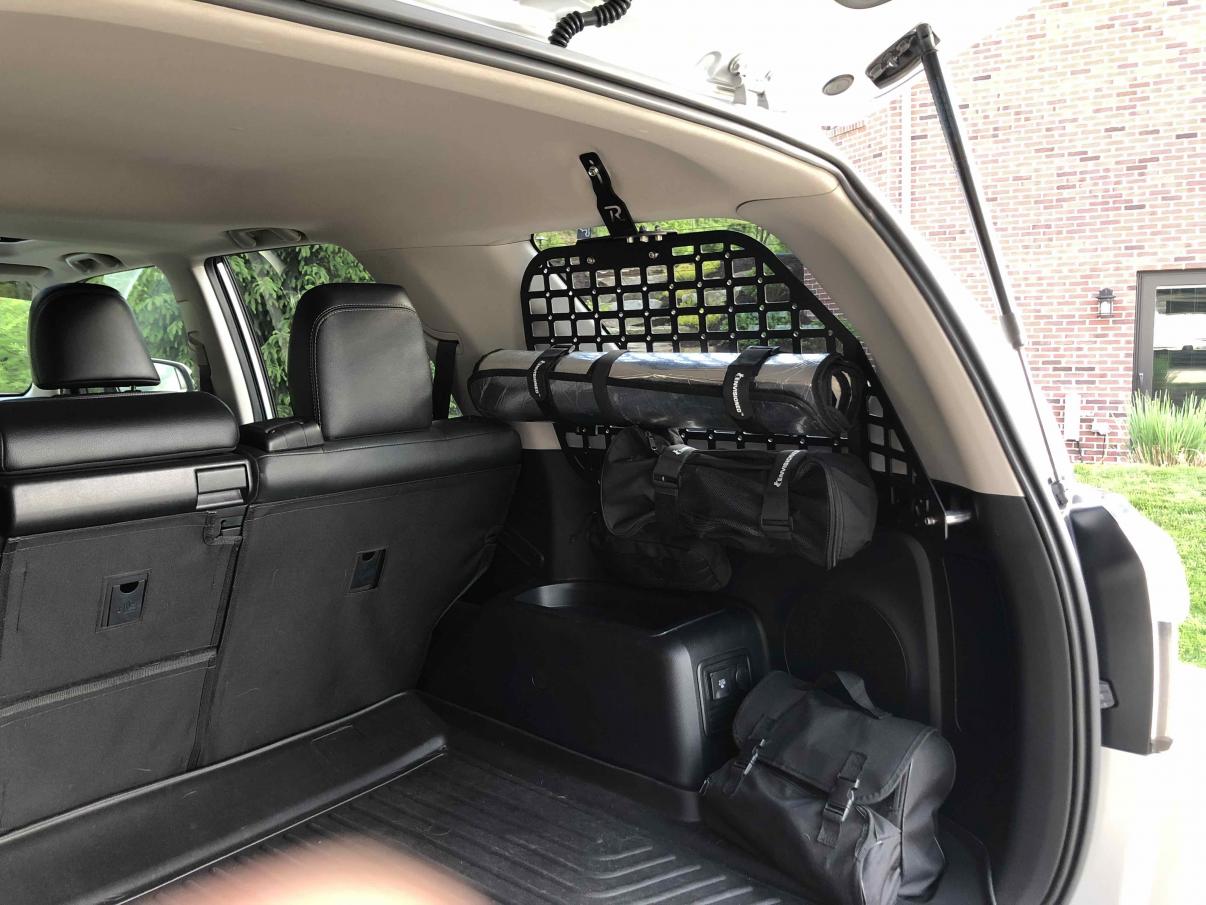

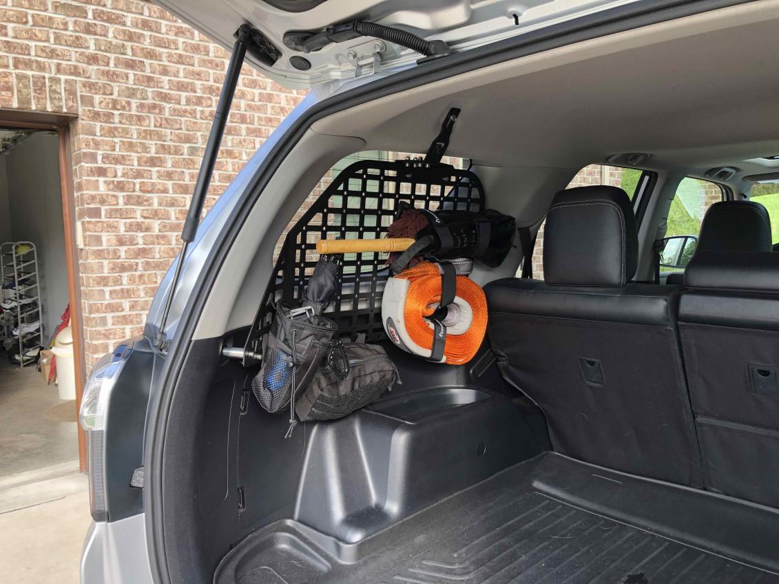

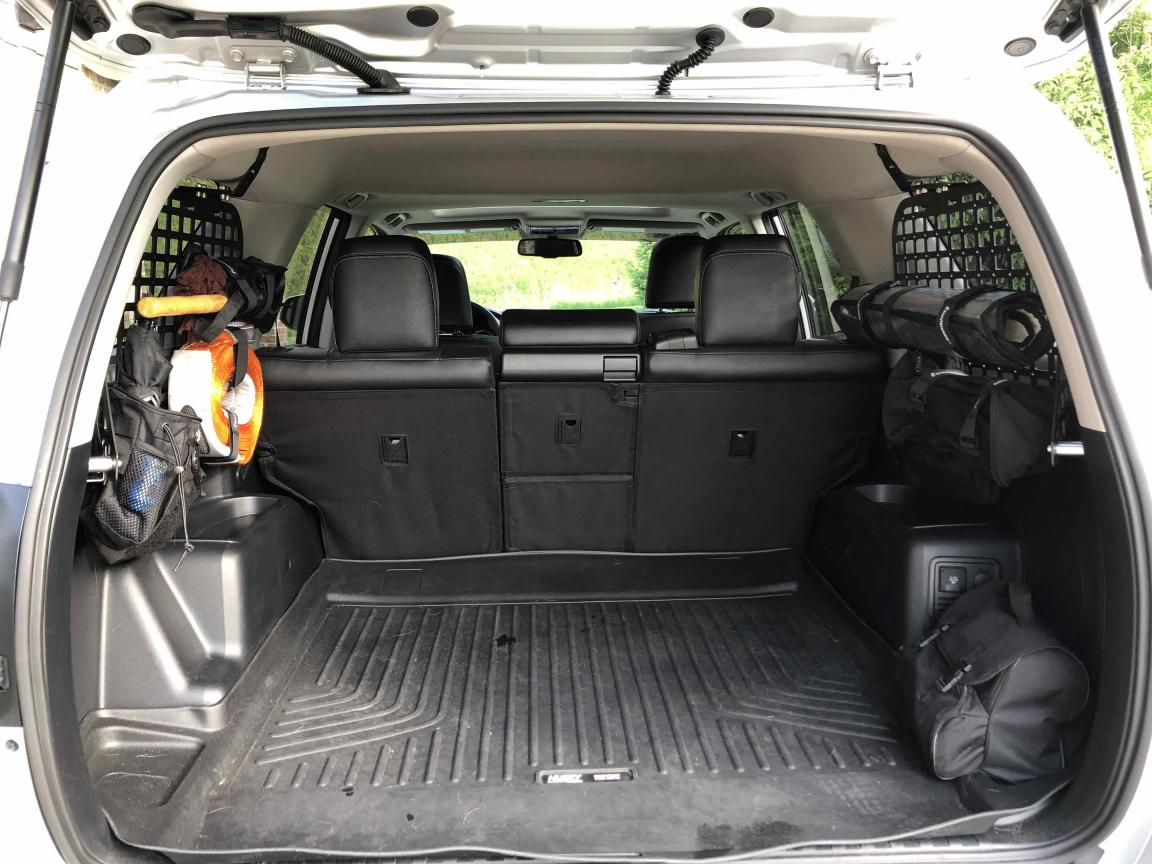

Rago Fabrication Molle Panels
Ordered these about 4 weeks ago and they finally came in. The workmanship is excellent. Watched their install video and very easy to install. All bolts/nuts/washers were accounted for.
I used to carry a medium plastic tote in the back to keep all this stuff in one place. The dog didn't appreciate that... The only thing I have on the cargo floor now is the heavy air compressor.
Very happy with the results. Still playing around with arrangements and I have room for more stuff.

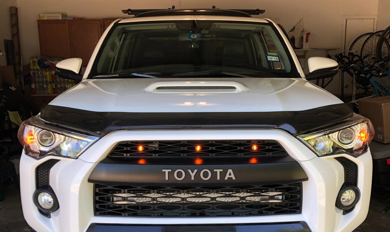

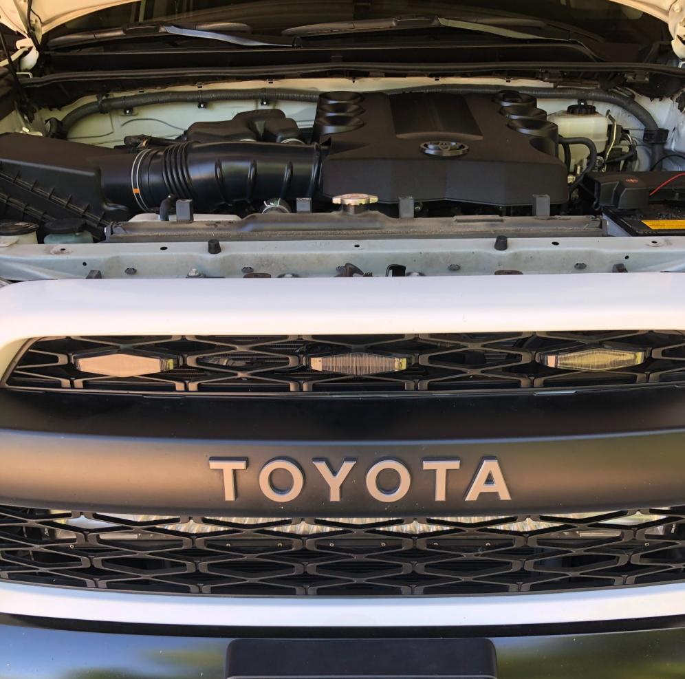

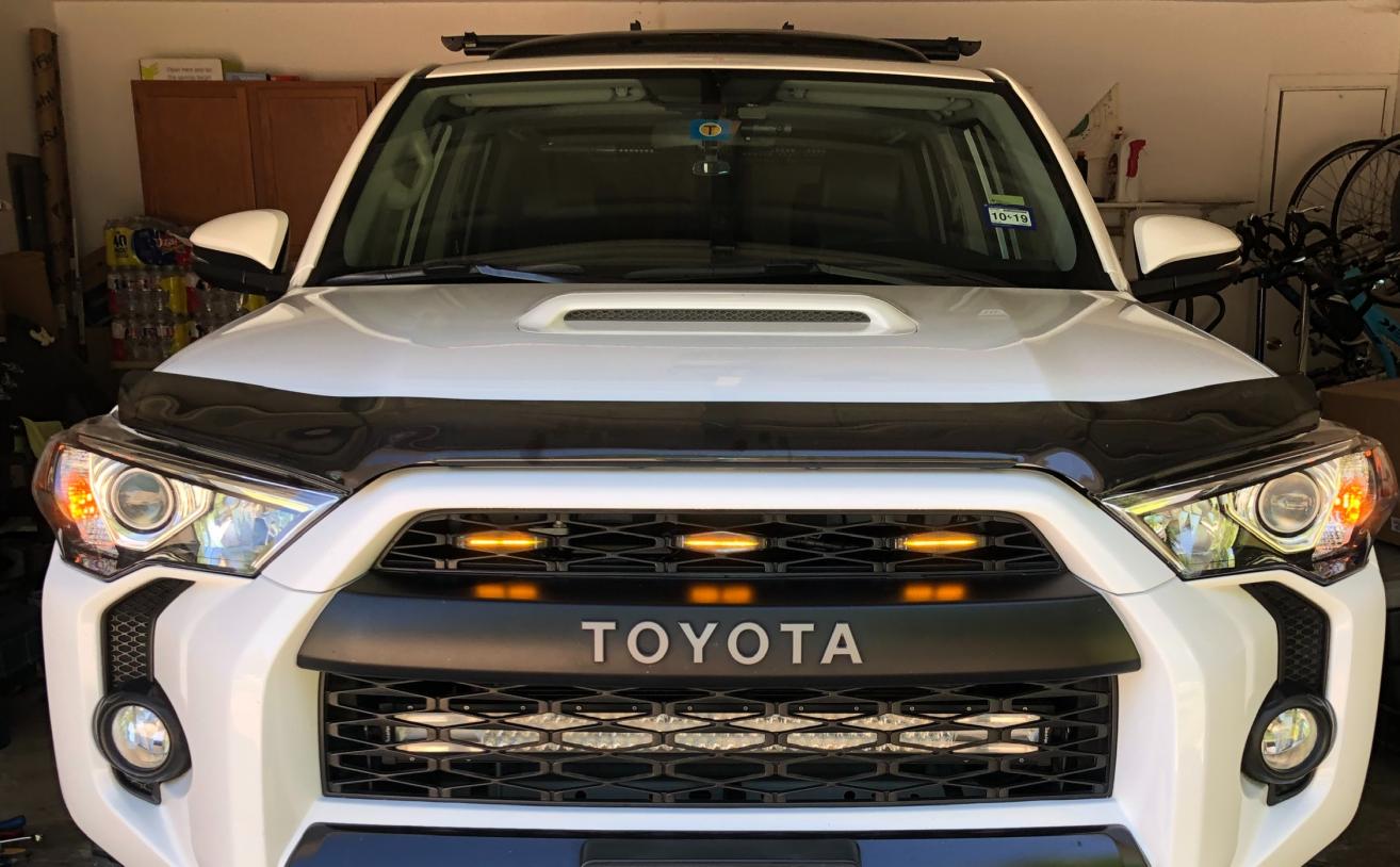

Raptor lights
Decided to change it up some with some different grill lights. Going to give these smoke eBay specials a try. Not bad for 35 bucks.

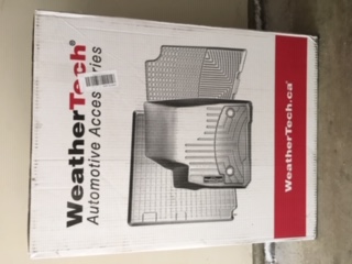

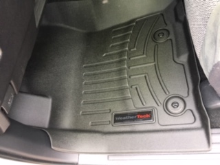

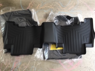

I installed the Weathertech floor liners for the first and second row in the 4Runner.
I initially ordered the Husky liners but I returned them. I order the Weathertech ones after. I preferred the Weathertech ones over the Husky because the Husky ones had too many nubs/cleats over some plastic areas and they scratched the plastic panels.
