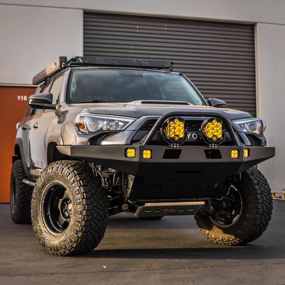

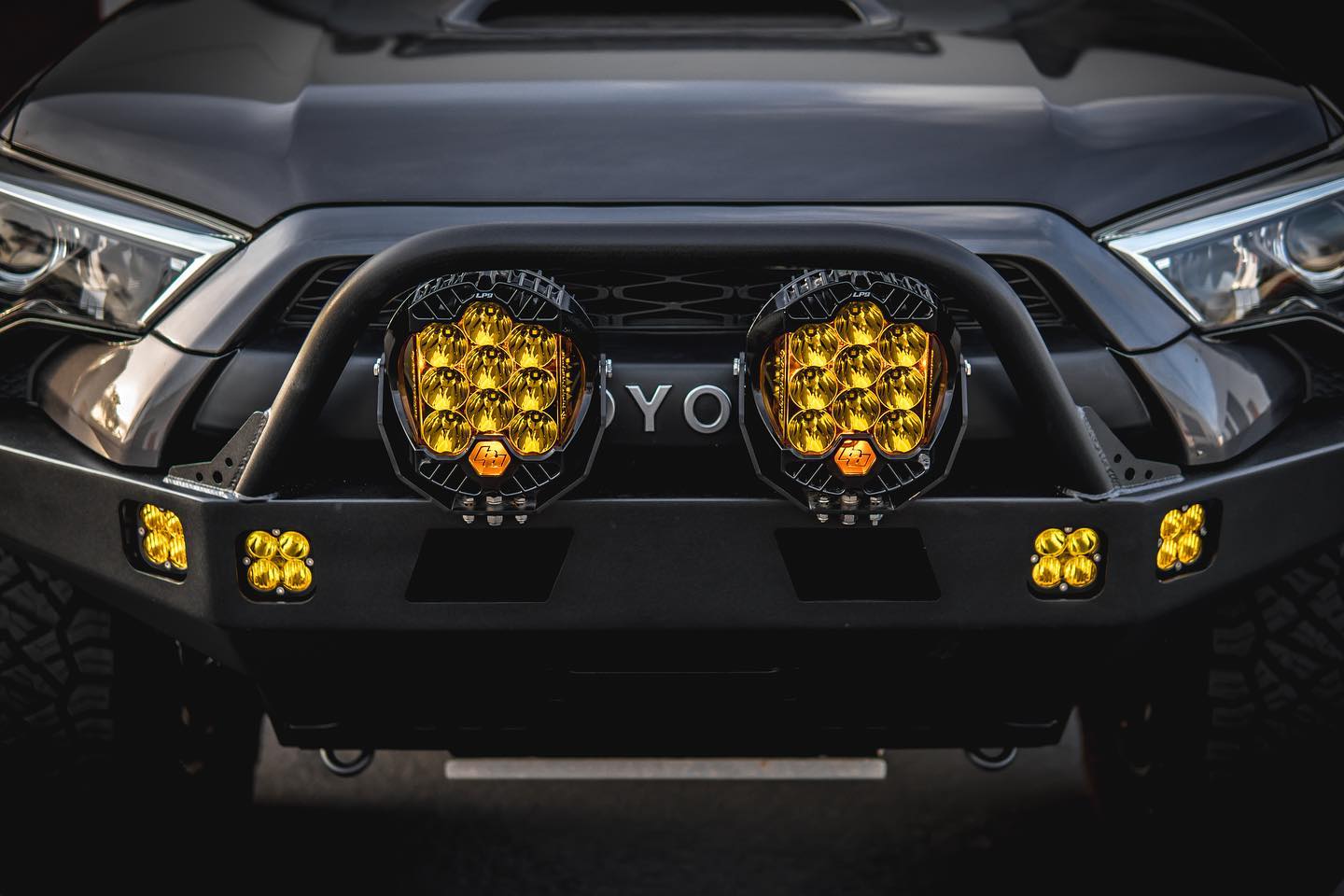

Slapped on Coastal Offroad's brand spankin new front steel bumper (comes in single or triple hoops). Switched up the lighting hardware a little - LP9 Pros, Squadron Sports in WC and DC. Swapped out the front spring and rear springs to accomodate for the heavier loads front and back. Also decided to clean up the wiring in the engine bay to satisfy my OCD.
