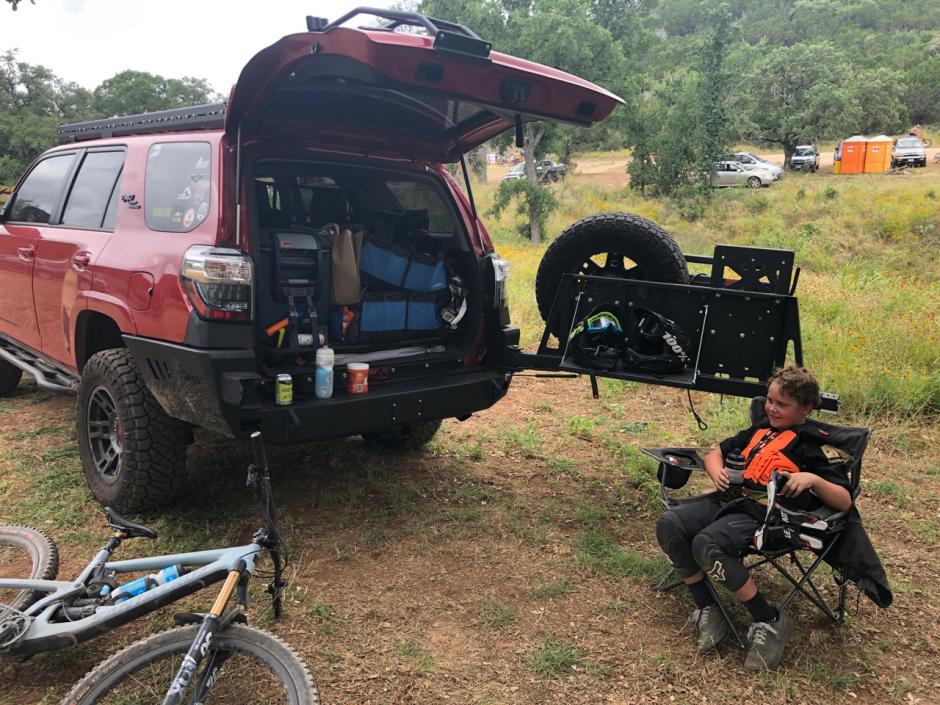

Hey Black
Sorry didn’t take many pics, made it out 3/4” birch ply and European adjustable cabinet hinges. The hinge plates through bolt to each other on the center bulk head and the hinges just clip on. The front doors open the opposite way via the back passenger doors. The top of the box has the fuzzy side peal and stick Velcro on all the flat surfaces so the doors don’t rattle. I was gonna carpet the doors but didn’t leave enough room.
70AAA6DB-B358-46A4-98E9-85D1DFDFAFFD[/url
This is upside down from the front.
[url=https://flic.kr/p/2gi2gyv]
F7CE5F9A-0C7A-4C73-81C2-B95CF81A5D73[/url

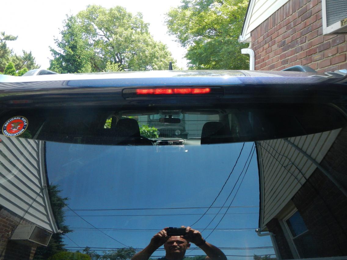

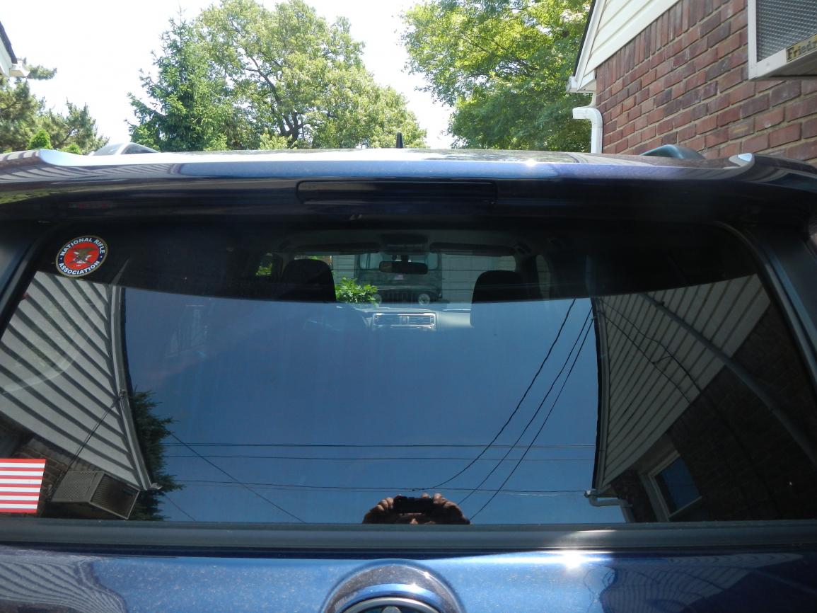

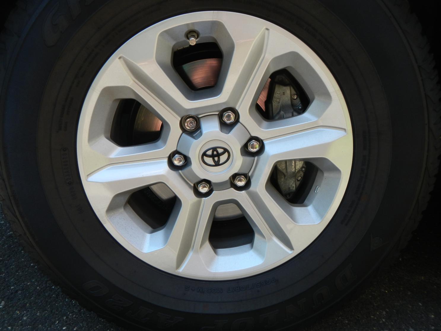

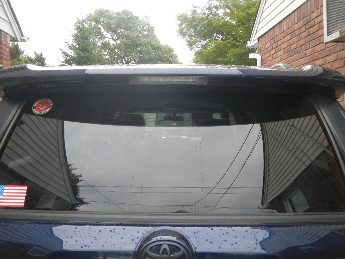

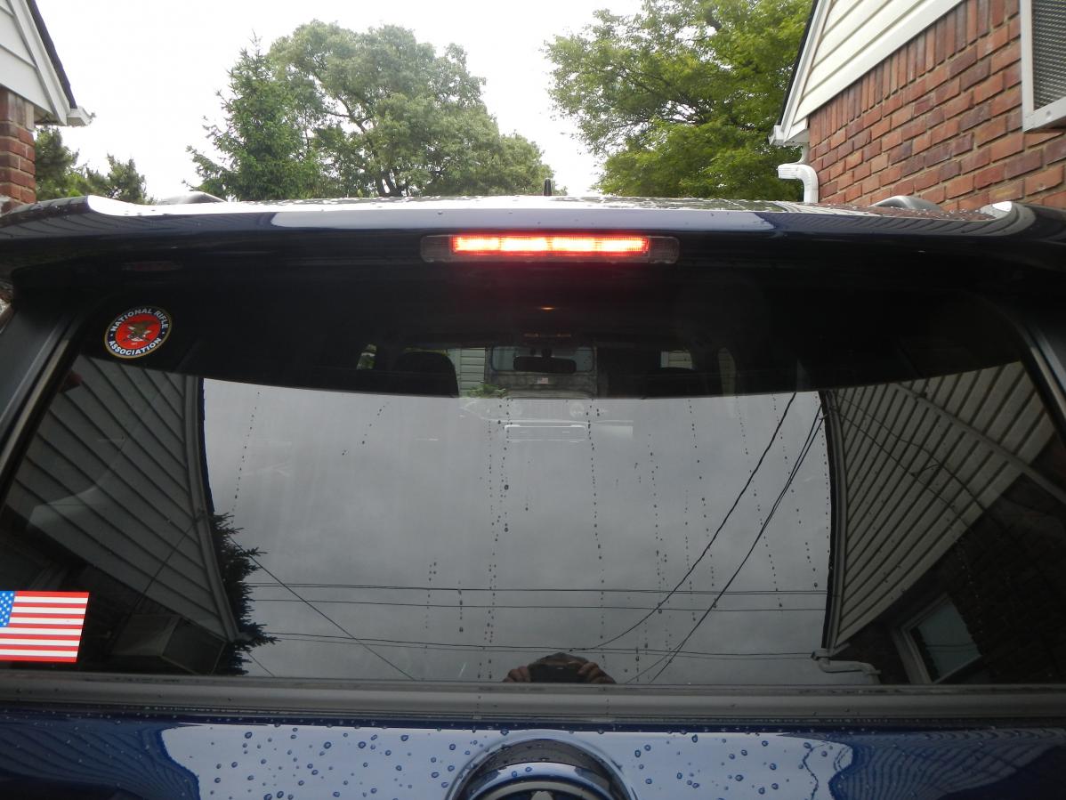

A couple of small things. Painted the chrome badges on the wheels black. I just didn't like the chrome. Took a long time sanding the chrome! Some tiny corners there. Since the tinted 3rd brake light my son got me didn't have the right plug, I decided to tint the original myself. Lights are dimmer but still very visible.

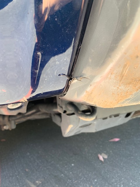

picked up nitto terra grapplers yesterday night, mounted them this morning and hit hollister svrp and proceeded to crack my front bumper.
looks like it's time for that bumper upgrade :whistle:
