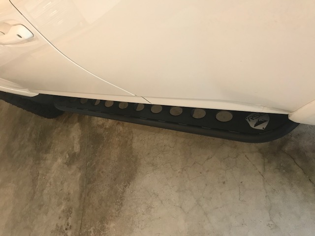

I was in Houston the other day and swung by the Shrockworks shop. It just so happens they keep a few sets of sliders in stock. Got them on today another stout product from Shrockworks.

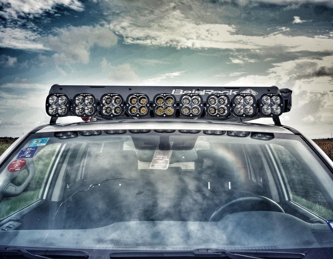

Installed a new light bar. BD XL Sports high speed spots! love the way it turned out.

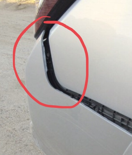

I have a similar problem, but not as severe. I had a little bump and the section popped out. I didn’t examine it closely, just pushed it back in and the area by the tire snapped into place. But the section by the tail light still protrudes a little. Does anyone know how this trim actually clips in? Any more detailed photos of the clip system? Thx.

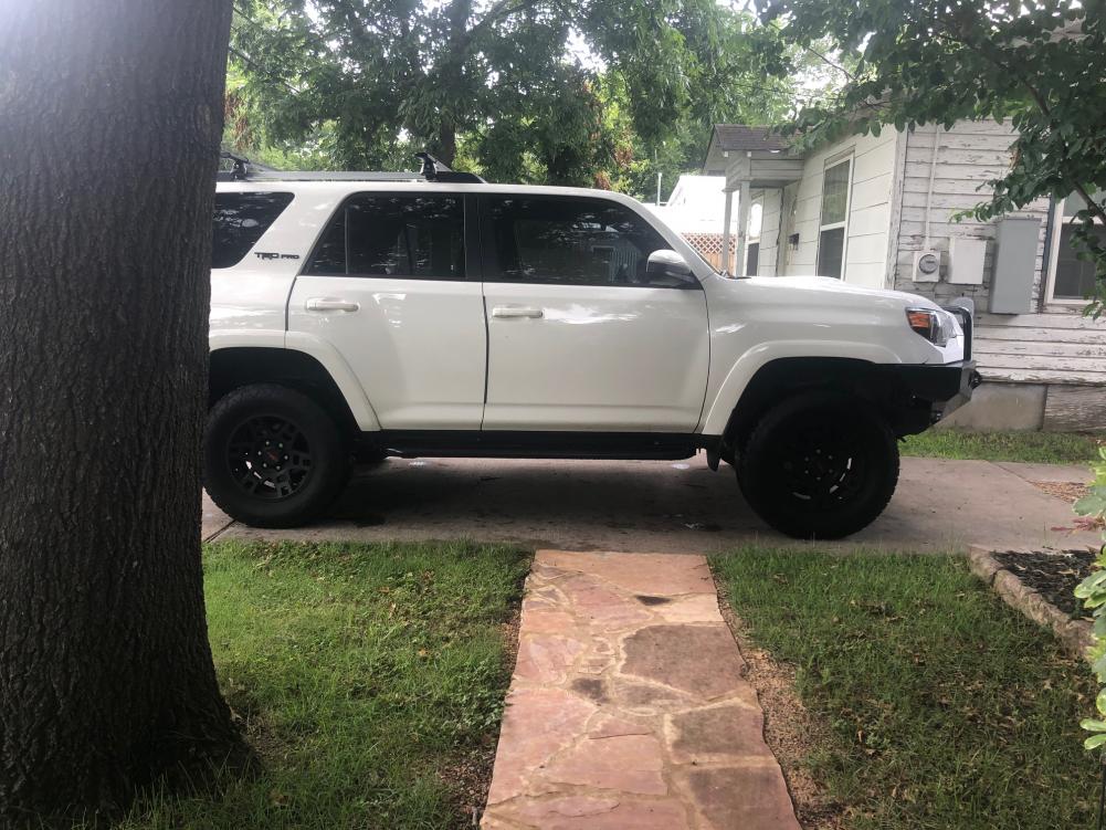

Hey everyone. So, longtime lurker but I read lots of your posts and have picked up tons of hints and mods. I appreciate all of you.
So I installed an Icon Stage 2 lift in my Silver 2016 Trail Premium with KDSS. I also installed a one inch body lift. This is almost the same route I took with my 2000 4Runner although I had added the Toyota supercharger and a bunch of URD mods. I kept that truck for 16 years and hated seeing it leave my driveway. I do, however, love my 5th gen. Finally had my 295/70/17 Nitto Ridge Grapplers and Icon Rebound wheels installed and an alignment performed. Previous to this, I did do a body mount chop moved the front inner fender liners forward, removed the front mud guards and trimmed the front fenders inside the wheel wells just a bit. They got my truck all aligned at 4.30 caster and it drives just awesome. I was a bit worried about rubbing but to my surprise I have had absolutely zero rub on road (and I have tried like hell in forward and reverse with the wheel locked). Keep in mind I have not taken the truck off road yet and I do assume when stuffed, I will get some rubbing but with 295s I couldn't be happier with the road manners and lack of rubbing. The Nittos, for being fairly aggressive are surprisingly quiet on road.
So, as far as KDSS. I have read everything I could about lifting a 5th gen with it. I did, and you absolutely can install the front coilovers without disconnecting the KDSS at all. I did my install with jack stands, on the ground in a driveway. Driver's side was simple with some jack pressure on the opposite side under the KDSS bar. Passenger side was a bit more difficult but simply required a jack under the KDSS boot and a fat guy with a bar to wedge down the lca. I did ucas as well so those obviously should be at least disconnected.
In the rear, which was much simpler, I only disconnected the KDSS on the passenger side. Springs and shocks went in without much effort and reattaching the KDSS on one side was a piece of cake. Many ways to do the same thing. Not saying mine is the best but it certainly can be done. If you feel like disconnecting the KDSS completely in front is the better option, have at it. Just telling you how I did it.
Icon Rebound wheels are 17 x8.5 with 0 offset and 4.75in backspace. These put the 295s maybe just a tad outside the wheel wells but I think it looks great. I do think the body lift may have helped just a bit with rubbing issues but 1in is fairly easy and I like the look better.

Ok, here are some crappy pics of my dirty 4Runner:
That sliver of plastic sticking out of the bumper plastic (in the circled area) snaps into the black plastic piece attached to the rear quarter of the truck. It will make sense if you follow my instructions.
That particular tab is flimsy and if you look at it closely you will see it's bent down. Happend to me when I took mine off to run breather lines.
Undo that half the bumper to the centerline of the cargo area. That will allow you to access the tab. Do your best to bend that tab back up into place. Then working from the centerline of the cargo area to the fender start fastening the bumper down. When you get to that tab slowly help guide it into it's little slot on the fender and then you can press/snap it back in. Pop, Snap, and screw the rest of the bumper together and you're good.

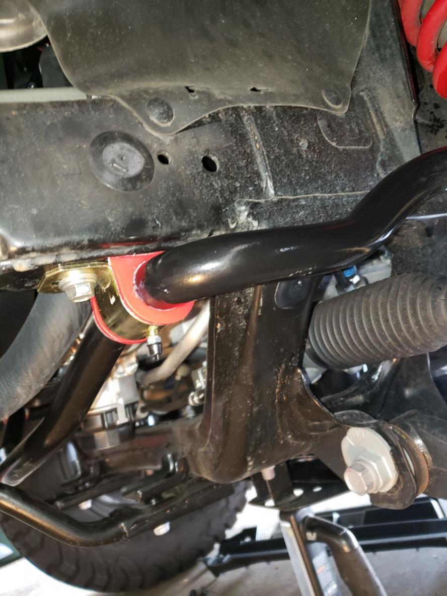

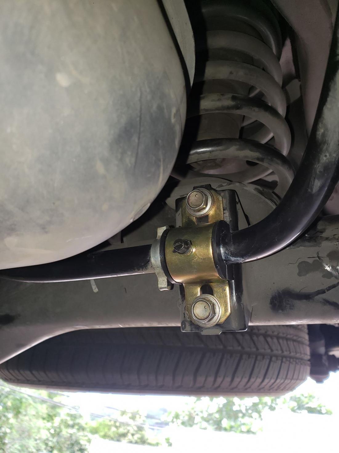

Sway bar bushing upgrade and TRD CAI
Upgraded to greaseable Poly Sway Ba Bushing for front and rear and added a TRD CAI.
