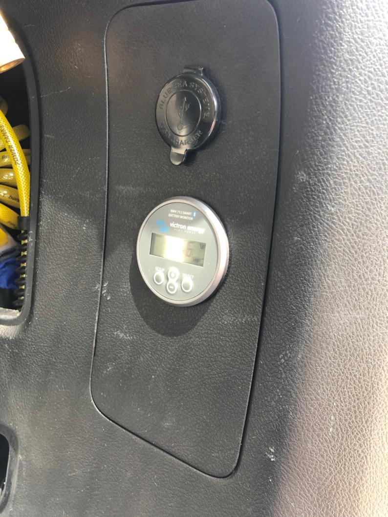

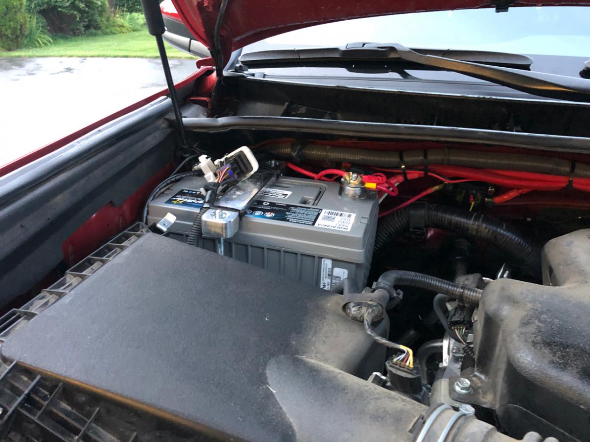

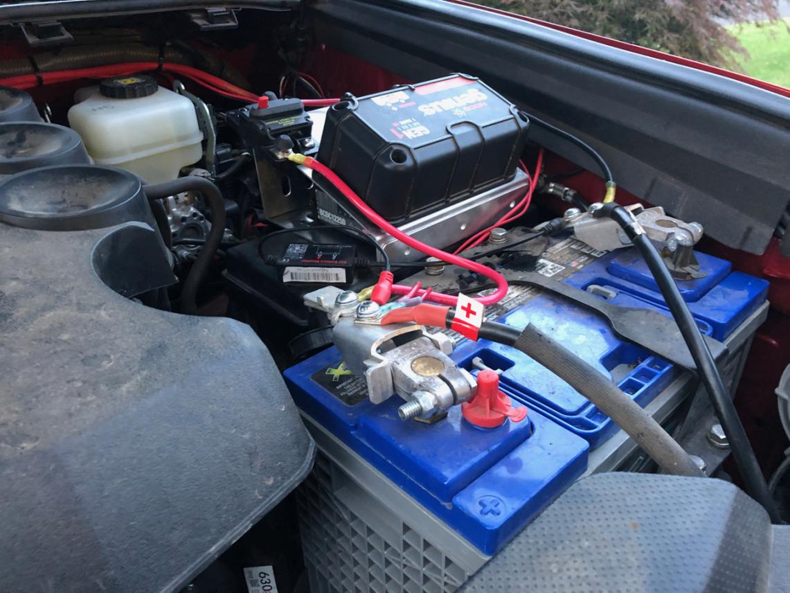

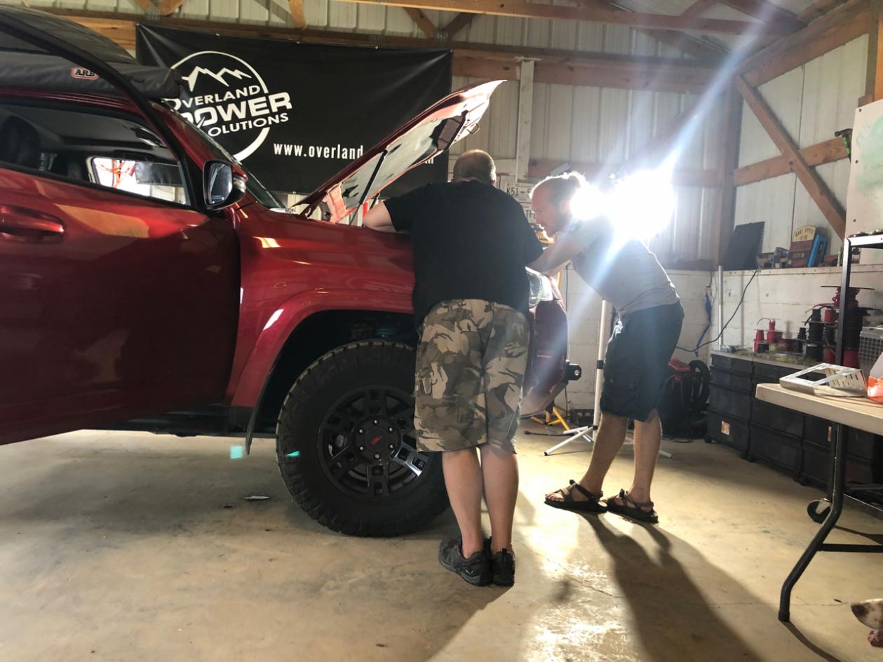

Super happy with my dual battery install from Overland Power Solutions. Too cool! Love having the options for shore power or solar. Going to use it like crazy on this huge road trip.

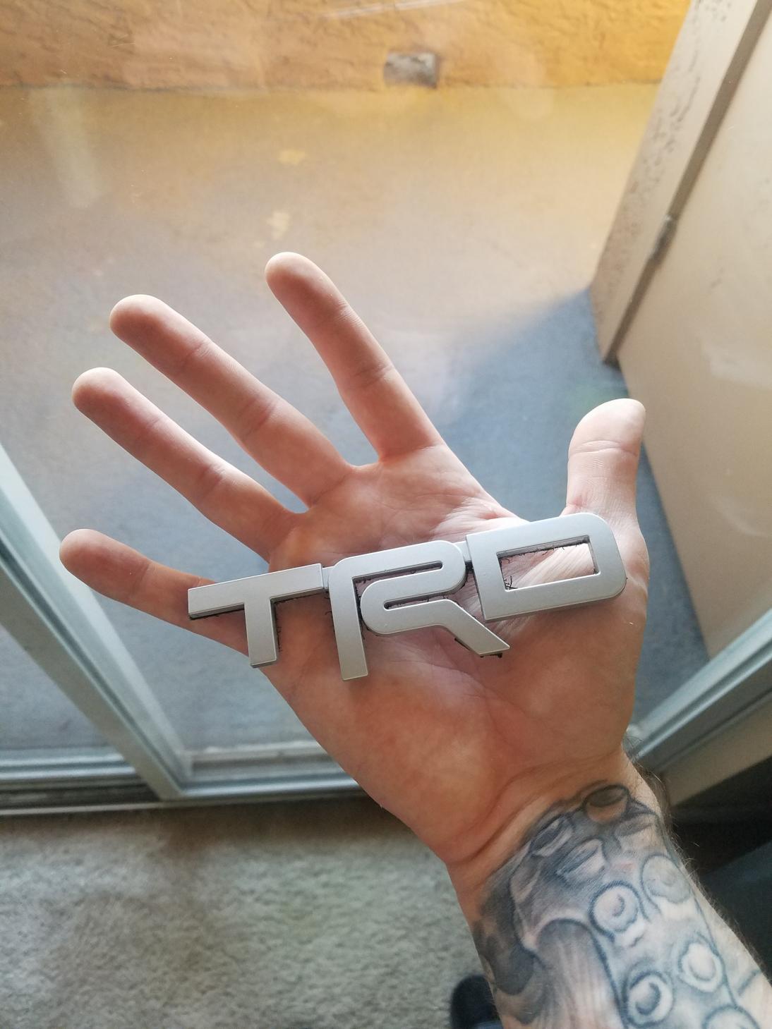

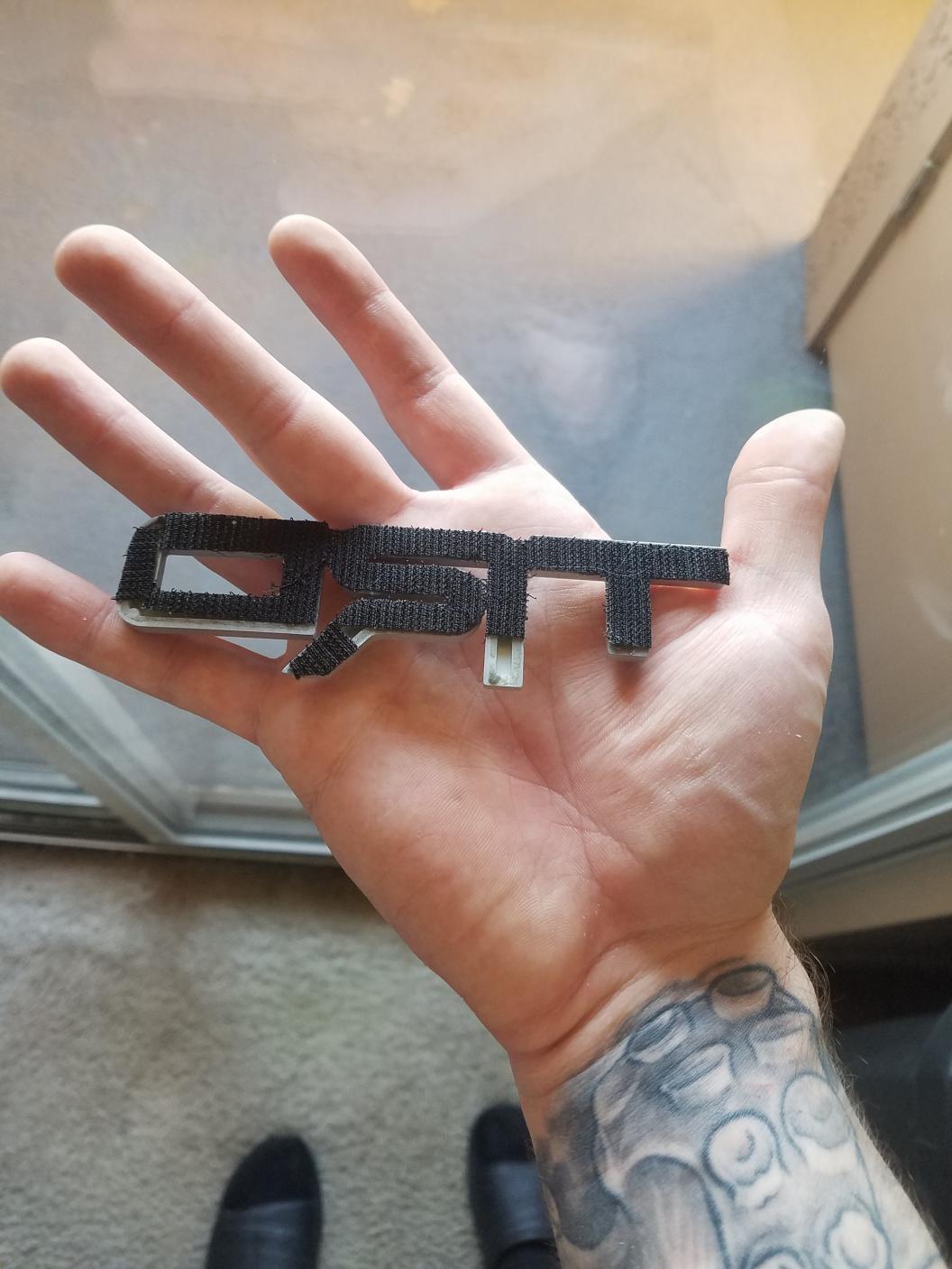

Idle hands something something...Decided to do something with the badge I held onto. Cost me nothing. Looks decent might paint it black down the road.

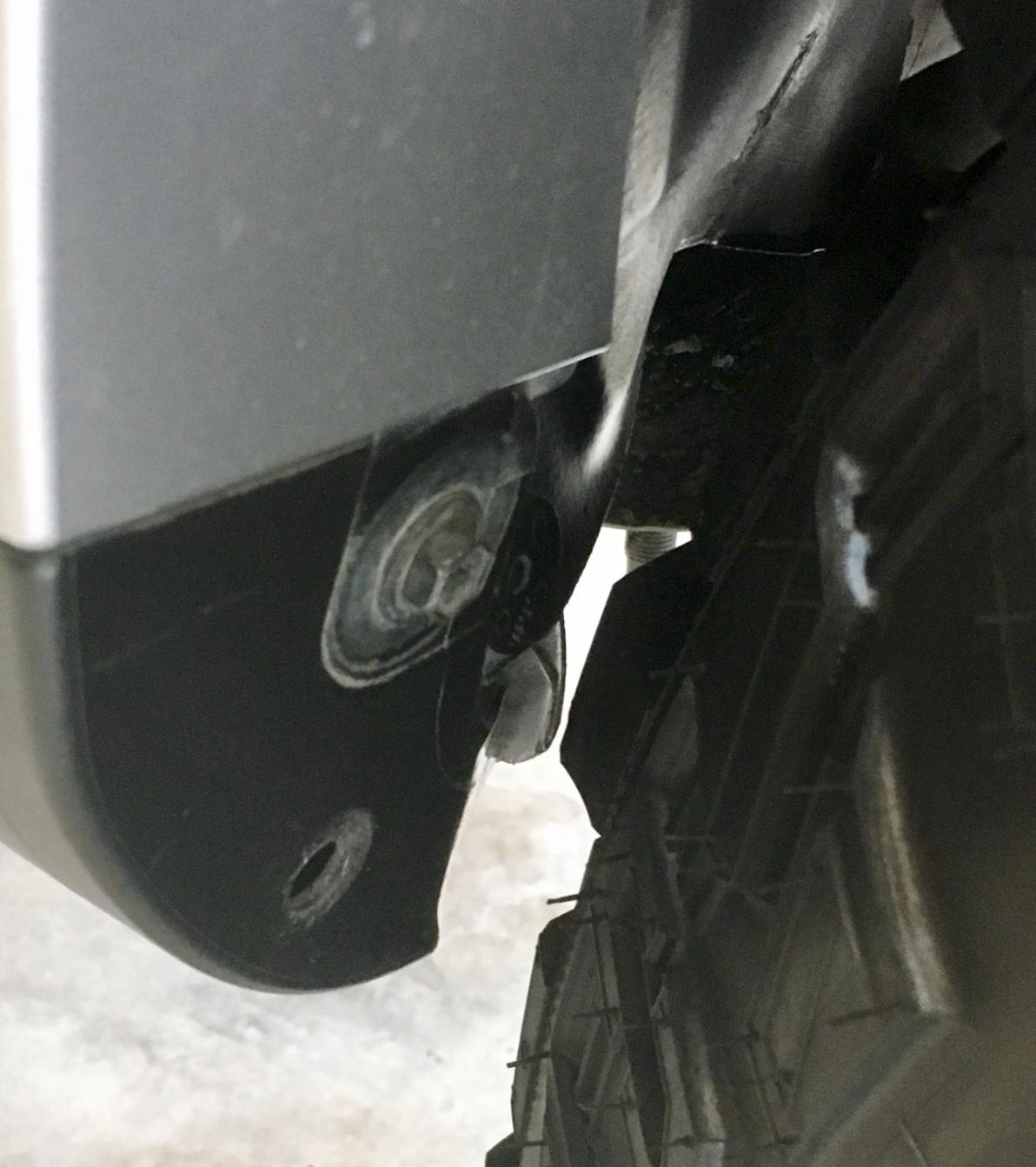

Front fender pinch weld seem
Passenger side barely rubs the pinch weld seem, trying to find the best way to go about hammering it flat. From what I read it’s best to hammer to the outside, gives you more space... Debating on doing the whole seem or just the first 5”...
And it only rubs in revers at almost full turn to the right.

What are your wheel and tire specs? Wondering how big I can go before I run into this as well.

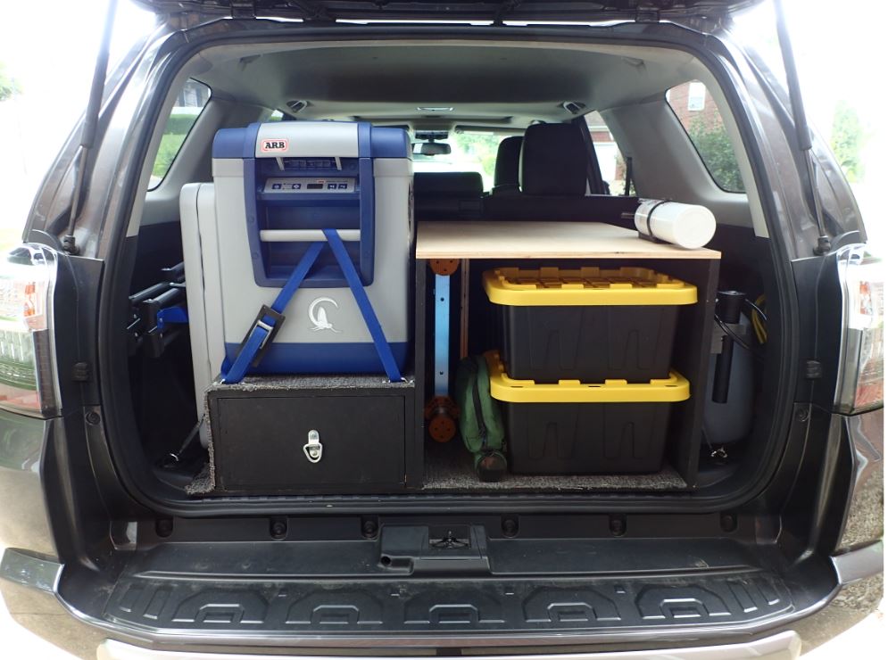

I re-worked my rear storage.
Basically I made the right-hand sides taller to accommodate the ladder I use with my RTT. I'll drive it fully loaded for a few days, and if no issues, pull it back out for painting.

Pro Comp series 40 17x9 -6 offset, 285x70r17 Cooper STT PRO’s and I have BORA custom 106mm inner bore to 108mm outer bore hub 1.25” spacers to clear the JBA HD UCA’s.

Whats your set up? Lift? Wheels? Tires? Caster?
Caster is unknown
And it’s got a 3” front 2” rear lift

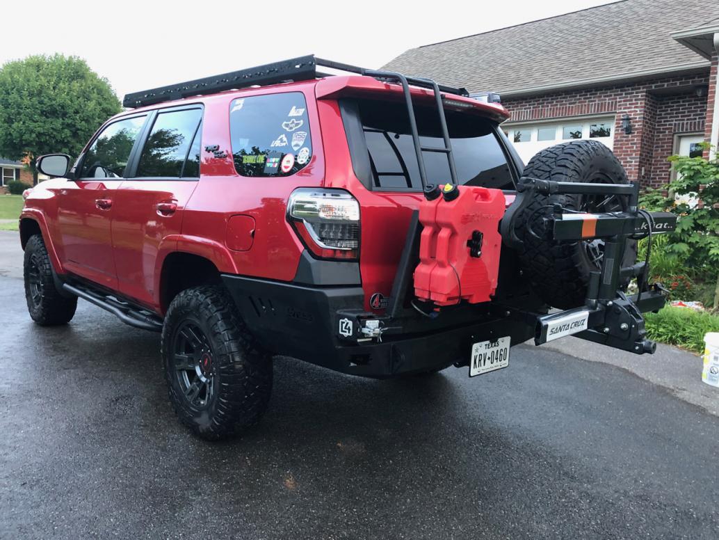

Got myself a matching wheel and tire for a new spare.
Thanks for the offer, I already have a 5th TRD Pro Wheel for the spare, it is on the swingout now. That pic was taken the day I picked it up from the previous owner.
