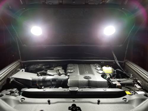

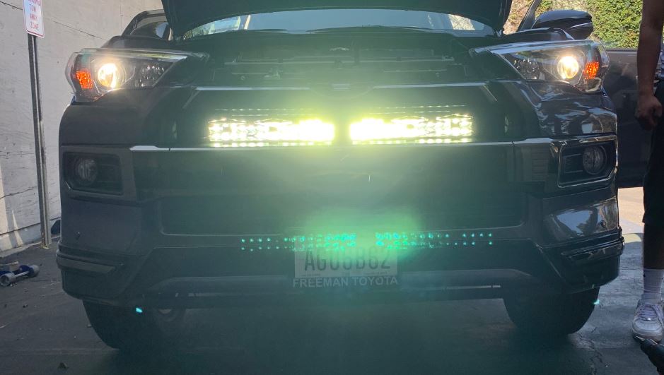

KC Hilites - under hood install
Cheating as I did this a couple of days ago...
Installed KC Hilites under the hood. These are a lot brighter than I thought they'd be - as much or more light as the dense LED light strip I did on my 3rd gen a month or so ago.
The kit was expensive ($80 @ Amazon), but everything comes with the kit for the complete job - 2 lights, metal screws, wiring that is plenty long, loom, switch and switch mount. Warranty is either 23 years or lifetime - can't recall what I read.
I ended up not using the packaged metal screws to mount the lights. I almost welded nuts into place on the underside hood metal support pieces to bolt into, but the truck was just too new to start welding on it... So I ended up tying some string to a bolt and pulled the bolt up the inside of the hood pieces to get it sticking through the hole into the pyramid shaped forms in the underside insulation (see pic below). Then attached the corresponding bolt in the doughnut hole of the light to hold the light in place.
Total install took about 1 hour of screwing around with the insulation removal (only broke 1) before learning how to remove the plastic posts correctly, 45 minutes of thinking through how to get the cleanest look and about 2 hours of actual install.
I'm not done routing the cabling in its final path - going to think about that for a few days while I also think about other power distribution under the hood.
I'm happy with the KC product. Everything it came with looked to be high quality and the various tube shrink and connectors we well done. In a few weeks after I've forgotten that I spent $80 instead of $15 (cheaper strip light), I'll like it even more.

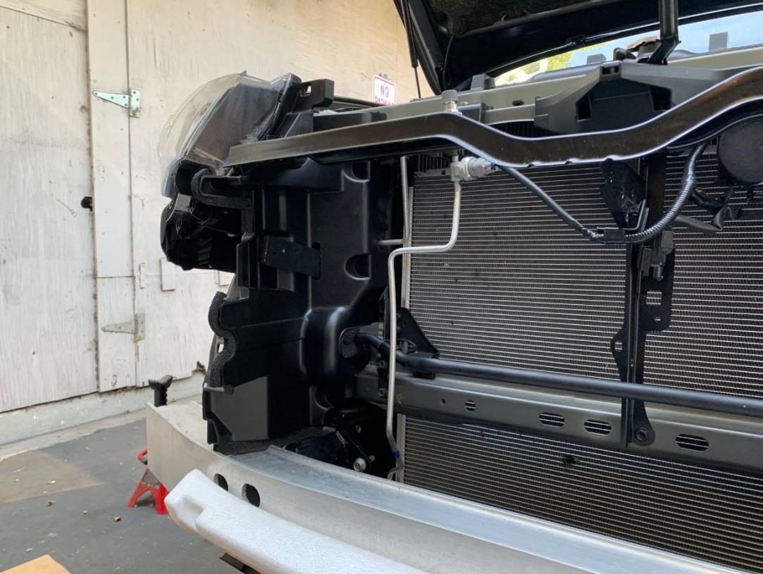

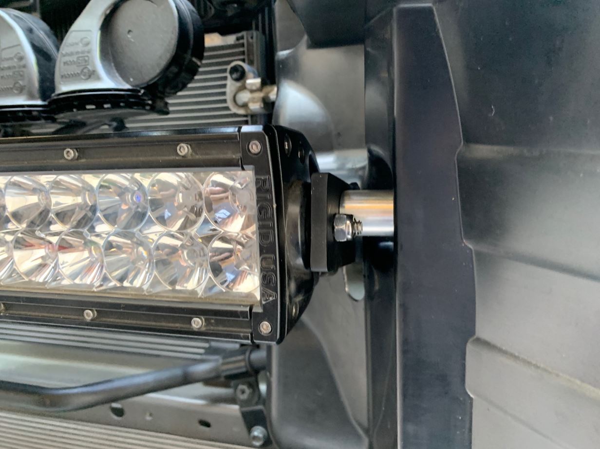

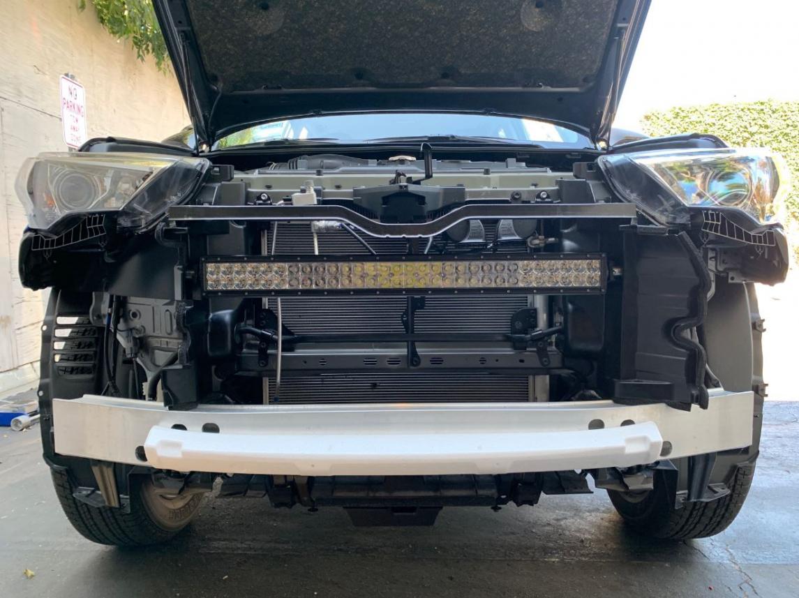

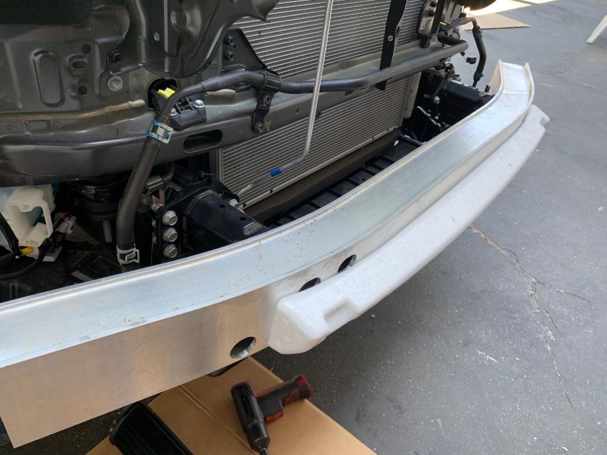

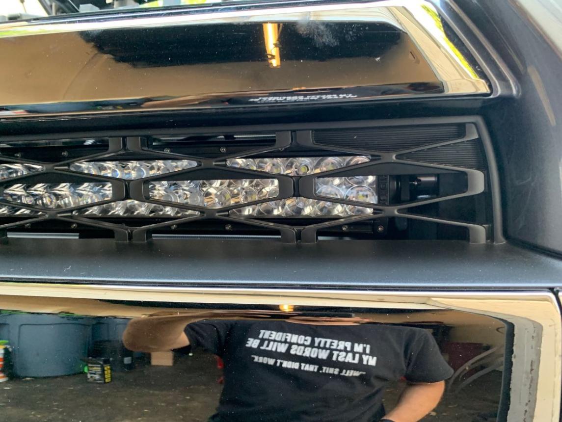

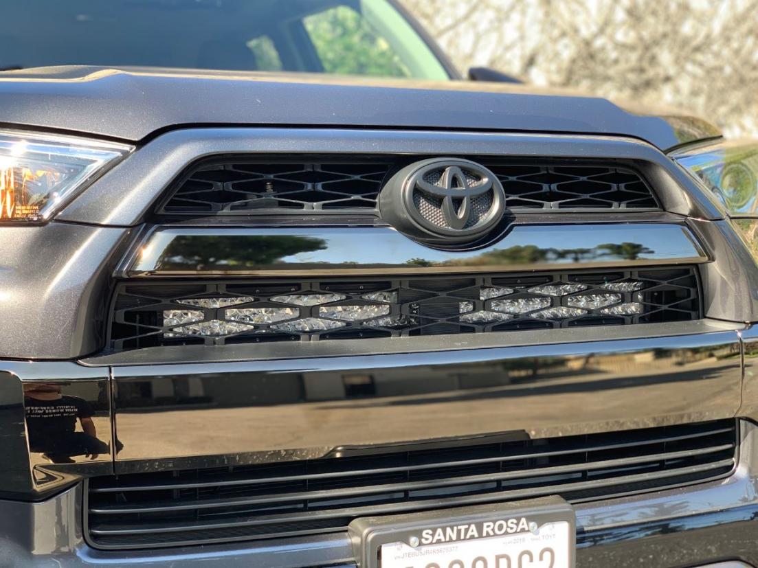

Got my Rigid 30" light bar installed today. I ordered the Rago Fab mounts thinking the only mod I'd have to do is to make an extension to raise the light bar for the Limited bumper.
Sadly, the Limited front end is even more different than I expected and doesn't have the same bumper support the other models do and there's no bolts so there was literally no place to mount the brackets without drilling into metal. OK. That sucks, but I don't give up that easily. So I measured everything up and found a fairly straightforward solution. I made it all out of some materials I had around the shop: brackets from 1/4" steel plate and standoffs from 3/4" aluminum bar.
Because I was going to be using the holes the plastic deflectors normally mount to with the plastic rivets to mount the brackets, I put shoulders on the front standoffs to anchor them and the wind deflectors to the upper grille supports and opened up the mounting holes in the deflectors to give me some extra surface contact. Mounted it all up and I'm pretty happy.
Sorry I didn't take more detail pictures as I was working. This is my first how-to/whatever.
End result: Perfect fit, super rigid, crazy simple setup, maybe three or four bucks in materials.
More pics in reply

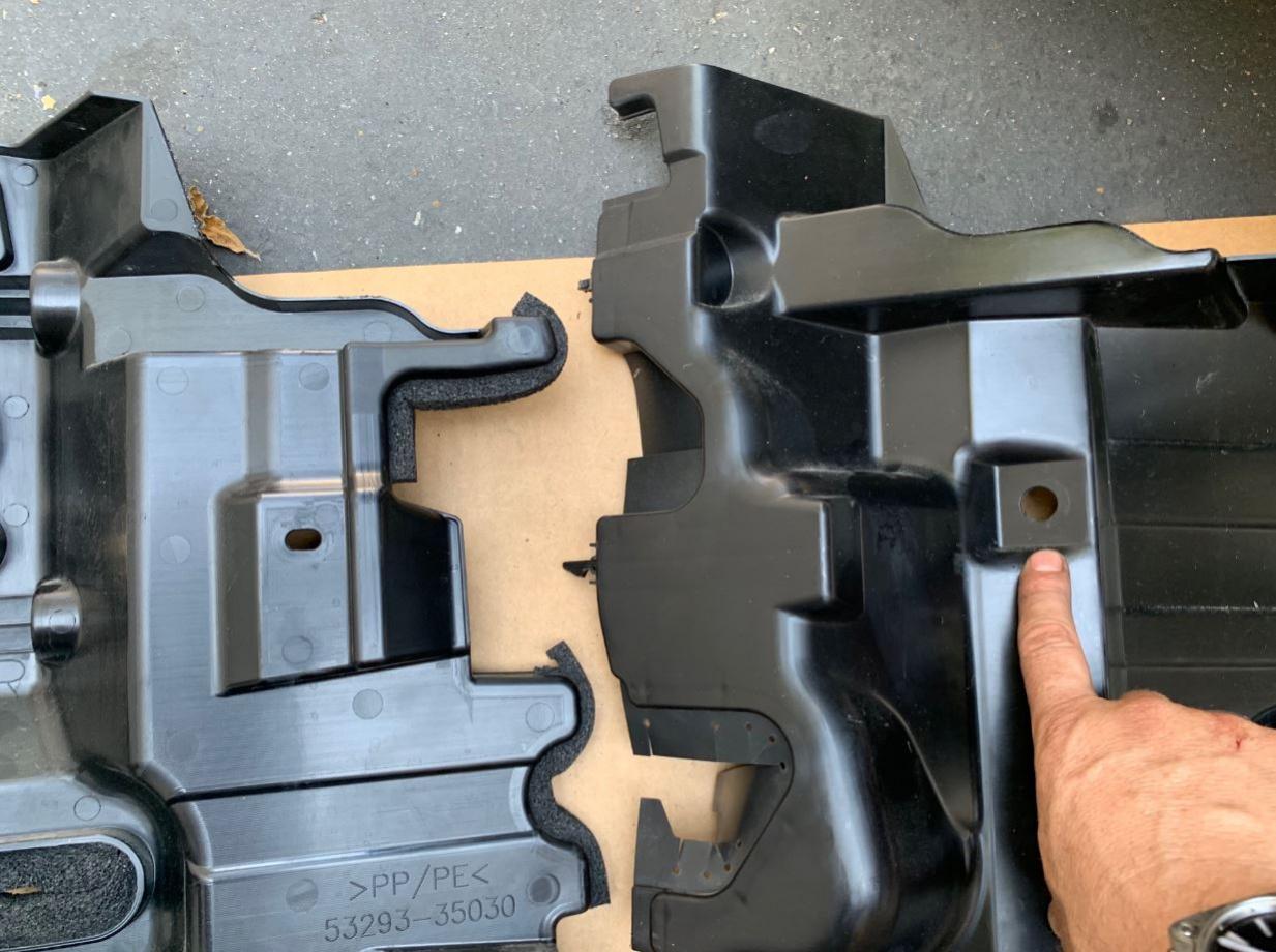

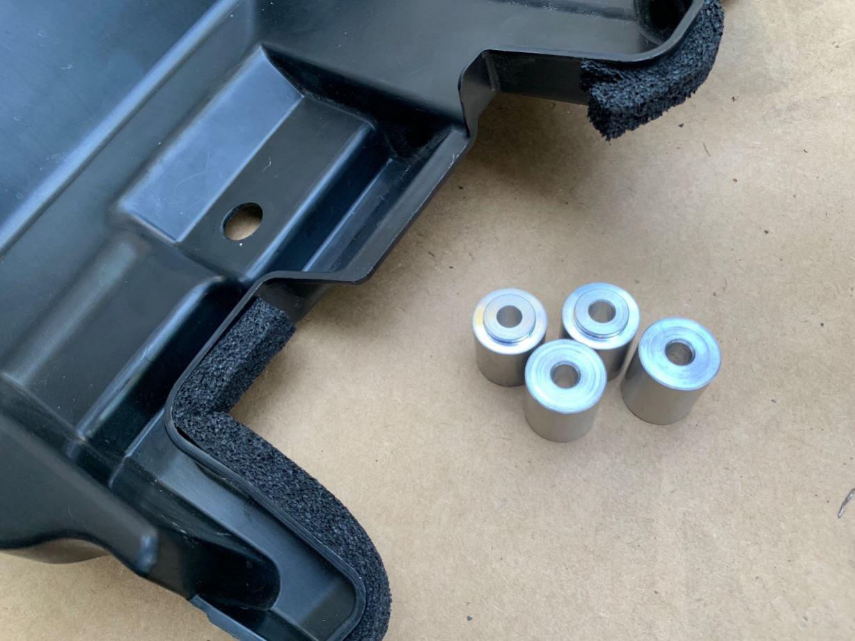

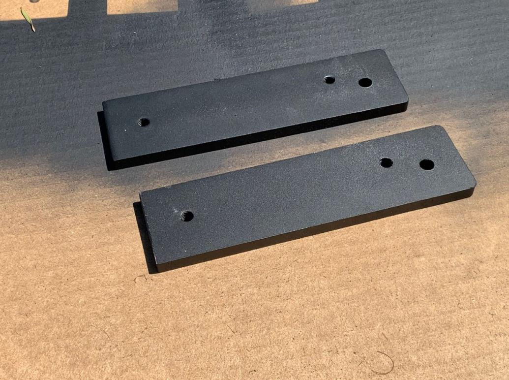

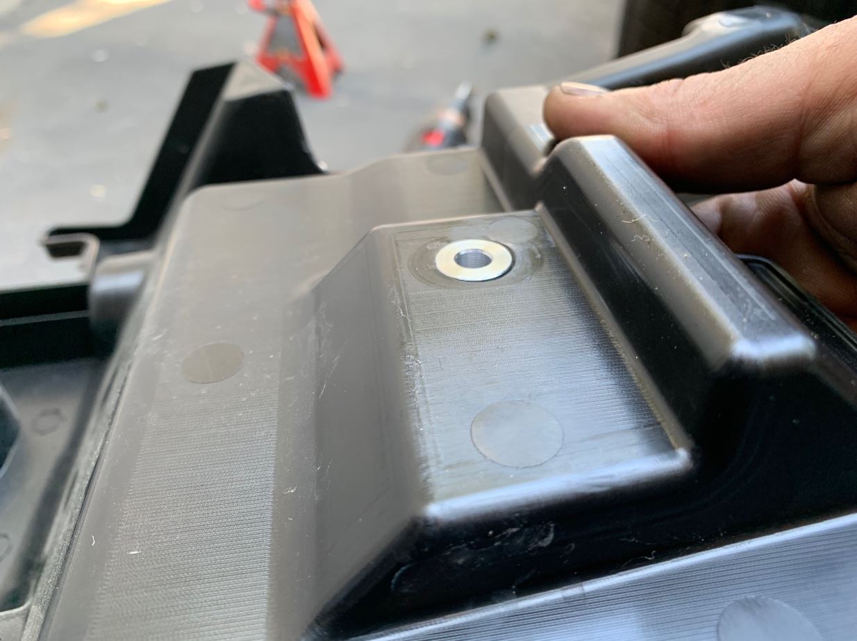

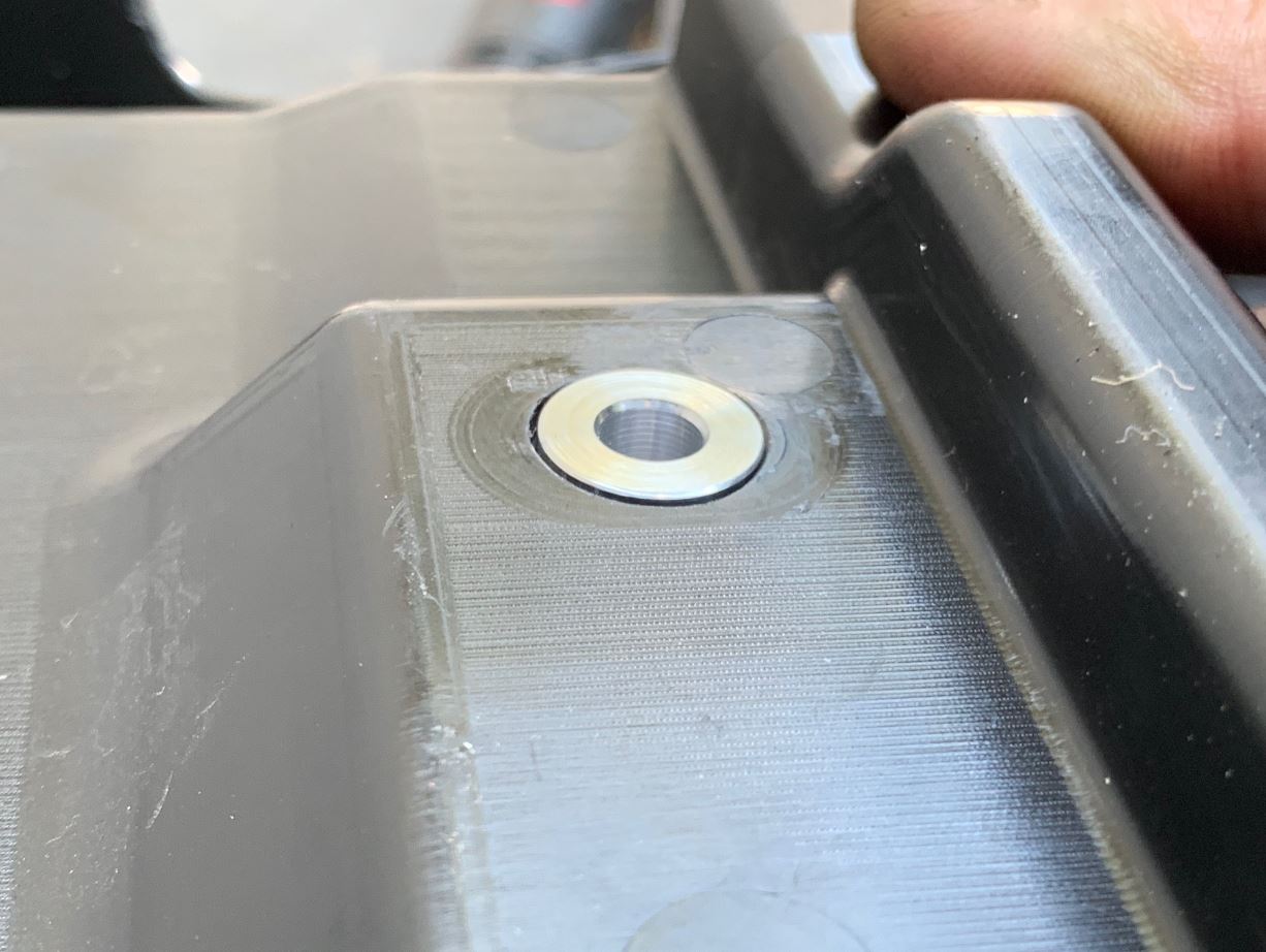

And the brackets/spacers and how they fit into the deflectors. The first shows the stock rivet slot compared to the one opened with a step drill. Then some pics of the standoffs, and lastly the side plates.
I didn't take pics of the slots I cut in the wind deflector plates for the brackets to pass through, but you can see it in the second to last pic in the first post and they help keep everything as stock as possible.
Sadly, the Limited front end is even more different than I expected and doesn't have the same bumper support the other models do and there's no bolts so there was literally no place to mount the brackets. OK. That sucks, but I don't give up that easily. So I measured everything up and found a fairly straightforward solution. I made it all out of some materials I had around the shop: brackets from 1/4" steel plate and standoffs from 3/4" aluminum bar.
Because I was going to be mounting the brackets to the holes the plastic deflectors normally mount to with the plastic rivets, I put shoulders on the front standoffs to anchor them and opened up the holes in the deflectors to give me some extra surface contact. Mounted it all up and I'm pretty happy.
More pics in reply
More pics in reply
Kudos to you for putting together a proper solution instead of jury-rigging it! I see a lot of drywall screws and Simpsons brackets on these pages too often... :doh:
