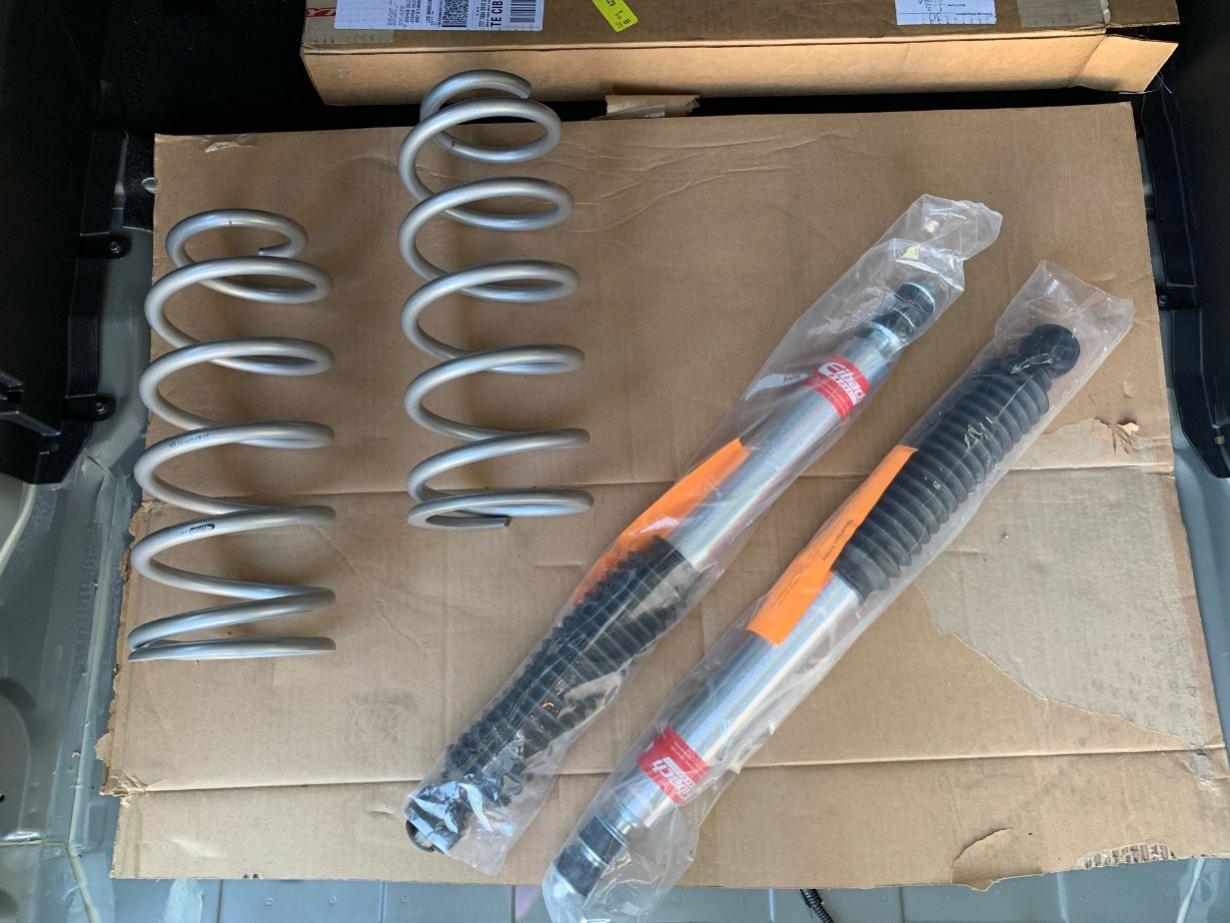

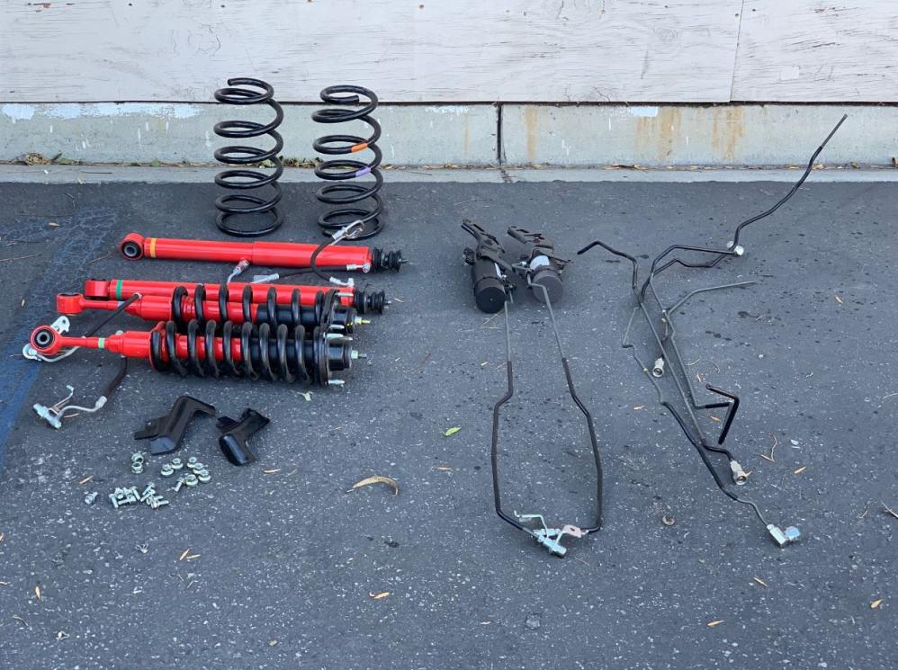

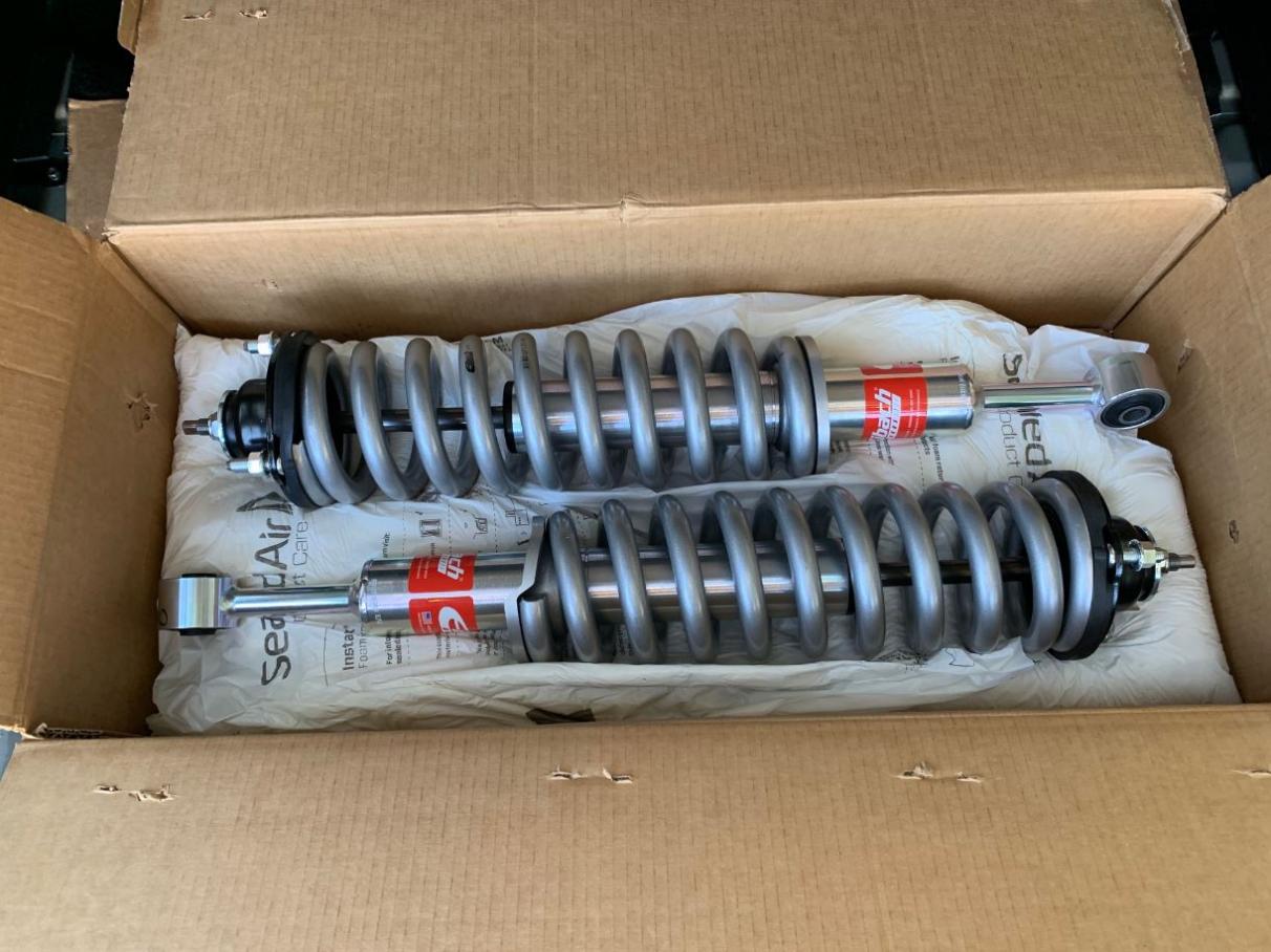

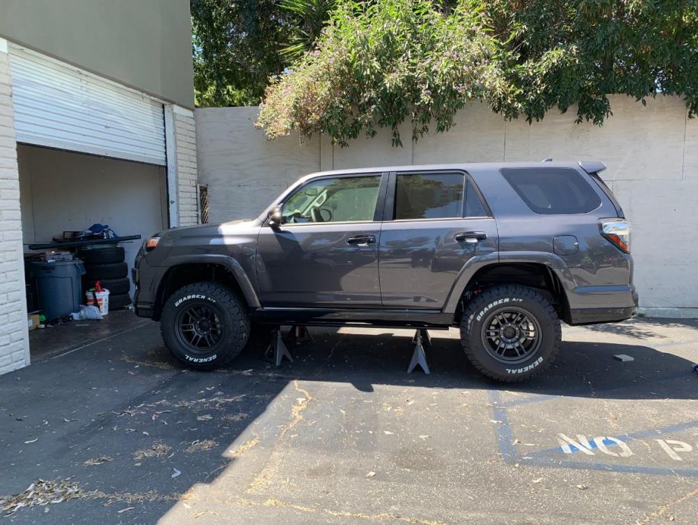

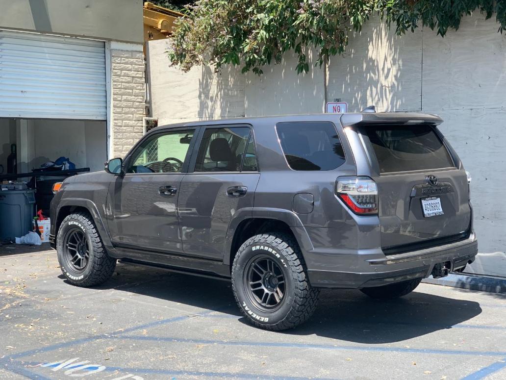

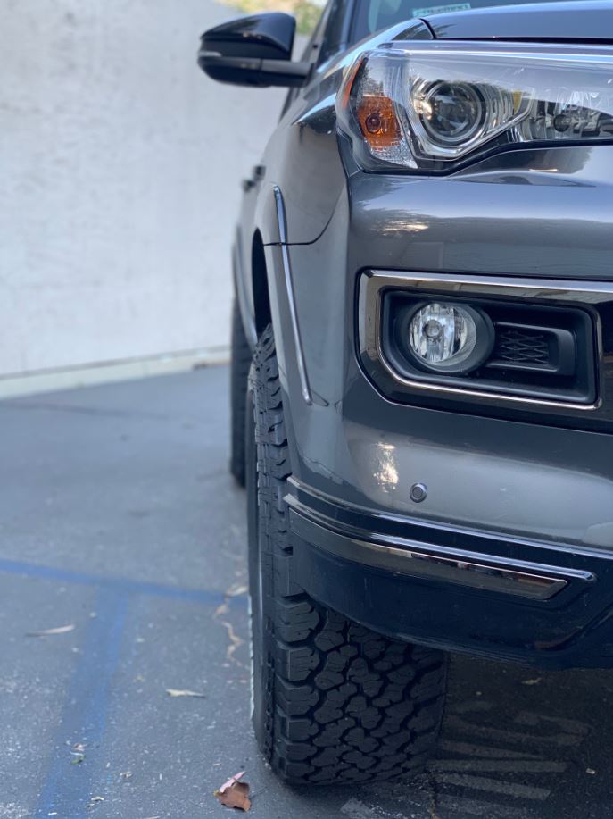

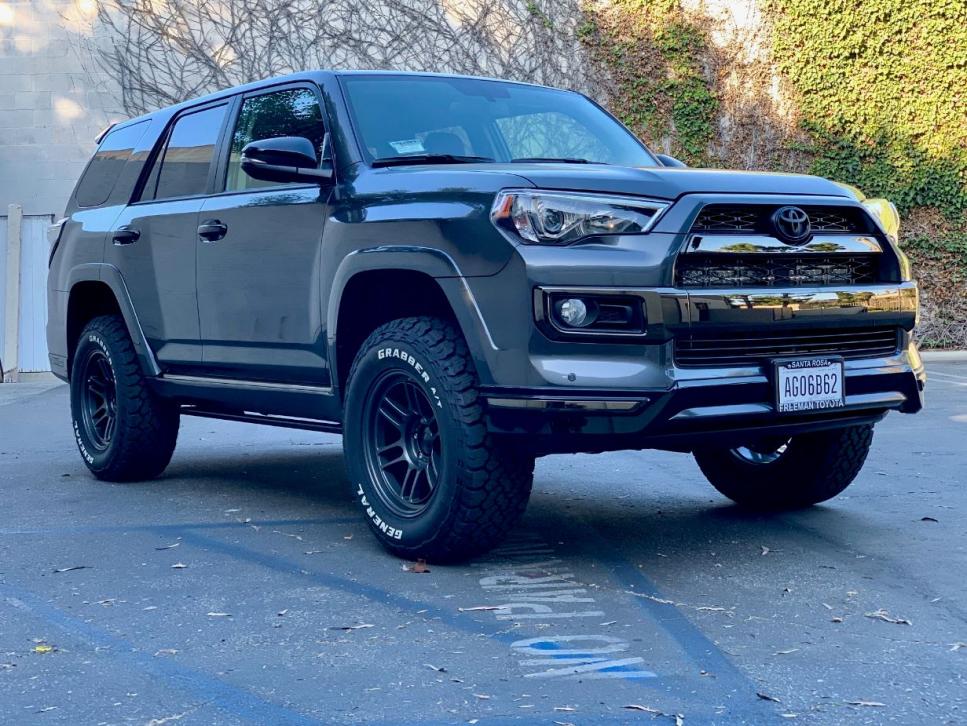

I got my Eibach Pro Truck kit from Toytec today. Had fun installing it. It took a few hours working pretty casually.
Removing the XREAS is pretty straightforward if you have the right tools. I did have to cut the front lines to get them out, but the rest of it was a piece of cake.
Pretty stoked on the results and I'll post more pics tomorrow after I get it aligned.
Pics before, during, and after:

Looks good. How much lift did you get and how is the ride?
Also, what rims are those?
Thanks
Thanks
Thanks man! I got around 2.5 front and 1.25-1.5 rear. It looks like the rear settles with these kits so I'm waiting to see where it ends up. I was hoping for fully level, but I'm happy with it. I normally have a pretty stout bike rack hanging off the back and that'll probably help drop it once it's back on. So far I've only driven the seven miles back from my shop, but the roads in Inglewood are pretty patchy and it's already obviously better than stock.
The rims are Enkei RPT1s. I saw them and fell in love. Managed to get a pretty good deal from 14TrailMike. Took a chance on the General Tires and am pretty stoked so far. Decent ride for E rated and the quietest all terrain tires I've run. Even at 85-90.

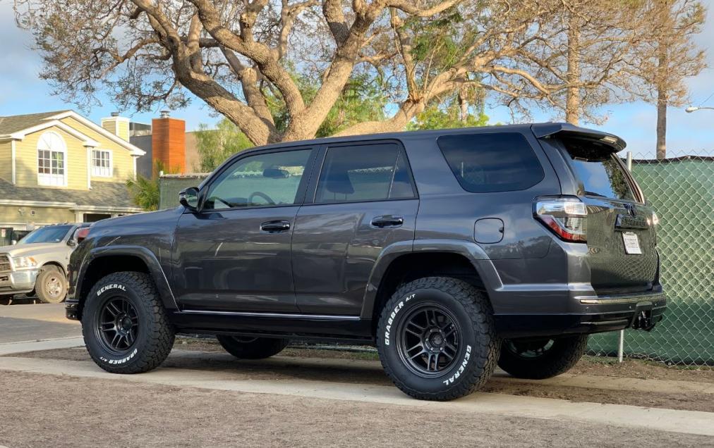

Ha, you caught me! lol I ordered SPC UCAs from Toytec like five minutes after the kit and they had a miscommunication and didn't ship them. Normally, that wouldn't have been a problem, but I paid for two day shipping because I'm going on a trip next week. Well, lemme tell you how awesome Toytec is: Anthony was super surprised, then really apologetic, then had me a tracking number for overnight shipping in like five minutes. Over. Night. That's gotta hurt your profit margin... Should be here in a couple hours and that's a quick install. Having them would have saved me some time on the front end yesterday (and a few small scratches on the shocks, lol), but I'm *THAT* kind of impatient with new hardware installs. #NoRegrets
That said, on the stock UCAs everything clears and it tracks *relatively* straight already. But I'd rather have it properly sorted, even if it doesn't absolutely need it. I'm putting in a diff drop too, even though that's not absolutely necessary either because I'd rather have everything in it's happy place instead of anywhere near maxxed out.
I'll definitely share all the alignment info as soon as I have it. And thanks for the compliment! I wasn't sure about the Limited front at first either and was planning an SR5 swap like a few people have done, but now that it's got wheels and lift, I'm really happy with the look. It doesn't have that skinny guy in a large suit feeling any more.
Also, this:

Ah so no alignment yet. Just wondering because eibach says it's not necessary and plenty of people don't install the UCA's. Nobody has given any real feedback to the ride quality and tire wear tho. I suspect it's livable for most but worth the added cost to do it. I daily drove a drift car for a while... poor tracking gets old quick.

Seems like we're on the same page about proper alignment. I can't imagine 4Runners NOT needing an alignment after a lift. The UCAs and LCAs aren't the same length, so it's kinda unpossible that the specs don't change when you're moving it up that far. I know the SPCs had mixed reviews for durability in the past, but they have more than enough adjustment and the shop I go to preps track cars so they're pretty finicky about getting it right. Aiming for 0 camber/toe and 3 deg caster to start.
