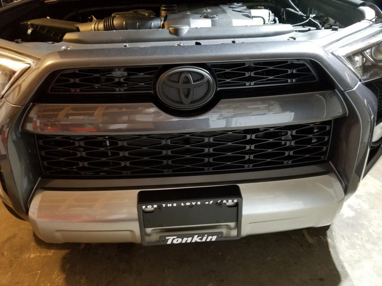

Front Emblem Blackout
I painted the front emblem a matte black.
Process:
1. Remove emblem
2. Light sanding with 220 grit paper
3. Wipe down with denatured alcohol to remove oils - no ungloved touching after this until done painting
4. Light coat with SEM plastic adhesion promoter, wait 5 minutes, wet coat with adhesion promoter
5. Wait 15 minutes (plan your next mod)
6. While waiting, put krylon fusion plastic black matte can in hot water
7. Light dusting coat of black; wait 5 minutes
8. Light coat of black; wait 5 minutes
9. Repeat step 8 6-8 times....
10. Let dry for 24 hours
Doing it this way, you won't see the emblem take on a deep black color until the 4th coat.
The outcome is very even, but a slightly rough texture. I didn't clear coat it, simply because I don't have any on hand. I'll see if the sun or elements damage it too quickly and assess what to do then.

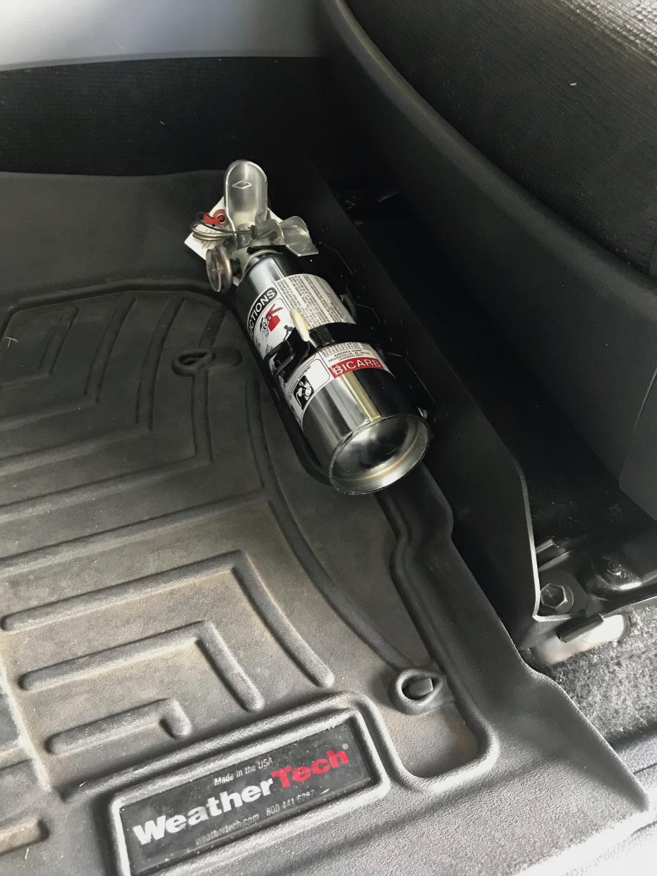

Just installed the Wits' End mount. I like it a lot. Currently I have a 1lb Amerex A620 Dry Extinguisher but I may go with a larger unit since there is a lot of space available. Well built mount with an easy install.
MB

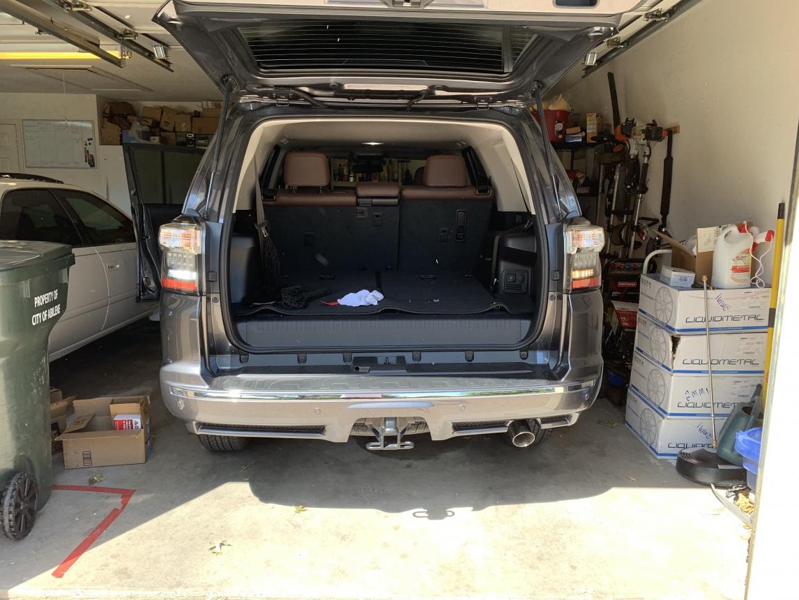

I got my Eibach Pro Truck kit from Toytec today. Had fun installing it. It took a few hours working pretty casually.
Removing the XREAS is pretty straightforward if you have the right tools. I did have to cut the front lines to get them out, but the rest of it was a piece of cake.
Pretty stoked on the results and I'll post more pics tomorrow after I get it aligned.
Pics before, during, and after:

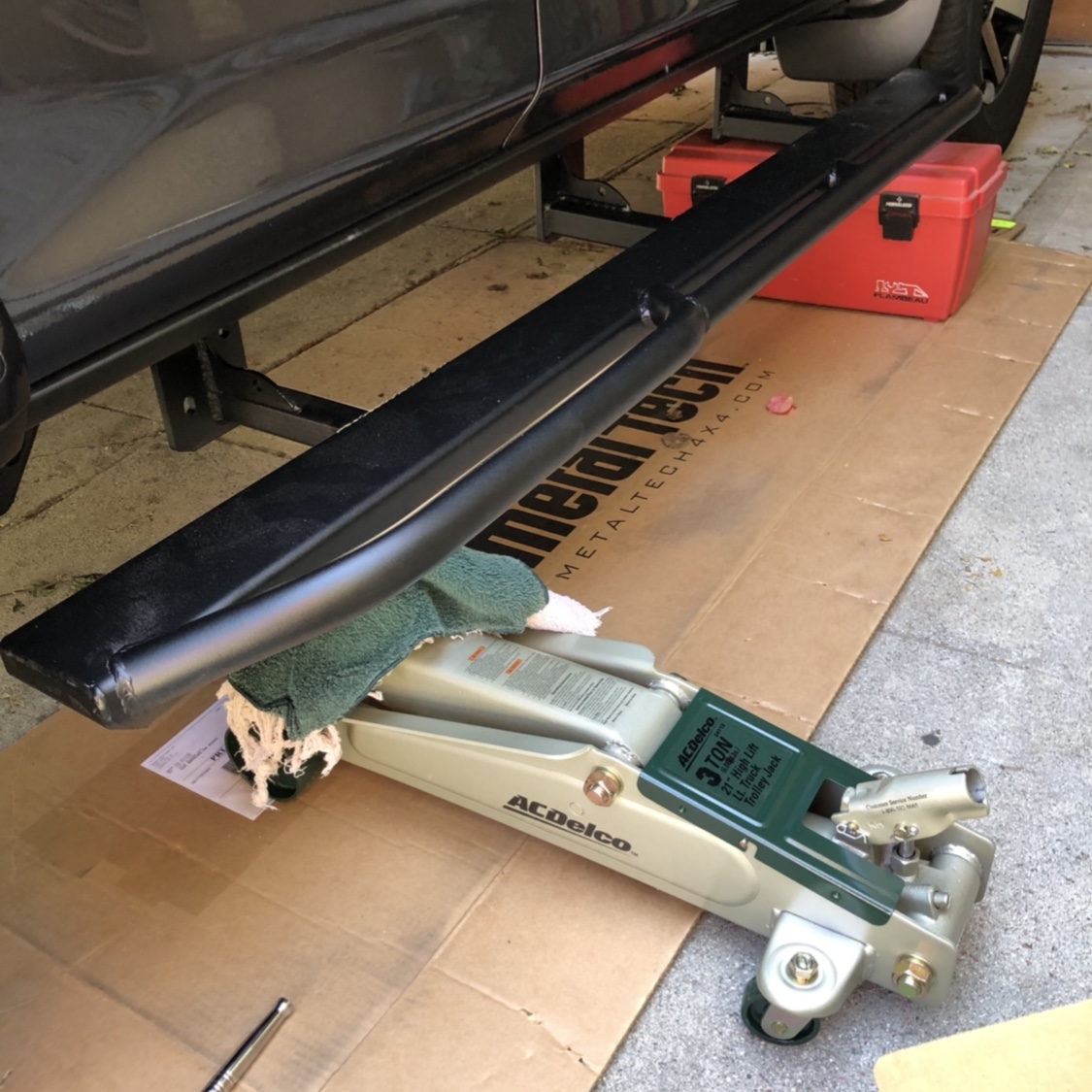

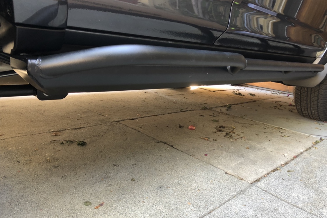

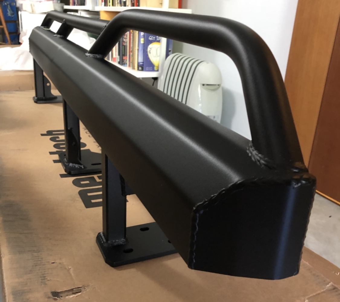

Not my first purchase but my first install. (Unless you count jdm shift knobs) Was able to do it solo using a toolbox and a floor jack. (I highly recommend this even if you've got a wingman it made it super easy to position things and take my time). It was really easy once I had the bolts in loose, to use the floor jack to position the sliders perfectly and then tighten everything down. Not that I have plans to ever take these off but I also used anti-sieze because stuck bolts suck. And a piece of the box made for a perfect work mat.
One thing I found is I needed an open end wrench for the bolt that is highest on the frame and closest to the front wheel. (too tight even for a lo-pro socket set).
It felt really good to wrench on a ride again, (something I haven't done in a very long time) I even miss the cursing and bloody knuckles. I love the results and feel a lot better about pushing things on the trails with a brand new rig and my daughter loves that she now has a "step" ;) to get into the truck. Next week the suspension & wheels go in. Will post a better of the install as soon as I take one...

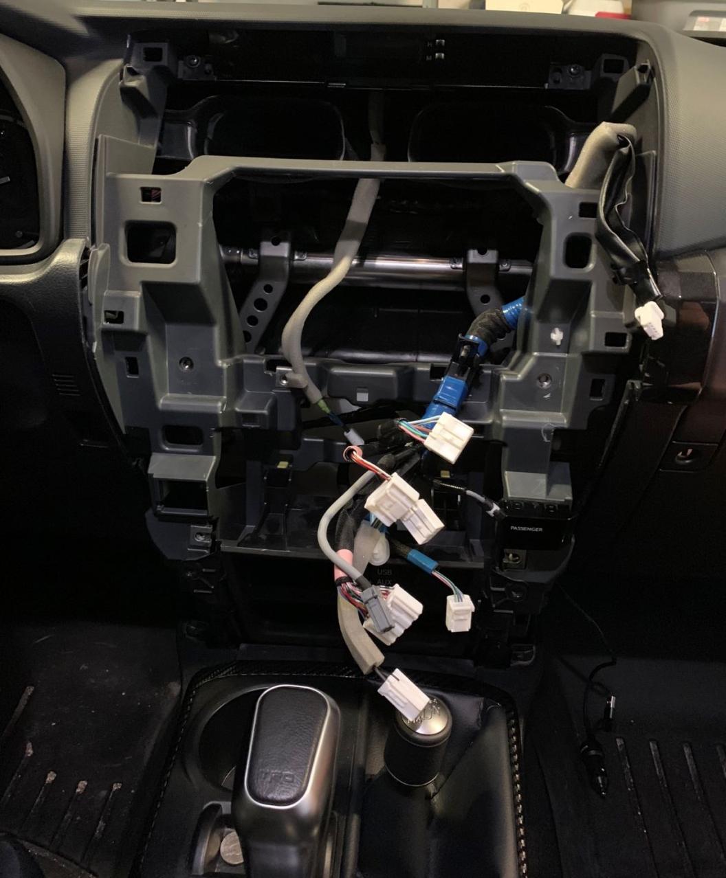

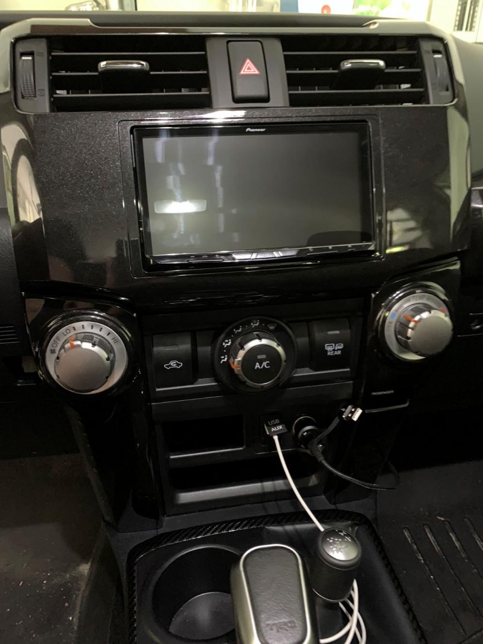

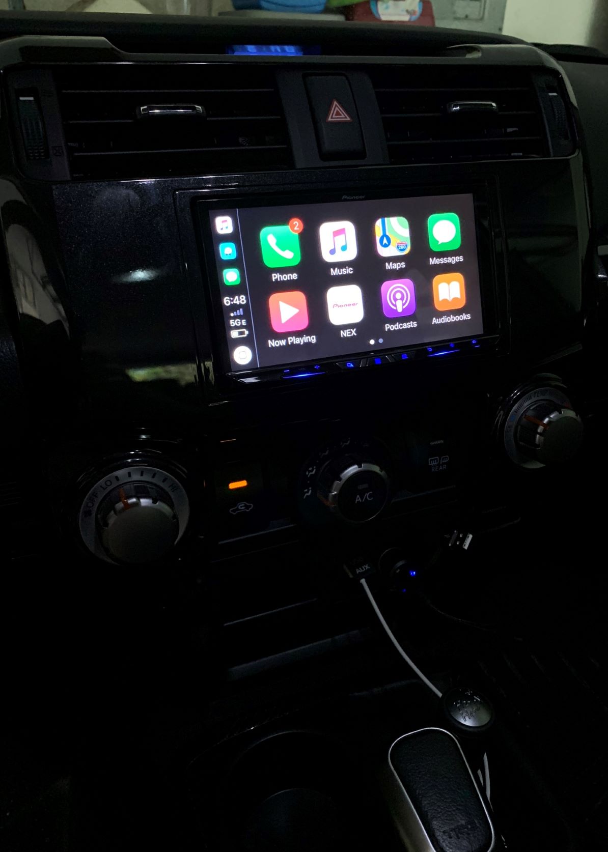

Upgraded the non JBL headunit
Tedious but gratifying when the job was done.

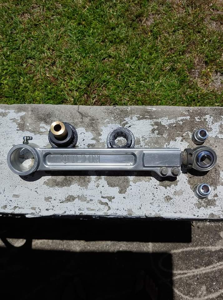

50k miles on the ICON rear links, so it's time for bushing replacements and some maintenance on the heim joints.
