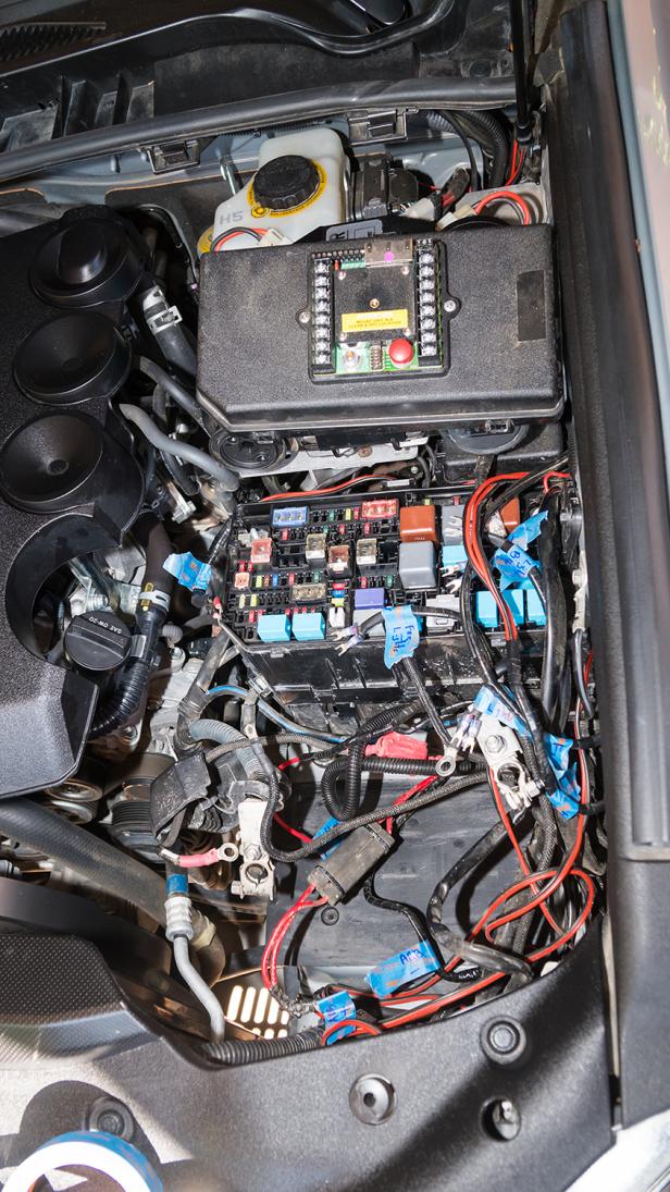

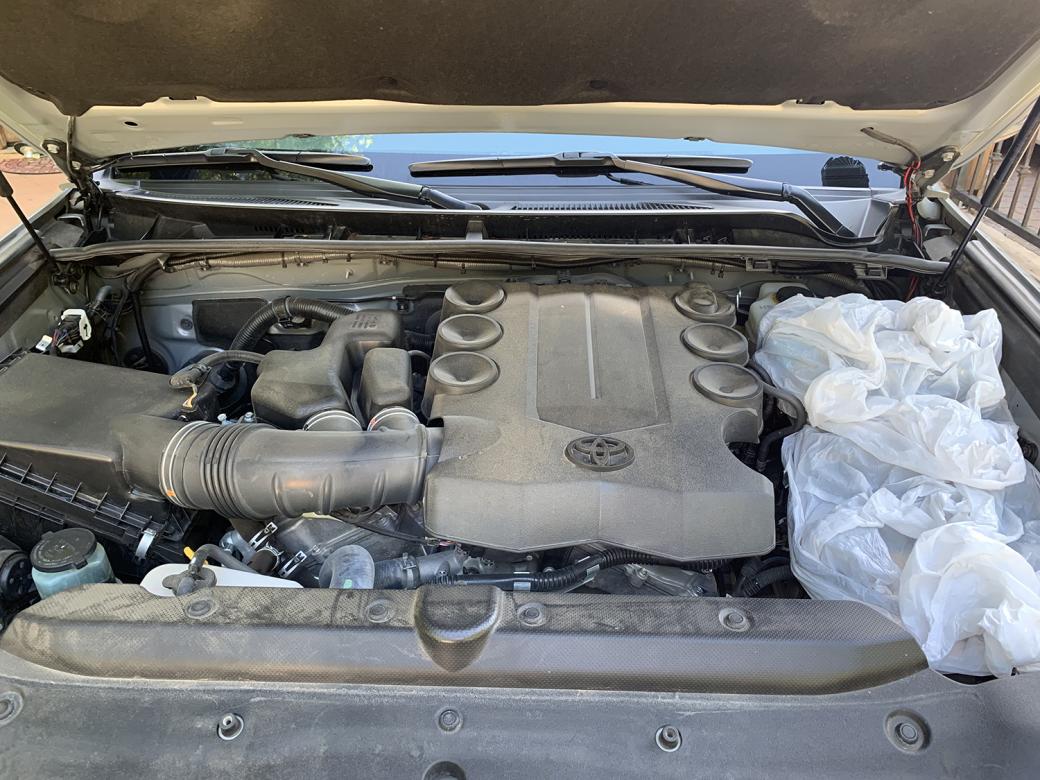

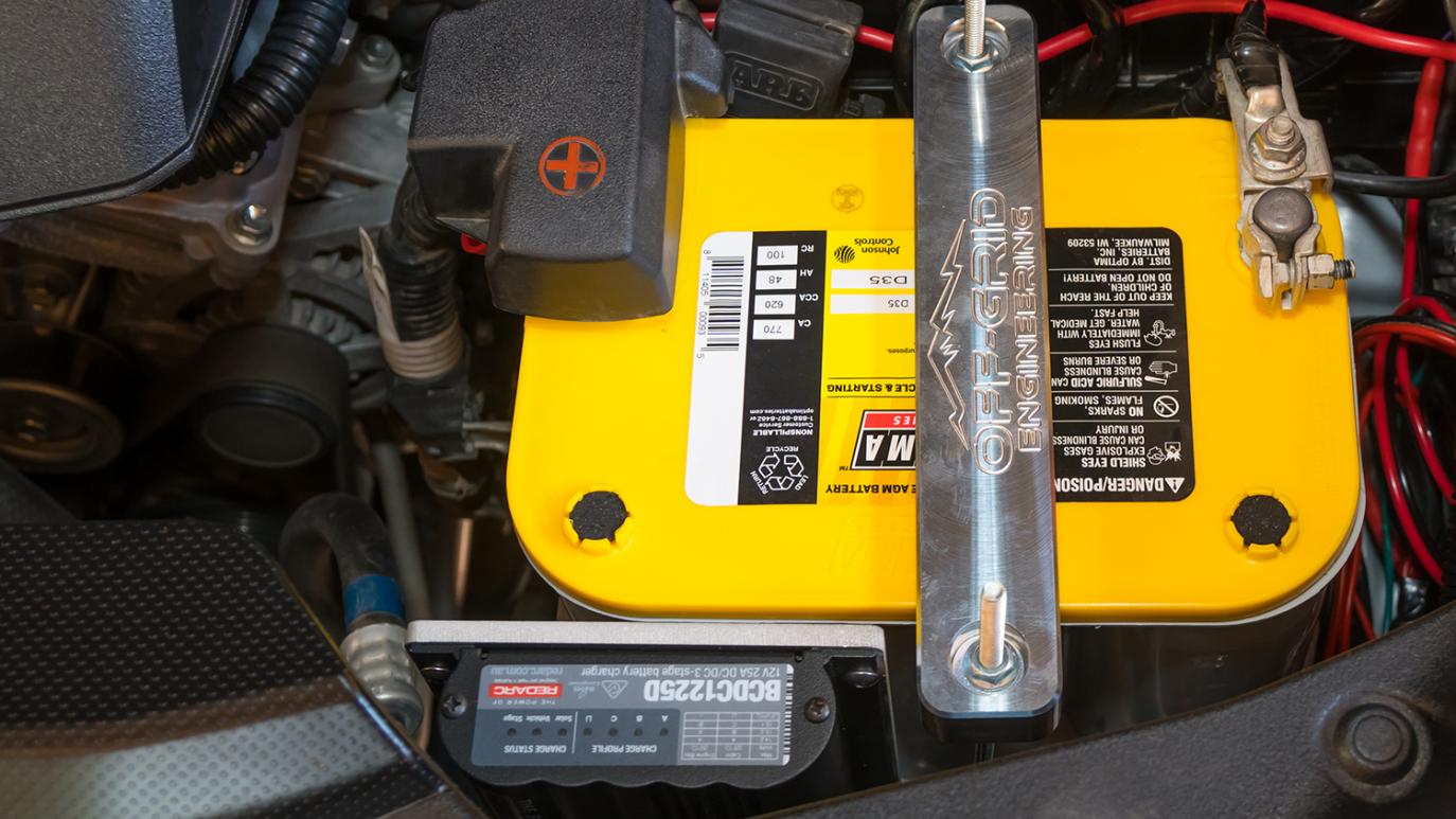

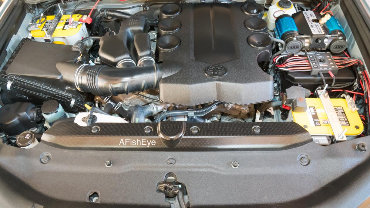

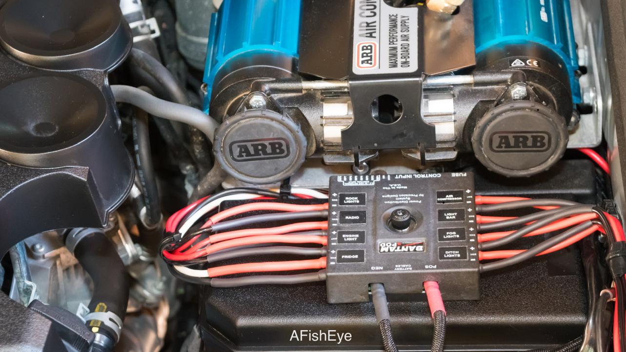

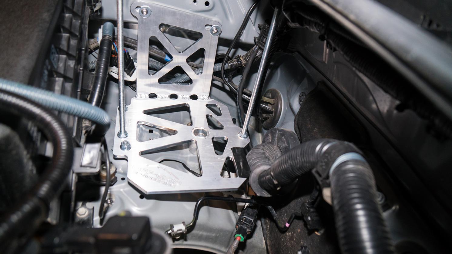

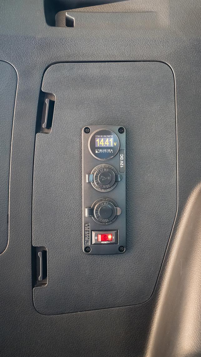

Off-Grid Engineering DC-DC Charger based Dual Battery system, sPod relocate, and power outlet back panel
1) I pay what you pay. Everything shown here was purchased with my hard earned money, no discounts, no deals.
2) Ask yourself if you need a dual battery system. If your battery did not die prematurely, you probably don’t need one. With all the stuff I run, my battery lasted less than two years.
3) DC-DC chargers in a nutshell: your smart alternator will not allow for the full charge of your auxiliary battery using a traditional solenoid based systems. Full charge of deep cycle batteries prolong their life. The Redarc BCDC1225D charger will charge the auxiliary battery to the max and also allows for the connection of unregulated solar panels directly to the DC-DC charger. If you want to also go solar, just get solar panels and you’re good to go.
4) You can do the system cheaper by purchasing bits and pieces from here and there. You are paying for two top-notch quality battery trays, one includes a mount for the DC-DC charger. Matt from Off-Road Engineering is very responsive. I couldn’t get the auxiliary tray seated and thought I had the wrong tray, Matt responded in less than ten minutes. A complete kit with quality components and good customer support made the difference for me. I also purchased the power outlets kit from him.
5) I connected my sPod to the auxiliary battery without moving it. sPod does sell a kit of long cables. I didn’t see it on their website, but if you call, they’ll direct you to it. On the 4Runner, the black (negative) cable was snug (length wise), but I made it work. The positive is long enough. Love my sPod Bantam and can see myself adding another one or two to the setup
6) Power outlets panel in the back is easy and simple to install (I connected it to the sPod). From firewall to the second row, run the cable under the floor panels (described in the forum numerous times). The last leg (from second row to the back) is time consuming so take your time. Don’t force anything, there are some thin wire looms inside the walls. No need to drill or break anything, remove the second row door weather stripping and run the cable through the crack using a metal wire as a guide. It will take quite a few attempts.
Redacted version of install:
1) Cleaned engine bay, used Maguire’s Ultimate Black for all plastics
2) Undid all wiring to date (wasn’t bad at all to begin with, just wanted to tidy up some things)

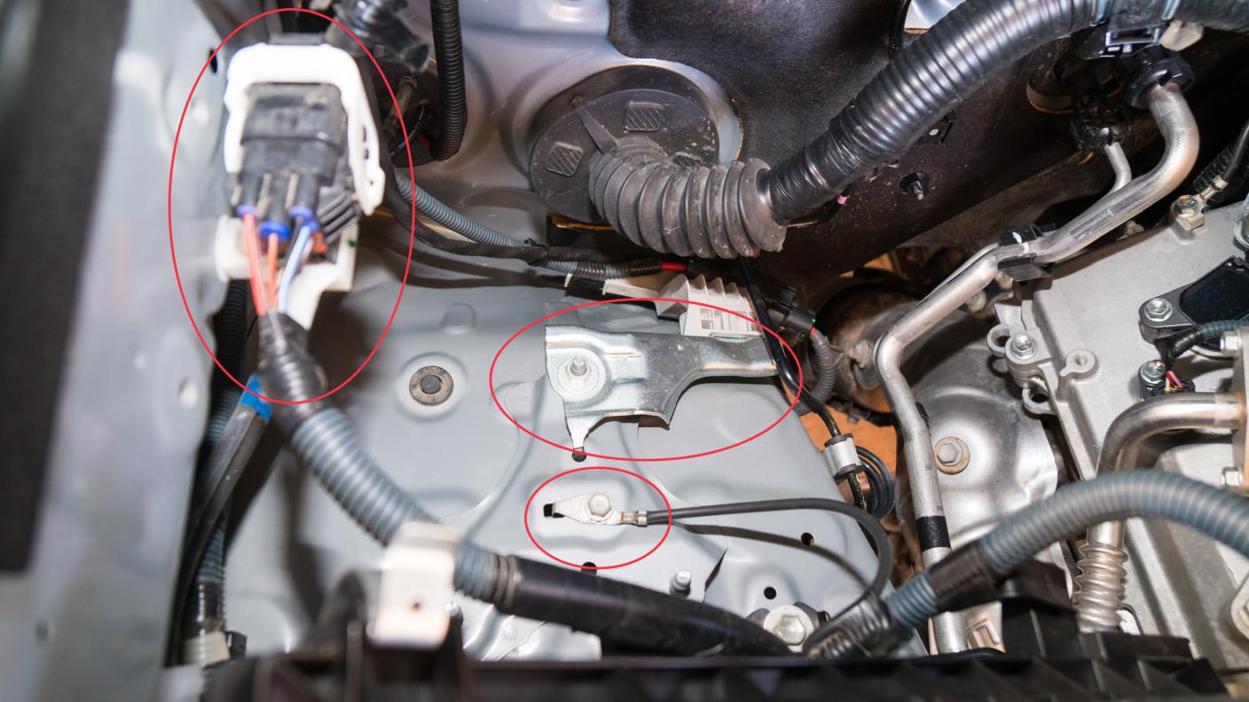

3) Specific items of interest:
a) Auxiliary battery tray install is the time consuming item. You have to relocate one ground point, remove part of a wire loom conduit, and relocate one wire loom. The large relocated wire loom has to be removed from the main loom and this will provide enough slack to place it behind the tray
b) Primary battery tray install requires that you remove the metal post that holds the wire loom in the front. Remove the post and zip tie the wire loom forward
c) Wiring the Redarc and the batteries is mighty simple, these things come with instructions
d) Power outlets panel in the back is, well, power outlets panel in the back.
I have additional images and will be happy to answer specific questions
