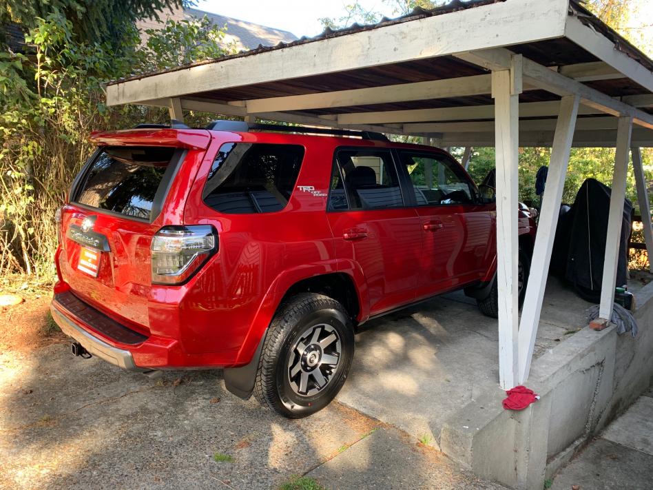

Parked my new ORP in my old, awful, (supposed to be rebuilt), carport. Also drove it...good times.
Sad part, traded in my 4th gen, overland built, go anywhere, do anything, kick ass truck. But it was silver, so I'm over it. :dance:

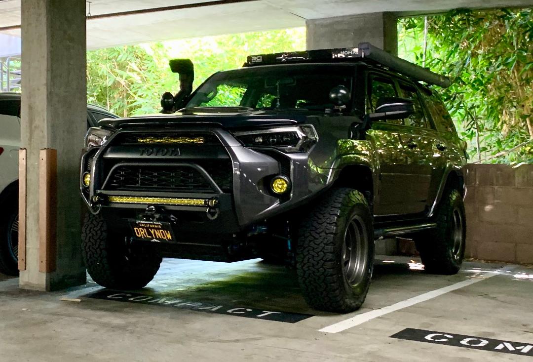

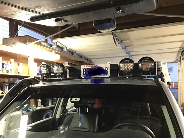

Trying something different here..... all Rigid Industries lights (2x spot/hyperspot, 2x driving/spot) on a Front Runner (also ARB awning mount, 2x Rotopax and quick release for the Autohome). Rear facing spot/flood. 2x driving with amber covers behind the grill. Also, Swapped our fogs for Morimoto. The fun part of wiring the SwitchPro still to come....
Do you have pictures of the install for the behind the grill lights?

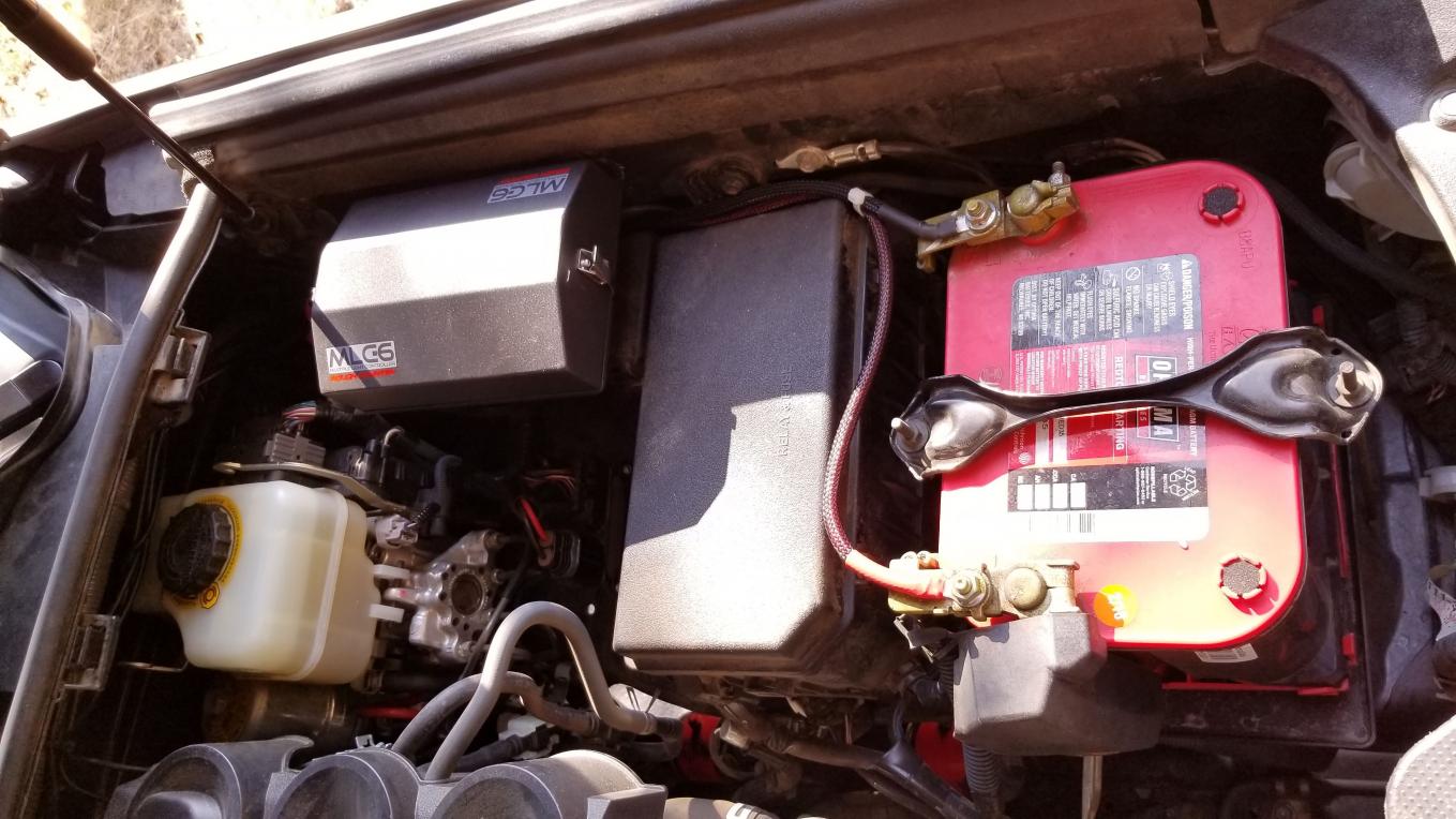

Also! Installed a Rough Country MLC switch and power distribution block. Cleaned up my wiring and am currently using 4 of the 6 switches. There really isn't a good place to mount the switch housing in the interior of the 5th gen, so I made one. Cut out the "pen holder tray" just forward the gear shifter. The gasket is something I will likely upgrade and clean up, as it sort of bowed up in the cold overnight. BUT, really happy with where these switches are and the cleaned up simplicity of the MLC system.
Switches powering
1 - 30" single row (road)
2 - 8 qty very helpful rock lights (rock)
3 - 2 qty 6 inch roof rack lights (rack)
4 - blank
5 - blank
6 - power inverter (mounted to left of lower dash)

[MENTION=3233]RedRunner[/MENTION], all brackets are custom bent out of I think 16ga aluminum except behind the grill, 90 degree “L” shaped brackets out of steel. I think Rago sells behind the grill brackets for round lights tho.

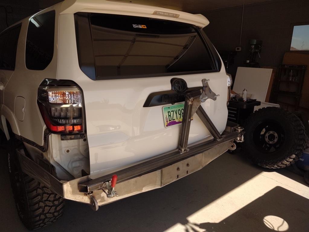

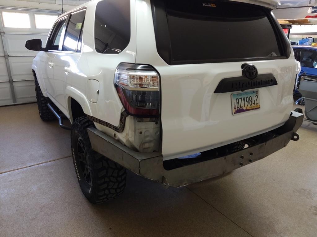

Week two of my Coastal Offroad rear bumper build. Didn't like the blocky look of the kit but liked the price. I tacked the bumper kit together as it was shipped to me then started in on customizing it. 4 of the corners got cut out and replaced with a section of 1.38" OD dom to make the corners flow a little better. There was also room to cut another facet into the rear. Basically cut a pyramid shaped piece out of each side, starting from just outside the rear mounting bolts to nearly the shackle hangers. Hard to see in the pics but it basically makes the bumper look like it is tapered up and forward from the back. Still have plans to integrate some backup lights.
Spare tire carrier was needed for the 295/70-17's that went on a few weeks back. Winged it on the carrier, using a 4X Innovations hinge/tire plate and Destaco clamp. A ball/socket setup near the clamp eliminates any movement when latched. Spare is parallel to the rear window leaving room under it for a hi-lift jack (mount TBD).
