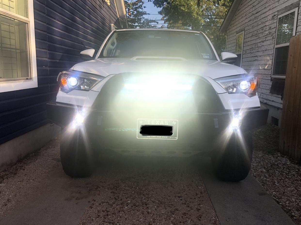

Bulb Swap
Finally had a halogen burn out so ordered the Auxbeam T1 H11 for low beams. They have an adjustable beam pattern so had to do a little tweaking to get the passenger side to project correctly but am overall very happy with them. Quite a bit brighter than stock and no dust cap modification required.

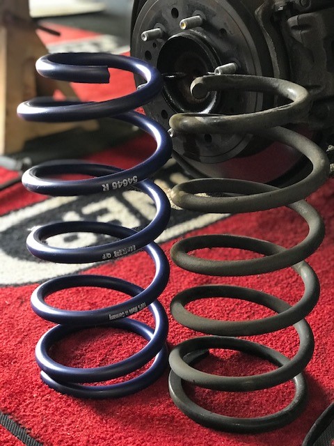

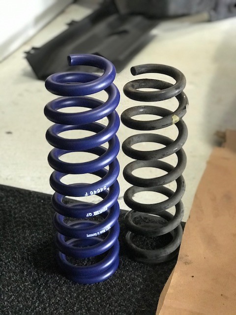

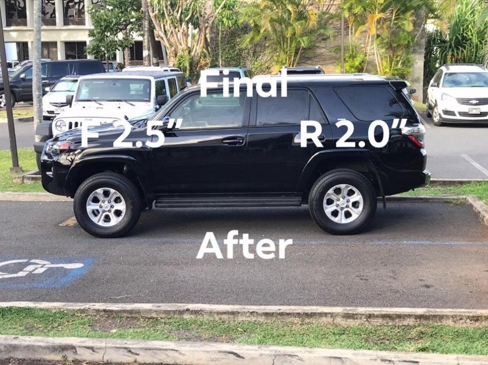

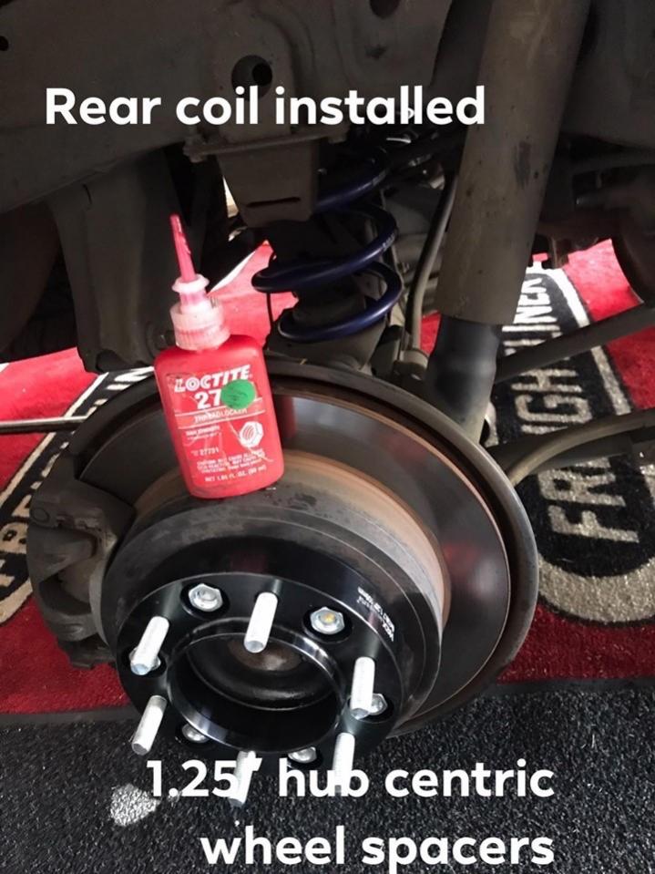

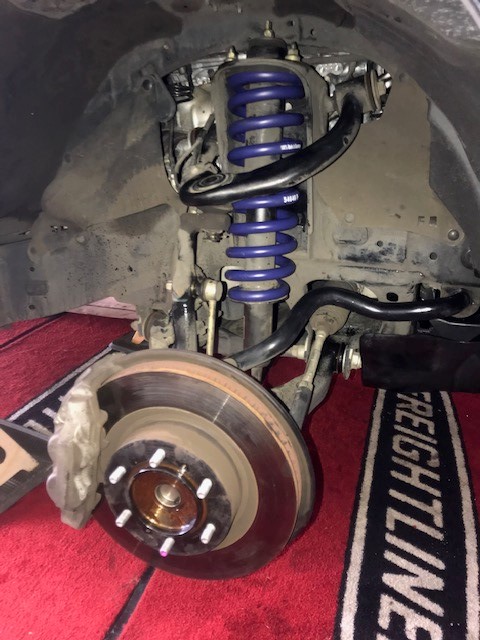

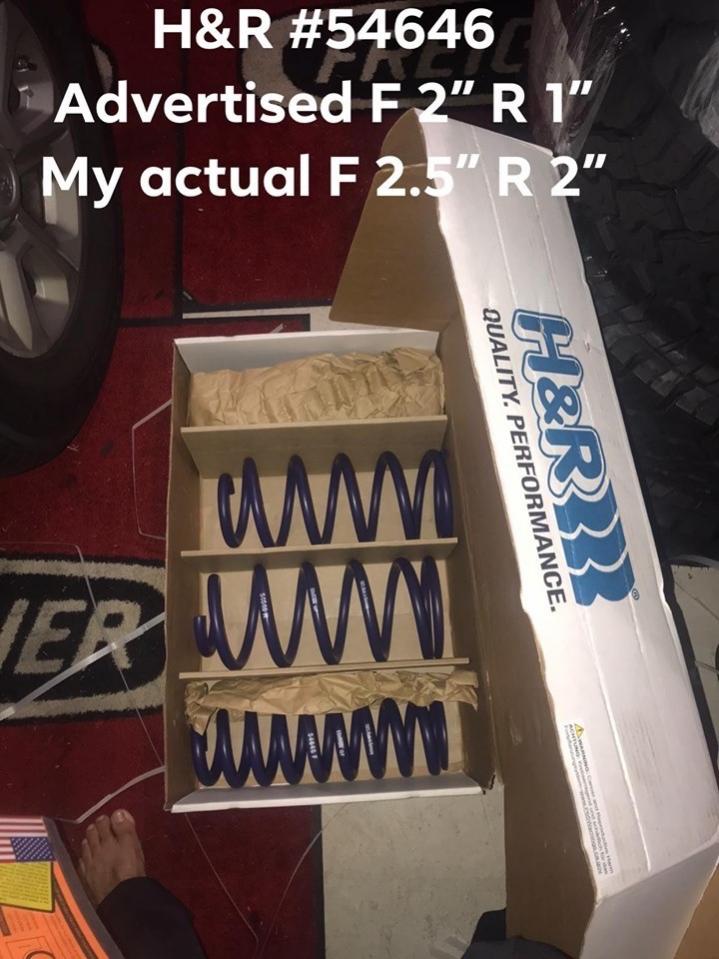

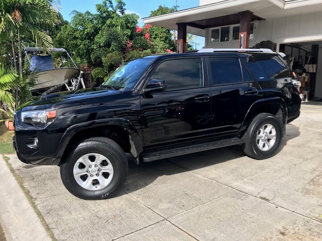

installed the H&R lift springs on the stock shocks. The ride is very nice.

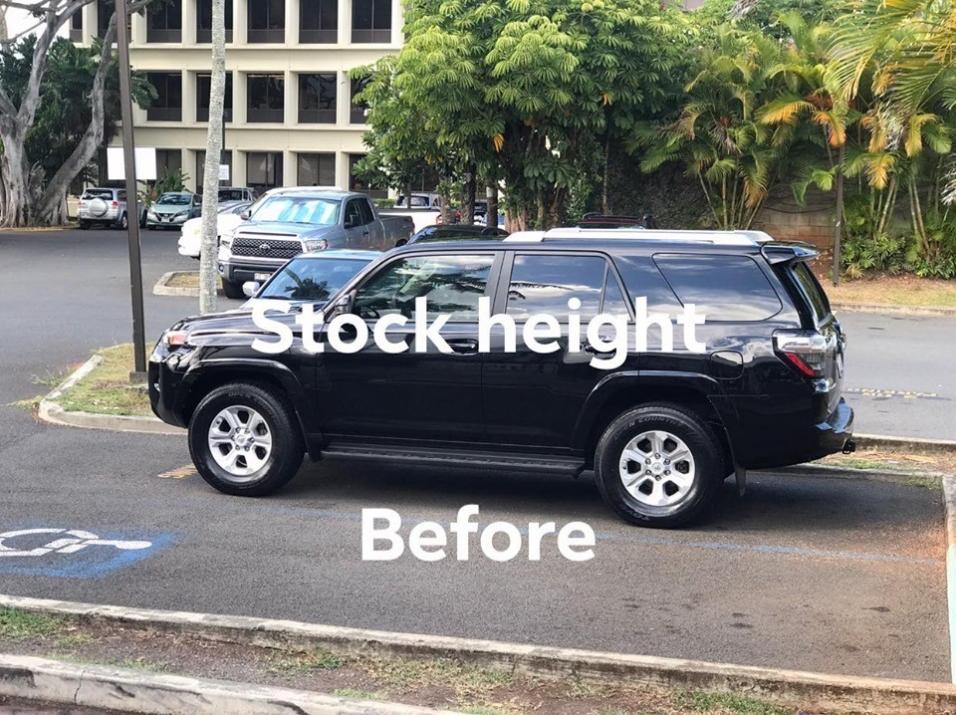

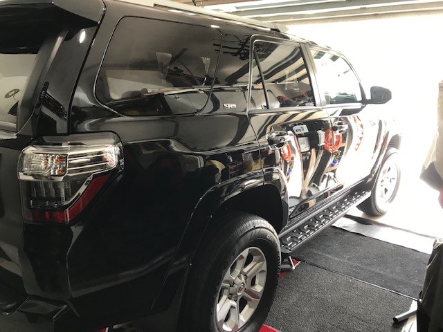

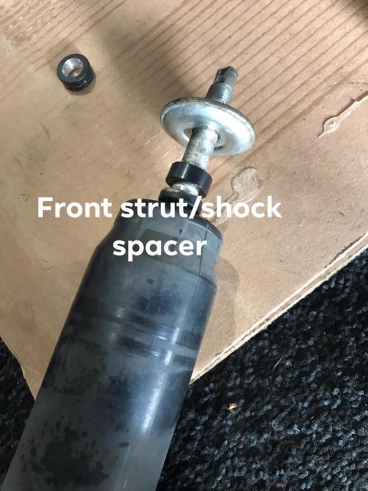

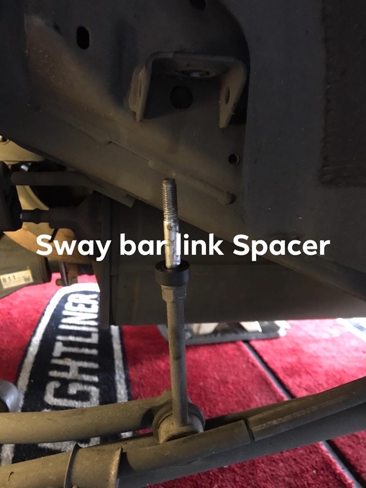

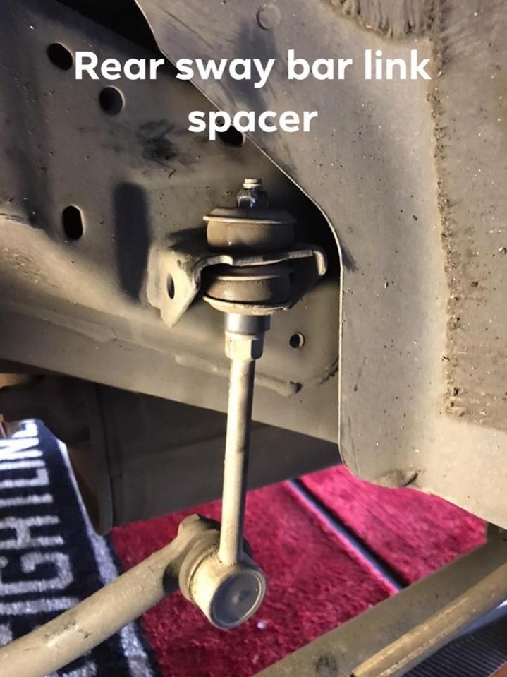

thanks, I would have liked the rear shocks 1" longer and then will have to re-position the rear ABS wire bracket. The tundra rear shocks I had were not going to work due to the lower eye size difference. Only reason being when I drop one rear wheel off the curb I feel the full extension, flying over speed humps not noticed. The fronts I added the spacer collar to extend struts slightly. I also added a spacer collar for rear sway bar link extender. It was the smoothest & easy install I have had cause the coils were not too tall or struts not too long. 1.25" wheel spacers added as well.
Pick up some 3rd gen rear sway bar links. Perfect length when used on a 5th gen with 2-3 inches of lift. Moog PN K80380

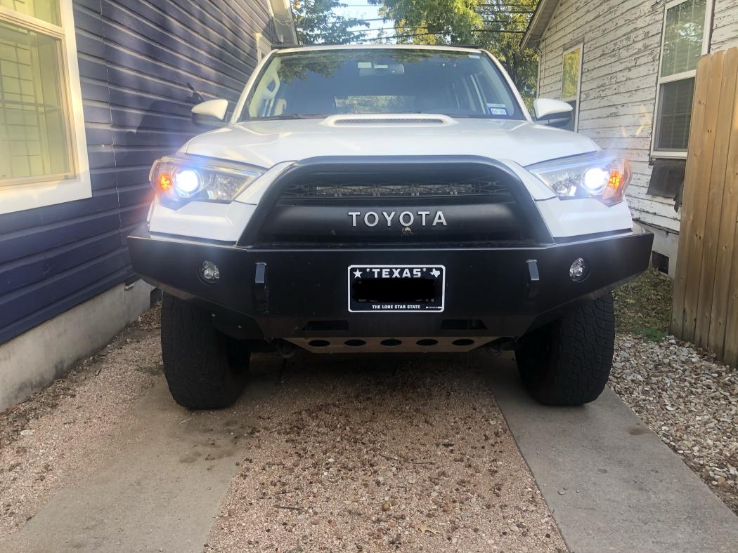

Damn fine bumper. Looks solid. The want is real.
Yes it's quite a beastly bumper. It's not for everyone but I love the simple and stout design. Didn't need all the unnecessary bells and whistles of the other aftermarket bumpers. The quality and clearance is unreal though. I'll post a mini-review and thoughts on the bumper once I get it cleaned up and get better pictures.

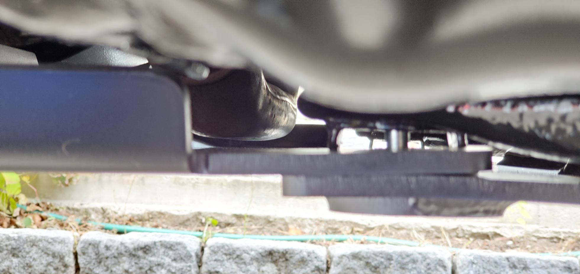

RCI TCase Skid Exhaust Gap
Figured this didn't need it's own thread so here goes. Just finished installing all of my RCI skids and I had read a ton about how the exhaust typically contacts the TCase skid. I know RCI includes spacers to gap the front of the TCase skid so it doesn't contact, but I tightened everything down and I have a fairly decent gap already. I didn't want to unnecessarily add the spacers and lose some ground clearance if I could avoid it.
Gonna take it for a ride and see what happens but what do people think? Is this enough of a gap for the exhaust to not flex and bang/rattle on the TCase skid?

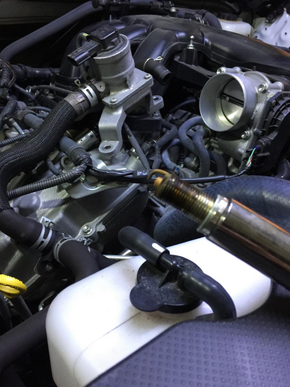

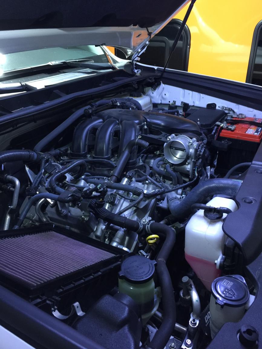

69,000 miles
69,000 miles, Oil change with Mobil1 and upgraded to metal filter housing. Put fresh plugs in, and changed the cabin filter.

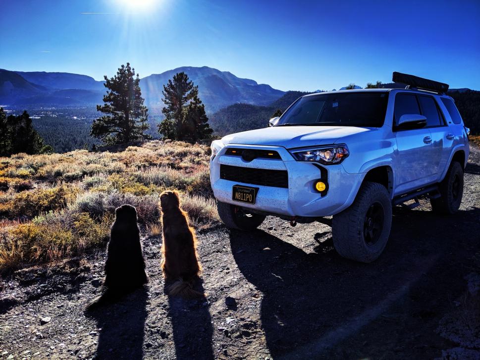

Went out for a quick dirt road therapy session today with the puppers
