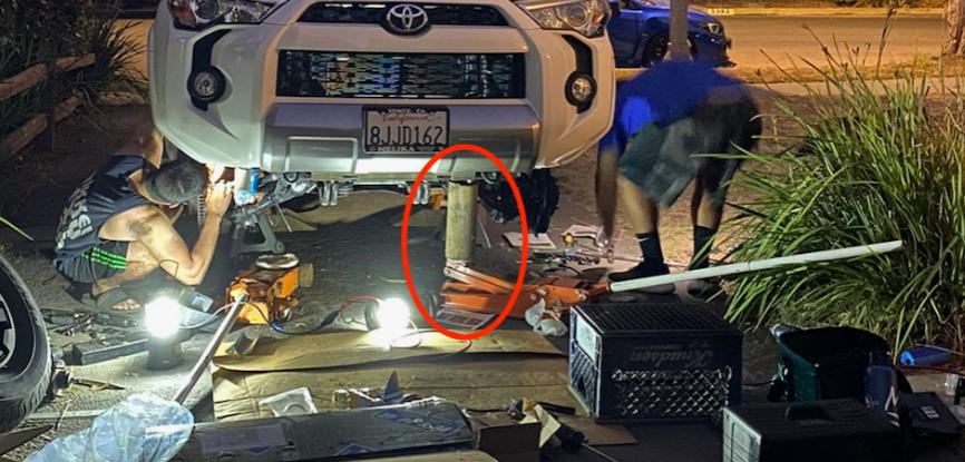

Another dirtbiking trip + installed Kings and Icon UCAs on a buddies rig
Nice!! He will love it . Just got mine King on like a month ago. Just don’t do proper alignment on first time , drive it ~ 500-700 miles let it settle.

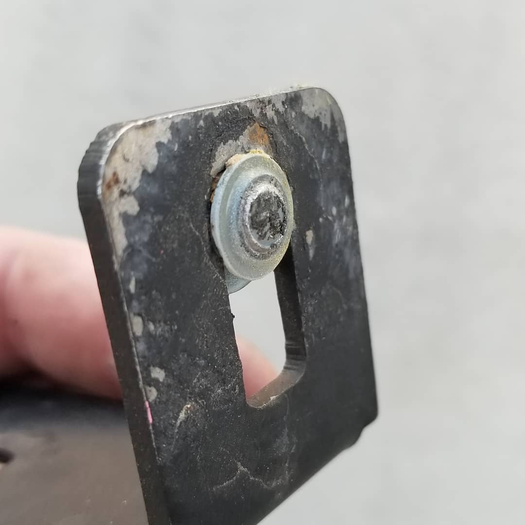

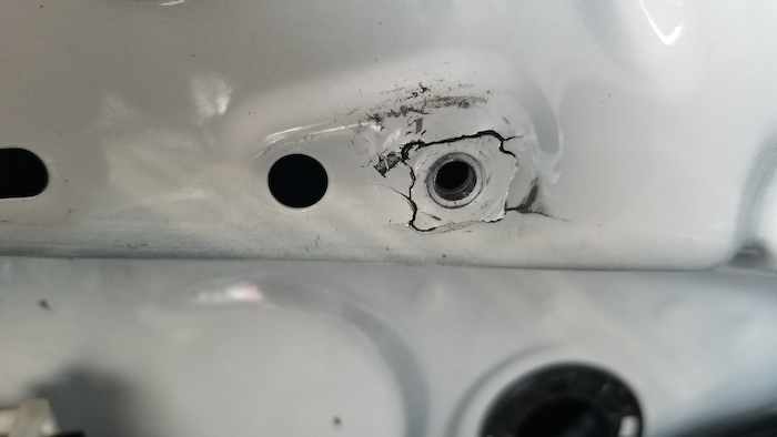

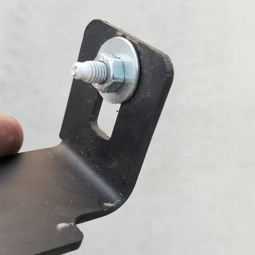

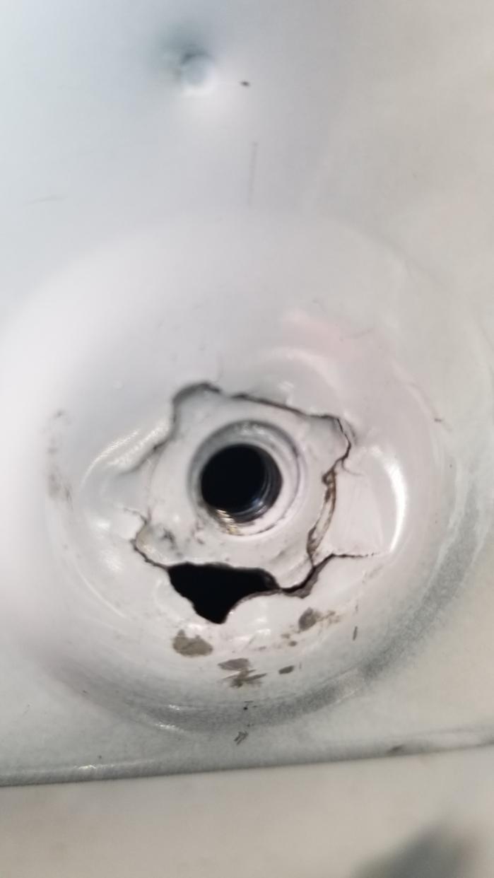

I took out my secondary battery and tray to find the source of a rattle after a trip to Death Valley and found this. Has anyone run into this issue? Anyone seen a thread on repairing and reinforcing factory Nutserts?
Ouch! Death Valley and vicinity can inflict serious pain on any vehicle. I have no answer to your situation though.
Looks like the nutsert held terrifically! The easiest repair is to replace the vehicle surrounding the nutsert.
Next repair would be weld the nut back in with a backing patch to strengthen the area. I believe there have been several others, especially those who upgraded to a size 31 battery that have had the tray and/or fender crack. I fully expect mine will do the same eventually. Toyota has definitely stretched the thinnest metal vs the heaviest load to the max in that application.
Well, the 4runner has 11k on it so I was hoping it would go a bit further.
Your spot on about the group 31, it was a bridge too far, 77lbs held in place by sheetmetal.
