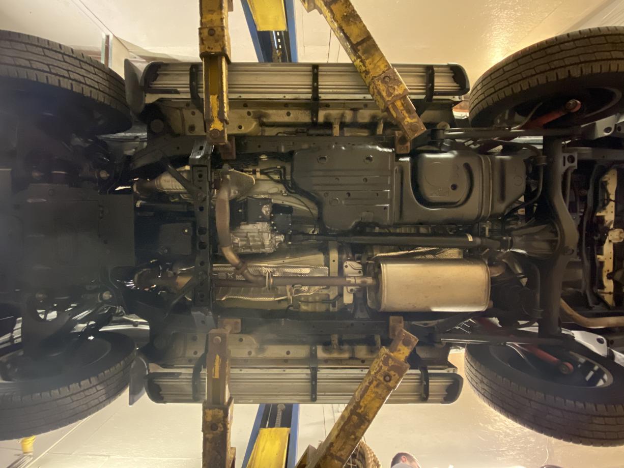

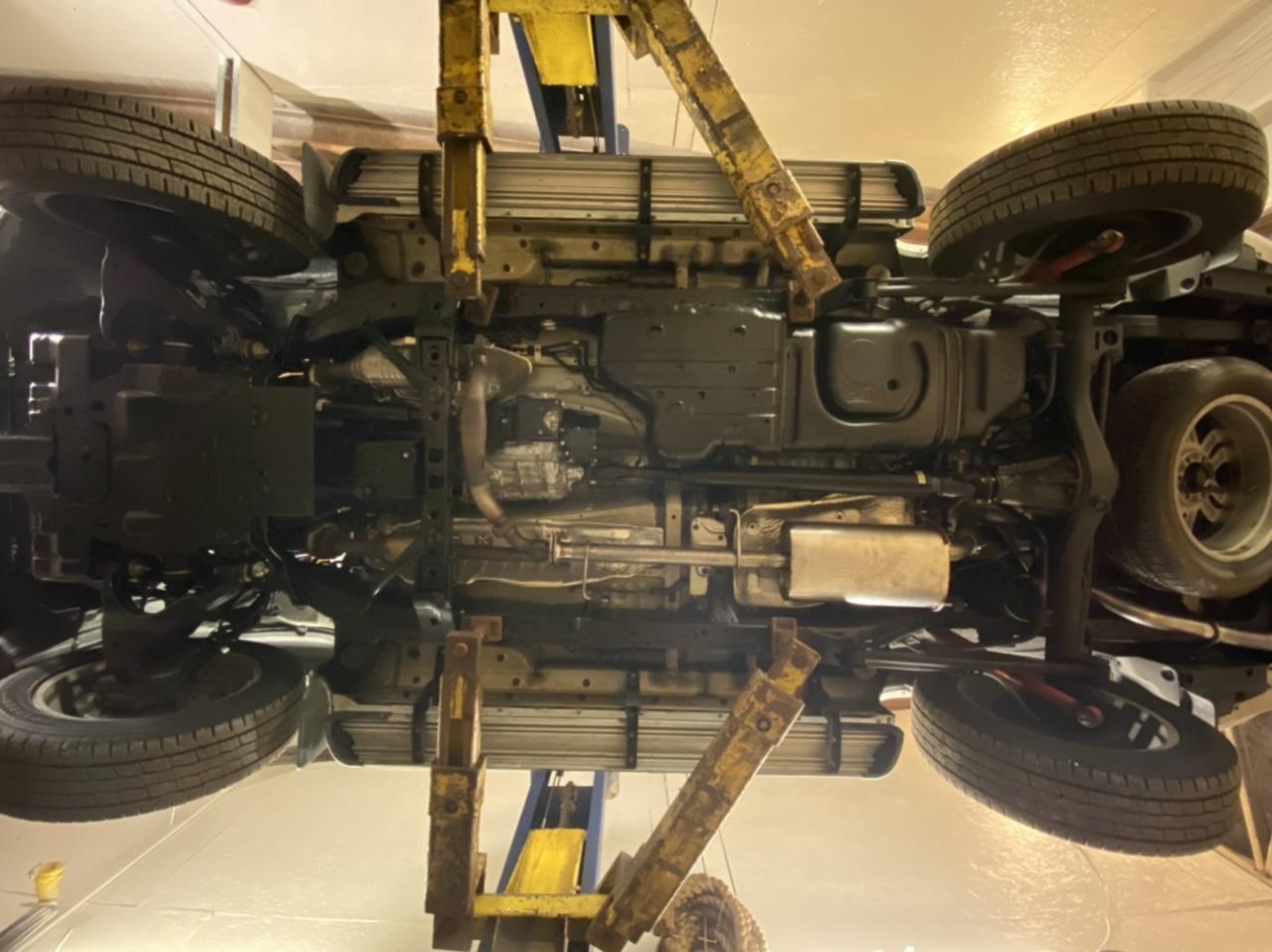

Went to install my TRD exhaust, but one of the bolts for the tailpipe section must have been installed by one of the Greek Gods. Was not expecting much of a challenge since I’m only at 6k miles with no snow/salted roads yet.
Moved on and got some more work done on my bi-xenon retro. Driver side is pretty much complete. Just need to figure out what I want to do with the housing interiors. Passenger side is ready for projector housing surgery.
I had the same issue with my exhaust, ended up having to cut it, and I only had like 10K miles
Were you able to get by with just cutting the bolt, or did you have to cut the pipe? I'm really trying to avoid ruining the factory exhaust, if possible. Mine is going to be at Toyota for the week because of the Fox shocks, so I may just have them swap the exhaust while it's there. I really hate having someone else do my work, but having a toddler that I already see less than I'd like because of work makes it hard to justify spending that time in the garage.
I ended up cutting the stock piping. I always save my stock parts, but this thing just gave us such a pain that the easiest solution was cutting the damn thing
I had my sawzall in hand and then walked away. Thank you for the feedback, though. I was beginning to think I had forgotten how to turn a wrench.

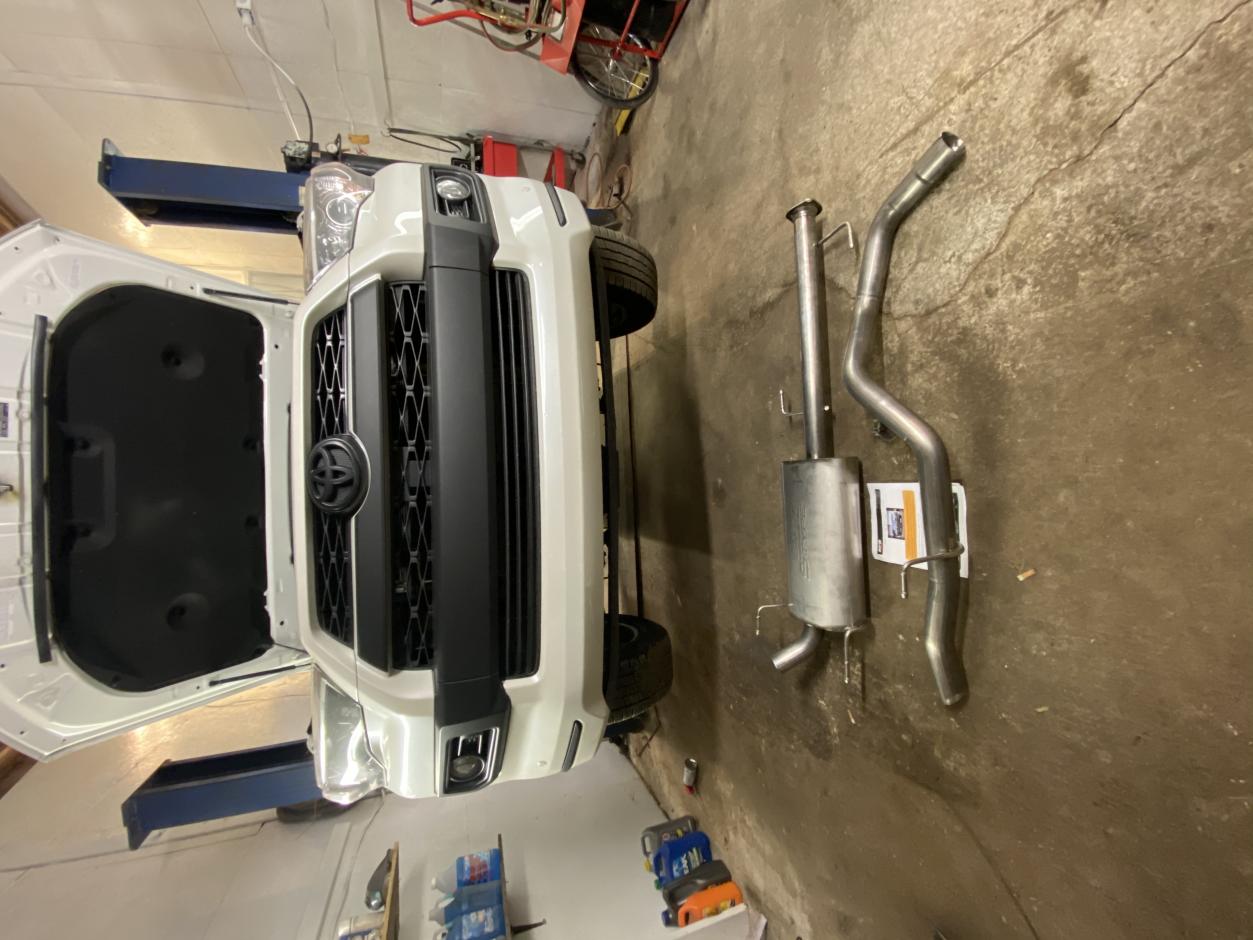

TRD exhaust:

I ended up cutting the old exhaust due to a seized bolt on the rear section, but it’d probably just end up sitting in my parts bin for years anyway.
Initial impressions: the combination does wake up the 4.0 a decent amount. I think the sound is nice and mild. I was skeptical because of the mixed reviews on here, but couldn’t be happier with the outcome. I think there’s still enough restriction from the catalytic converters to keep the noise down.
Exhaust took me about 2 hours from prep through cleanup and the intake took about 3 hours. Intake would have been faster but one of the bolts holding the box to the firewall snapped and I slipped my blade cutting the wire loom and caught my finger almost to the bone. Luckily I missed the vein, so I was able to clean and butterfly it closed and keep going. Also, 5/32 vacuum hose is too small. Definitely needed the metric 4mm. Luckily I had some hose laying around from my home brew equipment that I could slap in to make the 1 mile drive to autozone.

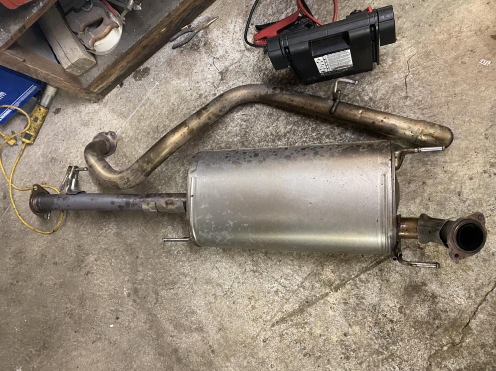

Just installed the Borla S Type exhaust into the 2016 4Runner limited.
Few tips:
Instructions say 15mm socket - wrong. It’s 14mm.
The screws near the rear axle are IMPOSSIBLE to take off, I don’t know if it’s because of the rust or if they just welded it on the other side but it took a cutting torch to heat the screws enough to take off. (Didn’t want to ruin the factory exhaust but just cutting it off)
Take the heat shield off near the rear axle, super easy to snake out the tubing.
Overall it took 4 hours, a cutting torch, a ton of penetrating spray and WD40. Haven’t broken the exhaust in but already notice a nice growl coming from it and can feel a little bit of power. I have it paired with a K&N CAI so cant wait to see the results in a few months once it’s broken in.

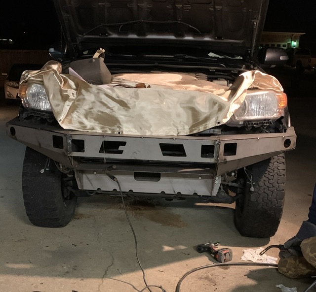

Decent start. Can’t wait to get this thing done. Very happy with this Coastal Offroad kit so far. Very precise cuts have made it pretty easy. Still have to get a good bead all around and put the front bottom plate and center hoop on. And paint of course. Will post when finished.
