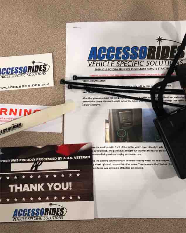

Accessorides remote start. Easiest mod I’ve ever made! Happy to see the message about the company supporting our vets too. Install probably took 15 mins. D90F02B4-3A43-41BA-9C70-A66D2C1B6C8F.jpg

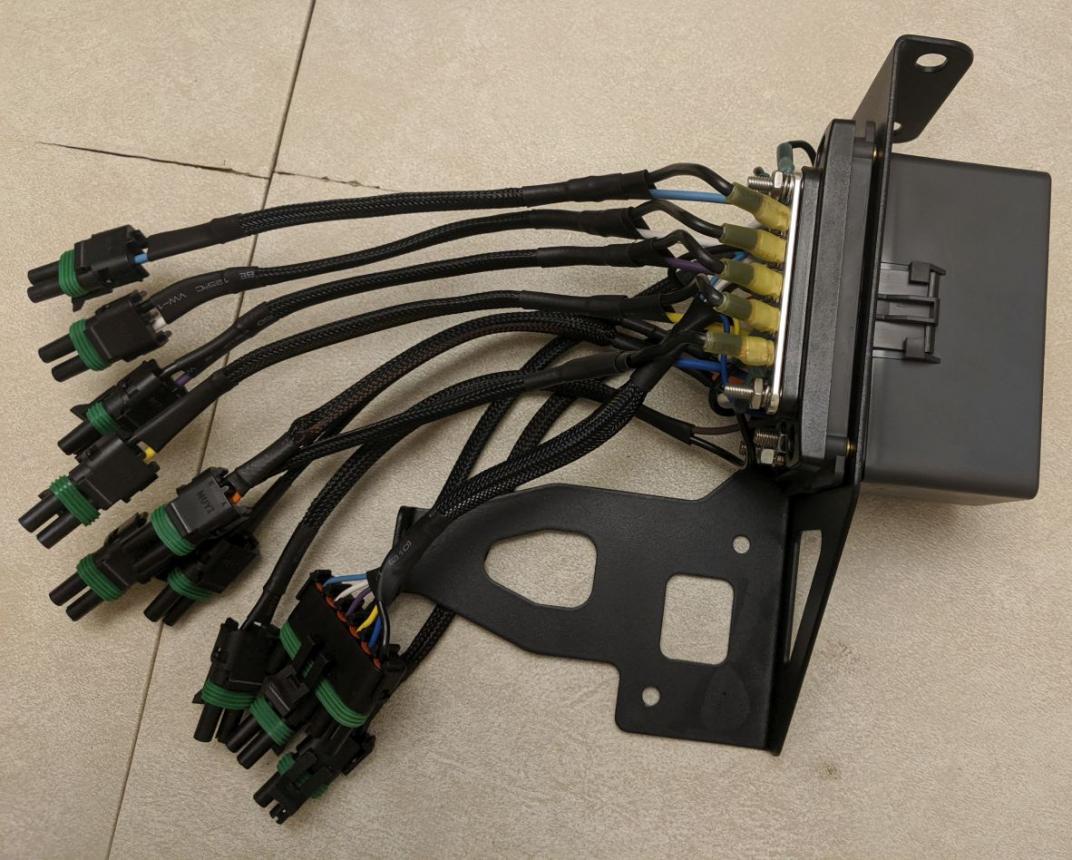

They are the CTH (I got the whole grill kit).
For wiring them up, I've built an underhood fuse box (bussman with the Shrockworks mount) for the fuse location. I then made one run for controlling all 5 relays in the cabin, currently have wired up just this switch. I'll be adding more as the truck grows.
For the power to the switch, I currently used an add-a-fuse but think I want to adjust how that is tapped.

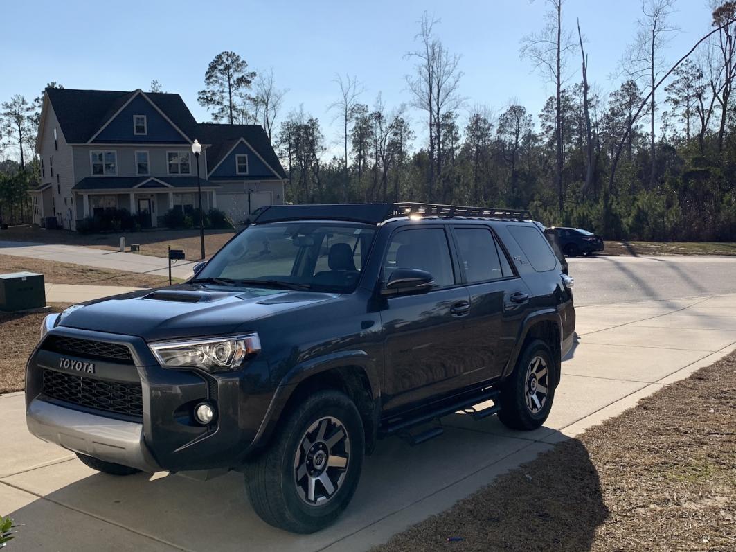

SSO full roof rack
Installed my SSO roof rack today and the Cartrimhome front TRD pro valence.

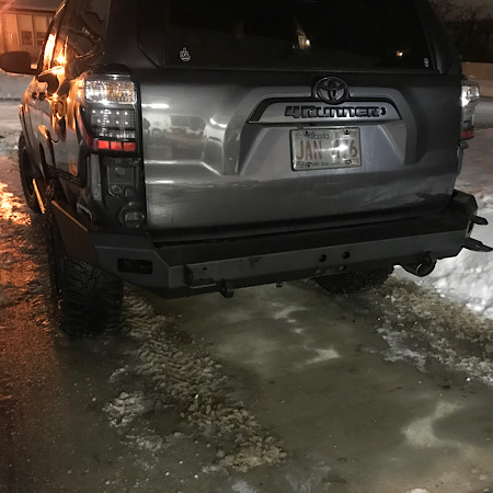

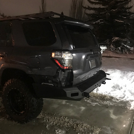

Started on my shrockworks rear bumper. Got it all lined up, ready to pop on what’s remaining of the oem bumper tomorrow, and then the swing arm.. super pumped.
I posted earlier bout possibly trading in on a ranger... decided to hell with that. Love the 4runner too much
