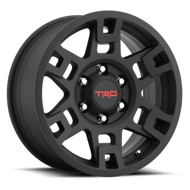

I know these wheels are all over the place, not that unique. But this weekend, I GET MINE INSTALLED! They look great and I got some new rubber coming too!

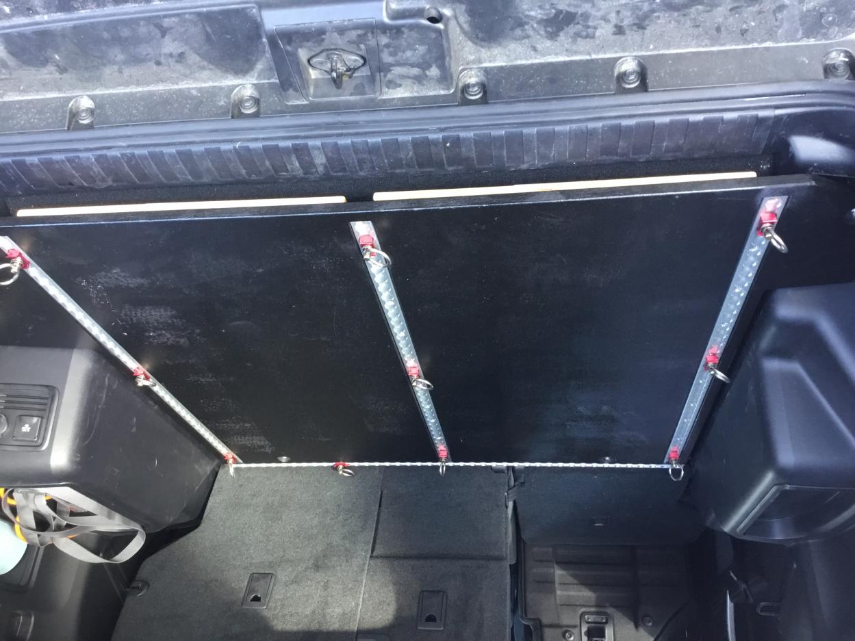

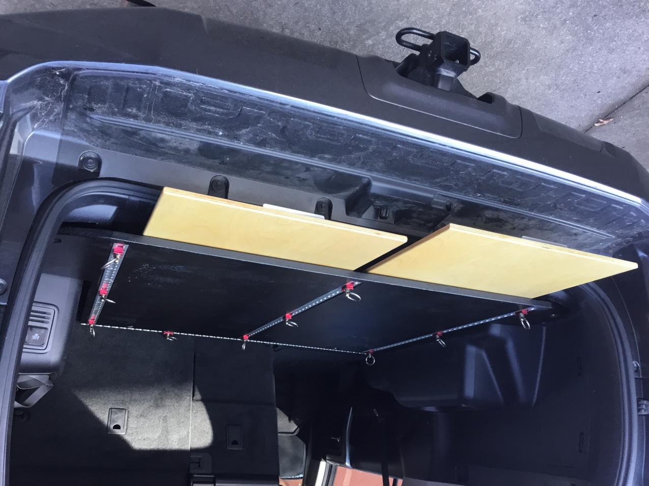

I built this platform for the back of my 2019 4R. I coated it with Rustoleum bedliner. I had a can of the spray type which I used first to coat the L-track channels and bolt recesses, and then used the roll-on type to put two coats over the whole platform. I kinda wish now that I had just used the aerosol type on the whole thing. I found that when using the roll-on, it was difficult to get a uniform sheen on the coating. The roll-on is tough as nails and probably(?) more durable than the aerosol. Not to worried about the looks though since it will just get scuffed up over time anyway.
I added two pullout shelves underneath coated with polyurethane satin varnish.
I used 3/4 inch baltic birch plywood for the platform and 1/2 inch baltic birch for the pullout shelves.
Will use the tiedowns for my Jackery 500 generator which I just got, as well as the Goal Zero Boulder 100 Suitcase solar panel (coming Monday), and plan on purchasing a Dometic CFX3 35 Fridge ASAP.
I will probably build my own slider for the fridge unless I determine that it would be as cost effective to just buy one.
Sorry about the upside down pics.Rotated them 180 deg. on my computer...still didn't work.:dammit:
