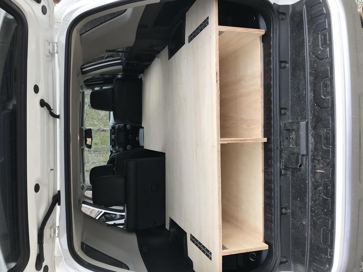

Been working on this a couple of weekends now.
Sleep platform and Drawer system inspired by Wanderlost Overland (using Marks plate design), Solidwoodworx.com, and about 1/5th the price of Goose Gear. And a lot stronger in my opinion.
Marks measurements were spot on. Really appreciate that video. It was the basis for this build.
Rear 60% seat bottom removed. Practically tool less install of sleep platform (only need 14mm socket to remove seat bottom). "Bed" is 32" by 80".
Putting finishing touches on drawers, and trying to decide what finish to apply to the top at the moment. Will post pics of finished product when complete.
By the way. Sorry for image being sideways. Anybody know how I can rotate it?

What did it cost you in the end?

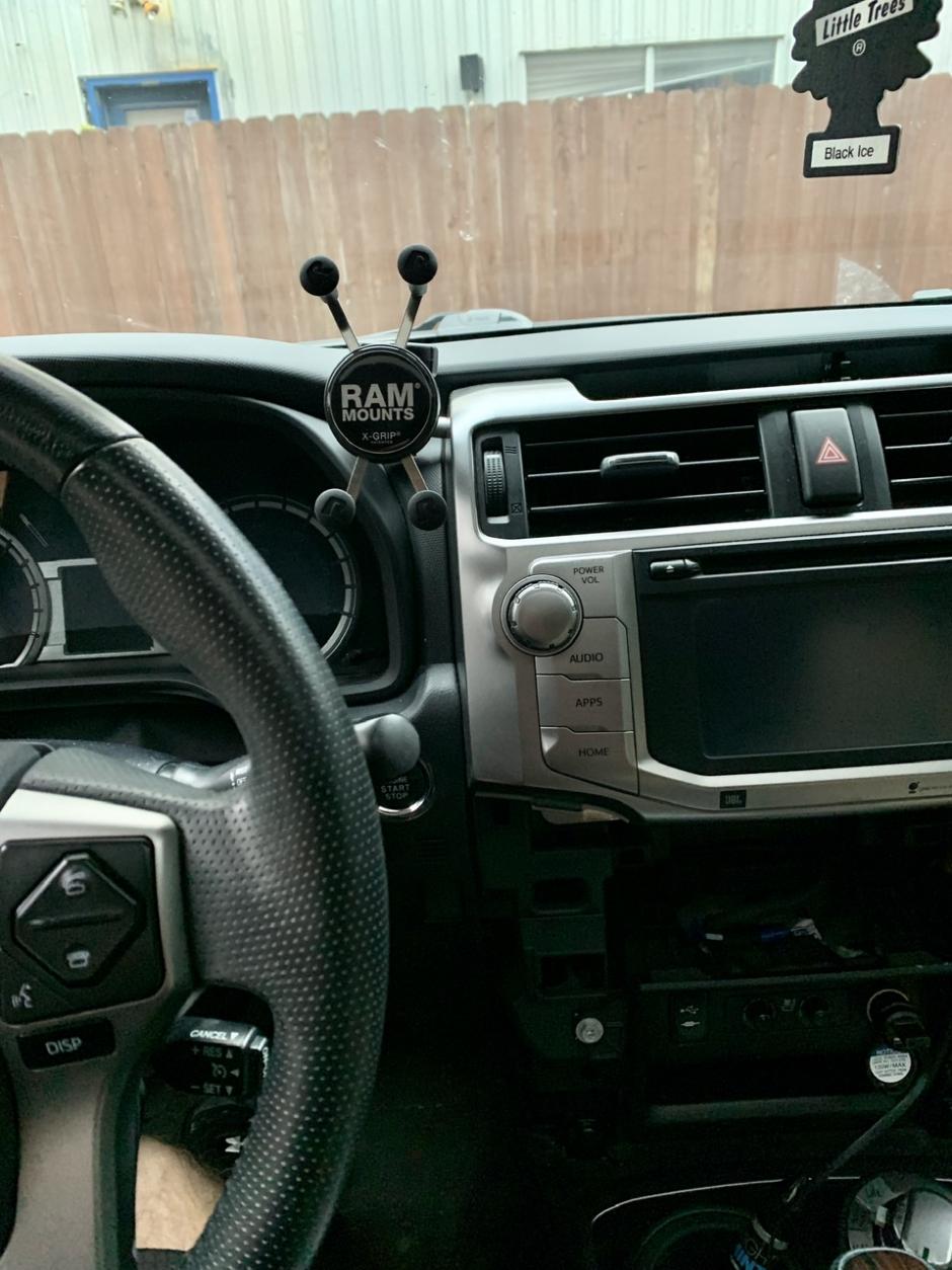

Might have to do this. Really like the location. No where to set these giant phones in the vehicle and I don't want to block a vent in AZ during summer or mount one to my windshield.
Do it!! Takes 30min to install.
I had a ram ball there for two years. Worked very well on the worst of roads
