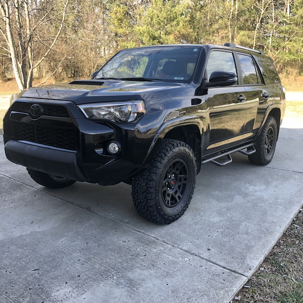

Got my wheels, 275/70R17 KO2s, and Bilstein 5100s (1.75") finally installed. Much better.
Looks great! any rubbing? What did you do for the rear or is it stock height?

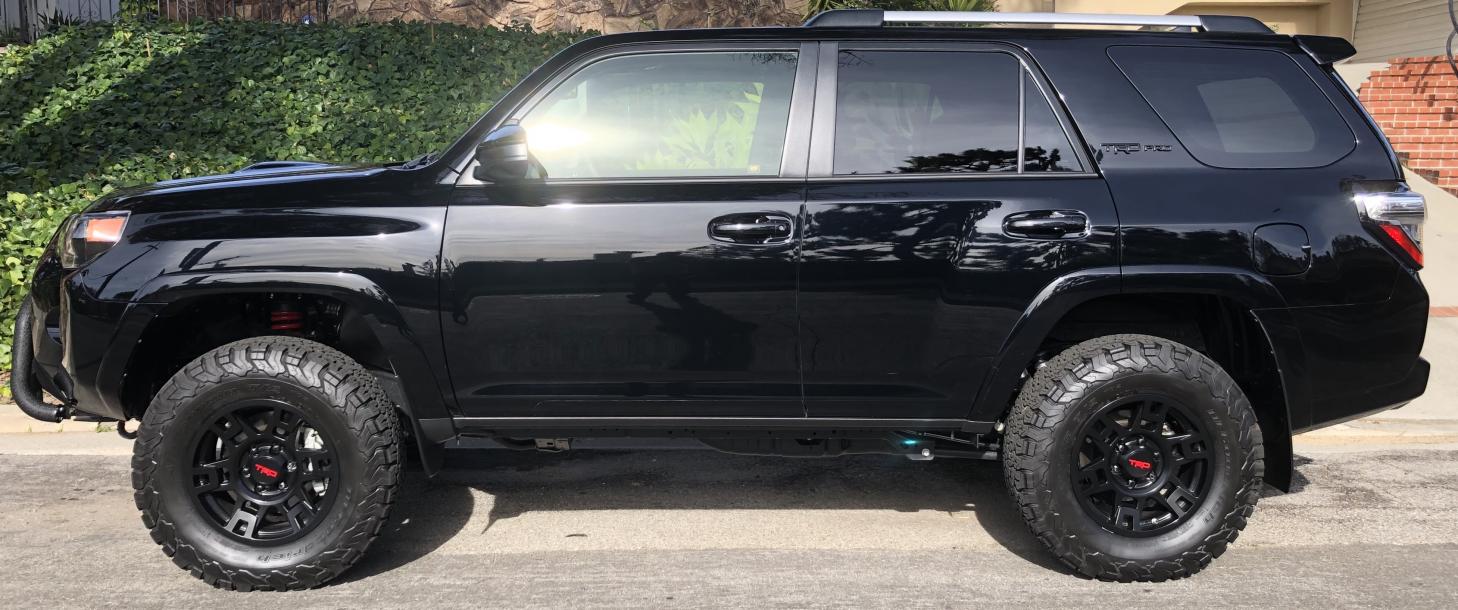

Is the driveway sloped, or does your 4Runner have a negative rake?
Curious if the 1.75 front Bilstein setting requires a .50 or .75 rear spacer to sit level and/or avoid a negative rake?

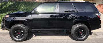

I would have him check the center of the hub to the top of the wheel arch to get a better idea. My Pro has 1.5/1”
spacers added to it for a front measurement of 22.5” and a rear measurement of 23.25”. 275’s. I would say that a 3/4” difference from front to rear gives a very leveled look.

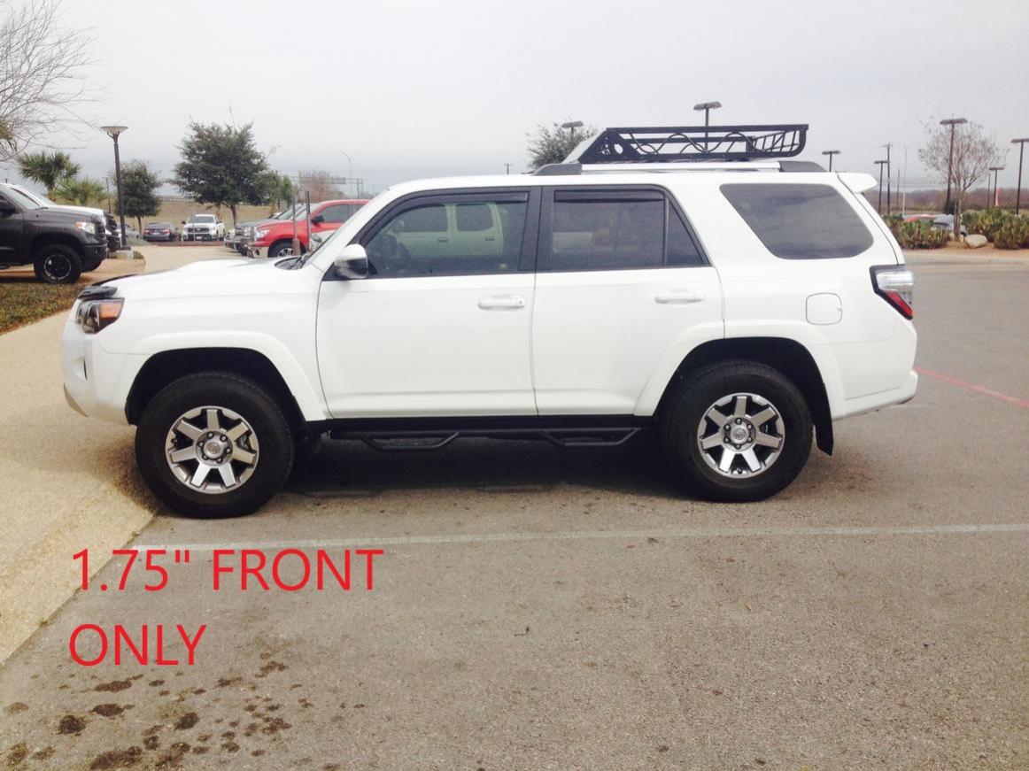

This is 1.75" front stock rear. It has some pretty bad negative rake. If going 1.75" front you want .75" rear to sit level.

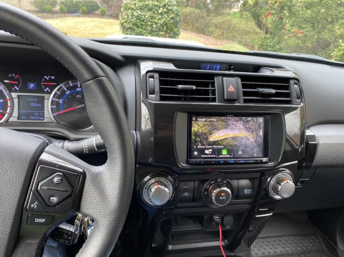

Yes. I tried duplicolor black sand metallic 1st and it looked ok but not a dead match. I have a friend that owns a body shop and he nailed the color. I also had the inside of the bezel by the head unit painted flat black. I think that adds a little extra touch and looks more stock.
