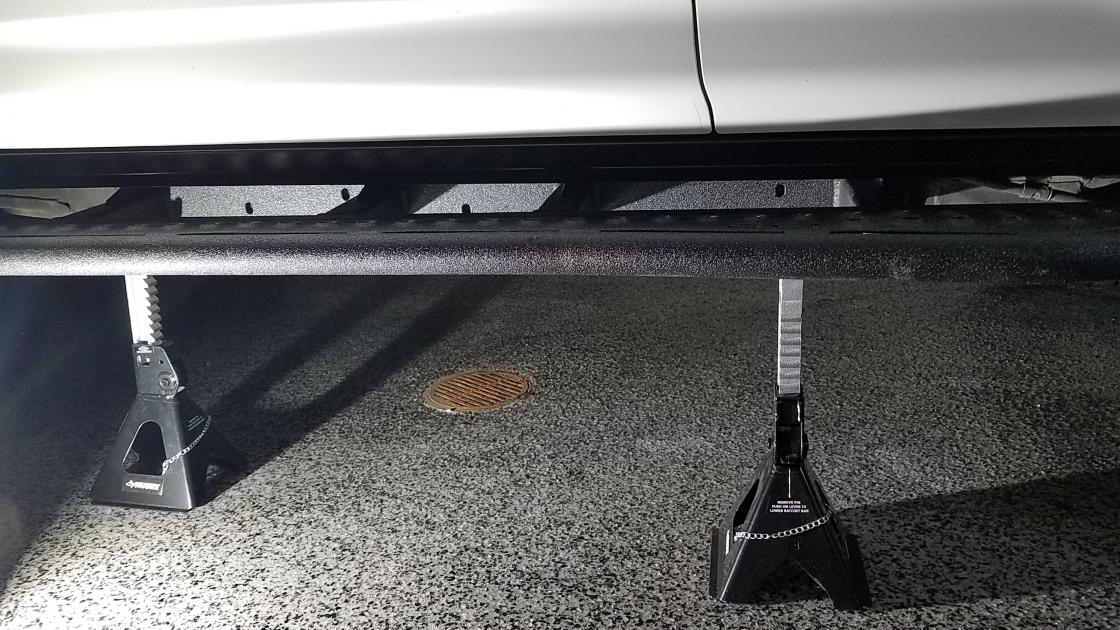

Added my RCI rock sliders over a week ago. Super easy install. Was hoping to take my family on an offroad trip this spring break but that sh*t got cancelled. Thanks a lot Coronavirus...so hoping this summer things will be normalish for a trip to Wyoming, Utah, and Colorado. Next install will be a Harrop rear diff elocker. I'm probably one of the few foolish who continues to spend money during these times.

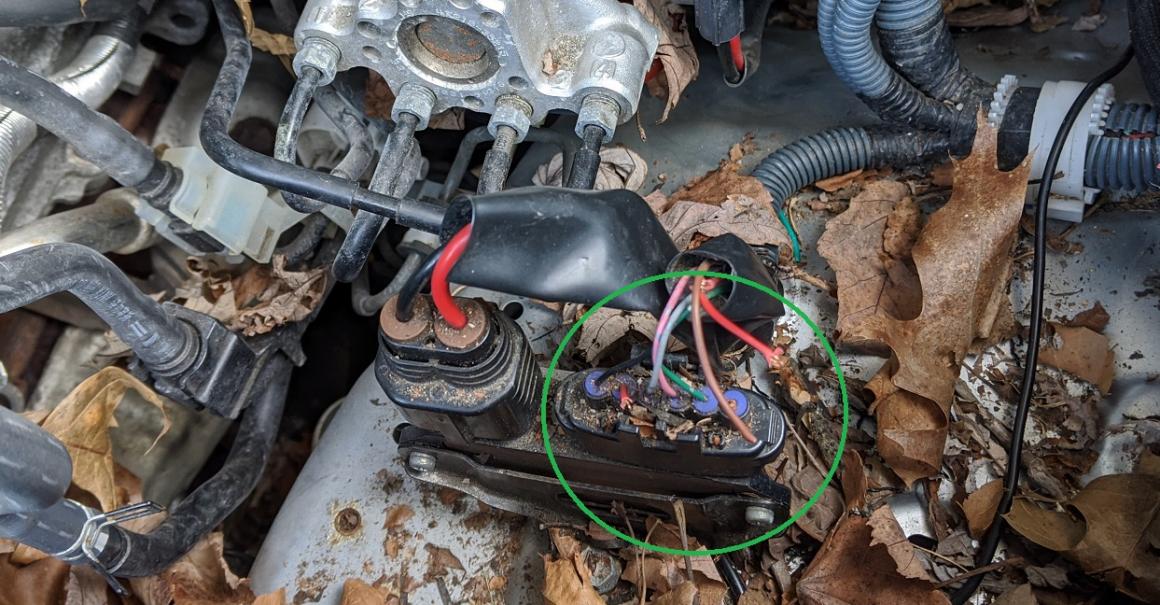

So the Squirrels came back and with me in Covid-19 isolation I didn't check the car like I should have. So this time the did some damage, can anyone tell me what the plug on the right is for and where I can get a replacement plug. I think they cu the wire too close for me to splice it.
You don't need a new connector. You just need what Toyota calls a "repair wire"...6 inches of wire with the terminal already attached. The wires/terminals can be removed from the black plastic "housing" and a new wire/terminal inserted in its place. Then you just strip & solder the repair wire to the remaining piece of wire in the harness. Done.
The plastic housing should have a 5-digit number stamped on it, really really small, usually on the back (top in your picture). It starts with a 1. Using that number, a Toyota dealer can get the correct repair wire for you.

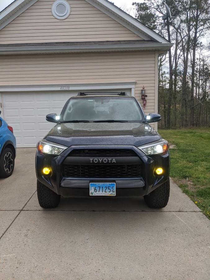

Finally got around to wiring my ditch lights
