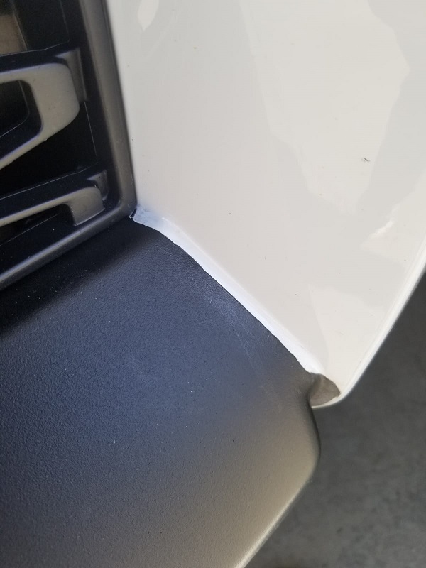

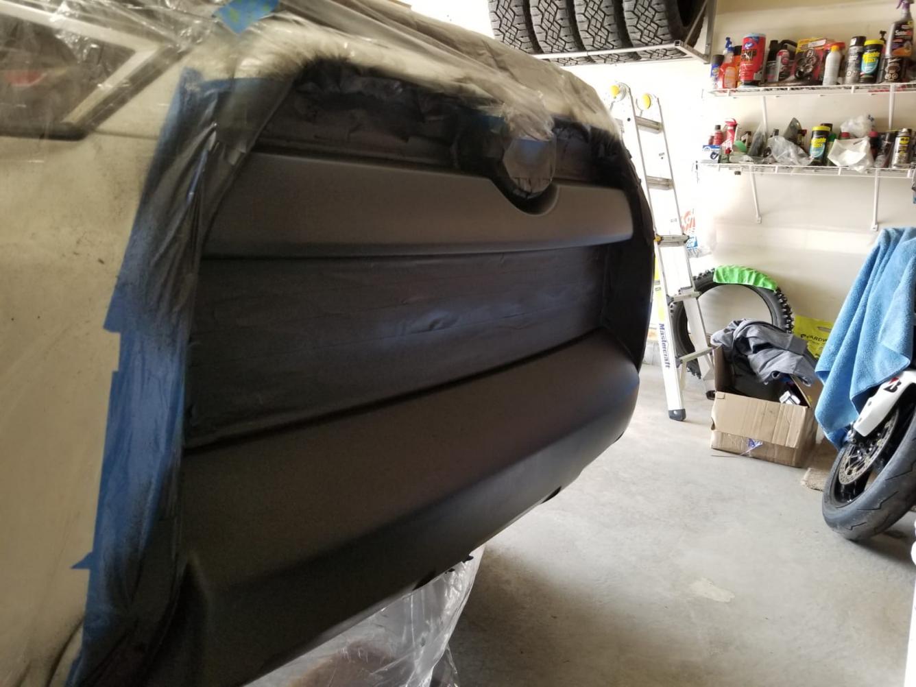

Nothing huge. Just cosmetic shit. Originally, I have the 2 front horizontal bits of the bumper professionally vinyl wrapped in a matte black but didn't get it wrapped in PPF so it started chipping. Doesn't matter anyway cause the wrap started peeling in the corners. It's been painful to schedule back with the shop to get it fixed so I tried my hand at plastidip. I've done bits of my motorcycle before but never tried to make clean lines.
When I first pulled the masking tape off, the plastidip had dried so it peeled the edges away and looked ****ing nasty. I tried to clean it up with paint thinner but that could only help so much.

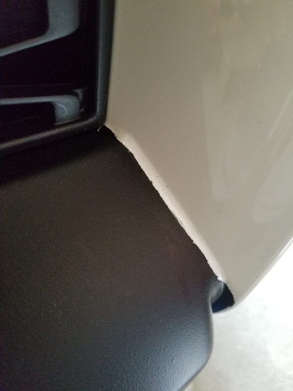

3rd pic: Attempt #2 at cleanup
Instead of masking and respraying the edges and pulling the mask off while the pastidip was still wet/fresh, I masked on top of the pastidip and then clean up the edges with paint thinner. It's not perfect but it's good enough for me. I'll clean it up some more down the road, but for now, the paint is protected -8 layers of dip.

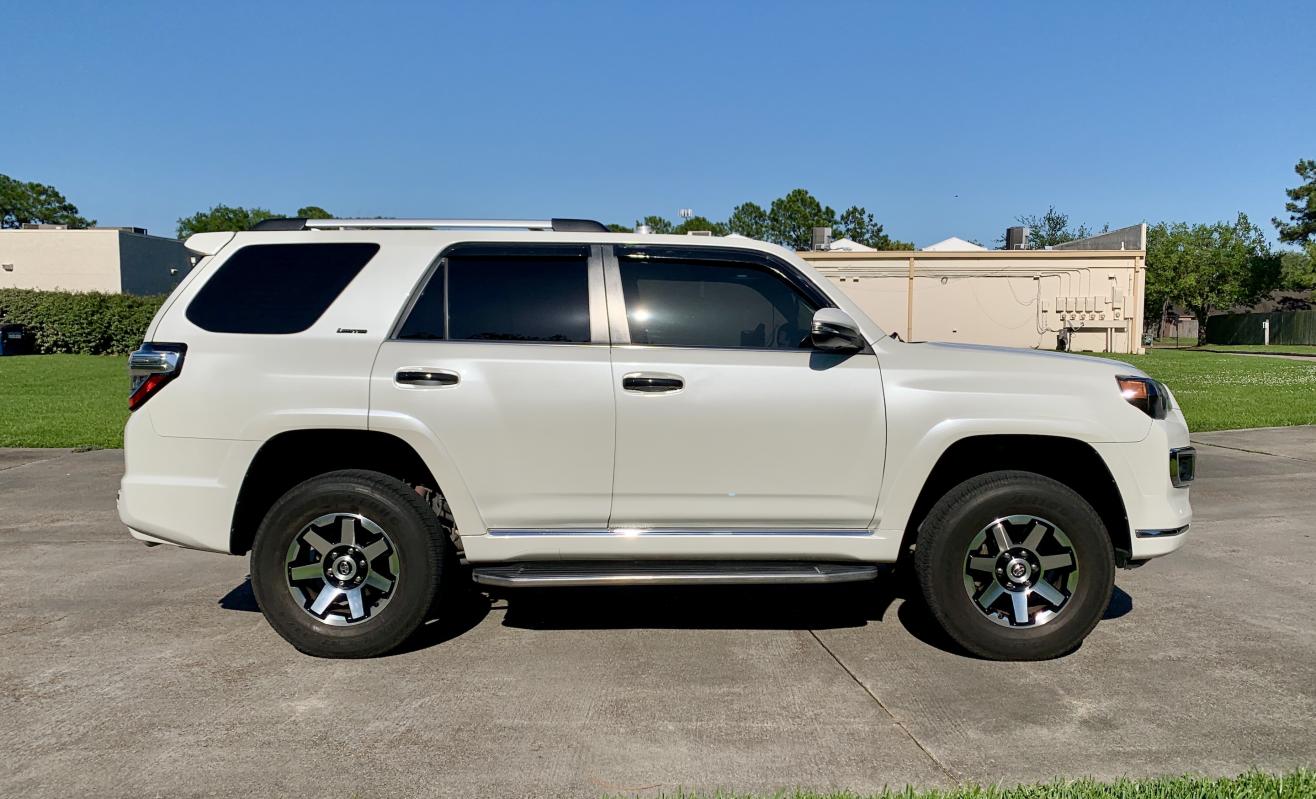

Full detail - 4 hours later and it looks just like it does after a simple wash!!
