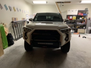

Since I have the rack off waiting for the paint to cure figured I would add the delete rack kit.
Came home and thought I had a Tacoma for a second.

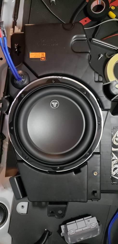

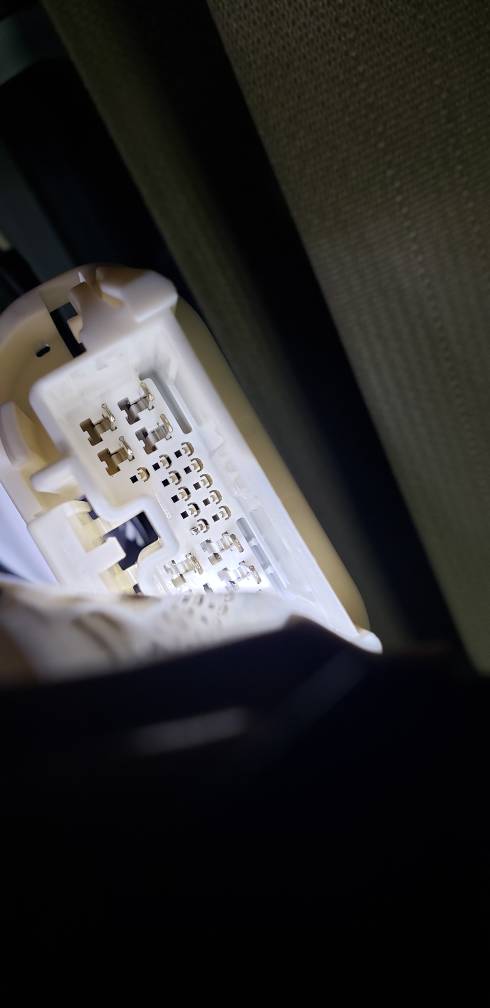

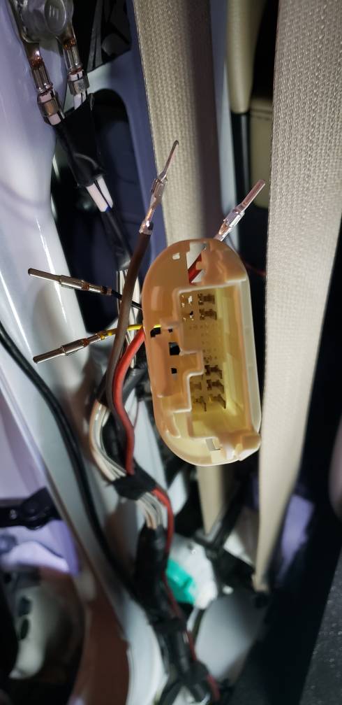

Figured out how to run my own speaker wires to the rear doors using the factory connector inside the grommet. No snaking wire through taped up looms and grommets.
You have to have a multimeter to find out which wires on the door side of the connector map to the speaker connector.
Then you have to find the corresponding wires on the cab side of the connector and release the terminals.
Then get the same terminals and crimp them to your own speaker wire.
Main benefit: this isolates the rear and hatch speakers from the series wiring, so you can run rears and hatch speakers they way you want with plenty more options and choices.

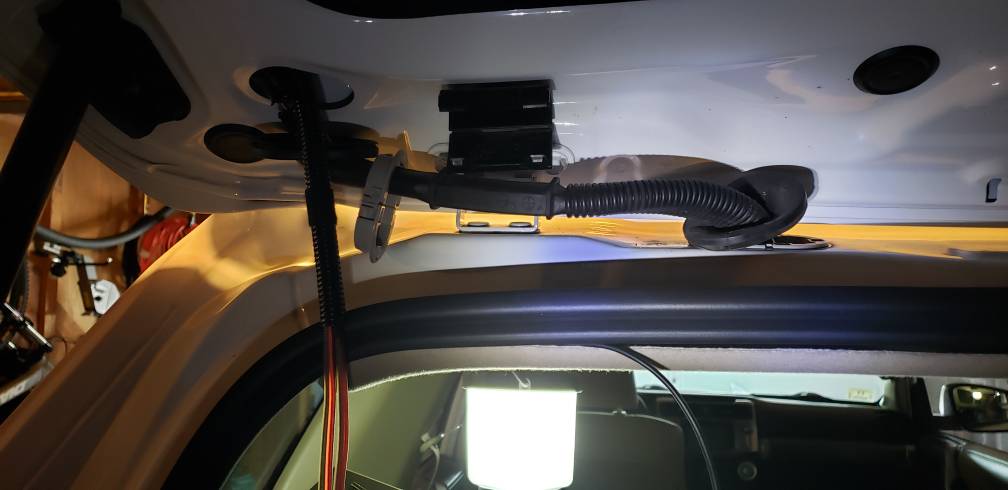

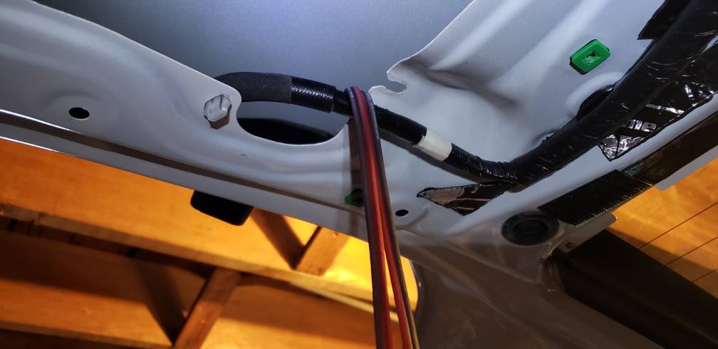

Hatch: Ran my own wire to the hatch speakers as well. Had to snake through the grommet there.

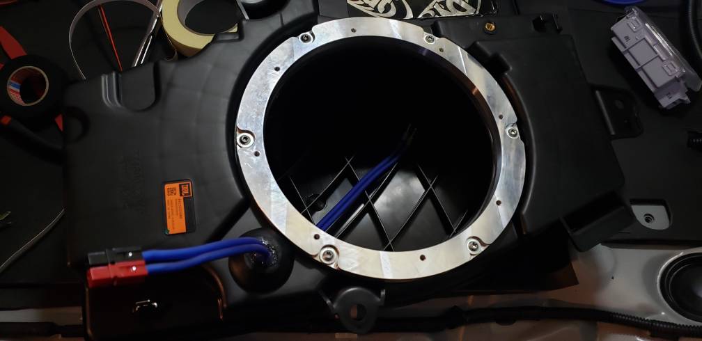

Sub: Had a custom ring spacer/adapter made to mount the JL Audio sub to the factory enclosure.View attachment 361692View attachment 361693View attachment 361694View attachment 361695View attachment 361696View attachment 361697

I have wanted to do a variation on this. My version is run an entirely new wire from amp to door speaker. Then solder the two original speaker wires together inside the door, thus putting them in parallel rather than series. This would reduce the load and allow more wattage from amp to all rear speakers. Unless I have this wrong?
I heard that people usually 'jumper' the hatch speakers, but not sure if that would work at the rear doors. It *might* work, but I don't know.
I ran my amp output wires to the b-pillar for the rear doors pictured in the previous post. Have yet to power them up as Crutchfield is delivering today. So maybe on the weekend, or during the next week. Ah...to be single without kids again...

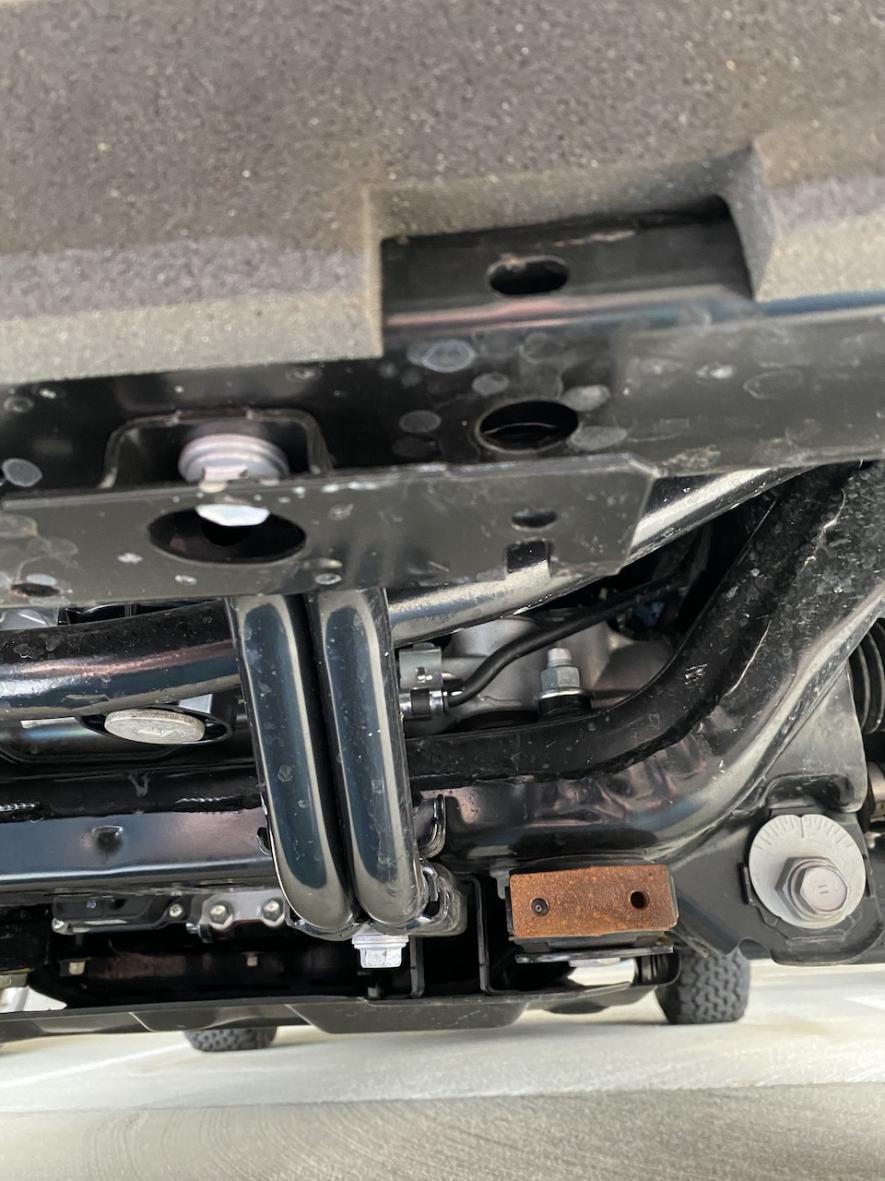

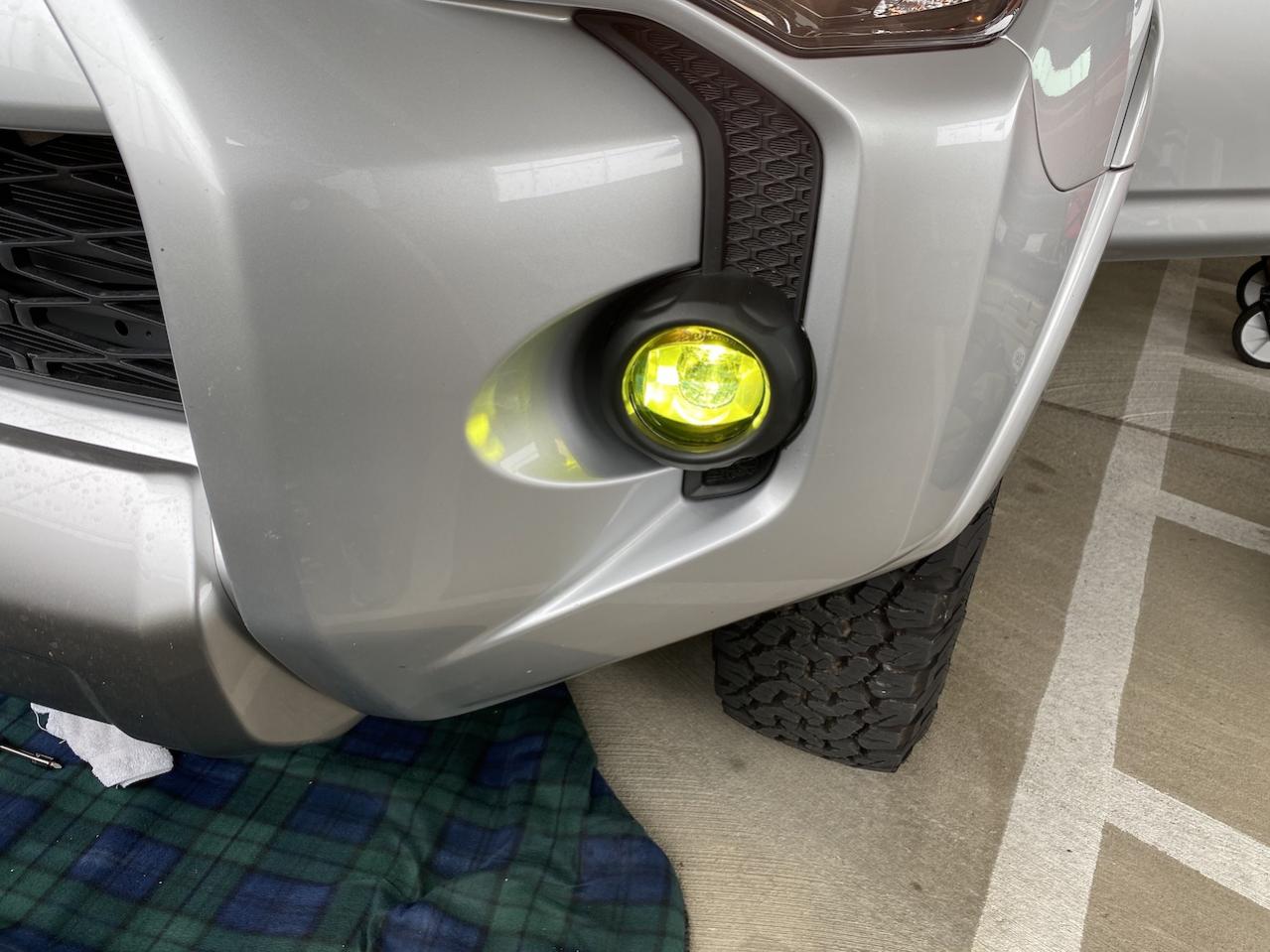

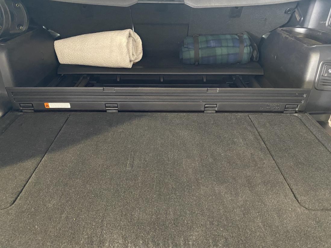

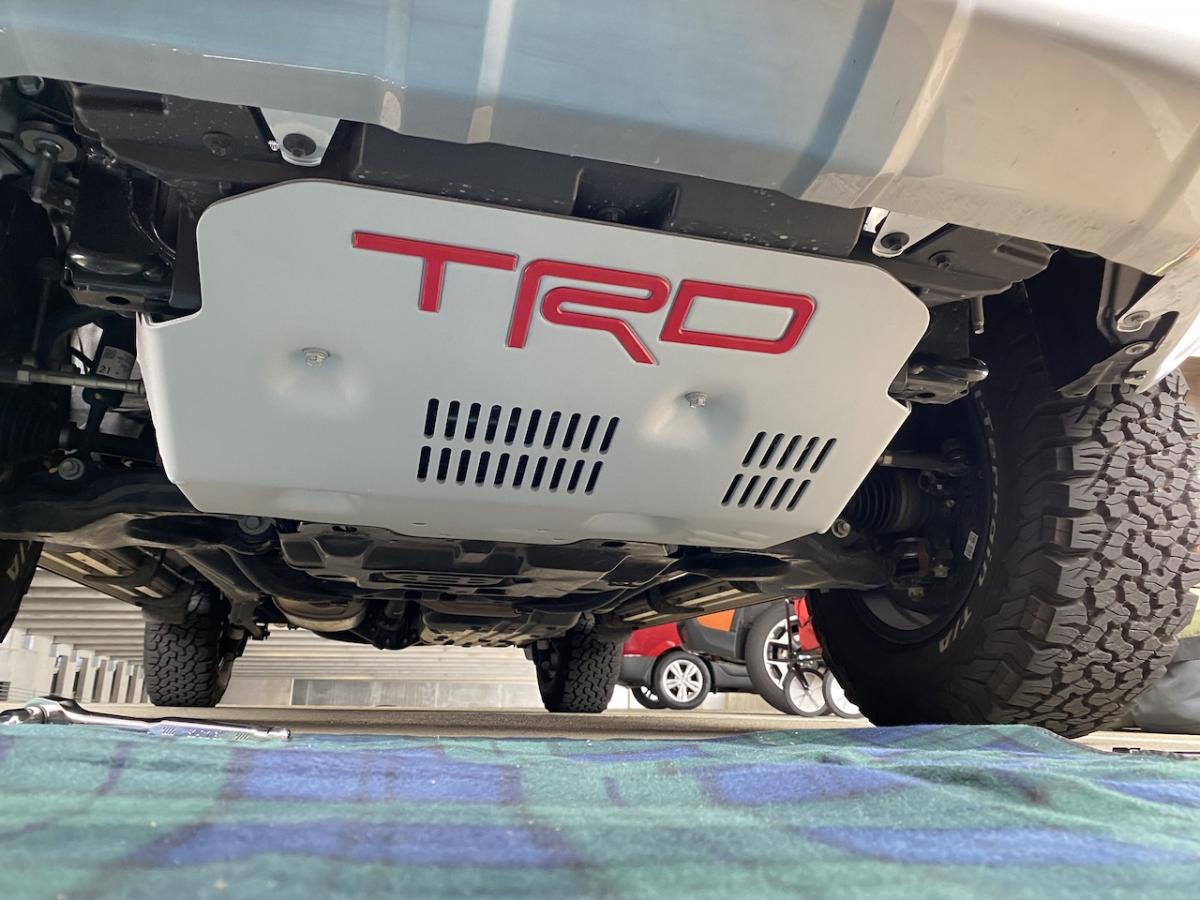

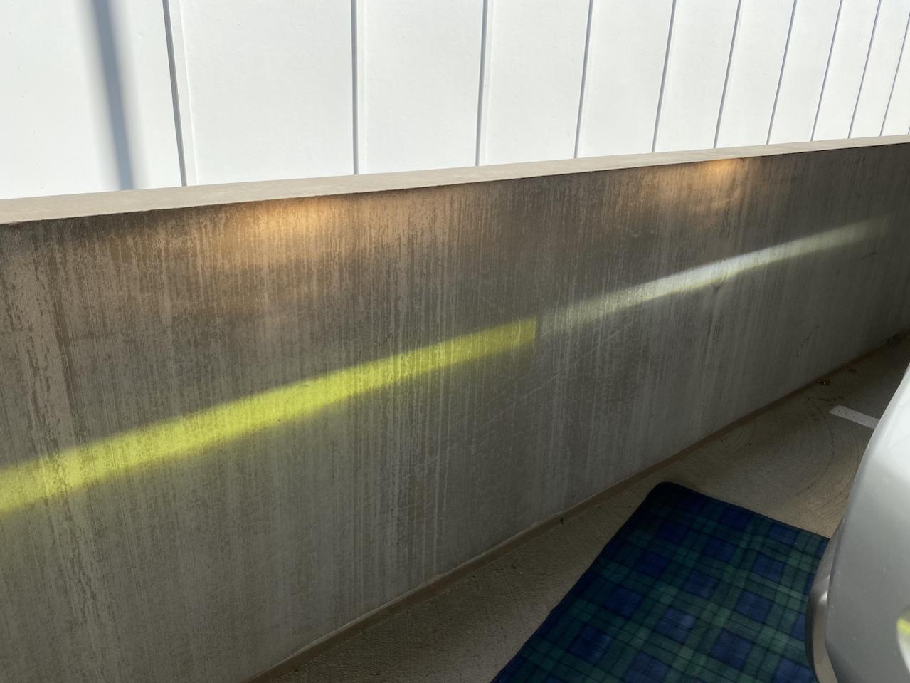

This morning, I installed the cargo divider onto my newly acquired sliding cargo deck I put in a week ago. Then I put yellow Lamin-x film over the LED fogs. I couldn't stand the blue-white light, especially with the yellow-ish halogen headlights. The extreme yellow isn't really better looking than the hyper white, but it should work better for fog and rain. Lastly, I installed the TRD skid plate. I was pleasantly surprised to find skid plate bolts already installed. No need to chase threads or anything. Plus I used the shorter bolts that were already on the vehicle because the long ones included with the plate create too much work. :D Now off to wash it since it's going to be nice for a few days.
