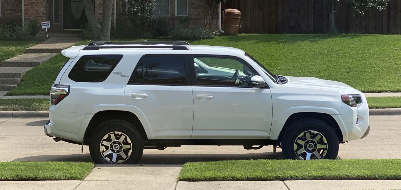

Mine arrived from Wisconsin today! Ready to start modding her!
