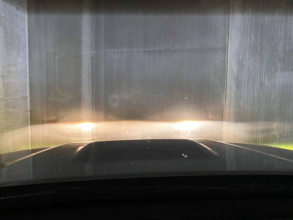

I know you asked someone else but I recently did the same upgrade with these Hella 2.0 bulbs and am very happy with the difference. They have a slight bluish tint that doesn't seem to affect output and makes them slightly whiter. Much brighter than the H11s. I'm getting ready to do high-beam upgrade with the Wagner-boxed Phillips 9011s ($13ea).
The attached pic is in our parking garage in the day, but you can definitely tell a difference in brightness and whiter light, especially around the spot, with the H9 on the right compared to the H11 on the left.

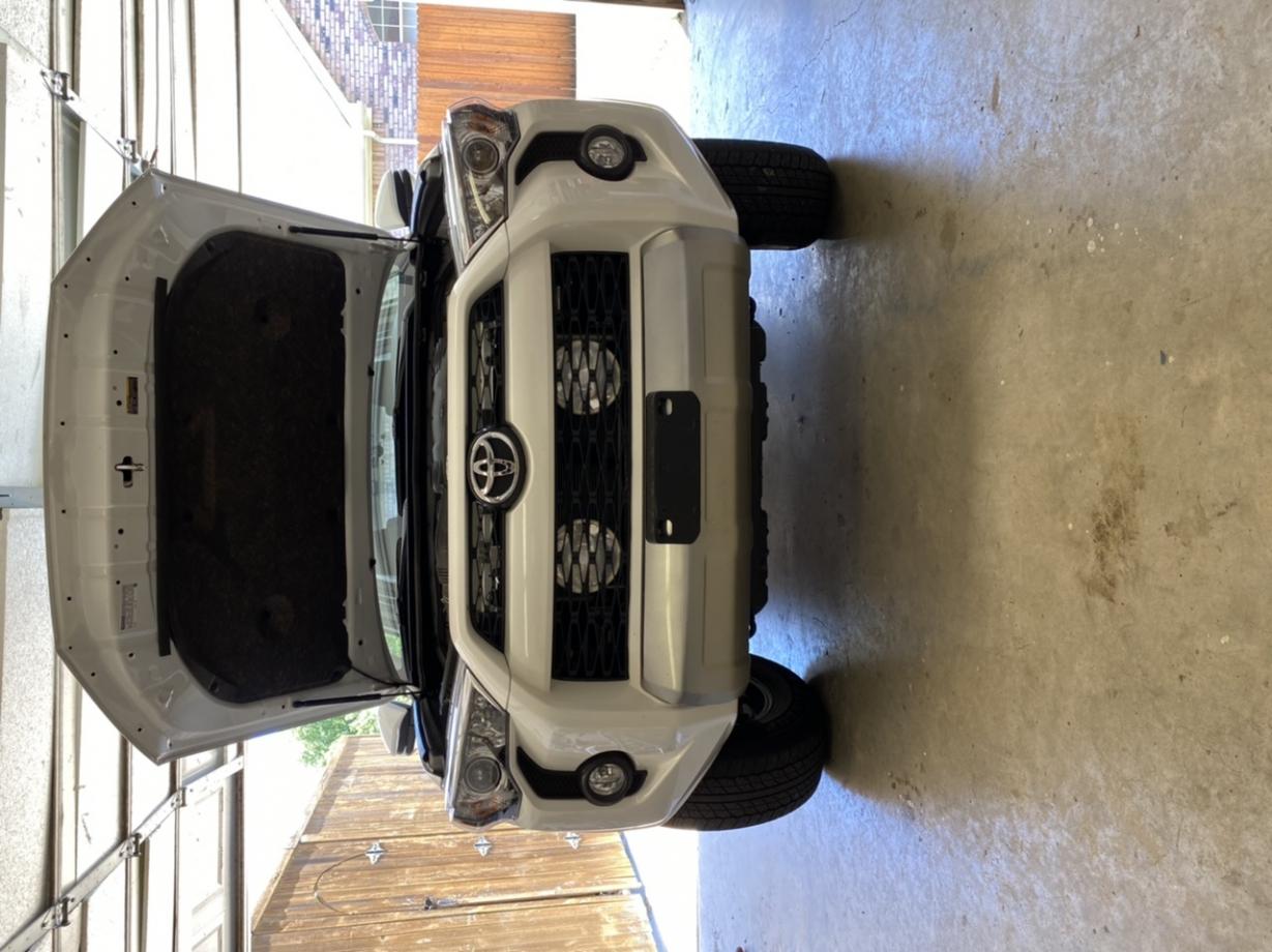

Made a bracket and installed some lights.
Sorry for the sideways pic

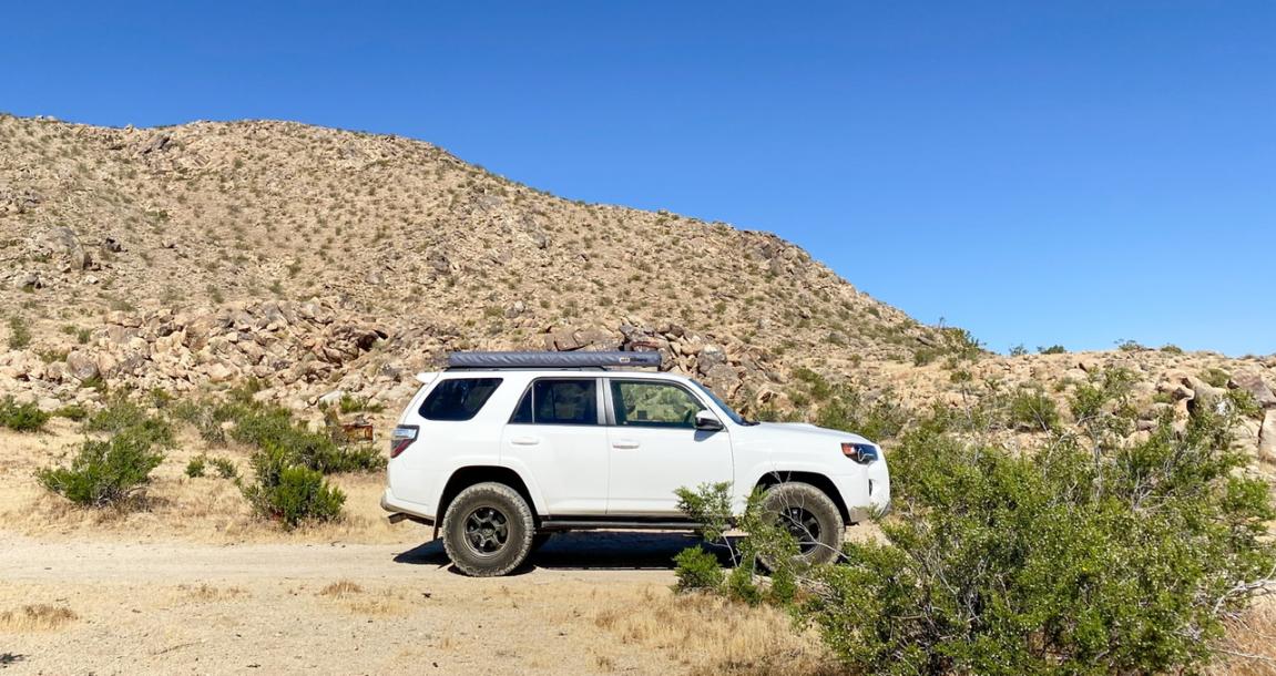

Explored for a bit after shooting. Took the little Runner out, too. Good times.

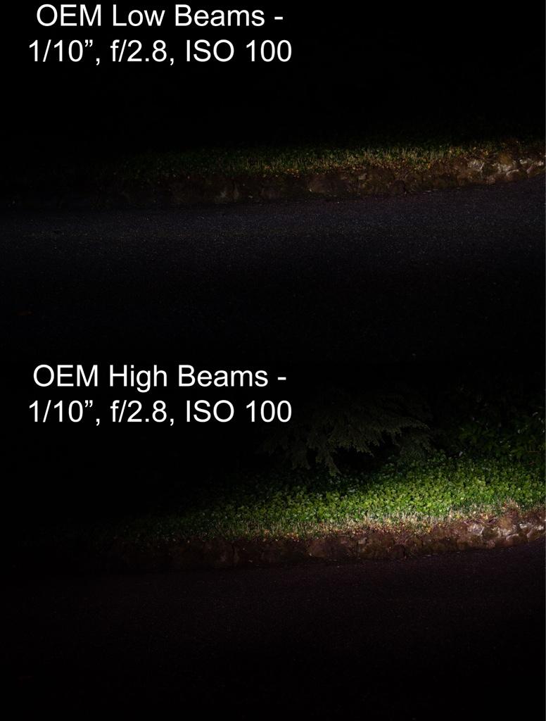

Here’s a comparison between OEM and conversion lights. Same exposure. Almost same focal length. About 25yds to the rock wall.

Well said. That’s something I can definitely vouch for in my comparison image I posted above.
