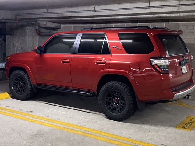

for 265s, if i had my stock UCAs / didnt have my JBA UCAs castered to 4* i wouldve rubbed slightly on the mudguards.
for my current set-up / 285s, definitely needed the UCAs. just took off the mudguards and still rubbing slightly on full lock.
going to get ARC one to do a bmc for me soon coz this set-up will for sure rub on full flex, offroad.
Thanks for replying and confirming I need UCA's. I'm hoping to keep the mudguards and avoid a BMC. Although I've already been in touch with ARC1 in case I need one after the install. If you see a cavalry blue pro waving, it's me. I live pretty close to there.
after lifting the truck 1.5" all corners, I finally upgraded to 285/70/17s on GY Duratracs D load. getting a slight rub on full lock from the mudflaps. trimmed a bit on the front bumper and moved the fender liner forward.
gonna see if i can "massage" the mudflaps further with a heatgun. if it still rubs, just gonna have to take them off.

here she is in our teeny tiny spot in our condo parkade
Looks good! I know that mall area also. I've got the 265 duratracs and just waiting to move up to 285's. I changed to rims with -12 offset and had the same problems with my mudflaps. Removing mudflaps is quick and easy.

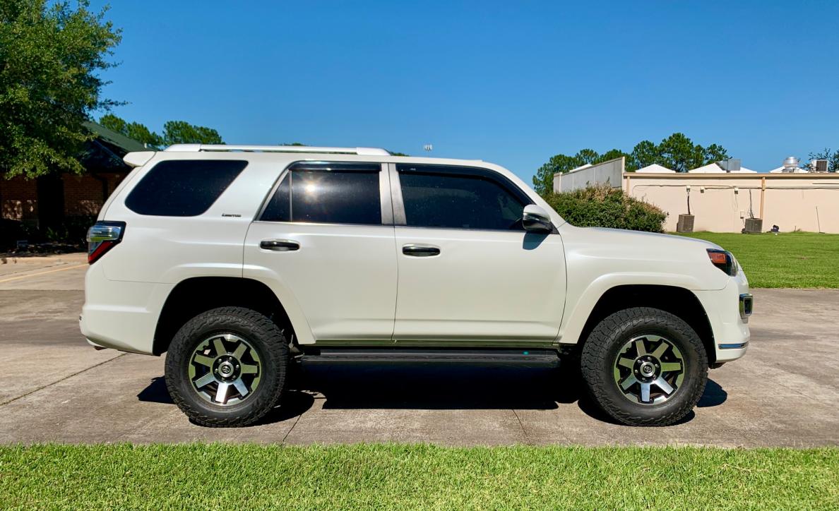

I installed my new wheels and tires on her. Very pleased with the look and the ride quality (K02’s). I have had this same parking spot since 1990 - the year this building opened.
