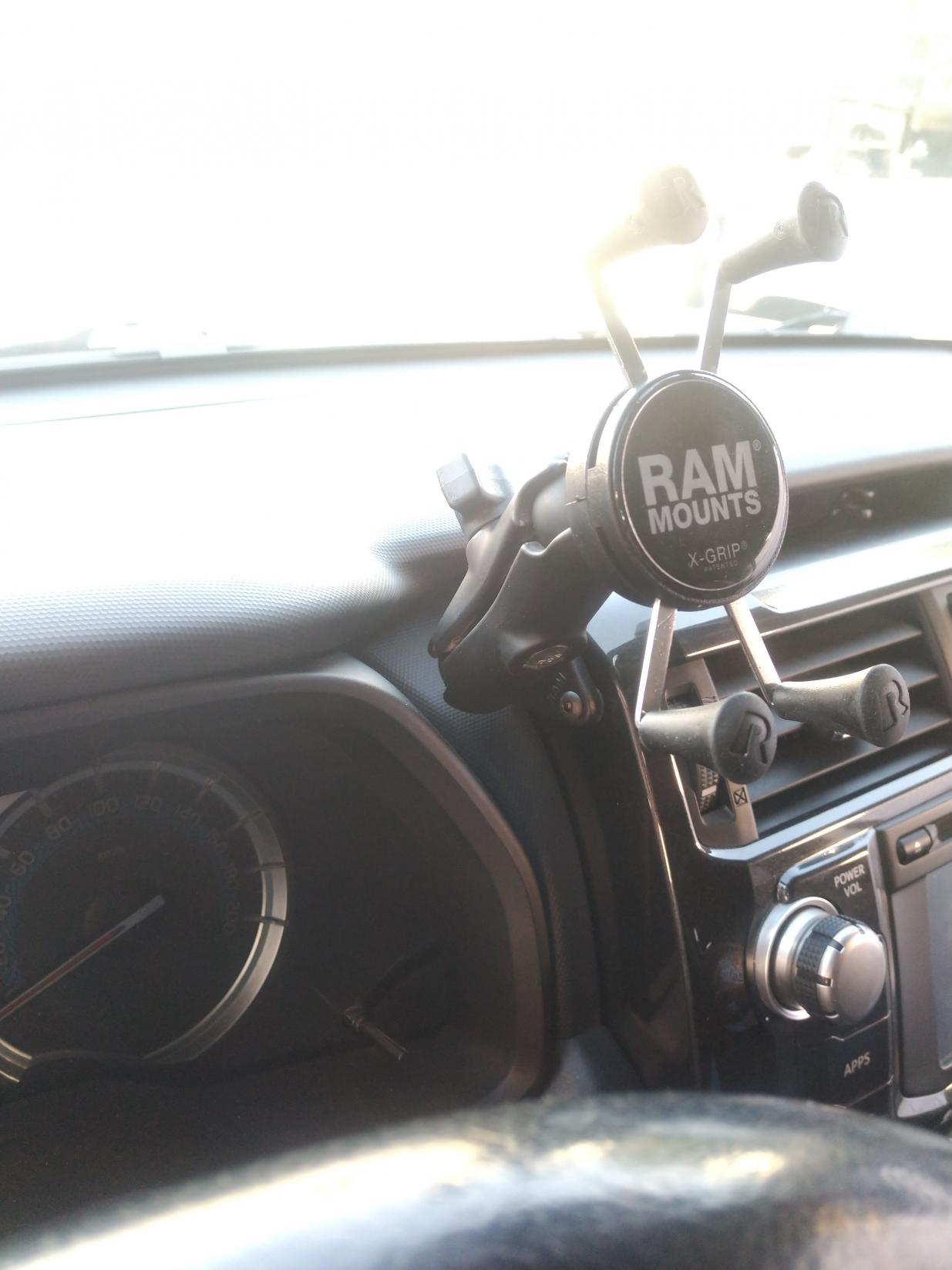

My Ram mount for the Sonim XP8800.

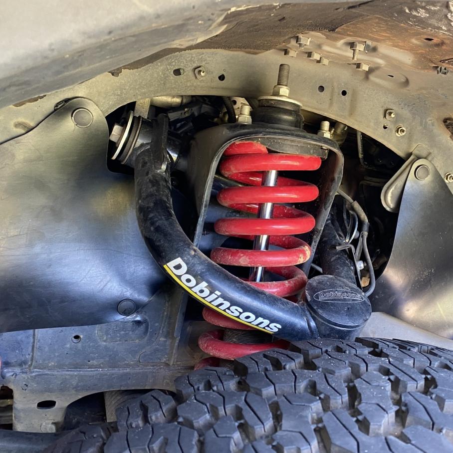

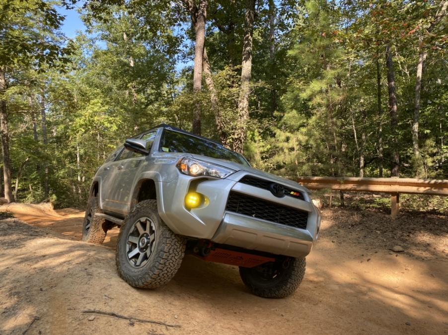

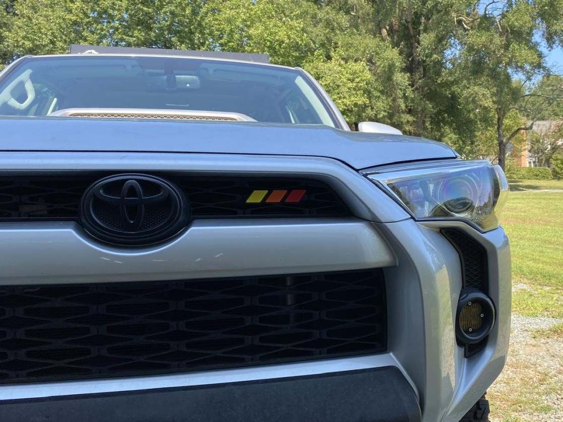

3 little easy ones today, Rad Rubber fender liners, grill badge, and not pictures H9 low beam modification.
Rad Rubber liners are amazing and well worth the money in general but even more if you off road, my OEM ones were torn up already.
The H9 conversion took maybe 3 minutes per side. An exacto knife for the plug tab and some little snips for the metal ring. They fit nice and snug, can’t wait to see them tonight.

Nice - how do you like it so far? I ordered one on friday and just got the same ram mount delivered yesterday. I got pretty fed up with not having a stable spot for my phone.
I'm in the same boat, ready to pull the trigger on a ram mount however I'm wondering how the visibility is with a phone that high up on the dash.
That's where I mount mine, but most of the time my phone is riding sideways (I'm usually running the Torque Pro app). Mine is positioned where I can still see the clock under it, this makes it where the phone blocks the majority of the glare coming off of the hood scoop.
YMMV based upon seat position and driver height (I'm 6'2" and my seat is almost all the way down).

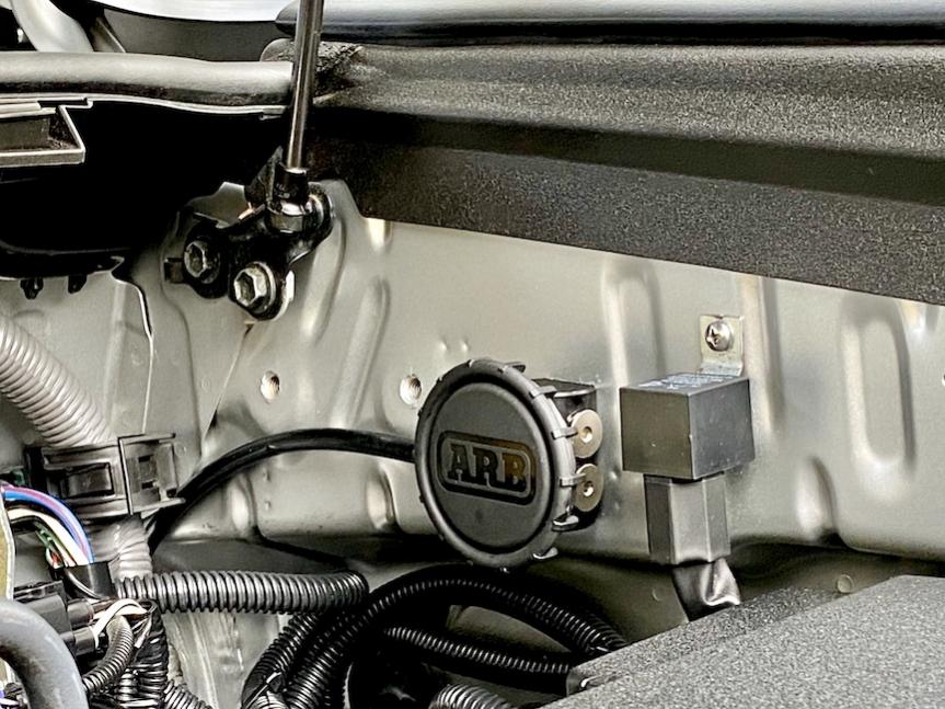

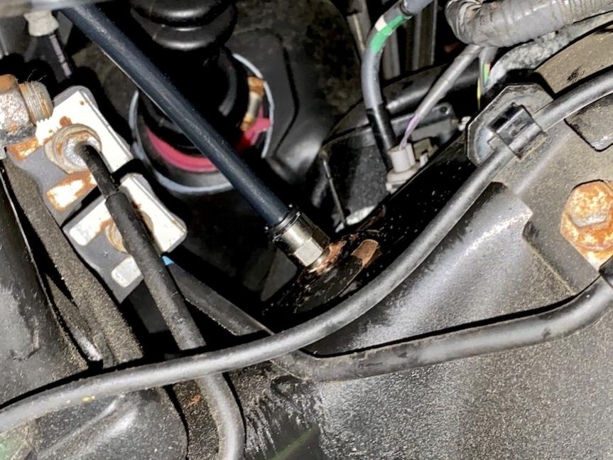

Gave her a wash then a drive this weekend, nothing too serious.
Today finally installed my Diff Breather Kit. Went with the drivers side, down along the inner fender, next to the rubber engine guard, along the top of the frame and then followed the gas/electrical to the back. Not bad, but not without a few curse words.
Bummed to see some paint flake off as I was initially cleaning around the original valve. Have been using Woolwax/Fluid Film for years with good results though.
I love it! Was in the same boat and needed something to hold my phone. Could have just secured the RAM mount on the dash itself but I will be mounting other things as well.
It does obstruct my view a little on the right, but doesn't bother me too much personally.
I just drilled a small hole into the center plastic dash so that it mounts lower and into the perfect location IMO. Perfect visibility
