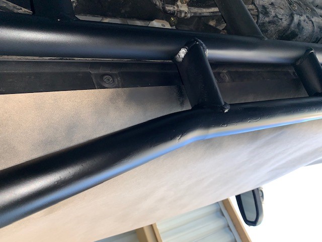

First, got rid of the rust on my sliders and got some rattle can flat black paint on! Dont you just love my art work from my dremel?

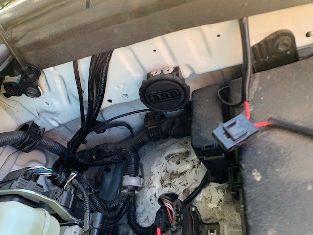

Now it is time for installing the ARB rear diff breather. All I can say is that I should have done this mod using the Wanderlust way and not the ARB way. The line they provide is of the plastic or hard line material and it kinks easily. I hope I left enough line to be in full droop and need to test that before my trip. The filter does look pretty good though. I ran the hose line down the drivers side above the frame keeping it away from exhaust and drive shaft.

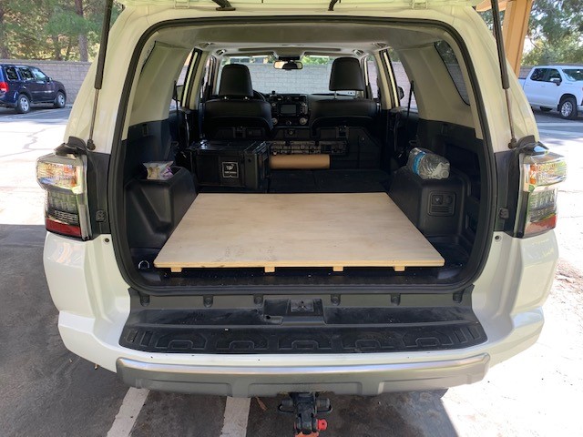

Last, I built the bed platform I got from [MENTION=132734]MeefZah[/MENTION] that levels out the drop from the folded down seats to the actual trunk. The build was super simple and it cost less than $50. There is zero drop now and it fits perfectly and is super comfy!

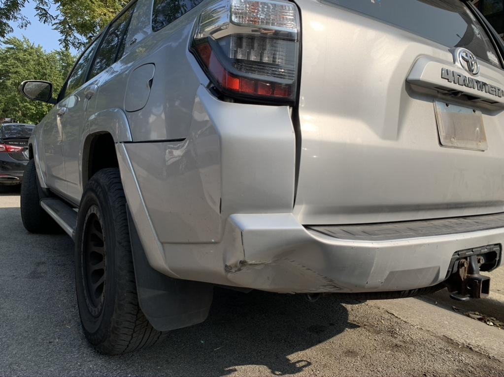

I accidentally backed up into a trailer for a bobcat that was sticking out into the street from the corner...
F*CK MY LIFE...
Need a rear bumper cover for a 5th Gen SR5 Premium. Ideally in SILVER...

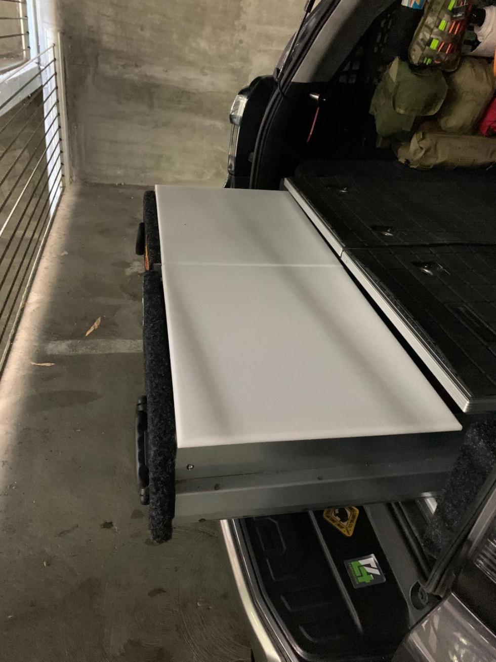

I need a multi purpose table for tailgating that is easy to wash, easy to store, food grade safe, and cheap (when compared to hipster overlanding hyped up bullshit) so 2 cutting boards and a ton of velcro later......

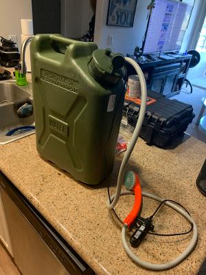

cheap hands, feet, anoos and dish washing system for less than 100 bucks
I stole this idea from a gentleman on youtube but it consists of a 5 gallon Nato can (you can use any canister you want) and a cheap chinese water pump (make sure you get one where the on/off switch is separate from the water pump).
I like the jerry can, because I can silicon the cap closed to make it a enclosed system to use either as a:
1. onboard water system to wash hands, feet, anooses, plus dishes.
2. can remove it to use it as a shower system
3. bought a extra nato cap that i sealed with silicon so i can transfer this to any nato can within the group and keep water contamination to a minimum
I like this pump because:
1. on/off switch is separate to the pump
2. powered by rechargable lithium batteries and is recharded via USB.
Anyways, here are the products i purchased:
Amazon.com: USGI Plastic Water Can, 5 Gallon, Green: Sports & Outdoors
and
Amazon.com : KEDSUM Portable Camping Shower, Camping Shower Pump with Dual Detachable USB Rechargeable Batteries, Portable Outdoor Shower Head for Camping, Hiking, Traveling(+ Handheld Bidet Toilet Sprayer) : Sports & Outdoors
cheers

That is repairable for free if you have the patience. I had the same dent on my 2006. I used my wife's hair dryer to heat up the area. Use a heat gun if you have one, just be careful not to melt the plastic. Get it good and hot, and then use a 2x4 or large handle from a hammer or something and push from the back. It should pop out pretty well. Then use the heat gun again and slowly smooth out the rest of the bumper, by using a smaller tool like a ratchet to push out small areas. Mine came out great (it's night here so I can't get a good photo), other than some scrape marks. Being that it's a 4runner and not a Rolls Royce, I couldn't care less about some scratches on the bumper. Good luck

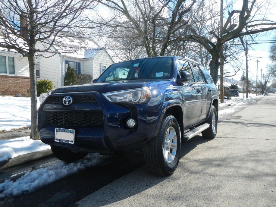

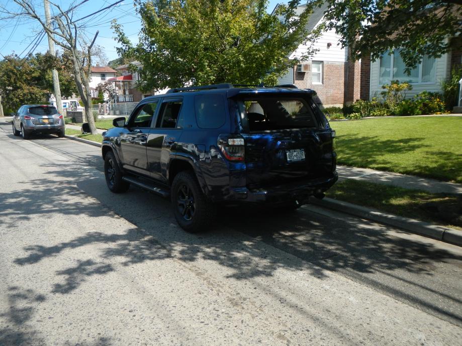

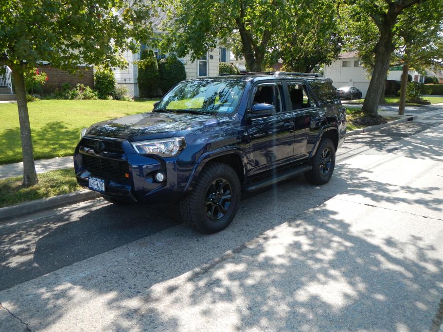

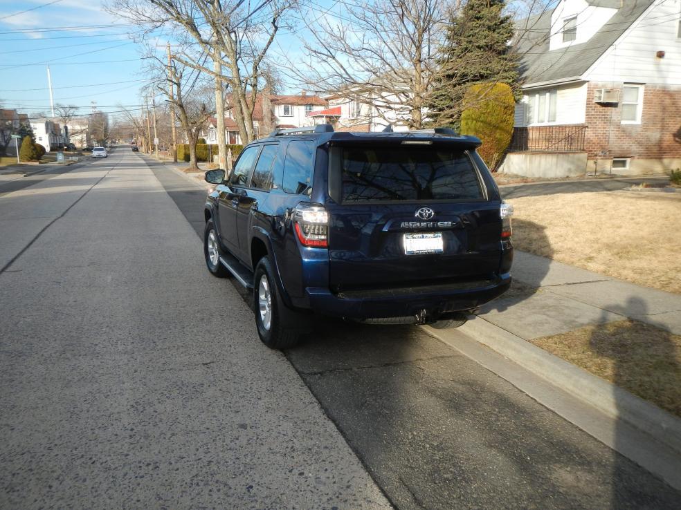

Finally got everything blacked out that I want to. The last thing was the wheels, painted them gloss black. The first two pics are when I first brought it home in Feb. 2019. Last two are how she sits now. Nothing major but I think I'm settled and happy with it now. Maybe...
Those wheels actually look REALLY good in black. Well done sir!
