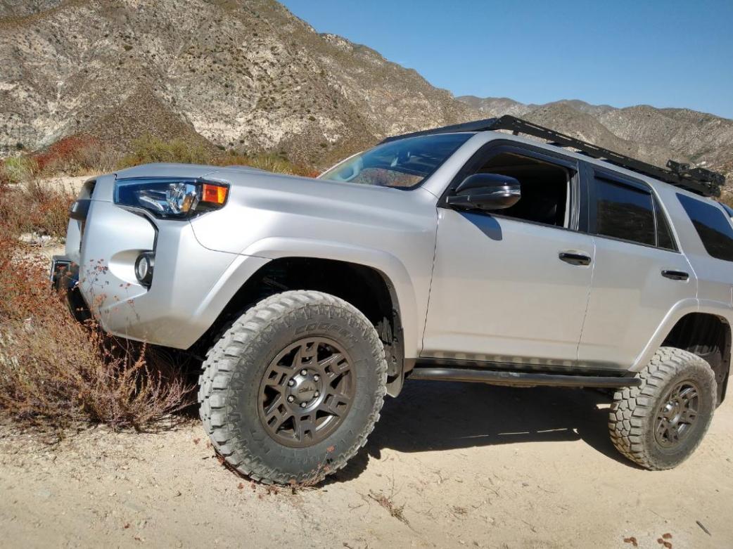

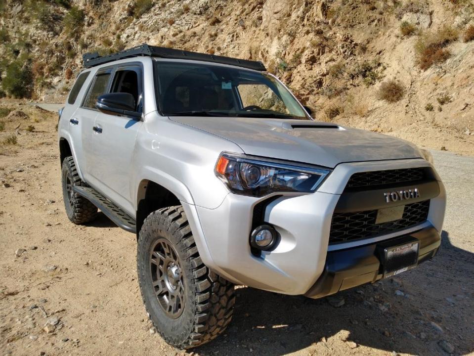

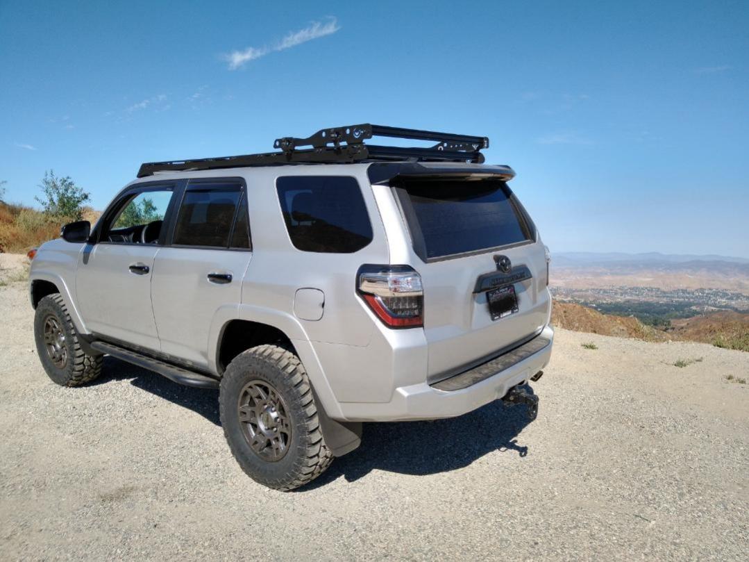

Installed Cooper Evolution M/T 285/70/R17s.

Removed the eight primary bolts from my Prinsu rack, applied ultra black RTV silicone inside the bolt holes, applied a threadlocker and sealant to the bolt threads, and then reinstalled them. Fun times.
I'd have recommended... not doing that. Black RTV is an engine gasket sealant, not a roof hole sealant. Great for oil resistance on a valve cover seal, not great for weather or UV exposure. What can happen is that (unless it's rated for long term outside use), silicone sealants can dry out and retract from joints, allowing moisture to creep in after a few years. This is bad.
It's also going to be a total bear to remove that gunk if you decide to change to a different rack.
Next time, use a dynamic seal that won't cure or harden, like butyl rubber. You'll notice that Toyota didn't slather silicone under the stock roof rack- they use a sealant that stays tacky.
