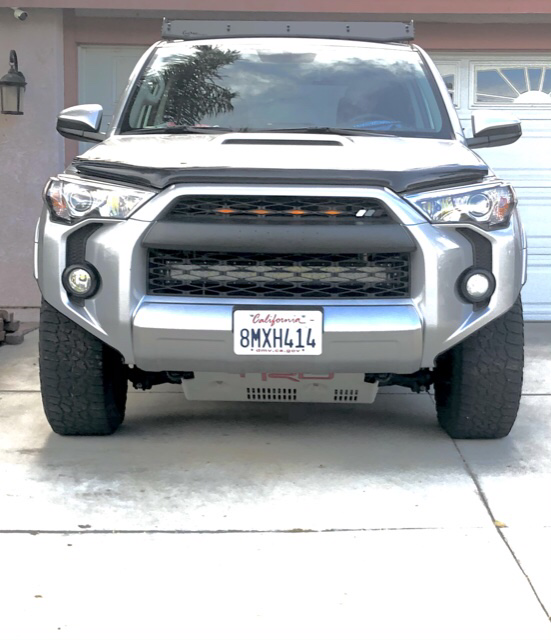

How’s it going everyone! Been registered on here for a minute never posted anything! Here’s something new I’ve done today to my 4Runner got my bumper cut(viper) I think it gives Runners a better looking stance. Shoutout to Gerry at Beast Fab in San Bernardino CA for getting this quick mod done!
