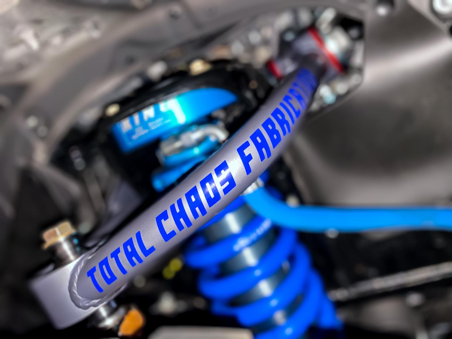

Finally!
At last a long await for my TC UCA finally came in! Had them installed and was able to make better alignment adjustments

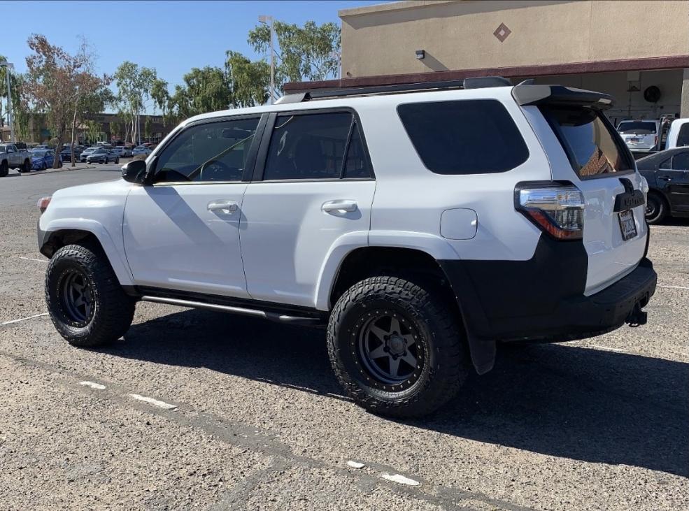

Got some 285s on the truck and took them out to an off road park this past weekend. Follow me on Instagram @appa_rnr

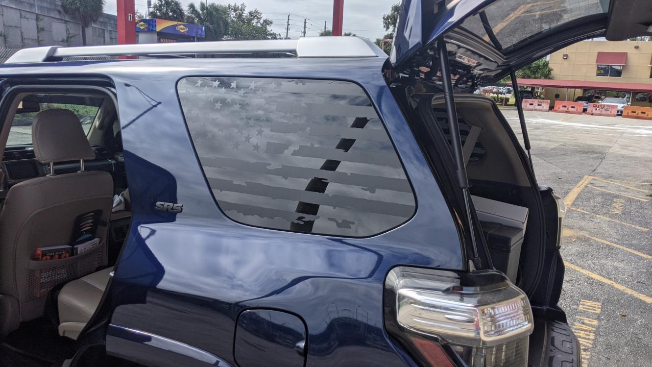

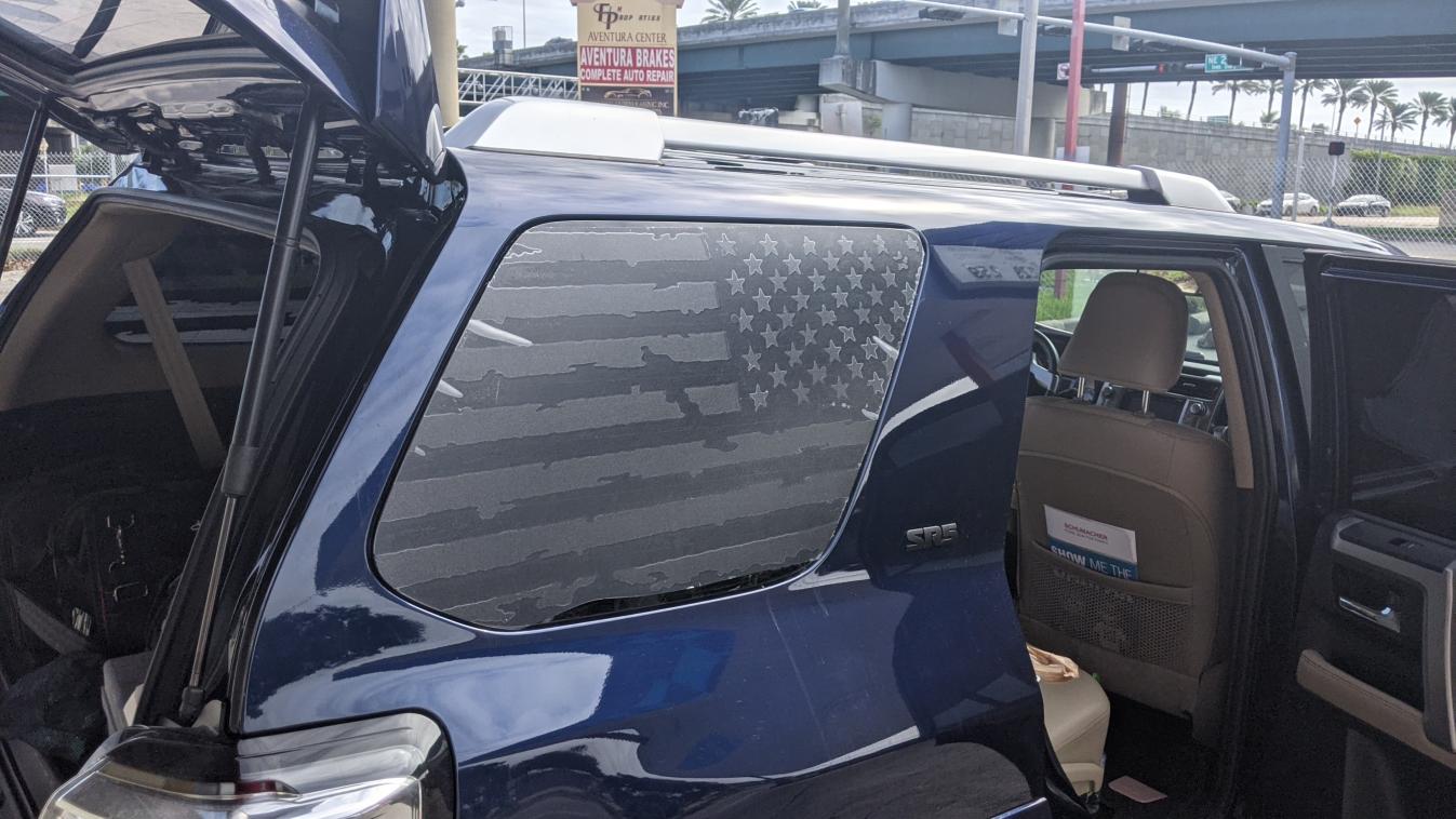

Window Decal installed today
Got a little anxious on the driver side, don't think I let it dry enough, but passenger side should look good.

I'm not sure of a true really measurable advantage but I like the tall skinny look, tire weight is usually less than wider tires. As far as the advantage, I've read a lot about skinnier tires having better performance off road. Given the weight of a vehicle, more pressure exerted on the tread versus a wider tire that spreads the weight out. Equals more grip. And airing down allows a skinny tire to become wider and fatter for sand and stuff. Maybe the differences are all minimal in reality, I'll test them out in the same terrain I've driven my old tires in.
I went 255 for the 33in size, the look and if I get better performance because they're skinny... Win win win!
Why do I find out about this stuff right after the installs!
Oh well, I like the look for now.. Haven't taken them off toad yet. I'm hoping they at least perform better than the Toyos
255's tend to get better gas mileage over 275/285. 255's tend to get better traction when driving in the snow(on the street) because they will dig down to the road to get traction as opposed to floating on top of the snow. Think about how often the military runs tall skinnies on a lot of their vehicles. If you do a lot of sand/deep mud 255's won't be the best since they don't float as well. But I am still getting 20-21mpg highway with 255's and a 3" lift.

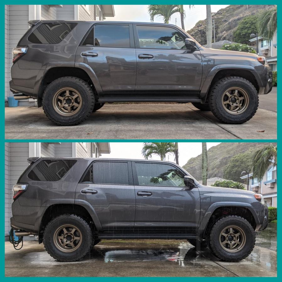

Swapped the TRD Pro 4Runner 3x13inch springs, and took out the ToyTec 1inch perch for TTUE FJ TRD 3x14inch 600lb springs. Gained an additional .75inches of lift. After research, and talking with some members here, I found out the old setup wasn't really giving me a 2inch lift. Now after the swap my measurements make sense, and is about 2.25 front lift now
Top picture is before, bottom is after spring swap
Very happy with the look, and surprised by how much better the ride is

Looks good! Looks like a lifted 4Runner now. I need to keep this setup in mind down the road. Did you add a spacer back upfront to to the 3x14" springs? Also, what did you do in the rear?
Thanks to you and others I talked to. Haha. Made me realize something was up. Removed the ToyTec 1inch perch spacer, and put back the stock perch, so no more spacers. The front now is stock TRD Pro Bilstein setup + FJ 3x14inch spring which gave me about 2.25 - 2.5inches of total lift for a non-Pro trim. I have Bilstein 5160s in rear + Eibach 1inch lift springs.
After I upgraded to 285\70\17s it totally looked like a stock Runner witt no lift in pictures. Haha, now it looks like it's got a lift again
