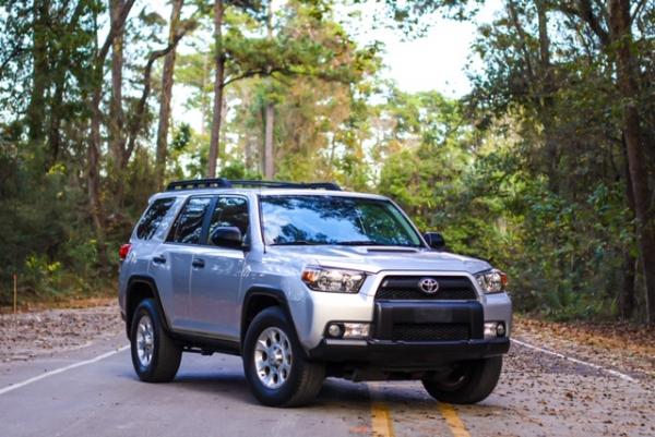

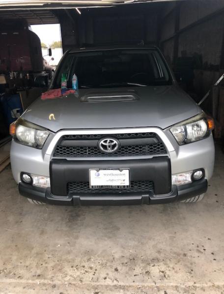

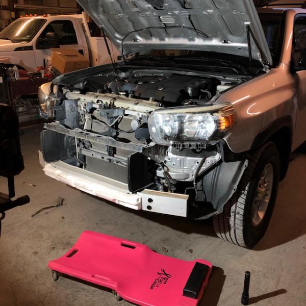

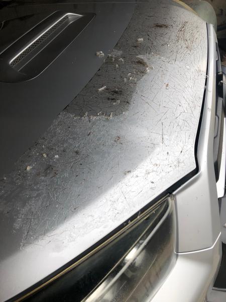

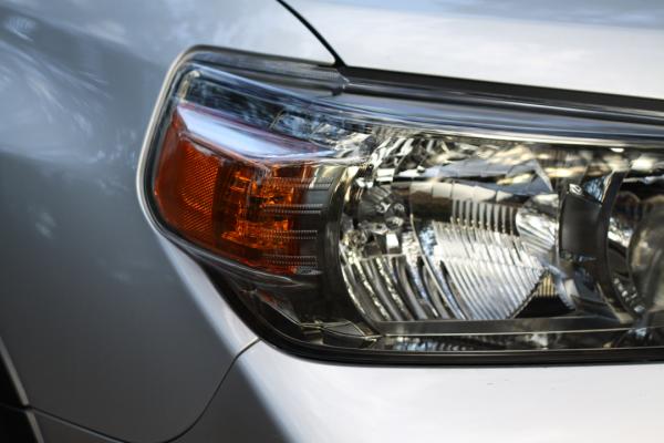

Scored this one owner '10 Trail. Sold my '88 and needed something a bit more modern.
Its been a fun 2 weeks with a few aesthetic fixes. One being the decaying clear bar and faded headlights. A trip to Toyota for some OEM's worked out nicely. After some trial and error I finally got the bra and adhesive off without scratching the paint. God this stuff was everywhere, hood, doors, door trim, under the handles.
Got some more upgrades coming for this weekend's camping trip to Hidden Falls

I have the same bad clear bra on my ‘ 06. What did you do to remove it?
Harbor freight has these scrapers. They are stiff but a bit flexible.
Any auto parts store should have that turtle wax adhesive remover. I went to Auto zone. It’s a familiar smell and I can’t remember what it is but it’s an orange scent of another cleaner.
First scrape off top layer of film then spray, as that acts as a lubricant. Then more scraping.
You won’t scratch the paint.
I had to dig deep into YouTube to find this but man it works.

A heat gun on low setting has worked great for me. Peeled right off in one go and no need for scrapers. Don't need to heat it up much either. Zep heavy duty citrus degreaser took care of any excess residue.
