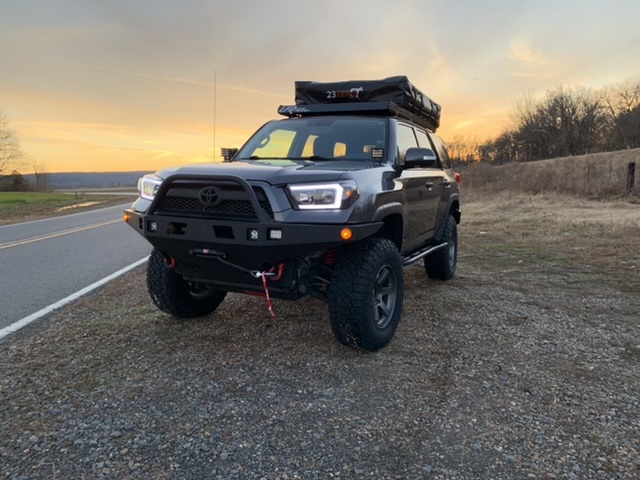

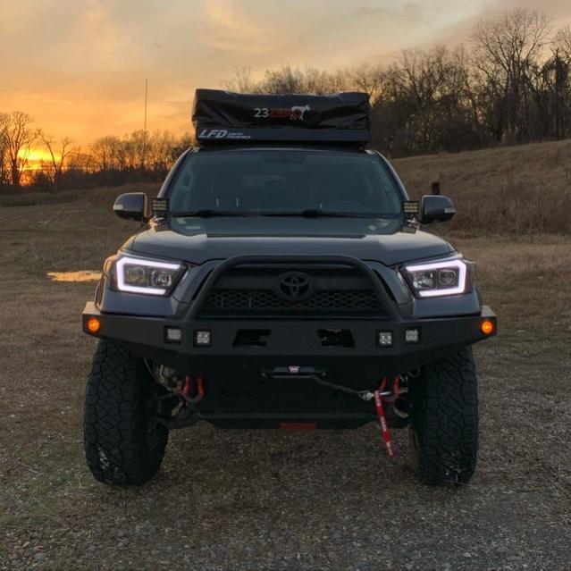

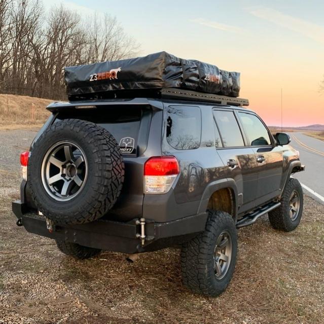

New tires... and some other stuff last week
Finished up my Coastal rear single swing on Tuesday last week. Then installed my Dobinsons lift and JBA UCAs on Wednesday. Got tires today to finish it off. For now.

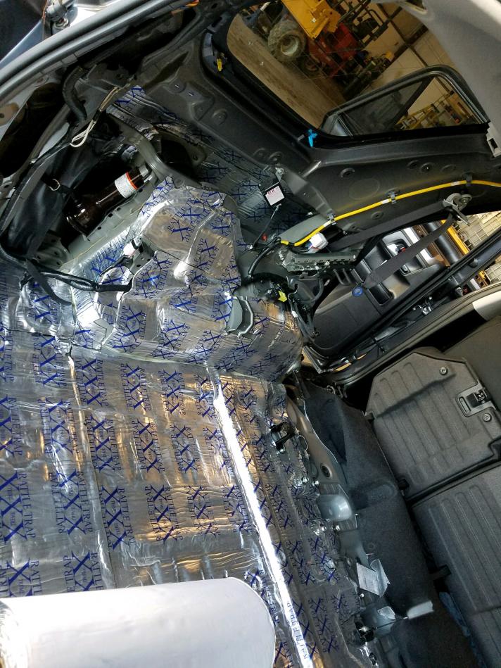

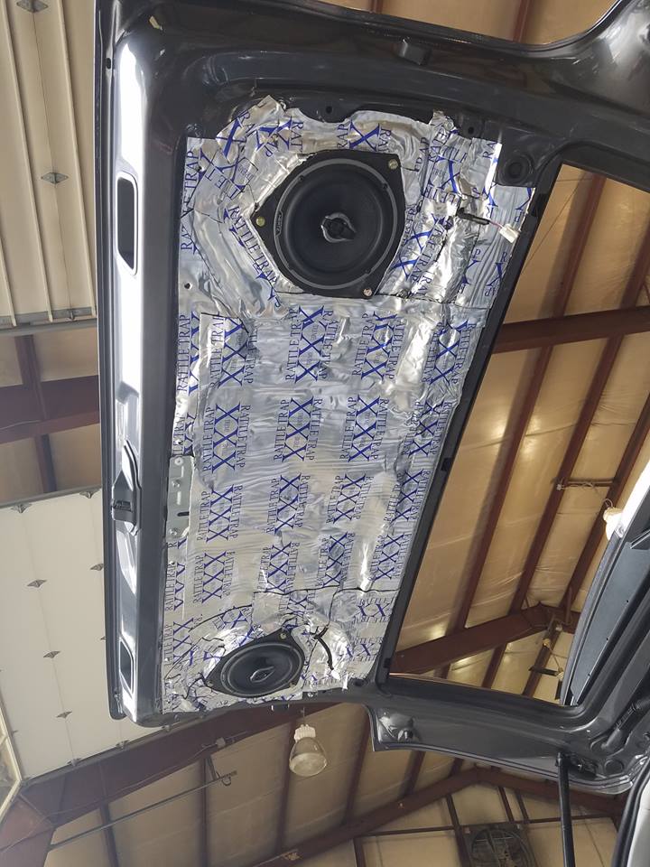

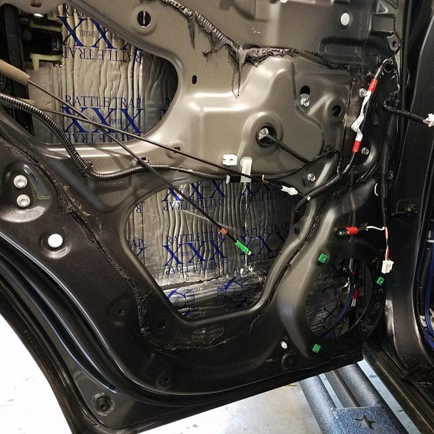

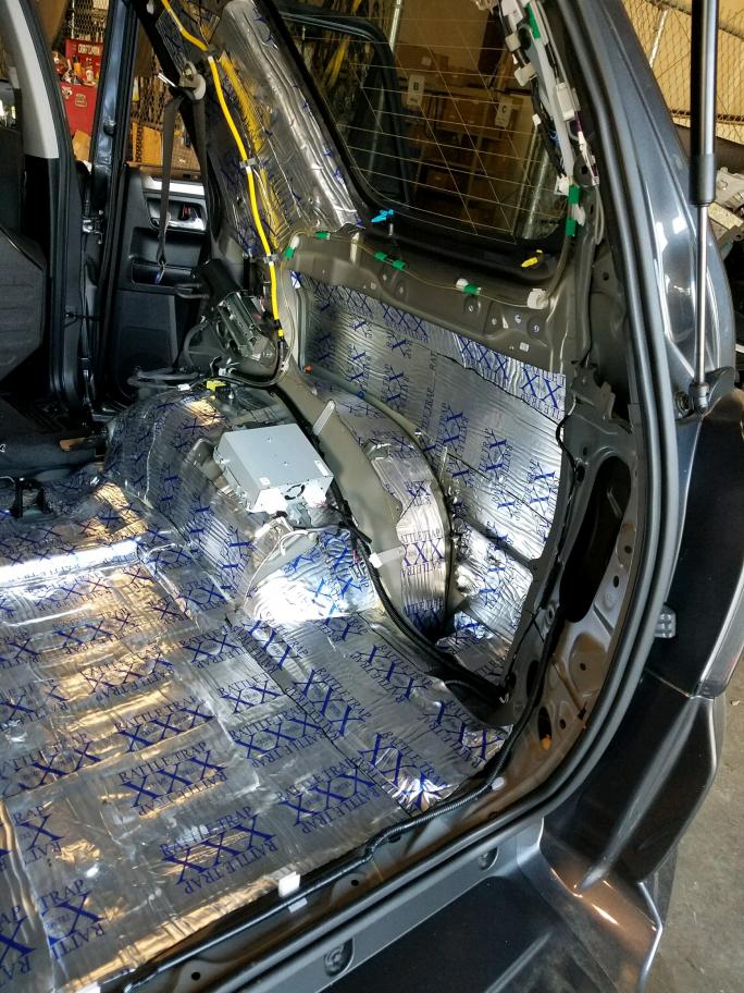

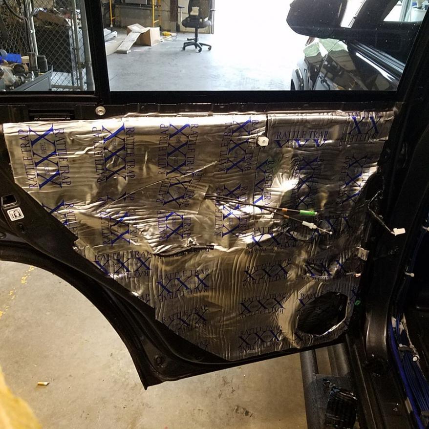

Would love to get a before/after verdict from you!
I'm open to sound-dampening my doors but worry that most of the sound is coming through the window anyway so I'm just not so sold that the benefit is there...
Sound deadening done correctly makes a huge difference. Only areas I haven't done yet are the front cabin area and the roof but I do have the materials. Night and day with and without and the doors now close with a solid thud rather than a tinny hollow sound. Inner and outer skins done on all doors and tailgate.

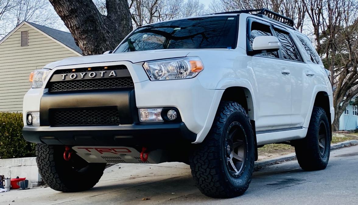

Being half Canadian, felt it was fitting to do the Canadian SR5 bumper swap on my limited :-) love the way it looks, and gives a little unique flair.

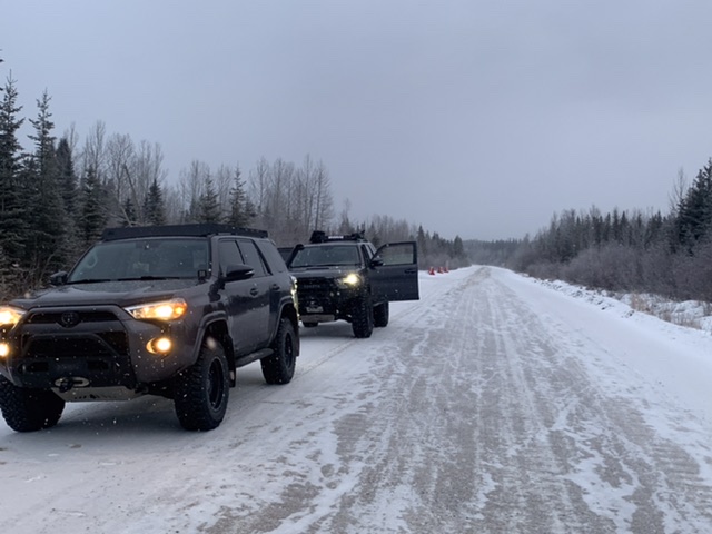

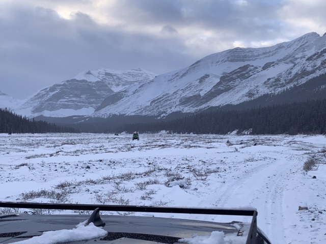

Did a quick run out to Ruby Falls on the weekend with a few buddies. Great trail ride. Had some issues getting over a 3ft ice ledge in a half frozen river... ended up with 8inches of water in my rig and had to be winched out. Spent till last night drying everything out. 4 fans 2 space heaters and a wet vacuum. Worked wonders. Let it go another 24 hours after dry just to be sure..

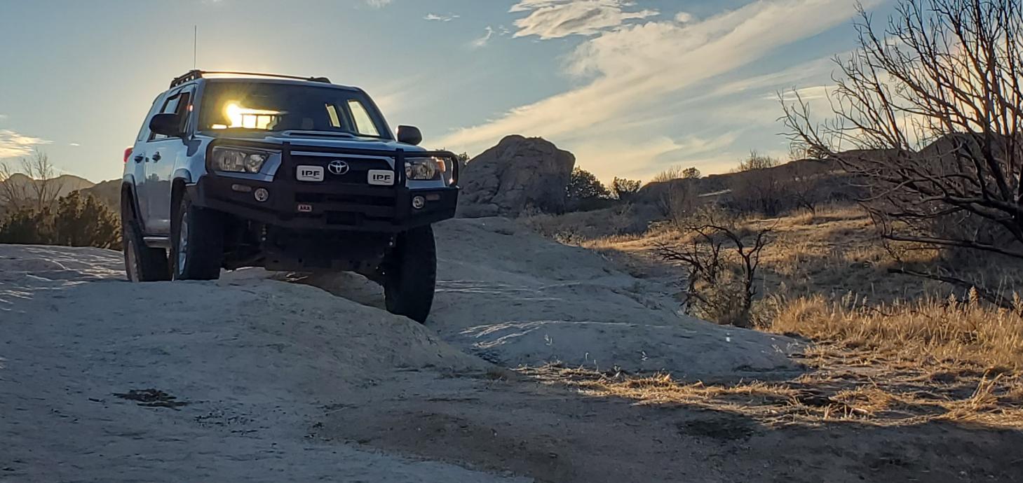

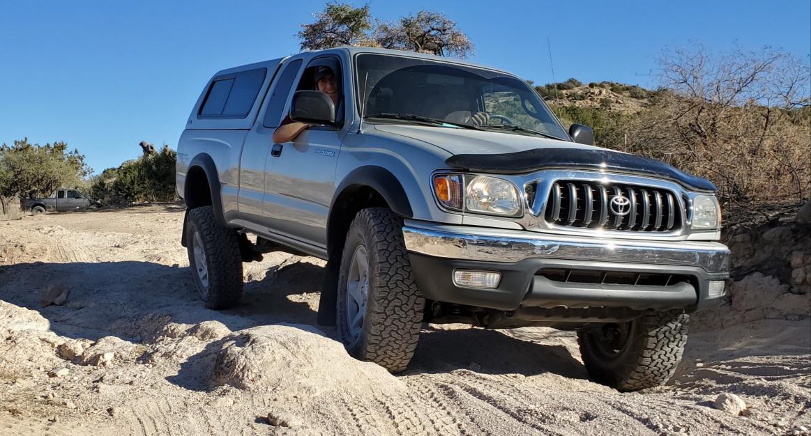

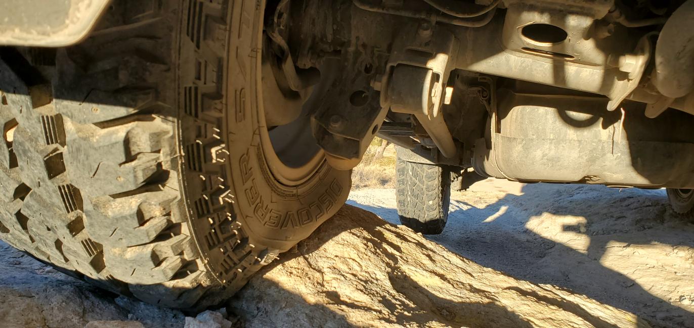

Went outdoors this weekend
Also tested my brother in law's new 04 Tacoma. It's a prerunner, so it's got a locker and it came with new ko2's. It followed the 4runner everywhere, and I got worried a few times. Surprised, but not surprised!
I'm loving this. Looks very much like the Trail Edition. Can you point me in the right direction to do this? I wanna research it and price it out and all that.
Thanks!
Edit: HA! Just saw your other post.
*initiates slow clap*
Should be good tho. Throw some rice in that *****.
Thanks!
I bought these parts to make this happen (from Toyota), the bumper came from Amazon, and for paint, I started with a white base, then did duplicolor white pearl (070 code), then a few layers of clear. I trimmed my existing fender liners quite a bit with shears (whatever it works lol). The grille is from Toyota Accessories Guy. For the bumper portion (not including grille) I spent about $400 which is really doable.
1. 52112-35150 (fender trim)
2. 52113-35140 (fender trim)
3. 75392-0R010 (fender trim retaining clips x20)
4. 52115-35141 (fender mounting bracket)
5. 52116-35131 (fender mounting bracket)
