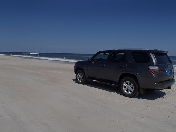

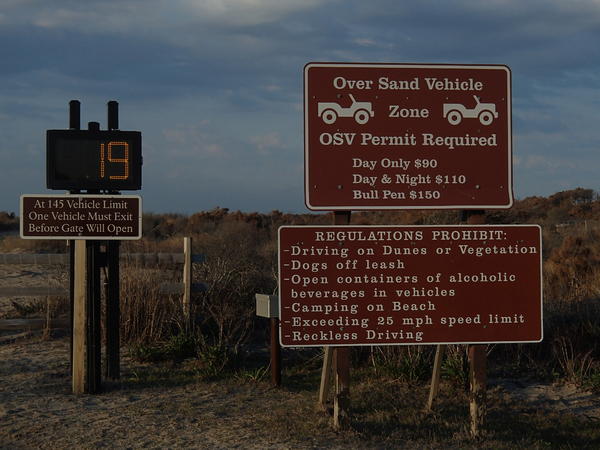

Last weekend we went to the beach - Assateague Island National Park. (No way it was this empty Memorial Day weekend.)
Fence is the MD/VA state line. Yellow thing is metal, some speculate a bouy that broke free.
Did some fishing.
And saw the locals.

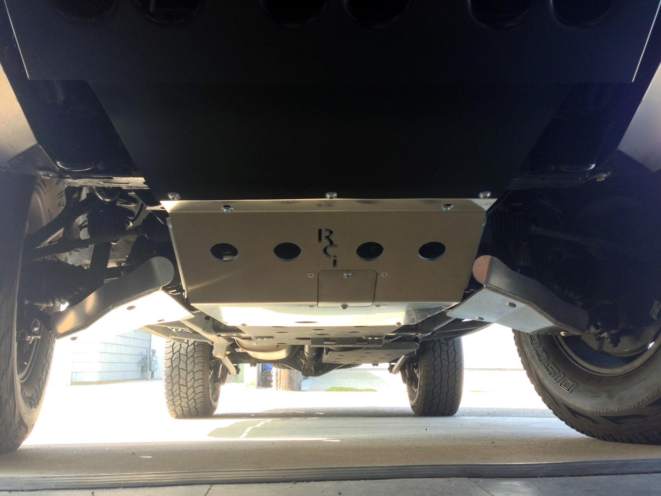

Here's a better pic of the front and underneath:
I cut the ARB front skid so they meet exactly at the RCI skid width and trimmed the front (part that would normally connect to the cross-frame if you didn't have a lift). I also had Josh pre-drill holes for the ARB skid to mount to.

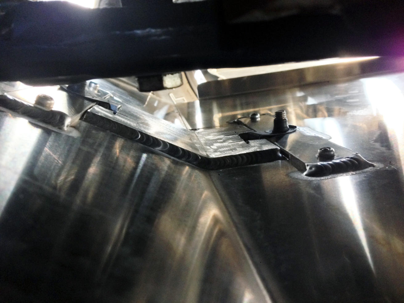

For the oil door, I had Josh reinforce (double) the thickness of the oil door and weld the mounting brackets vs. rivet only. Came out good. Josh stated that the rivets they use are rated to 700lbs.

Yes, that looks a little beefier. Great stuff!

Yeah that's beefier :D I like it. a full set of those is third on the major change list, hopefully this winter/next spring.
Although I think I would rather have the mounting brackets intentionally fail vs trashing the skid or the door. Your hopefully going to stop when you hear it fail, I'd be afraid of snagging a hard/sharp stone in the door and tear the whole thing off. Drill out the rivets and pound the f'n mount brackets flat again, re-rivet.

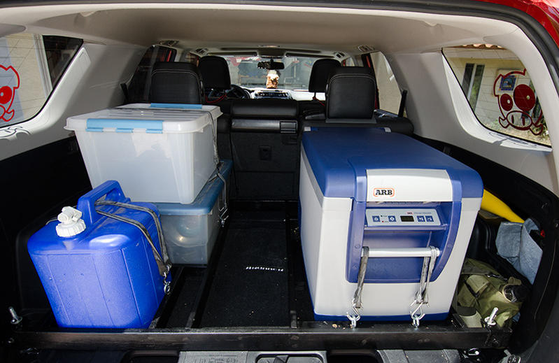

I redid the layout of my tie down rack for the cargo area.
The frame is getting thrashed from all my changes and I've not even had it offroad yet :D
But with the new fridge and a trip to Moab coming up I had to hack at it to get it ready.
[MENTION=107862]HarvestHawk[/MENTION] I'll probably wish I had a set of those by the end of the 12 hour drive from San Diego To Moab and then back again!

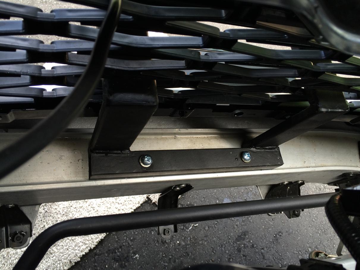

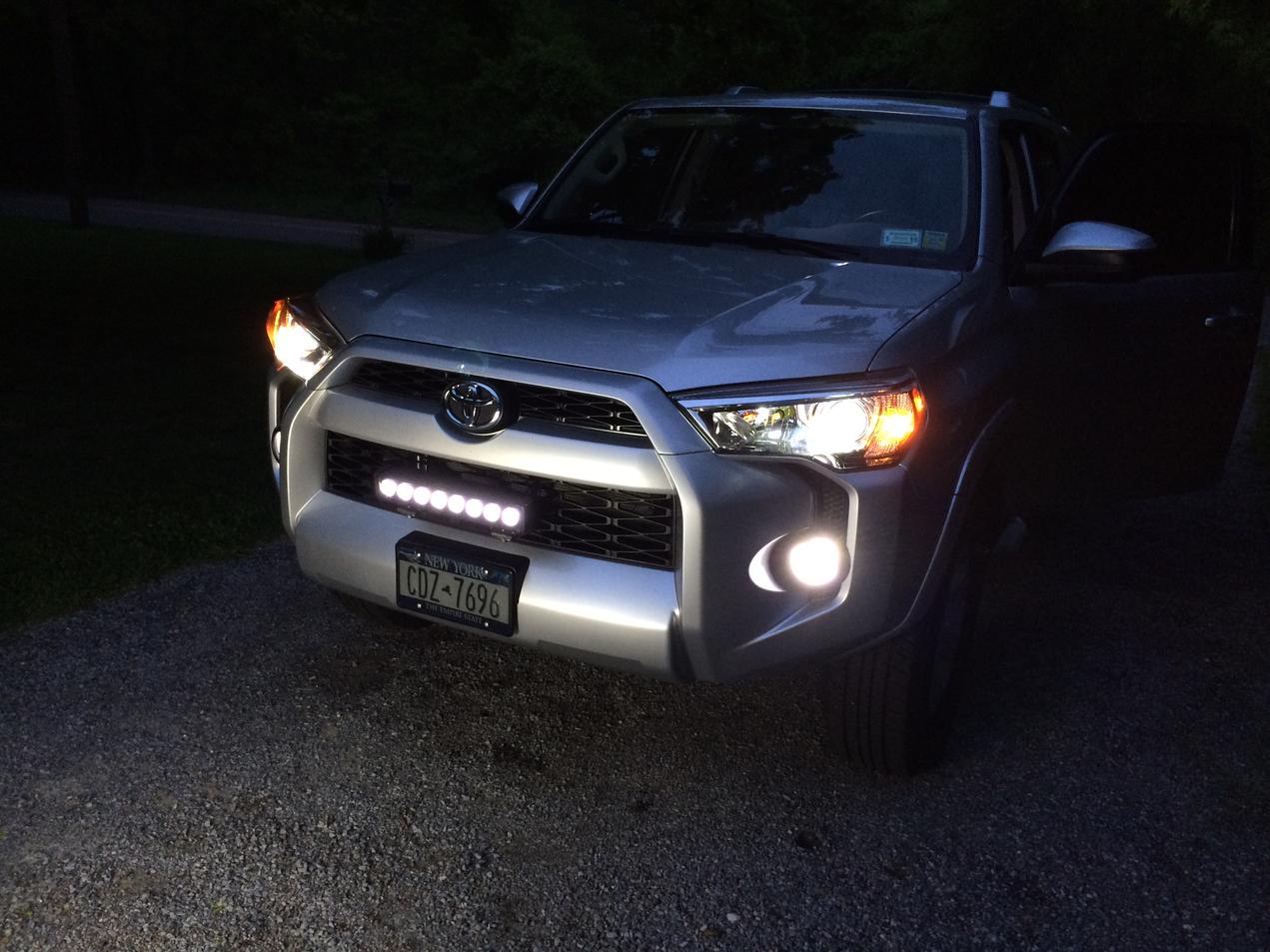

fabbed up a light bar bracket and installed a light bar.
I got it off ebay for 99$ it seems like its really well made. We will see/.
edit: sorry for the large pics

The light and mount look good.
One thing though and not sure if it's the angle of the pic but the light looks off center and a few inches more to the passenger side.
