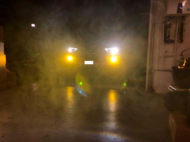

Added some MUCH needed lighting modifications...

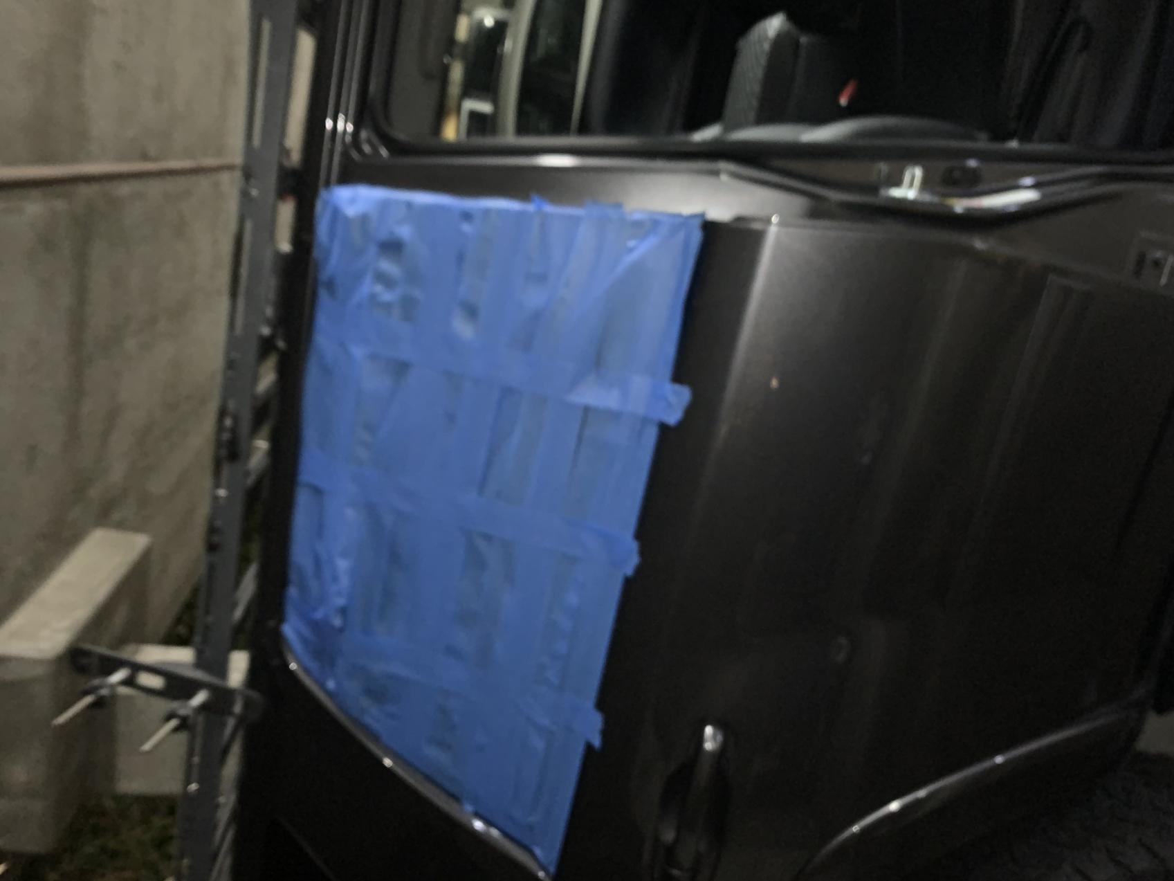

gotta love thieves.. smash and grab some stupid jumper cables and my jump box. The only day i forgot i left it in the backseat. *******, climbed in and then climbed out of the window (belt and clothing marks on bottom of the window frame). I hope he cut himself and dies by a million paper cuts.
great way to spend the day cleaning glass, and dealing with insurance.
second time someone broke in within 30 days. The first time, i found some dood stealing my license plates at 1am while i was walking my dog. .told him to wait there while i go get my gun so i can shoot him in his face. So of course, he jumped in his car and took off..... I didn't realize he stole my plates until after he took off. less than 2 weeks later, someone breaks my window....

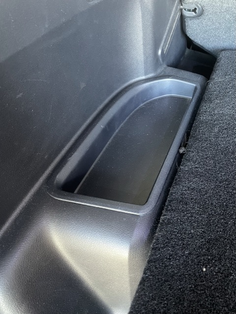

One mod you can also do is free up the trays on top of the wheel wells in the cargo area. There’s a small space underneath each, with more room on the driver’s side. Search the forum, there’s a few threads on this.
For the wheel wells, do you meat cutting the plastic open or?

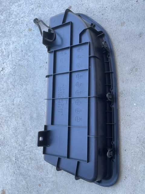

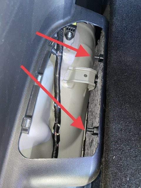

Those trays on top of the wheel wells are held down by two screws on the interior side (see arrows) and three clip-tabs on the body side. See pics.
There are two methods to make those trays removable. The first is brute force to break the plastic screw tabs on the tray. The other method is to carefully pry up the tab (exterior) side, slip your hand in there with a Philips #2 screwdriver, and cleanly unscrew those two screws. Some people use a flexible shafted screwdriver, I used a stubby straight shafted one.
It’s kind of a tight fit, I wore thin nitrile gloves to prevent too much scraping on my wrists. It may help to do this when the plastic is warm so it flexes a little easier.
It’s not a lot of room, but you can slide small or flexible items a good ways in there. I just did this to the driver side. The passenger side has less room due to the inverter being under there. I also tied a loop of paracord on a tray screw hole to be a pull tab for easy removal.
