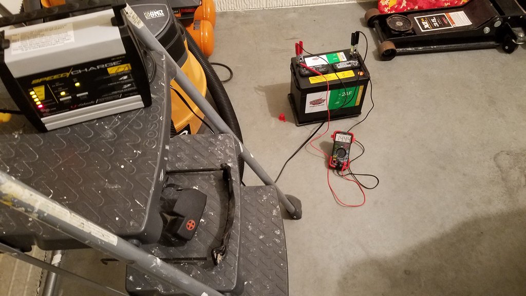

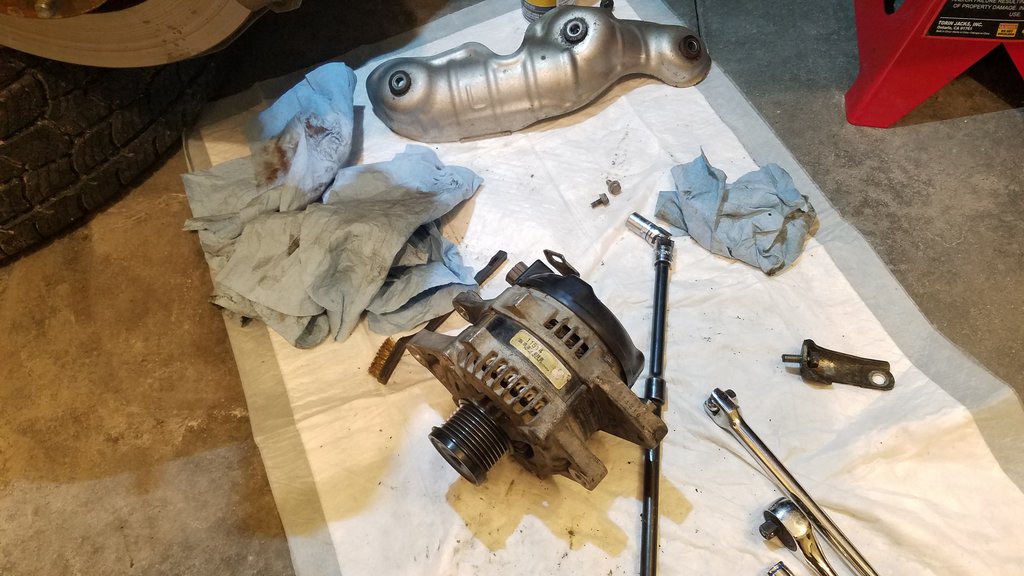

My gf said the battery light was flickering so I tested it and the battery was running only 10 volts with the engine going. I tried a new battery because the old one was about the age they start giving up with the cold, and because I didn't really want to do an alternator job. Test drove around the block and the new battery was half flat afterwards so had to charge it and remove the alternator.

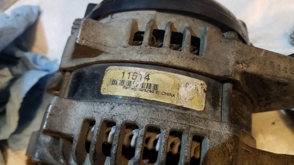

After rigorous analysis I was able to diagnose the problem:
Whoever put this junk one in also broke off the B terminal connector cover on the harness.

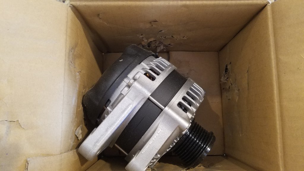

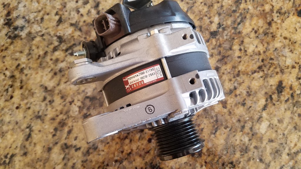

Ordered the proper 130A Denso infused with pure Japanese goodness from McGeorge... the packaging isn't exactly confidence inspiring:

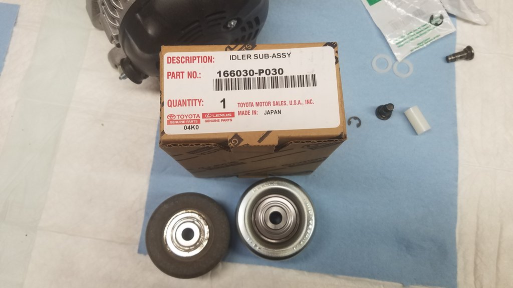

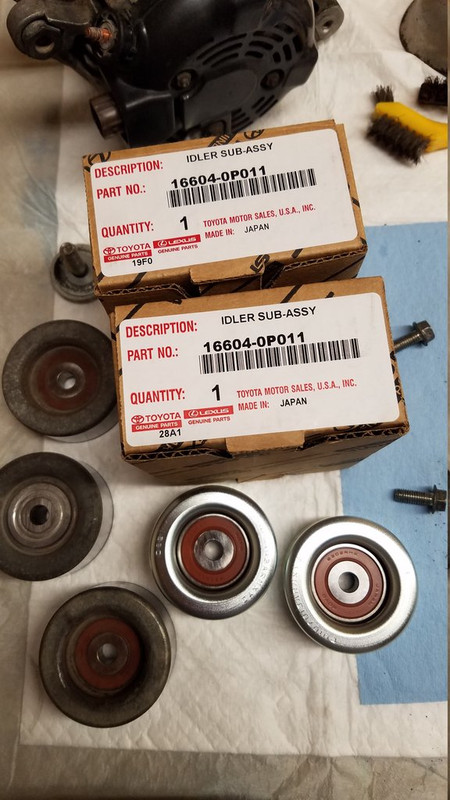

I'll do the idler pulleys while I'm at it. These aren't as cheap as a hoped it was over $200 for the 3 pulleys. Only the driver side No. 2 was obviously worn so I'll keep the other as backup spares.
2 No. 2s:
1 No. 1:

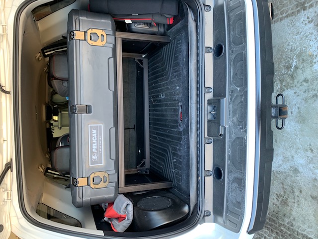

I built a shelf for my Pelican cargo case out of extruded aluminum.
I have the quick roof mount for the case as well, but it doesn't fit in the garage with it attached so wanted an option to keep it in the cargo area. Unfortunately the case is about two inches too long to fit between the wheel wells. I ended up designing / building this simple shelf so I can:
1. Keep the case level in the cargo area
2. Store other cargo or cases beneath it
3. Still see out my back window with the rear view mirror.
My thought is that I can leave it back there most of the time and throw it up on the roof rack when I need the space in the back.
I'll post a project write up in the next few days.

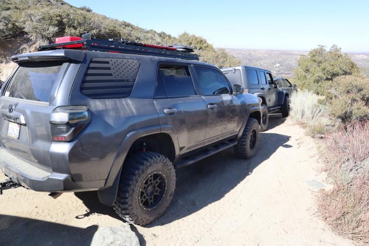

Got my 4Runner back from the shop. They installed my Dobinsons IMS system, air bags, BMC, EimKeith PCK, and FN wheels with Nitto 285/70 C load tires. The ride is so improved over stock that I couldn't believe it... even with the C rateds at 40psi (vs stock SLs at 30psi). I got a quick pic before the rain moved in, planning on getting it offroad in the next couple of days.
