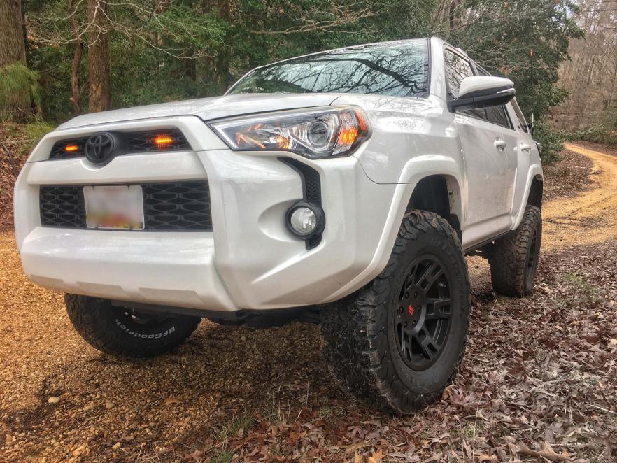

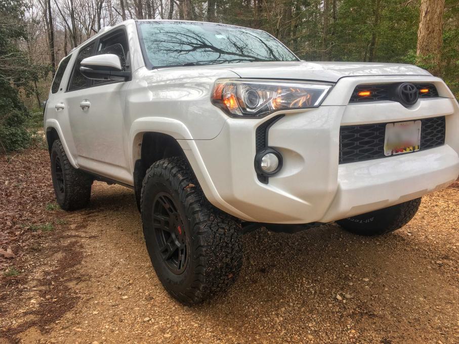

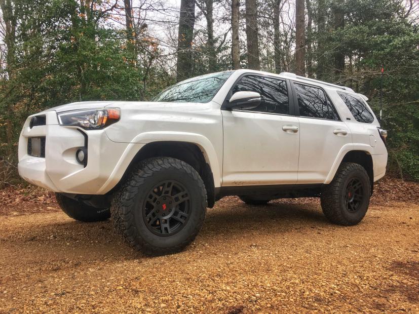

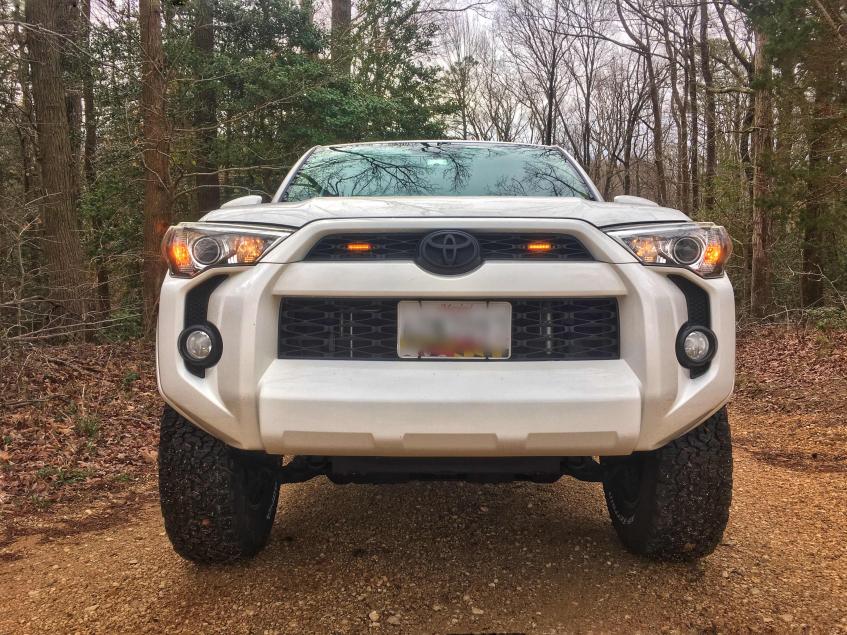

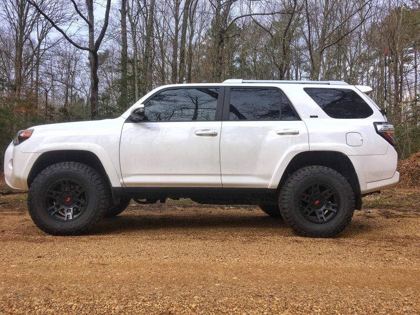

Bilstein 5100s with stock springs set to 1.75" front. Cornfed 1" spacer in rear with stock rear shocks and springs. Rear 5100s on order.
Took about 4 hours in the garage, solo. First time installing a lift. Very happy with the stance now! I really wanted to keep a slight forward rake and this nailed it [emoji108]

More pics of the 5100s with 285 KO2s on FN f(x) pro wheels. Front is set to 1.75 and I've got a 1" spring lift in rear.
