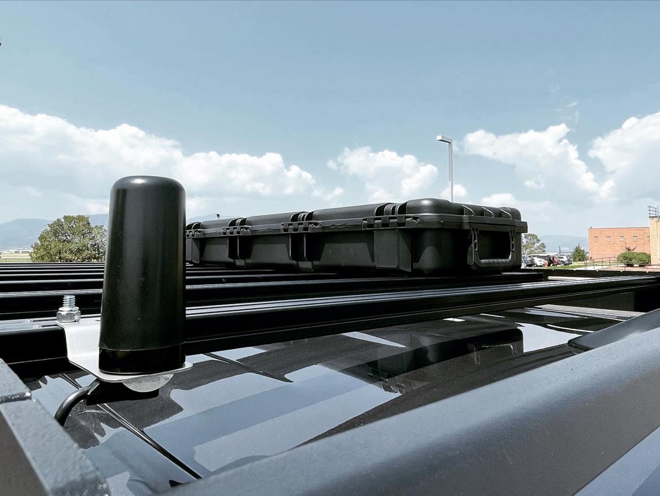

Moved my Midland 3db antenna from the hood mount to the roof rack. Took my time and made this a super clean install. In total, you might see 3-4 inches of wire total, that's it.

Out of curiosity, how did you get the wire up from the cab out to the roof? I like the idea quite a bit but want to make my install similarly clean.
I ran the antenna wire under my roof rack mount which creates a little channel to do so. I then brought it through the rear hatch cable loom from the factory. That takes you into the cabin above the headliner. From there down to the side of your choice and route up front to your radio.
