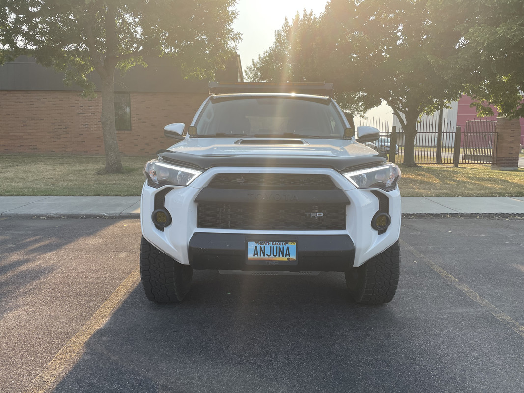

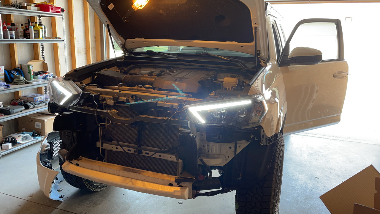

Installed USR Depo headlights, ordered from yotamafia. I picked up the LED upgrade kit. Housings came without the high beams but a quick email to yotamafia has a set en route. The LED turn signals are bright. The built in low beam is clear, proper cut-off up front and to the sides. I'm not blinding oncoming traffic and can see much better. The Lexus style checkmark is how the vehicle should have come from the factory. Overall, i'm pleased... except for the fitment. I should have taken a better picture with the front bumper installed.. but the gaps between the front bumper, housings, and hood seem to be a bit too large. I'm going to pull everything out again when I install the high beams and see if I can improve the fitment.

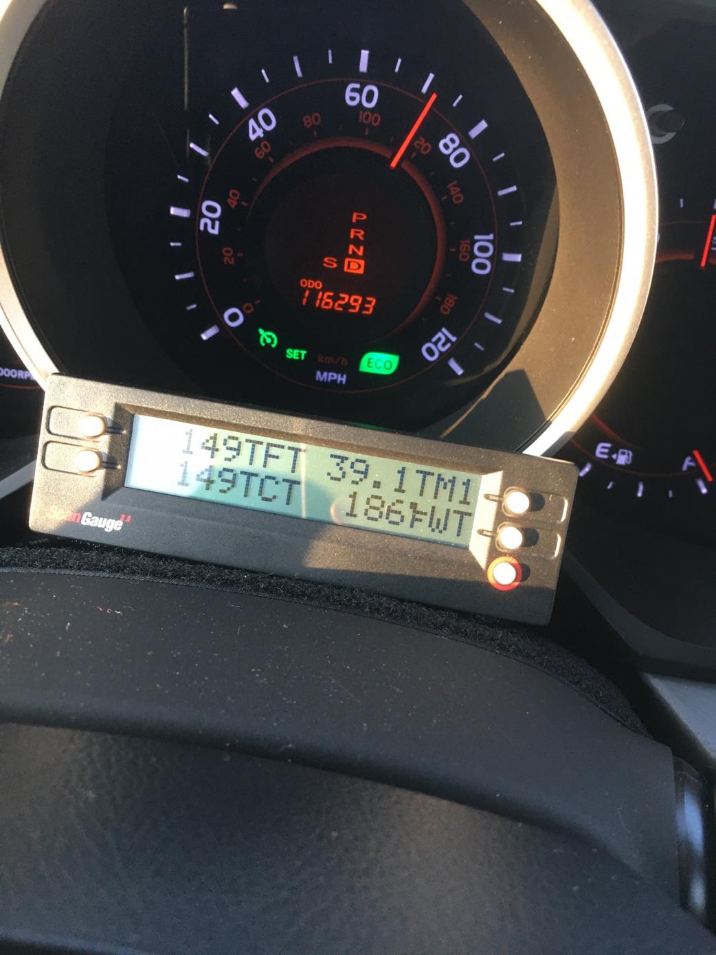

7 hours into my vacation and she’s running like a top. 95° weather, running cool on rolling 2 lane roads. I dig my ScanGauge.
Would love to see some output pics (on road and against wall). And definitely want to see those gaps.

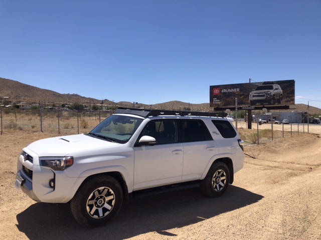

Johannesburg, CA

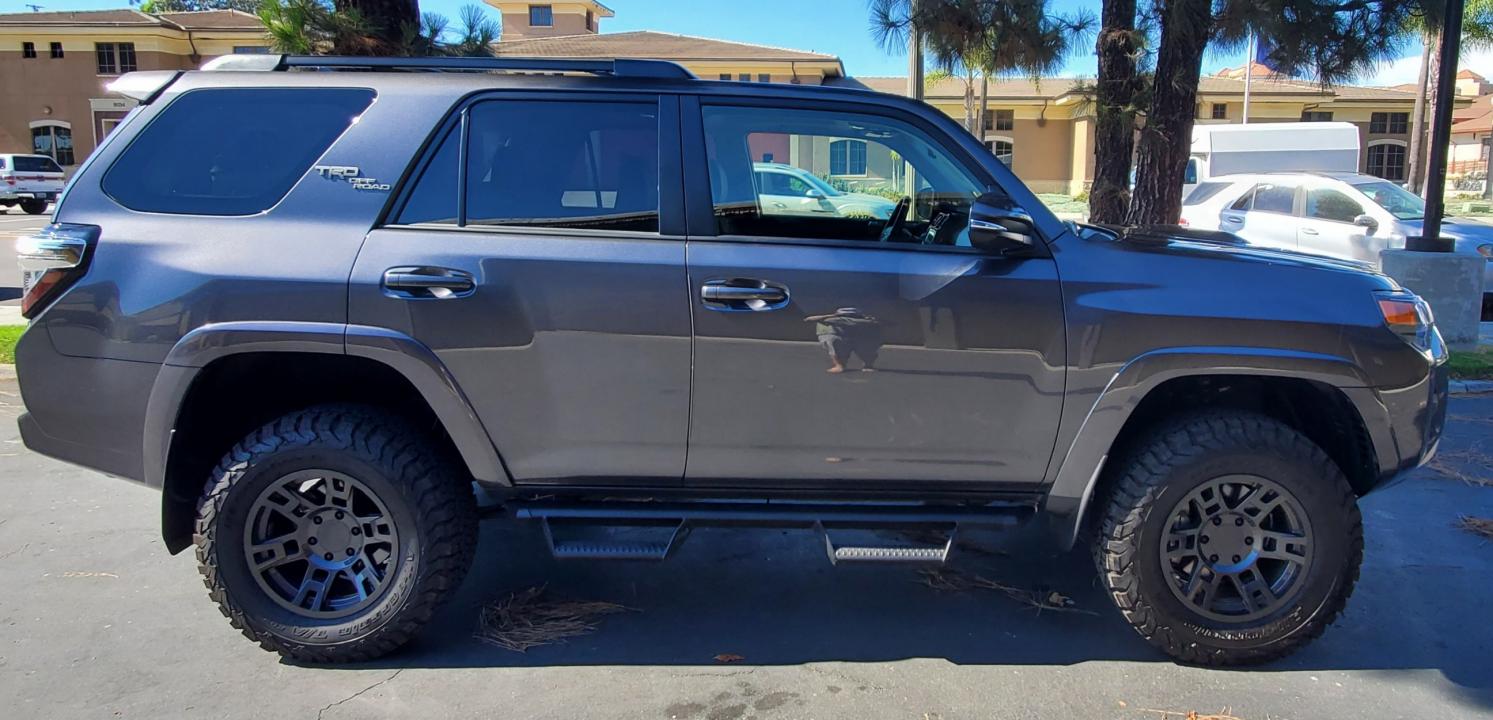

On the way home after two nights of camping with the family at Monache Meadows, I had to take this pic at Johannesburg:

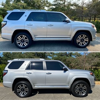

Bought this ‘21 Limited at MSRP couple weeks ago and yesterday installed Revtek 432X lift/level and added 275/60R20 Wildpeaks. Very slight rub in reverse with wheels full turn, but so minor I likely will not trim liner. Ordered N-Fab steps.
I did this exact setup on my ‘16 Limited but had 285/55R20 then. That size apparently is no longer available in Wildpeaks so I went with 33” size above and like it better.

I personally went with 275/55R20 (Cooper Discoverer AT3) because the diameter is almost exactly the same, so it doesn’t effect the speedometer.

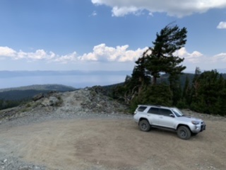

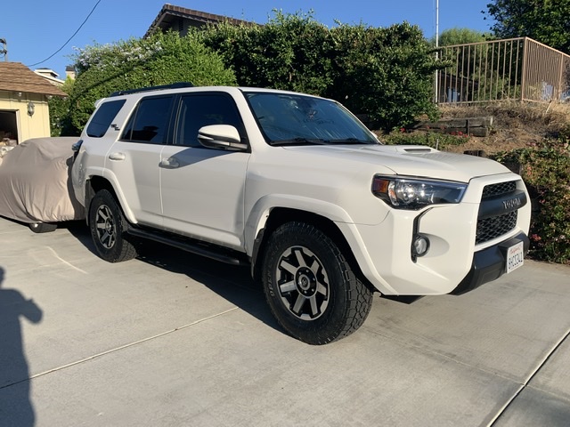

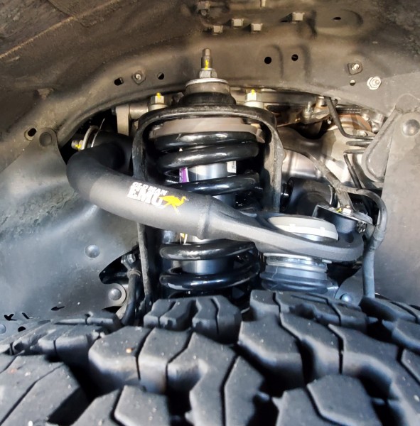

Dobinsons Coils 2.5/1.5 OME UCAs Dobinsons twin tube shocks

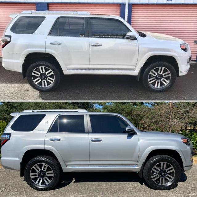

I had the option of 275/55R20, but didn’t want smaller than what I had previously and personally like this new size and height and ride. Don’t notice much speed difference, but then again I don’t push the speed limits like I used to so a little faster in reality is still not more than 10 over.
This isn’t the best pic, but comparison with same kit and 285/55 on white and 275/60 on bottom silver.
