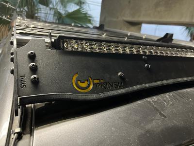

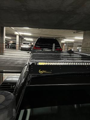

new prinsu fairing and 40 inch lasfit lightbar
Not too shabby with the yellow backplate on a prinsu fairing and the new 40 inch lasfit lightbar... Now just need my lamin-x yellow film so the carpet will match the drapes.

I notice your front fairing does not touch the paint. Did you do that on purpose?
I’ve been curious about that and was wondering if I should mount mine a little higher like yours to protect the paint.

Yeah, I mounted it higher, because I don't want the fairing to touch at all. After mobbing the vehicle offroad, all that dirt and dust will act like sand paper on anything that rubs the paint. I just moved it up one mounting hole. That area is so dang dirty, pretty much all the time (as per the pics).
I'm not sure if it will increase wind noise. However, this roof rack fairing/led light bar is replacing a dual 42 inch LED light bar that sat in front of the fairing, which made alot of noise.
i had mine mointed lower and moved it up when it started to rub the roof randomly. no change in noise.
