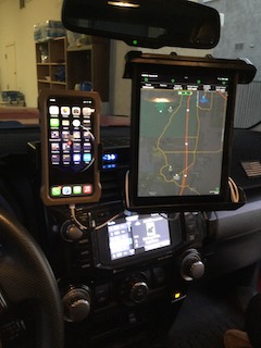

did it a little bit back like you suggested, The grommet was a battle and a half...it's in looking like a squashed oval. thankfully, no one will see it.
also, I had to remove the screws around the frame holding the lighter - couldn't get my hands in to unplug the power from the lighter.
then, of course, I dropped one of the power taps into the bowels of the center console. luckily for me I had a bunch on hand.
all in all, I'm very happy with the ram mount. have my phone and iPad mounted with power.

crappy Wife's iPhone picture:
Not trying to troll, but how TF do you guys put up with all that crap right there? it'd drive me nuts. Of course saying that i'm thinking about how i do it currently....staring at my phone Gaia app while driving through the desert lmao:shrug:
Perhaps a Tesla would be better for some. Ha
Going to get a different arm for the tablet, to allow me to lower it a bit more than I currently can.
Also that was a staged photo to get everything in view - the tablet was sitting higher for the picture..
so, in reality, the tablet will be lower and angled to not block my vision. The phone is in a good location.
