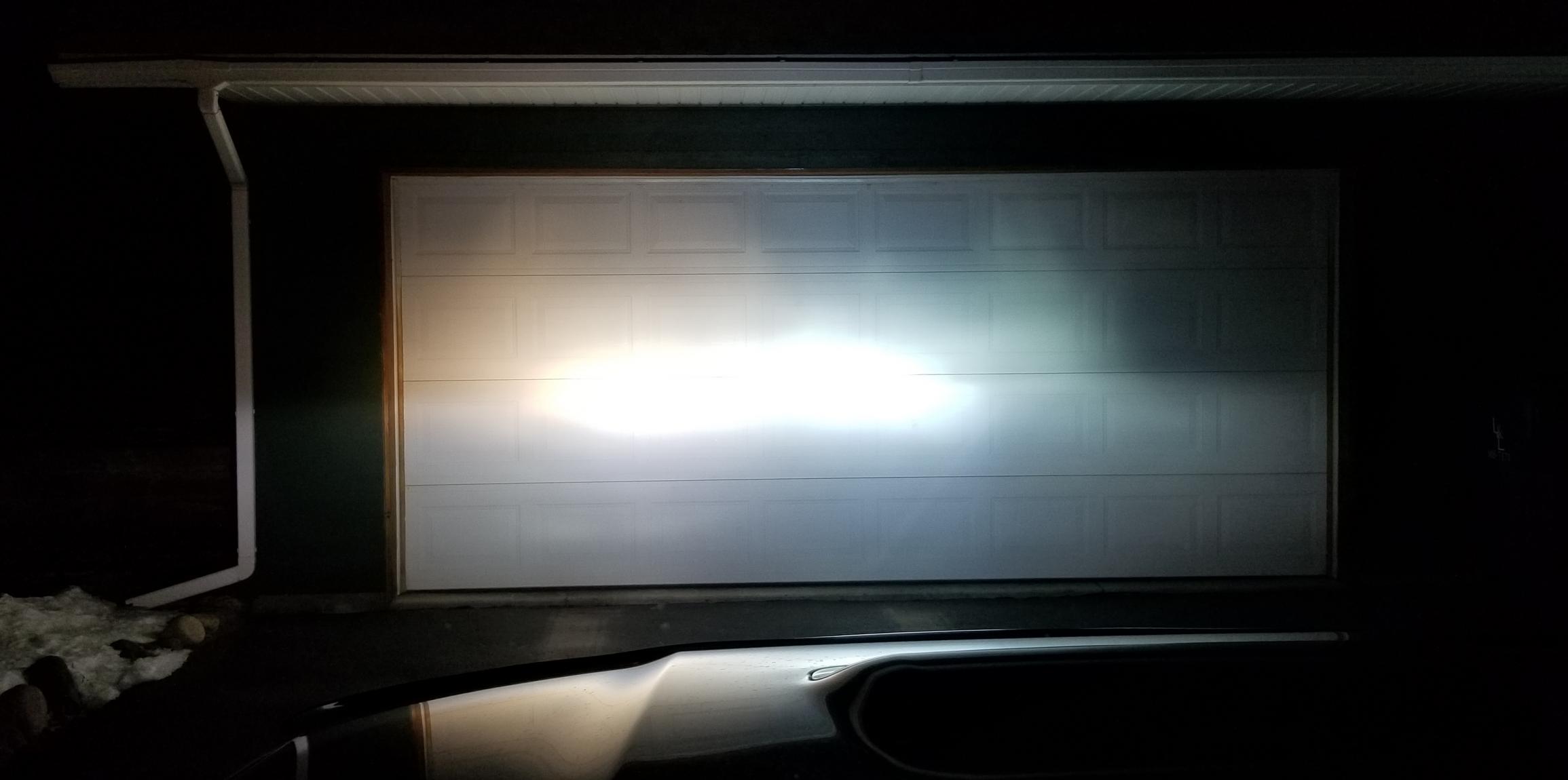

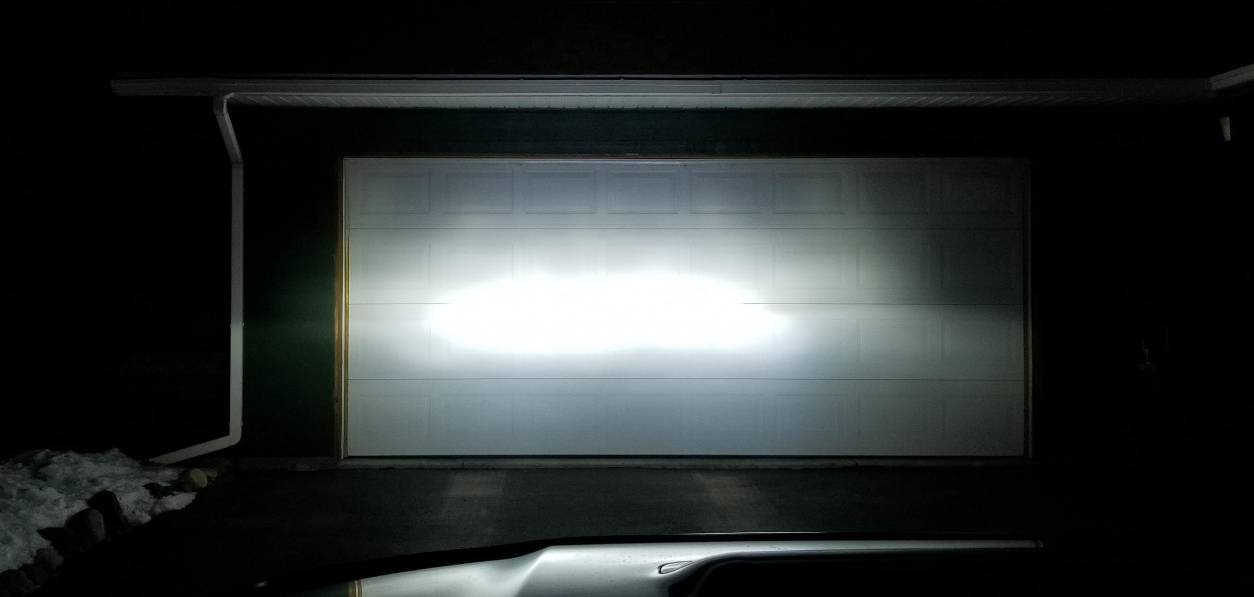

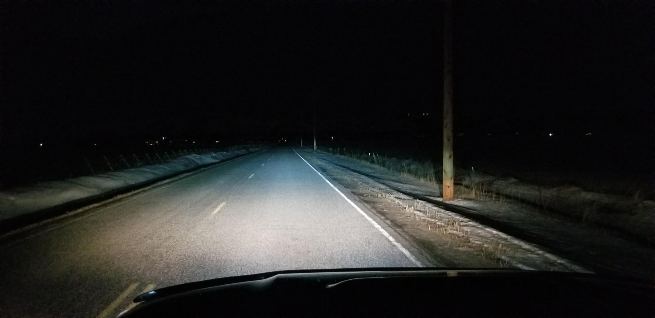

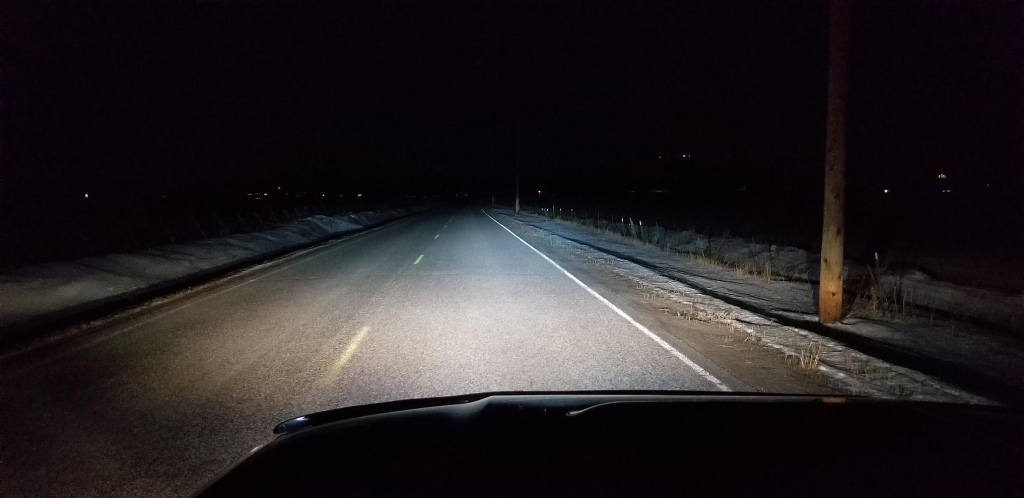

...Below is a series of comparison photos:
1) the Lo-beams against my white garage-door...AUXITO on the right...
2) the Hi-beams against my white garage-door...AUXITO on the right...Please note, OEM on the left...
3) Low-beams on rural road....AUXITO on the right...
4) Hi-beams on rural road....AUXITO on the right...OEM on the left...

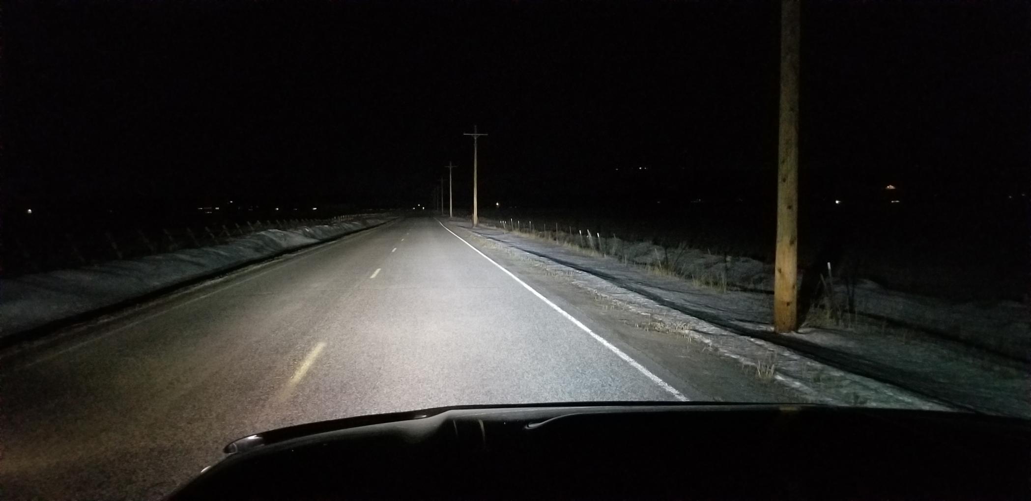

...*I then went back and replaced the left side with the AUXITO Hi and Lo beams...so here are the same comparison photos:
5) the Lo-beams against my white garage-door...both AUXITO bulbs...
6) the Hi-beams against my white garage-door...both AUXITO bulbs...
7) Low-beams on rural road...both AUXITO bulbs...
8) Hi-beams on rural road...both AUXITO bulbs...
...I have only had them installed for a few days, but I am quite happy with the power and distance they light up! Unlike the other brand that had to warm up before being fully lit, the AUXITO bulbs are instant on. Annd, as soon as I took those photos and turned around to head home...a couple of deer popped out onto the road, way ahead and I was able to see them quite clearly!...Woo-Hoo!...
...Also, I have had only one car in about 50 flash me, as they have an advanced cutoff which slants lower on the left....:thumb3:
