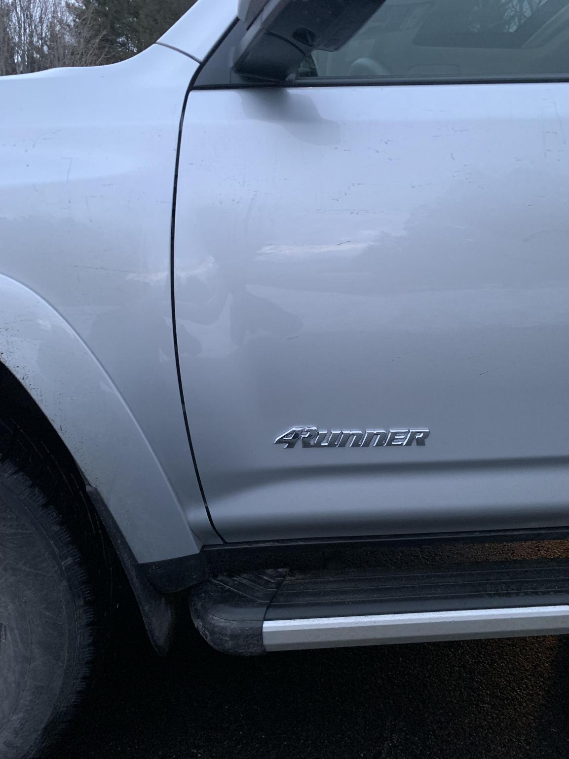

New 4Runner Emblems on 2021
Loving my 2021 Silver Premium but the vast landscape of silver needed something (thinking racing stripe but....). And I realized I was so used to the SR5 4WD on my previous 4th gens. Bought some 4Runner emblems from a great eBay seller.

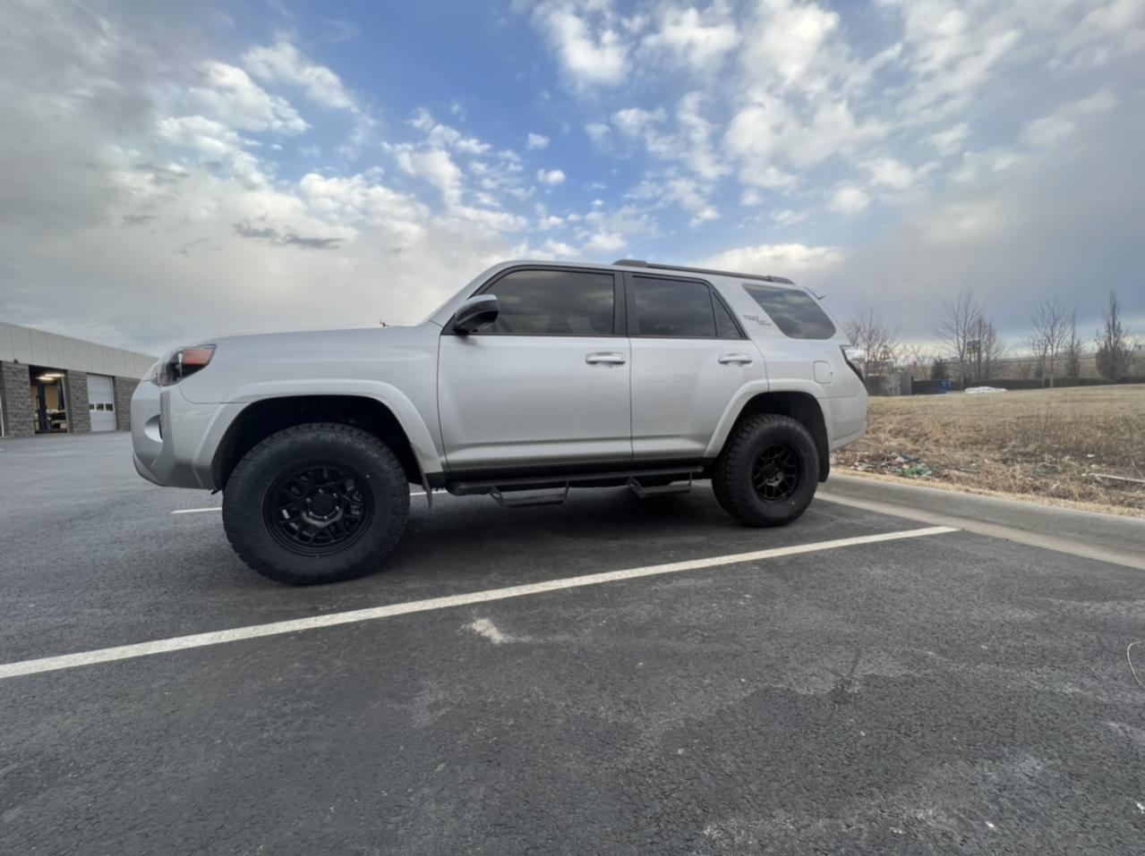

1” Cornfed spacers in front to level
KMC Bully OL wheels
Toyo Open Countries

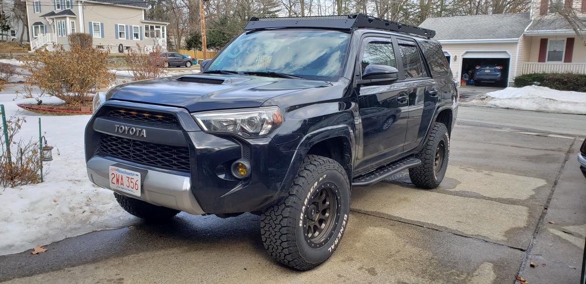

Took advantage of the 50* day in NE and installed the CALI RAISED rock sliders. What would have been a 2 hour job turned into a 4 hour one because the frame threads were rusted from so many winters. I ended up having to chase the threads and tapping them to clean it up before installing. Needless to say a few bolts were leftover, whoops.
Kick out with bedliner toplate. overall happy to finally get these suckers on.

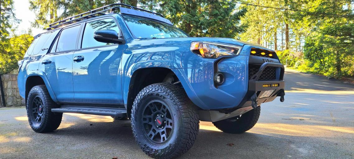

Spent $1000 fixing a squeak in my OME BP51 shocks
After 40,000km the hemispherical bearings seized. No way to service or clean. $200 in parts, 4 hours labour + alignment.

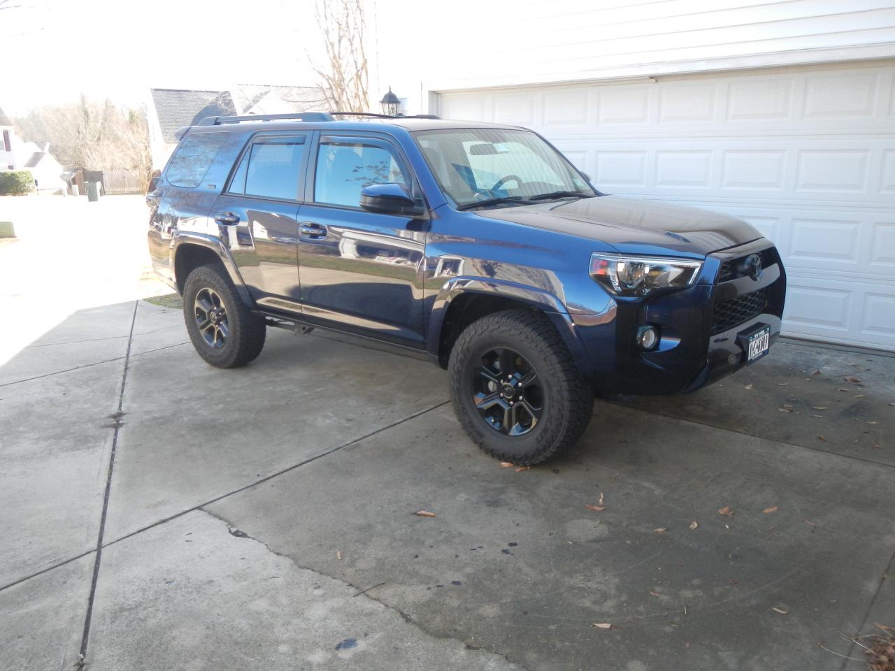

Installed lift, tires, & UCA's
Installed lift kit, Camburg UCA's, 285/70/17 AT3W's, and got an alignment. A full 3" gain up front over the stock TRD Pro suspension height. 5.3 degrees of caster, it tracks nice on the highway. It's level now, but I'm hoping the front settles a bit, I prefer a bit of rake. No rubbing. No squat when I had it loaded up with the bikes and gear yesterday.

Nice stance/height. Details on lift?

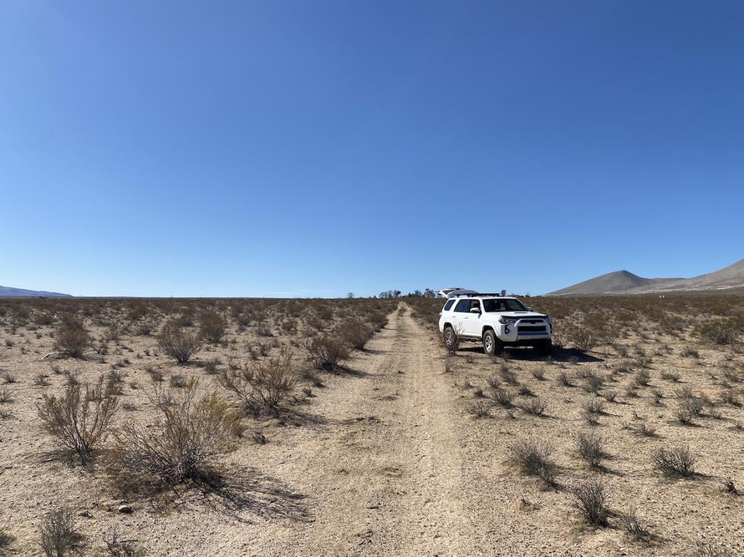

Took a trip out to the high desert to visit a buddy's property
Didn't need anything more aggressive than 4H and it performed like a champ. I do need to think about upgrading my skids as some of those scrub brushes are pretty tough.
