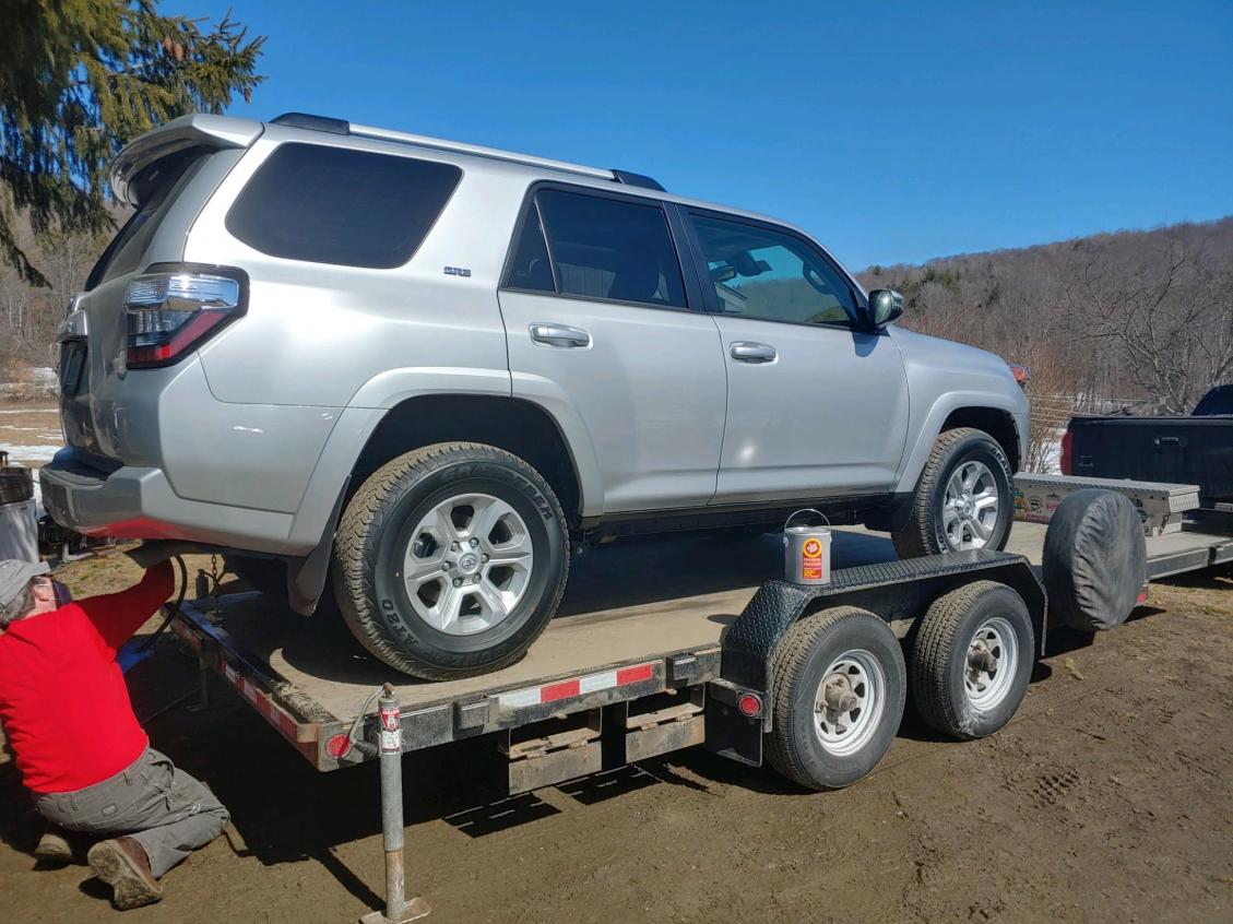

As promised...
Pics of my Runner after the leveling lift.

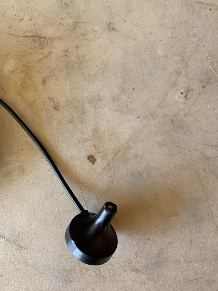

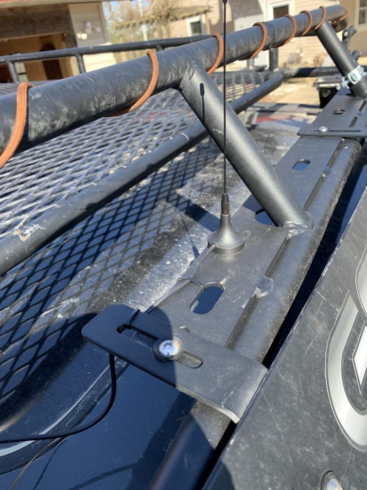

Broken GMRS Antenna
A few months ago, I put a GMRS radio in. Later, I put on the KC wire hider so I could relocate the antenna from my hood, to my roof/rack. Well, hitting some trails, I didn't realize the antenna magnetic base had been hit by a branch, and the antenna was dangling over the side. Not seeing it, I shut the passenger door and heard a "ping" Damnit, broke the antenna. Midland had a new one on the site for $19, but there are no connections directly on the antenna, so I had to rerun the entire wire. It is zip tied in place now, in hopes of avoiding this again.

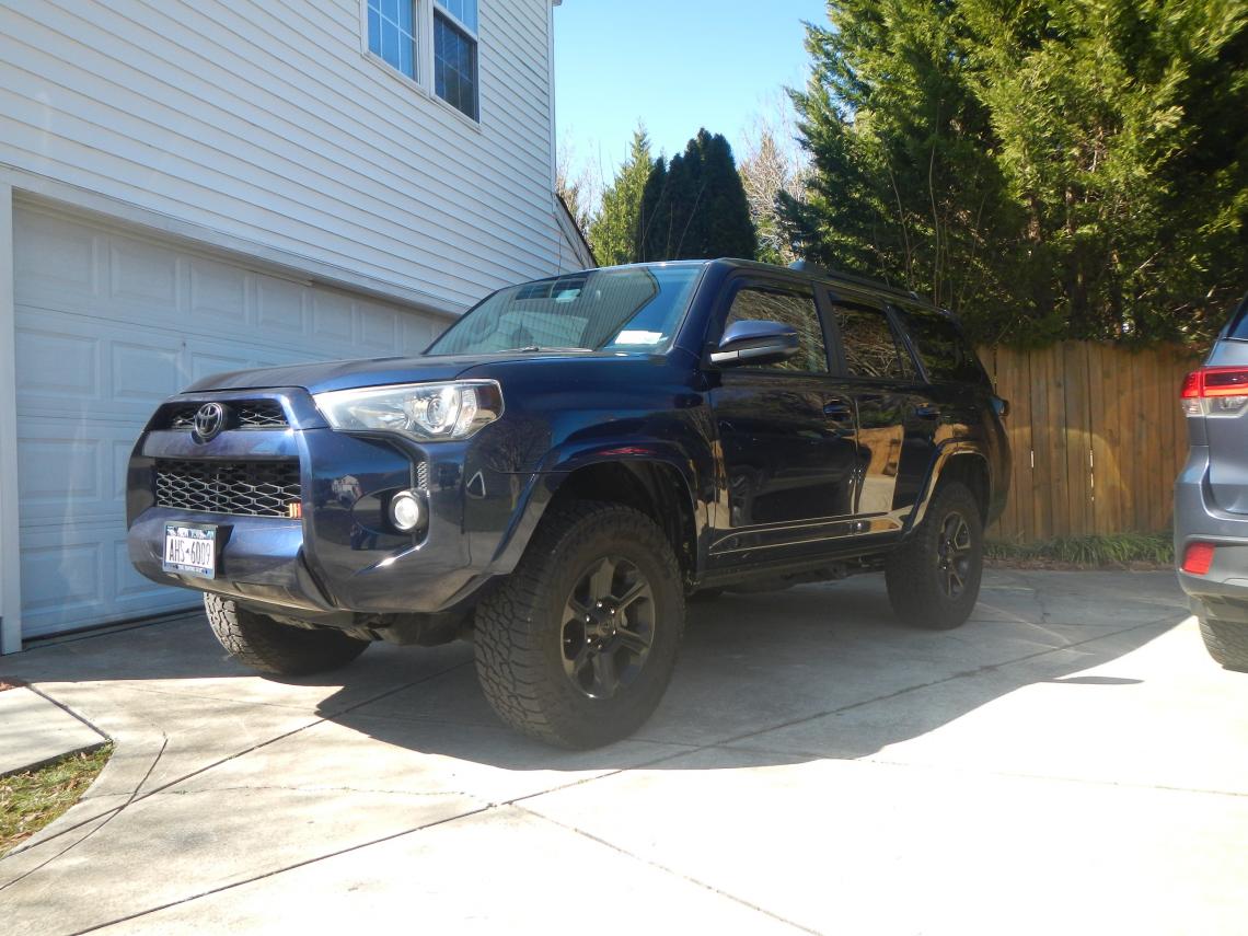

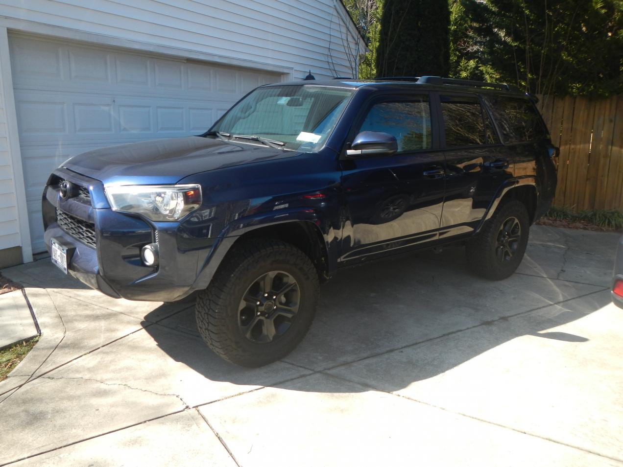

These are brand new. They are the Nitros they just released them. They are 17×9 with a -18 offset
Sent from my SM-G998U1 using Tapatalk
Went to their site (which has almost no info other than pictures it seems) and found them. Those are really nice. Would have to look in to fitting a -18 offset on my rig. I've done a viper cut already and still need to adjust or remove my mud flaps.
If you don't mind.. what have you modified to fit that offset and tire size? Apologies if you already stated.
Swapped out the stock GrandTreks for Falken Wildpeak at3w’s. So far they are great. As quiet if not quieter than the Dunlops. Great in snow too.
I cranked my Icons up to the max recommended from them. For the front; Body Mount chopped and welded, viper cut, and removed the front mud flaps. I asked the alignment shop to set the caster more positive as well. Rears I added the 3 inch heavy duty springs which may not be necessary, currently I have a slight rate. but with the bigger size I am going to have to get a rear bumper to fit my spare anyways, which should re level it out
Pics
Really appreciate the reply and the pics. I've been putting off doing a body mount chop due to my location and not having found a place I trust. Was saving up for Konig Countersteer but these DX4 wheels are much more affordable at discount tire with my military discount.

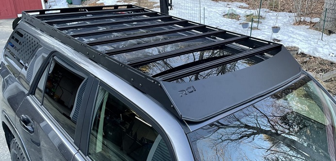

I put on a new RCI roof rack. I'm pleased with how it looks but I haven't test driven it yet for wind noise. RCI failed to send the correct size washer for the screws that hold on the cross rails but otherwise I like it.
