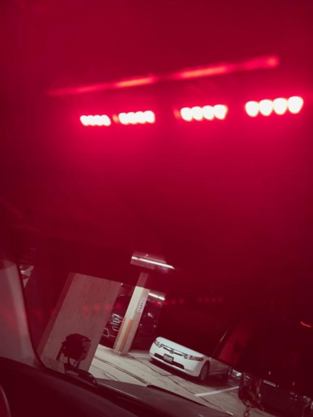

After waiting a billion years, a buddy notified that the dual color map lights (red/white) was in stock. As with all MESO products, it sold out pretty fast. I was pretty skeptical because im a cheapskate bastard, but it was worth it.
installation was a breeze.
The white light is too bright. So bright, you gotta be careful if you using it while driving. You will see reflections, and artifacts in the windows, and can't see out. It will also wipe out your night vision.
The red light is still pretty dang bright, but it's way more usable in the map light location. You won't get as distracted and you won't see floaters and artifacts in the windows at night.
I'm not going to bother posting a pic of the white light. It's so bright it gets washed out, and ya'll seen white light before.

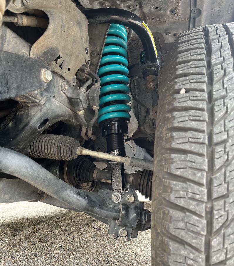

I installed some Dobinsons IMS shocks and struts. So far they ride really great. Comfortable but with more control. I haven't taken them off-road yet and put them through those paces.
I set the coil seat height at 222.5mm to give me ~.75in of lift at the wheel. With my 2in lift springs and the weight I carry up front it sits perfect.
And to address Dobinsons quality in another way, the coils in the picture are just shy of 3 years old and they look more or less new still after a wipe down with a moist rag.

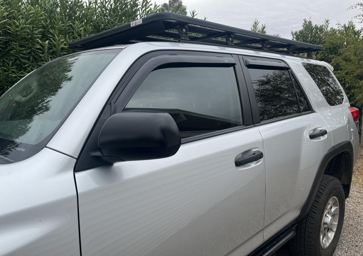

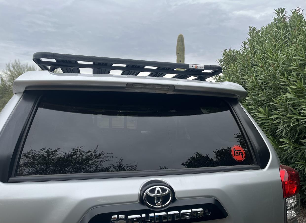

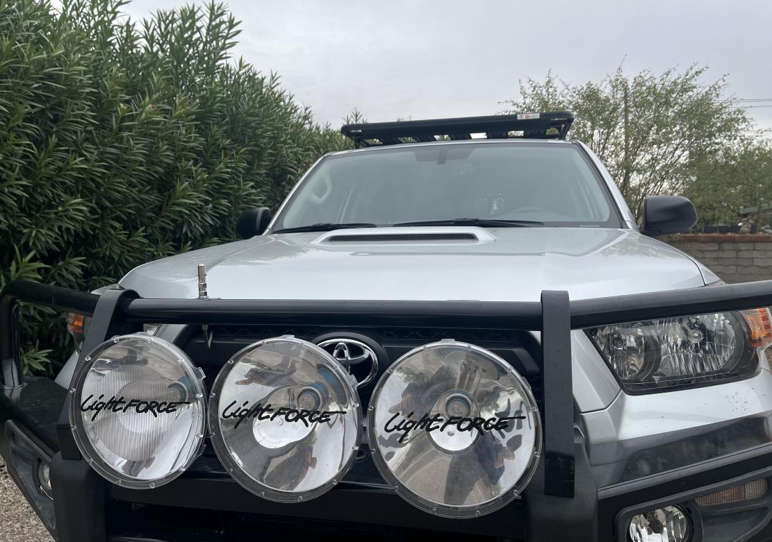

I also installed a new roof rack, the Eezi Awn K9. I went with the 2.2m x 49" version for full roof coverage.
Once positioned and tightened down, there is no flex or movement in it whatsoever. The finish is very good. The fit is perfect. If you pick one of these up I recommend taking the time to install slowly. I followed the directions on the equipt site and the video they made.
The front portion of the rail and rack are unsecured to the roof in the sense I’m used to (bolts). However the four factory mounting points on each side for the factory roof rails are used. When the rack is installed and tightened in the sequence mentioned on the equipt site, the front portion is pushed down and held in place against the roof very tightly. It feels like it may as well be bolted down like the rest of it. I have no concerns with this design after seeing it and testing it (push, pull, shake as hard as I can).
I really like the all welded design of this rack. It’s huge, but allows for the entire roof area to be used for cool and useful things. I personally am excited to just be able to sit up there on a camp chair. A ladder is necessary I think (considering the rack can be stood upon for loading/ unloading) and I’m working out a solution now, but I don’t like the hatch ladders that are made for these trucks.
I installed the wind deflector the way it showed in the paper instructions that came with the rack. I noticed that in the equipt video they have it on “backwards” compared to the paper instructions. I don’t know what’s better, but the rack is fairly quiet as I have it. If the sunroof shade is open I can hear the wind being deflected onto the sunroof glass and that’s a little noisy but not terrible. I did notice that the deflector shoots air into the open sunroof and onto the front occupants. It’s actually kind of a nice bit of extra airflow.
The amount of accessories is impressive. I bought 8 tie down rings to go with it and changed most of the visible hardware to same grade black bolts for a cleaner look.

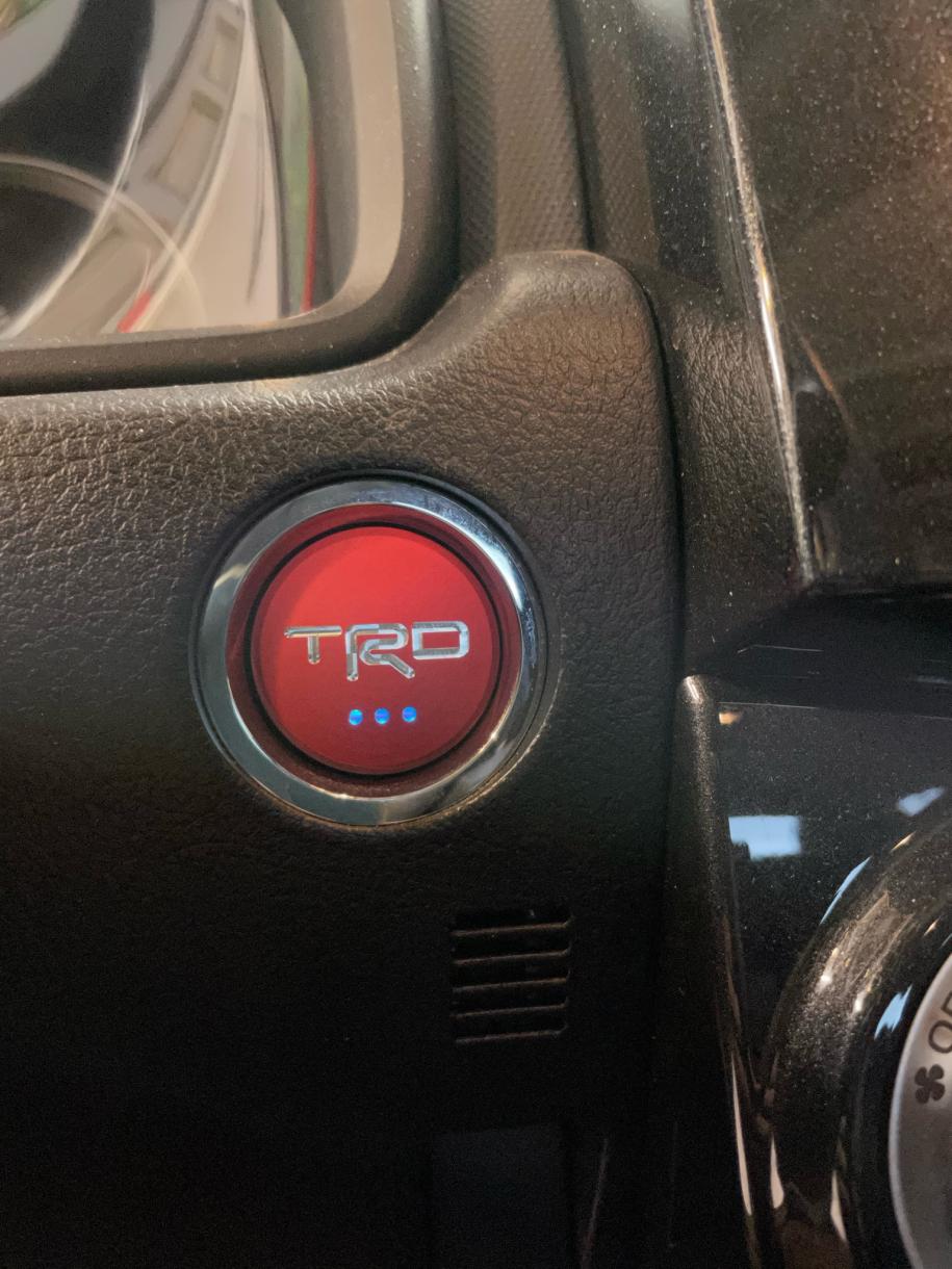

Installed a new ignition button. Was inspired when I saw my buddy’s new Tundra button. This one is from bonoboproducts.com. Kinda feels silly to spend $50 on it, but it’ll make me smile every time I push it. :thumb3:
