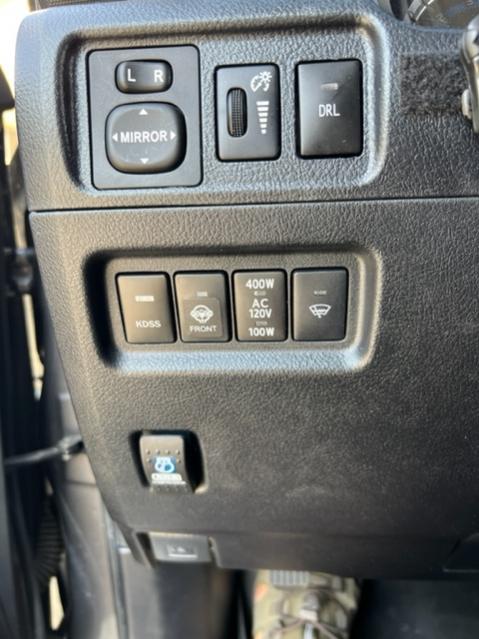

finally installed my KDSS switch, now i can hit dem switches!!!!

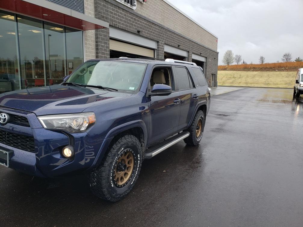

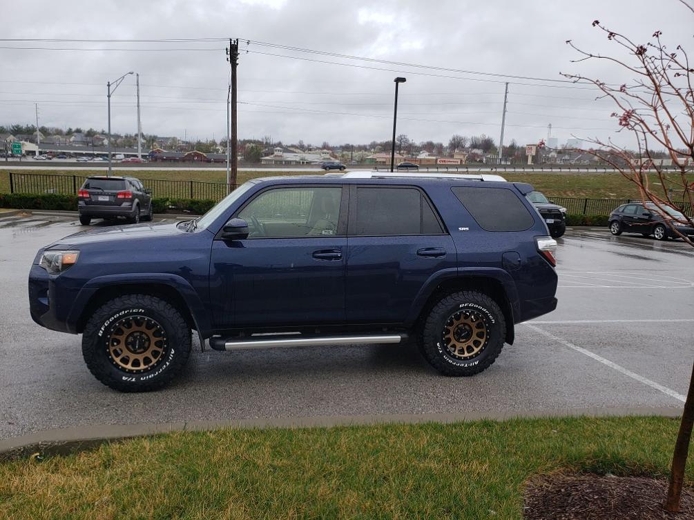

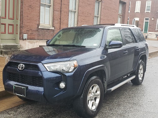

Got my Method 305's and BFG T/A KO2's put on the other day.
Next is an OME 2-3" lift kit, then a dual swing rear bumper (not sure which yet); a few minor internal mods on the way too, but I don't want to spoil any surprises :)

What does that switch actually do?
makes it ride like a boat. its fantastic. any crappy road you hate going on, hit the switch and half of the crap you feel is gone. offroad, its a huge upgrade and allows the suspension to independently articulate at speed. Remember, this is allowing the sway bars to move, so you need to keep that in mind so you dont roll it lol.
I think for the money and ease of installation, its a top mod for KDSS guys that wheel in higher speed areas.
Interesting. Send me the link to everything you have on it. I'd love to turn my KDSS off.......
Gotta hit up dr.KDSS on instagram. My buddy got it for me for Christmas cuz he knew I wanted it badly. I dunno if there is another way. He’s also on this forum with a long travel white 4Runner on 35s

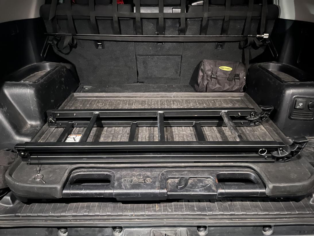

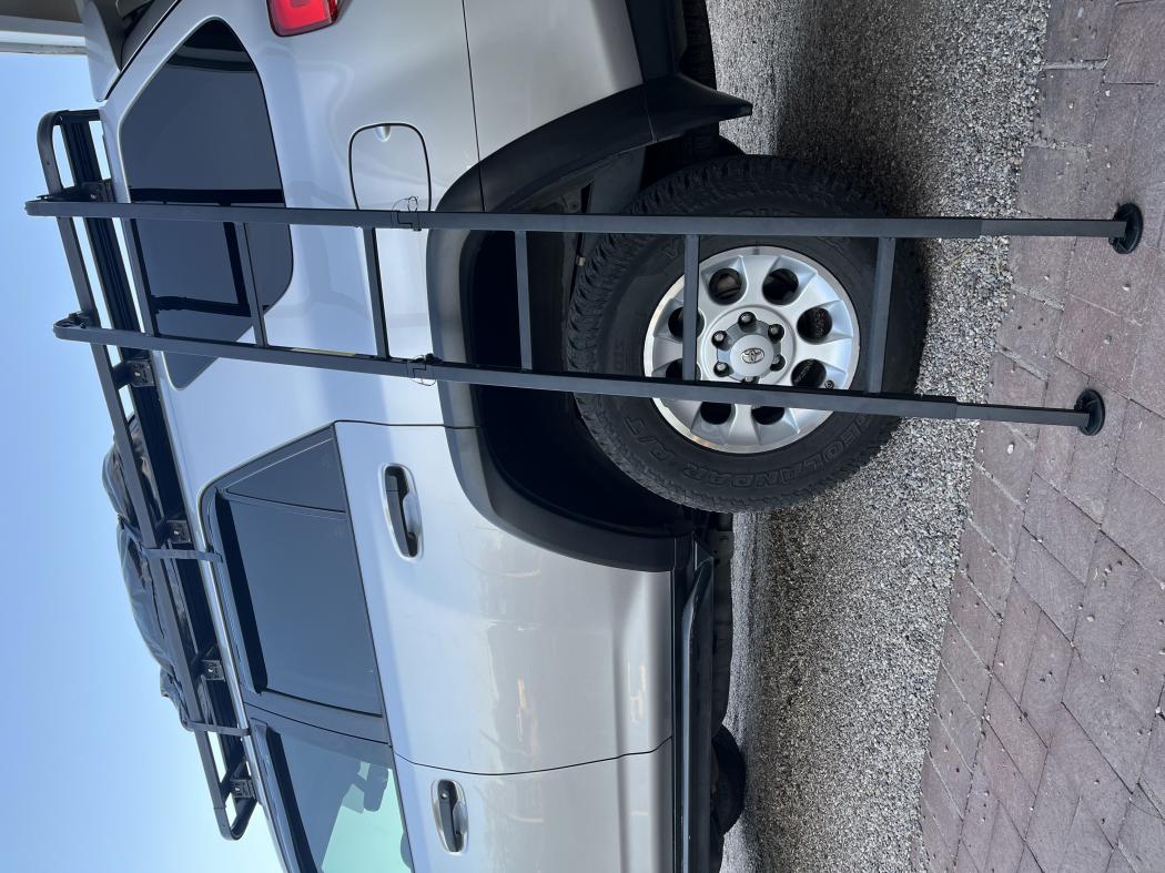

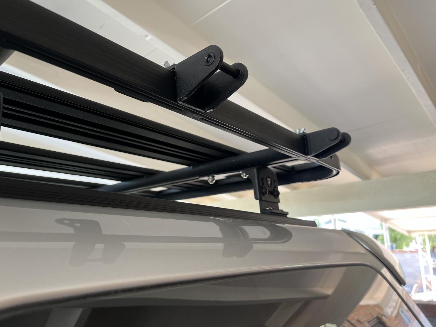

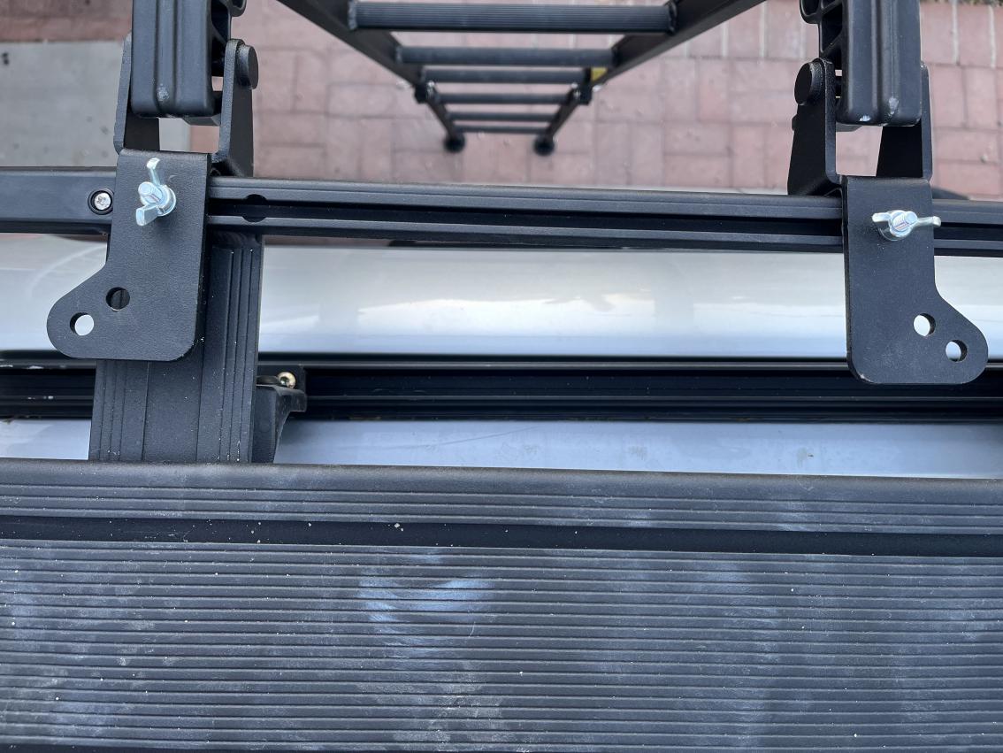

I chose a ladder to use with my Eezi Awn roof rack. The Rhino Rack folding ladder.
Technically not compatible with the Eezi Awn but after a small modification to the ladder mounts, it's perfect. I had to drill a 1/4" hole in each mount in the location that corresponds to where the Eezi Awn rail track is. I picked up a couple of m6 bolts and washers and done. I used wing nuts to be able to loosen the mounts to slide to any part of the rack front to back for loading and climbing in different areas.
I like the ladder because its light weight. 12lbs. It folds in half so it's easy to store. I've never been fond of the typical rear hatch ladders. It appears to be really well made too. Sturdy.

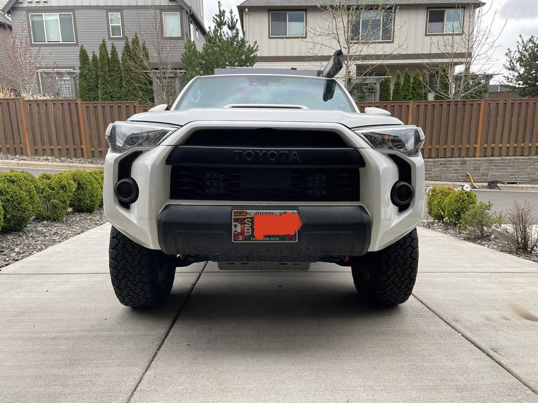

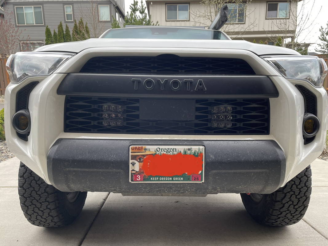

Installed Meso Customs map/dome lights, Arc LED in the rear lift gate, and 2x new Diode Dynamics SS5 Pro lights behind the front grill.
Deactivates KDSS without having to be in 4lo. Acts kinda like a pseudo electronic sway bar disconnect. Great on washboard and corrugated roads
By far the best mod I've done so far. I even use it for silly things like hitting rough railroad crossings that aren't perpendicular to my direction of travel :biggrin1:

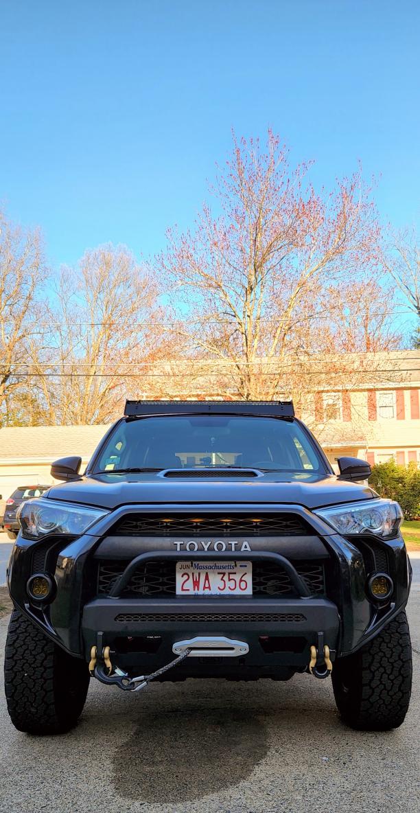

Spent Saturday throwing on the TSO bumper with high clearance sides and Smittybilt X2O 10k winch with synthetic rope. I feel I cut the sides a bit too high but honestly, it's on, it'll do the job.

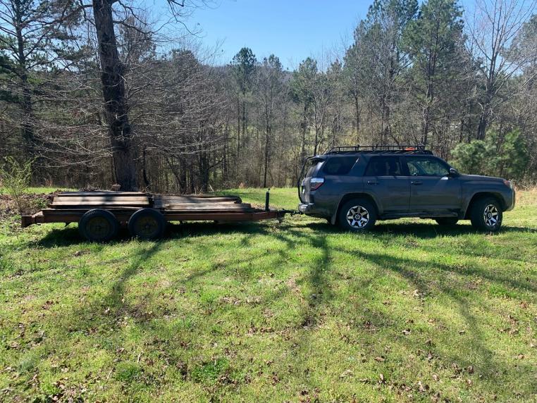

Property cleanup
We moved to a 10 acre setup just over a year ago. Previous owners stashed junk all over the property. We are slowly getting things cleaned up. Had to put her to work.
