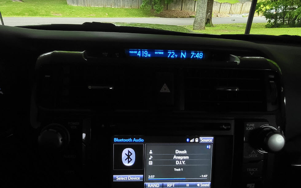

Installed my Accessory Meter Display. :wink2:
What exactly did you do that was different than what was there before? My 2018 ORP has that upper display screen already (range, temp, compass, time.) Do some not come with it?
Edit: I see most just came with a clock and this was 2014 Trail specific? I found your comments in that thread on 4runners.com. Wonder if the previous owner put it in mine with the other little stuff he put in.

Almost certain that the previous owner did that as only the 2014 Trail and Pro came with the blue LCD version of the display. 2010-2013 had the Amber version and anything 2015 and up has the basic clock. You will be able to tell by pulling out the instrument cluster. ;)
I will not be pulling the instrument cluster and will assume it's what I have, but I appreciate you sending me down the rabbit hole on a slow day at work! I had no clue that was "special." Thought it was just what these came with. So, I did some googling after your post and came across the threads with Old Red and the harnesses. So, I scoured it to see who signed up to buy one. Sure enough, I found a person in NJ with a 2018 TRD ORP that had bought one. Went down the rabbit hole some more and looked at his posts. Sure enough, I think I found the previous owner of my 4R and sent him a message. Everything seems to be lining up timeline wise, based on the info in his few posts he has, and the pics he posted of it with even the same dealership license plate frame. I sent him a PM, but it's gotta be him (I hope). I knew it had to be an enthusiast that had it as it had a bunch of stuff on it already (molle panels, black valences and badges, Pro grille, black roof rails, LED interior lights, glove box and center console organizers) and now this instrument cluster.

It's a sought-after item for sure, as the displays are hard to come by (either buy new for $350 or scour over junkyard listings, which have all been picked clean by now). And then on top of that, you need the custom harness to make it work. And Old Red is likely done making them, owing to a dwindling supply of OEM connectors. It's a much better use of the dash space than the cheap analog clock they switched to.
