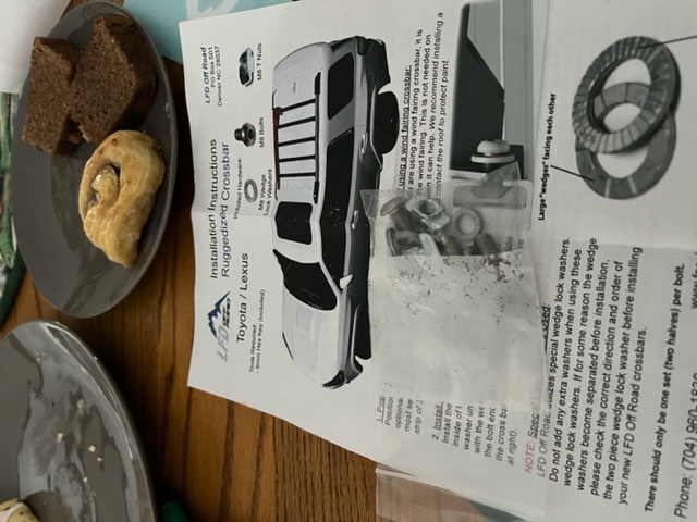

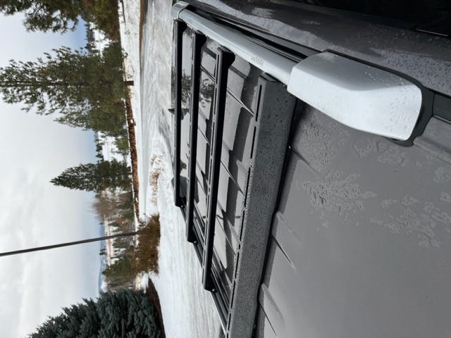

Installed LFD SS Racks on my wife’s 2014 SR5. The racks were her primary gift (aside from a new Off-Road on order) and she loved them. Weather finally warming up to allow me to do this.
So after installing I had a complete bag of nuts, bolts and washers left over. Kit is the 5SS
and the instructions show 5 crossbars. Looks like I was short changed a crossbar.
Edit: Called LFD and they said 4 crossbars including the fairing is the correct #. They just throw in an extra bag of nuts and bolts.

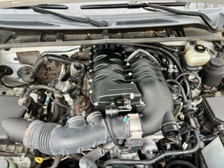

Added a Magnuson supercharger
I had a Manguson Supercharger install in Mckinney Texas and finally got it back. It was $1300 for the install, which I thought was really cheap. A few other places charged up to 3500 for install. I could definitely tell a difference.

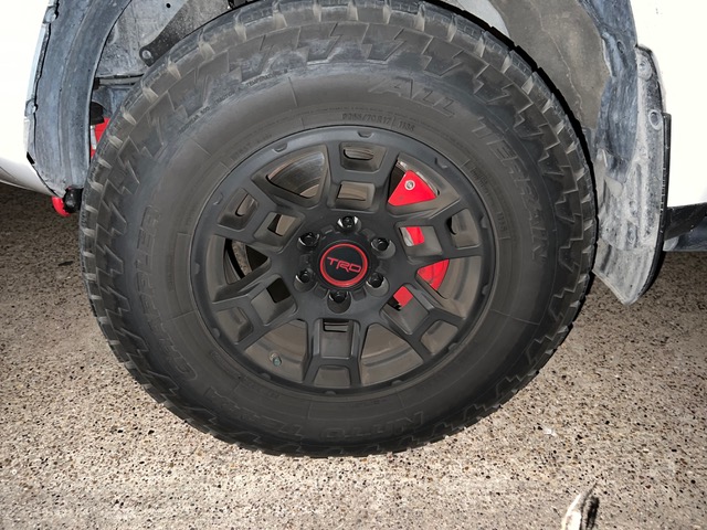

Red Brake Caliper Cover
I also added red brake caliper covers. I also put some white TRD stickers on the caliper covers. It looks really good. I wish I had taken better pictures.
