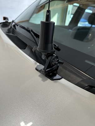

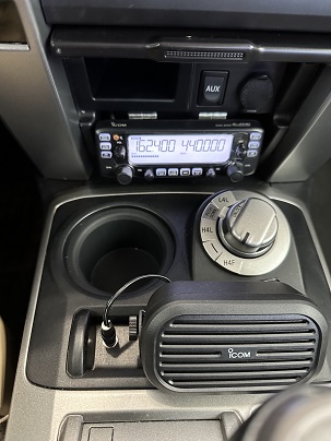

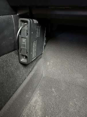

for those that have asked, here are some pics of my radio set up. I will post them here.
pic 1: speaker and control unit set up. got the control unit magnet mount idea from a couple others who did that as well. icom speaker quick connect into console
pic 2: brain unit mount underneath passenger glove box way in the back. doesn't interfere with airbag or hvac air flow. I can't use the spaces underneath my seats the wiring and unit for the built in headrest entertainment units takes up that space so I needed to find somewhere else. this was the best option, dual lock fastener for the main unit so it can be removed. I have the icom 2730a and it' a big brain unit. those of you that run midland GMRS with the smaller brain unit it will tuck in there even nicer
pic 3 and pic4: antenna mount. haven't seen anyone mount it this way with a heavier duty mount. used PPF under the bracket to protect paint with weatherproof foam tape on underside of mount as well. it's not exactly a stealth mount but I do have a longer antenna and need a strong mount. comet rs730 NMO grounded to hood via 4 set screws. fluid film on the underside of the mount and around the screws for extra moisture repellent. however that spot on the hood is fairly safe and you don't need to run the coax over any weather stripping and squish it
parts used:
- icom 2730a
- icom sp35 speaker
- icom mounting bracket magnet mount with home depot L brackets and 3M extreme double sided tape
- panel mount 6ft mono TS male/female audio cable. male into radio, female is what comes out by the shifter
- ran the coax through the smaller grommet top left of the main grommet (easier to remove if need to replace and allows for the shortest run of cable to brain unit)
- ran main power through main grommet and connected to battery directly
- comet rs730 mount, specifically cp5NMO
- step drill bits to drill holes for the controller plug and speaker quick connect

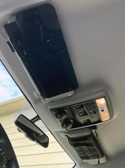

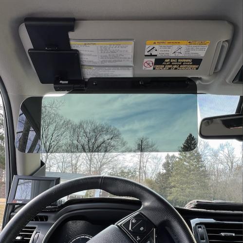

Quick add-on this afternoon - Rosen Insight Versafit 15" Visor
Insight(R) Versafit Sunvisor System
Will update with additional pics and review when I get some miles and use with it.
Quality, and customer service (Suzanne) is outstanding! Fast shipping, as was in stock.
Light, sturdy and very well designed. A nice thick acrylic lens, reminds me of a neutral density filter, it doesn't change the colors just the brightness and glare.
A few call outs:
1. Very light but does drop the OEM shade a few mm's when in upward position. My fabric visor molle panel on passenger side does the same thing w only a few small things on it.
2. Curve part of the clamps ends does not let visor go fully into it. The OEM visor is thick, but the clamp still grabs it solidly and the curve makes it around somewhat.
3. If you are tall, when in the upright position, thee arm and visor from the side does sit in the windshield view about 1" from the top. I'm 6' 2" and this doesn't really bother me though.
Overall very happy with this, a bit pricey but again superb quality item and for something that may add in a safety factor. I wear sunglasses less and less lately in even sunny weather and also occasionally wear prescription glasses (non tinted).
Anxious to get a few sunrise, sunset drives in for testing. Also covers the hood scoop from my POV so curious to see if it helps with that occasional mid day glare. (my OCD won't let me wash/wax less)
