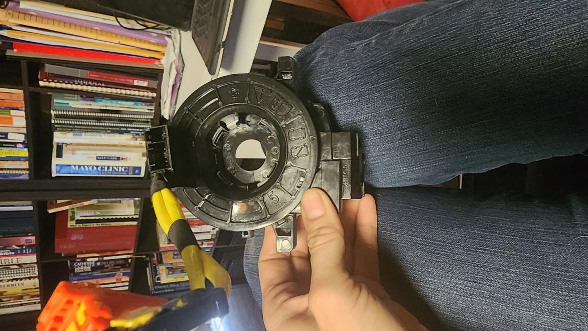

diagnosed and research= clock spring bad when horn won't work going straight but will sound when steering wheel turned left or right.
800 + OEM part I had a heart attack
found " clock spring experts" San Antonio tx. they guaranteed 100% fit or money back. and in same town I'm in
GUYS it's been 3 weeks now with no refund, not sent correct clock spring and they don't allow phone calls or me to go in person.. now guessing angle sensor needed now possibly bad.
I've been without vehicle 3 weeks now do to these guys mistake.

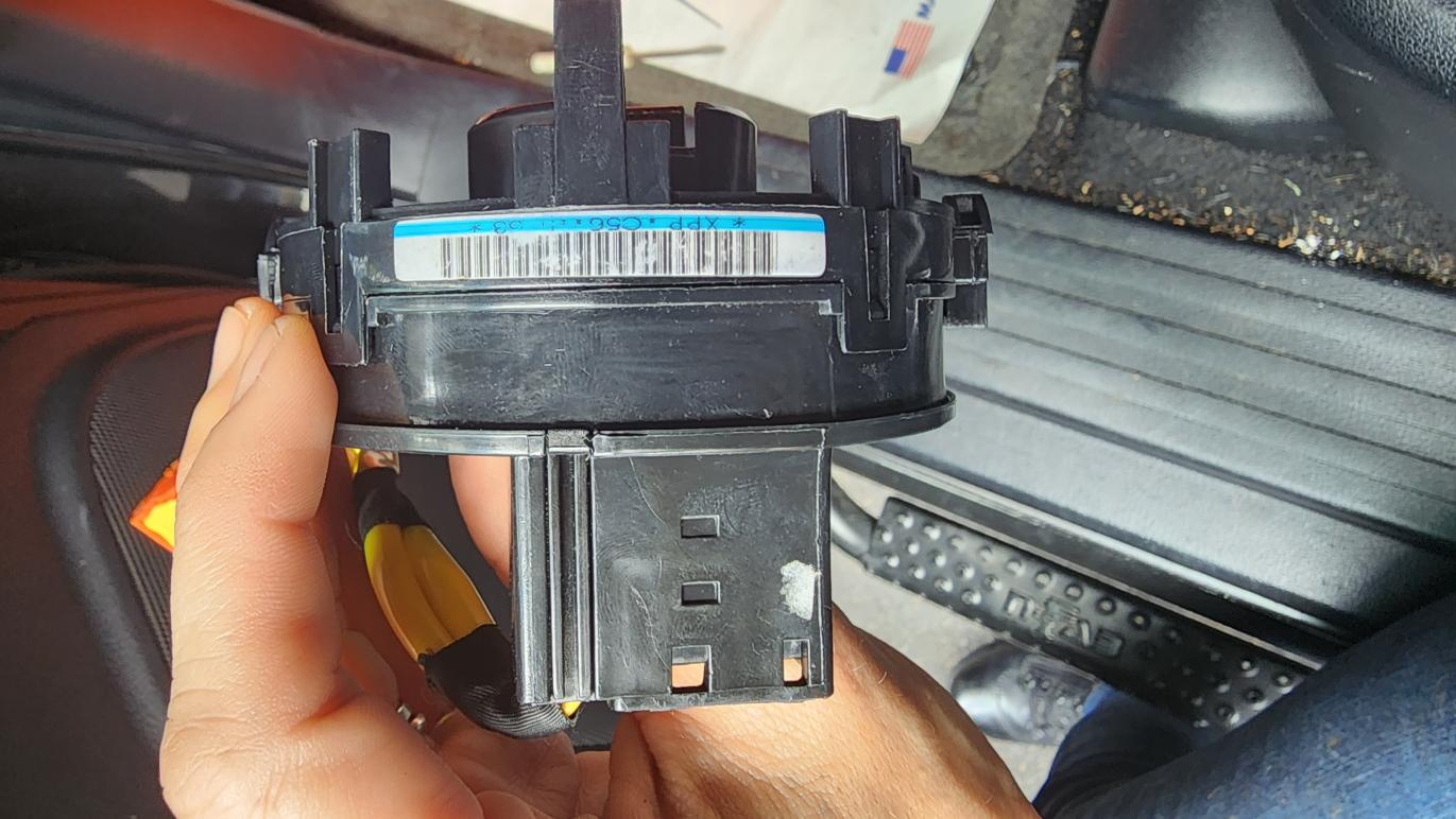

I am a rookie and now gonna become pro. I ordered part that was labeled a match from there website remove angle sensor from original and install ..putting back together 2 main connectors Airbag and CMC ECU ports wouldn't click in. I thought I wasn't putting it in right.without full connection guessing set sensor off when I put back together
airbag VSC and power steering lights now on! put back original airbag light went off but VSC and power steering lights still remain on
so attempt to contact the "experts"
guy told me sorry your emails in my spam 1week later only to tell me I ruined it putting it in or I forgot to plug something and that's reason not working. no sir!!! they sent wrong model so
sent pics of items side by side #s wrong and differences still no refund or spring or now sensor.
HELP....Anyone help with aftermarket part that worked for 2012sr5 ? and where to get repair manuals ?
trying to fix this but bought 2 scanners wouldn't read or scanner software wouldn't work and now battery seems to be part of the issue not cheap guys but 800 in already and truck is worse off than just getting OEM and took experts word.
