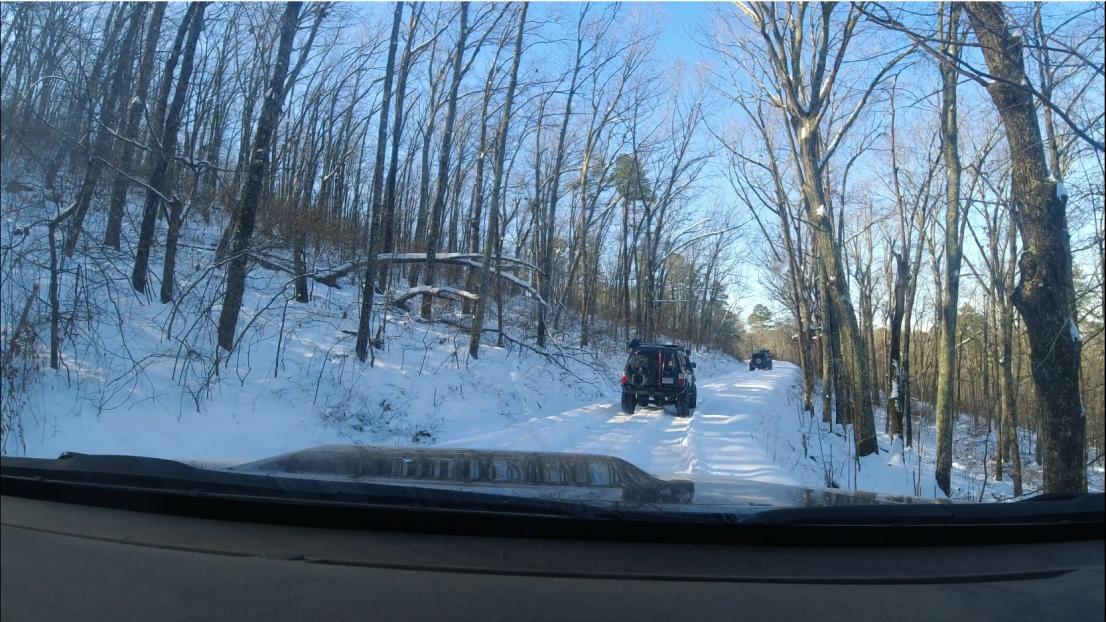

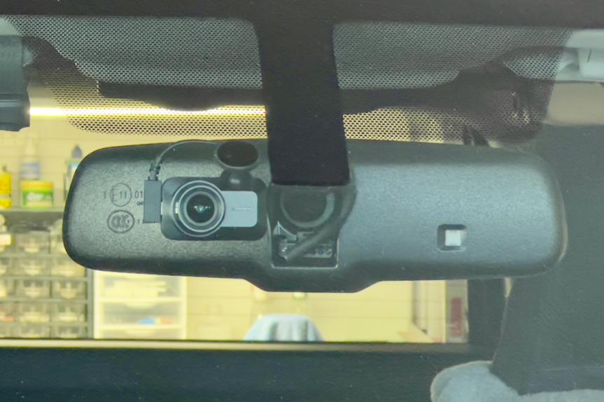

Added a Garmin Mini 3 dashcam. Love how basic and small it is.
Ran the cable up the rear view mirror "channel" into the head liner, down the drivers side a-pillar, behind the door gasket and kick panel, under the door sill, out over (under the rear passengers floor mat) to the 12 v outlet. Only on when vehicle is running.
Haven't downloaded any files yet to really check the video quality in detail, but via bluetooth on my phone looked decent.

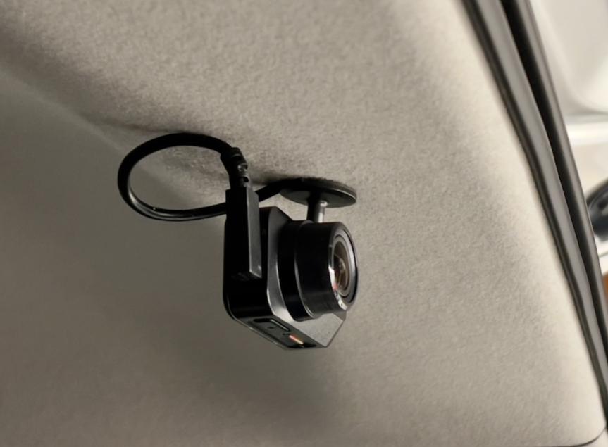

Some Friday night garage time.
After recently adding the Garmin Mini 3 to the front I got one for the rear.
Routed the cable along head liner, down rear pillar by jack storage compartment, over wheel well to under the rear door sill, under rear floor mat to 12v on back of center console. Garmin's 12v adaptor can take two cables.
Looks decent, will road test today. Sits back a tad from the window bc I used the retainer clip, no adaptor, seemed to be the cleanest install. Used the clip closer to passengers side vs center one so that the camera sits in the area where the wiper cleans.

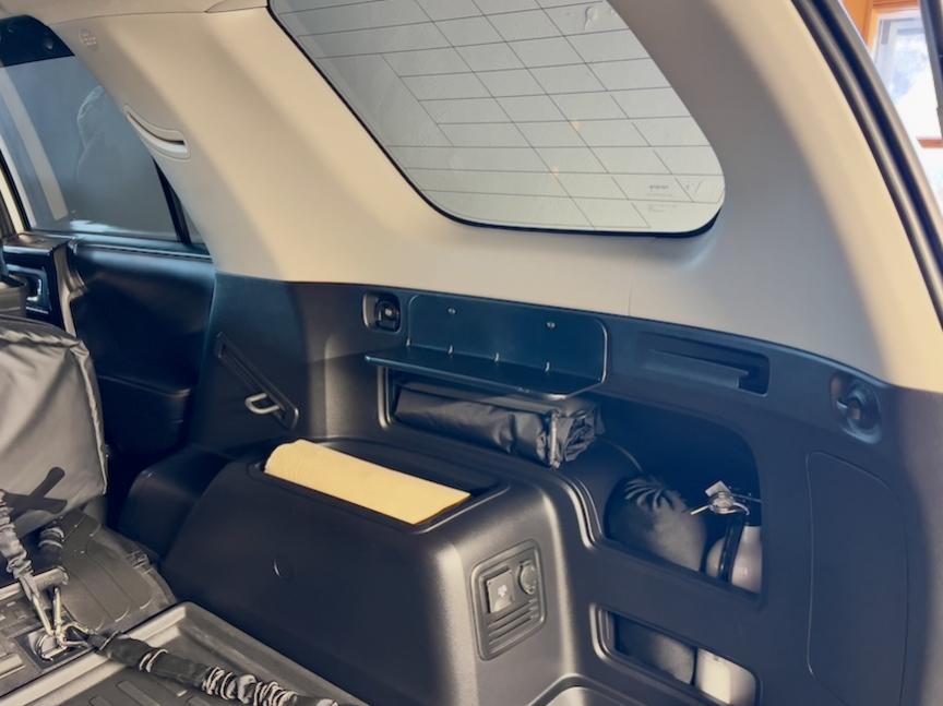

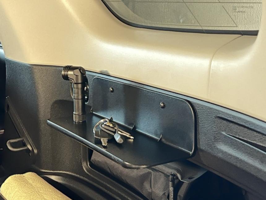

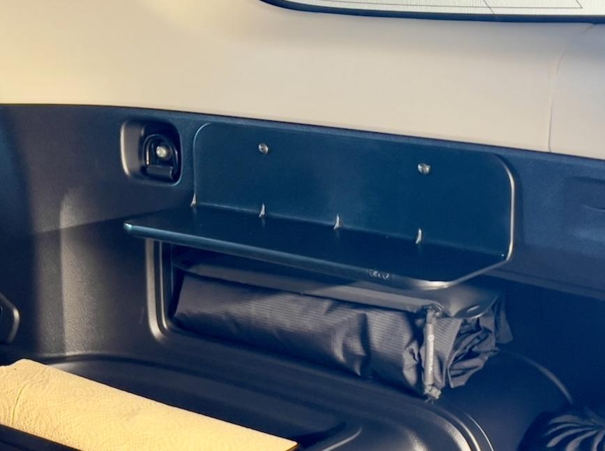

Installed the smallest, lightest interior shelf unit I think I've seen in a 4R.
Seems ridiculous but I've been always wanting to add a shelf in this spot. Summer, the fridge/cooler lives on that side of the cargo area and I'm always looking for a little extra space (but keep minimal and open).
Saw something similar on a van dwellers Youtube vid and found this: Amazon.com
Surprising nice sturdy ABS plastic.
